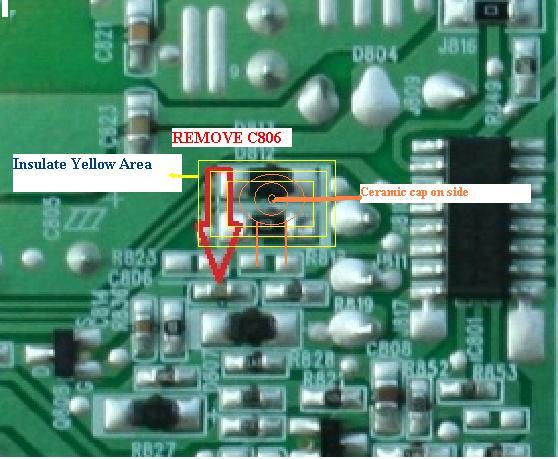

            Next step is to try the eBay inverter on another sister monitor at work to ensure that the replacement inverter is good. If so, then my issue MUST lie with the panel - probably a failing backlight bulb.

                          After not being able to participate in 'Badcaps' since Dec last year due to having some Surgery,it is nice to see it is still going strong and helping those that need it.
                          This was of great interest to me, as I have had the same monitor with the fault for a few months now,and I know lots of others have in the past.
                          So took out C806 as advised, repalaced with 0.1uf,50v ceramic disc,and it has been running for the last 4 hours with no shutting down,with the fault on it used to take 30-40 minutes before fading away.I am delighted,both with fix and the return to the Forum.

                            Can you provide some photos of the repair you did? I will likely send this off to have this repair done, but I'd like to see what you did so I can instruct someone to do the same.

                                    Aha...got it. Where did you solder the ceramic cap?

                                      Re: Dell E228WFPC goes dim after 10 minutes, not 2 seconds
                                      I first removed the C806, and there are two non used solder points directly next to the 'o' link,these go to the same points where the C806 was connected to.I then put a piece of insulation tape over the '0' link and the Diode next to it,put a little sleeving on the legs of the ceramic Disc I was fitting, and soldered to the two non used points,with the ceramic disc resting on the insulation tape.As the disc is thin when lying flat on the tape it does not cause any problems,and has worked very well.

                                        Ok Rtech just to be sure I have done a pic of what I think you did.
                                        Perhaps you can confirm.
                                        Was there some reason not to use the C608 pads?

                                          I could have, but the top one is very close to R819,it would be easy for a slip of the soldering iron to cause damage to that.The way i done it used 2 previously non use solder points so therefore logically in better shape than the originals,and it made the job simpler as the legs of the replacement disc fitted very nicely to those points,without having to bend then,twist them etc etc.,so it was also much neater and professional in the end.
