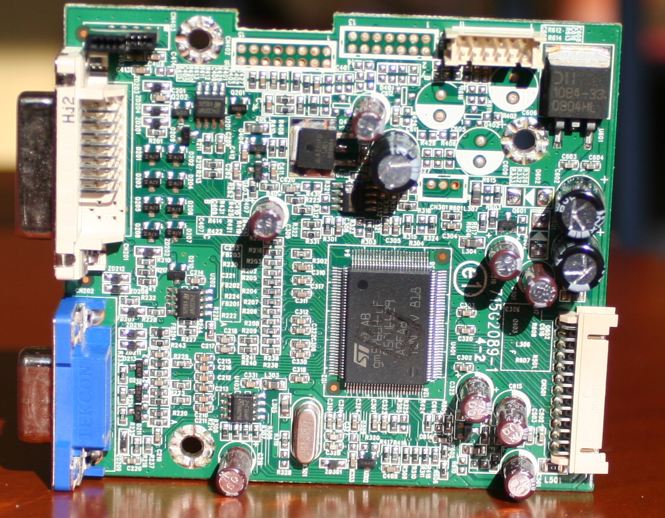

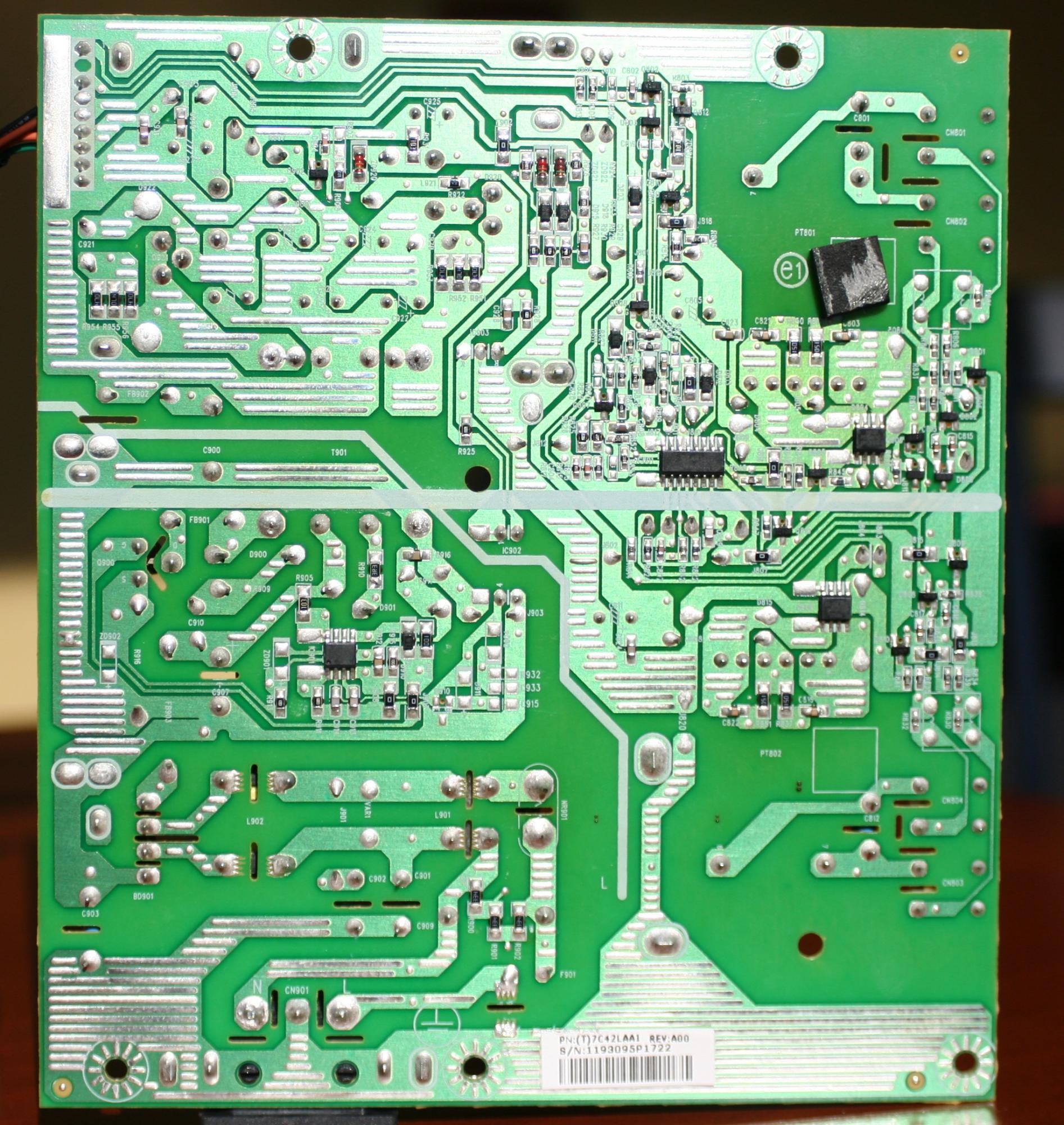

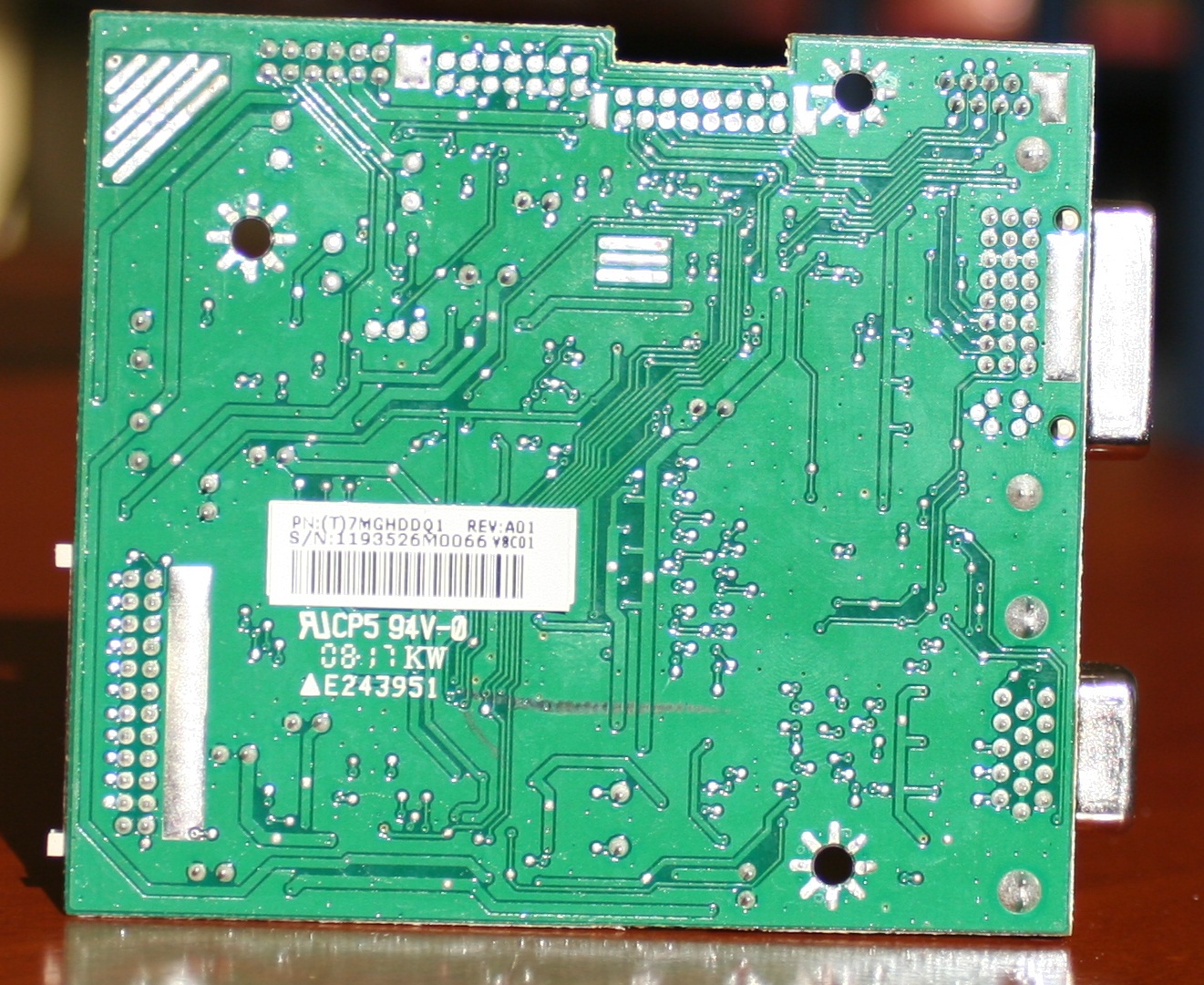

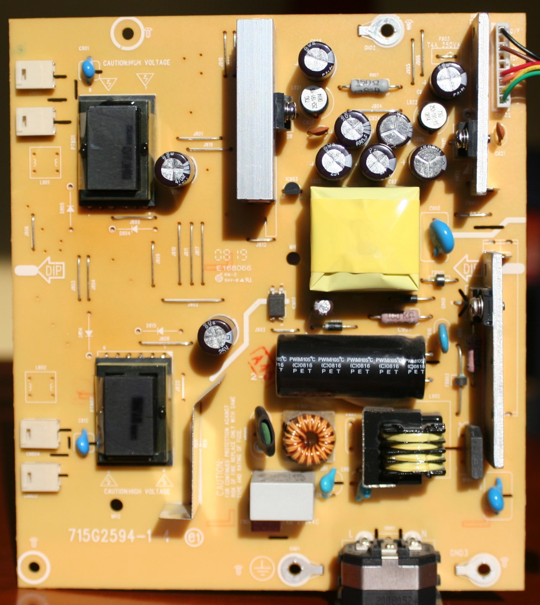

    Dell E228WFPC goes dim after 10 minutes, not 2 seconds
    Working on a Dell 22" monitor I purchased from eBay. The monitor stays on for approximately 10 minutes, then goes dim. When it does go dim, cycling the power causes 2 seconds to black behavior. Leave the monitor powered off for a few hours repeats the ability to have it run for 10 minutes, then the issue reappears.
    I've checked all the caps on the inverter board (Elite brand) with my blue ESR meter and all of them spec out fine.
    I metered the blue caps near the transformers and got similar ohms between the two (secondaries, right?)
    I DO have a few spares at work to check for possible CCFL failure, but I really don't want to pull apart another 22" panel that's in constant use unless I absolutely have to. These things are heavy and awkward.
    My symptoms are similar to the ones described in this thread:
    https://www.badcaps.net/forum/showth...light=e228wfpc
    And, of course, pics:

      Sounds like a heat problem/ bad solder joint. Since you have 10 minutes before the problem occurs, may I suggest you try a hair dryer and heat up various portions of the power and logic boards to see if you can accelerate the problem. Hopefully, you'll be able to narrow down the board/area that's giving you the problem.

        have you also checked the esr on the caps between the 2 heatsinks top right of picture?
          Yes.
          Before I try any hair dryer tactics, it would probably be a better idea to place my panel on the boards of a known working donor monitor. If the problem migrates, then I know it's a CCFL issue.

                        Update: I brought a sister monitor home today and swapped in the boards from the known good monitor with my panel. I gave it to my wife to work on all day with her design work.
                        Result: no problems all day.
                        OK, that's good, at least that means I've narrowed the issue down to the inverter or logic board(s).
                        So what now? Start stressing my suspect boards with brightness adjustments, or a hair dryer?

                          A photo of your inverter board would be helpful.

                              Oops! Been looking at too many Dell boards today. Some of them had separate inverter boards.
                                Re: Dell E228WFPC goes dim after 10 minutes, not 2 seconds
                                "I metered the blue caps near the transformers and got similar ohms between the two (secondaries, right?)"
                                So are you able to read the resistance of these two blue ballast caps?

                                    I am just trying to find out if the two ballast caps have leakage resistance when you check them with the Ohm meter.
                                      Try to replace C806.
                                      I had the same symptom with the same IPboard.
                                      I used hot-air to locate heat affected component then found C806 conduct when it heat, replaced with 0.1uF/50V 0805 running fine for 2 months.
