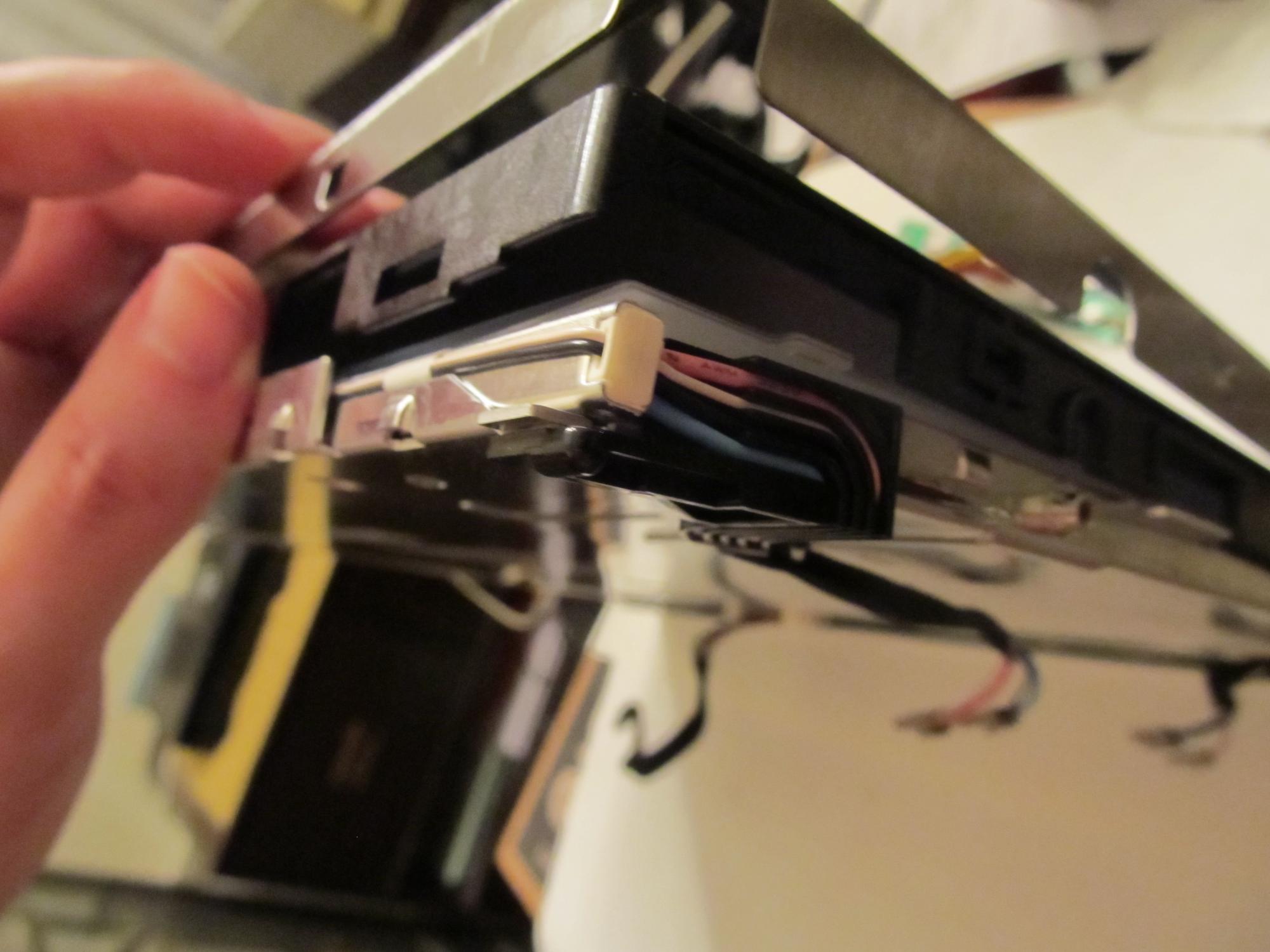

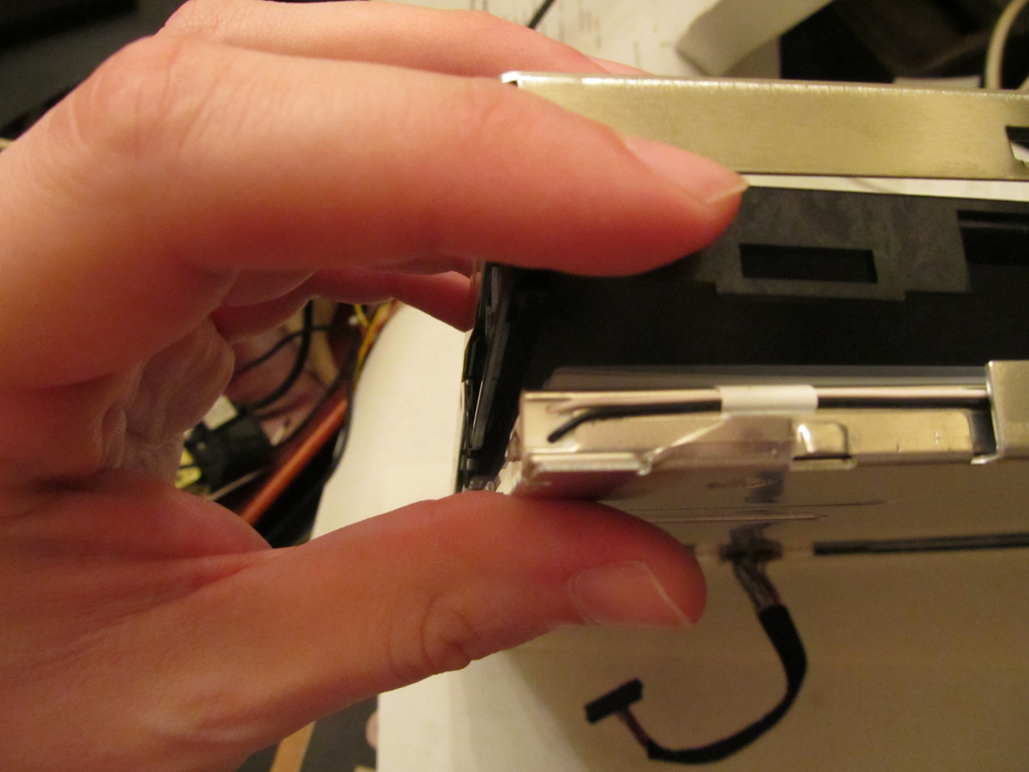

                #47
                Re: iiyama ProLite X486S dead - psu / inverter issue

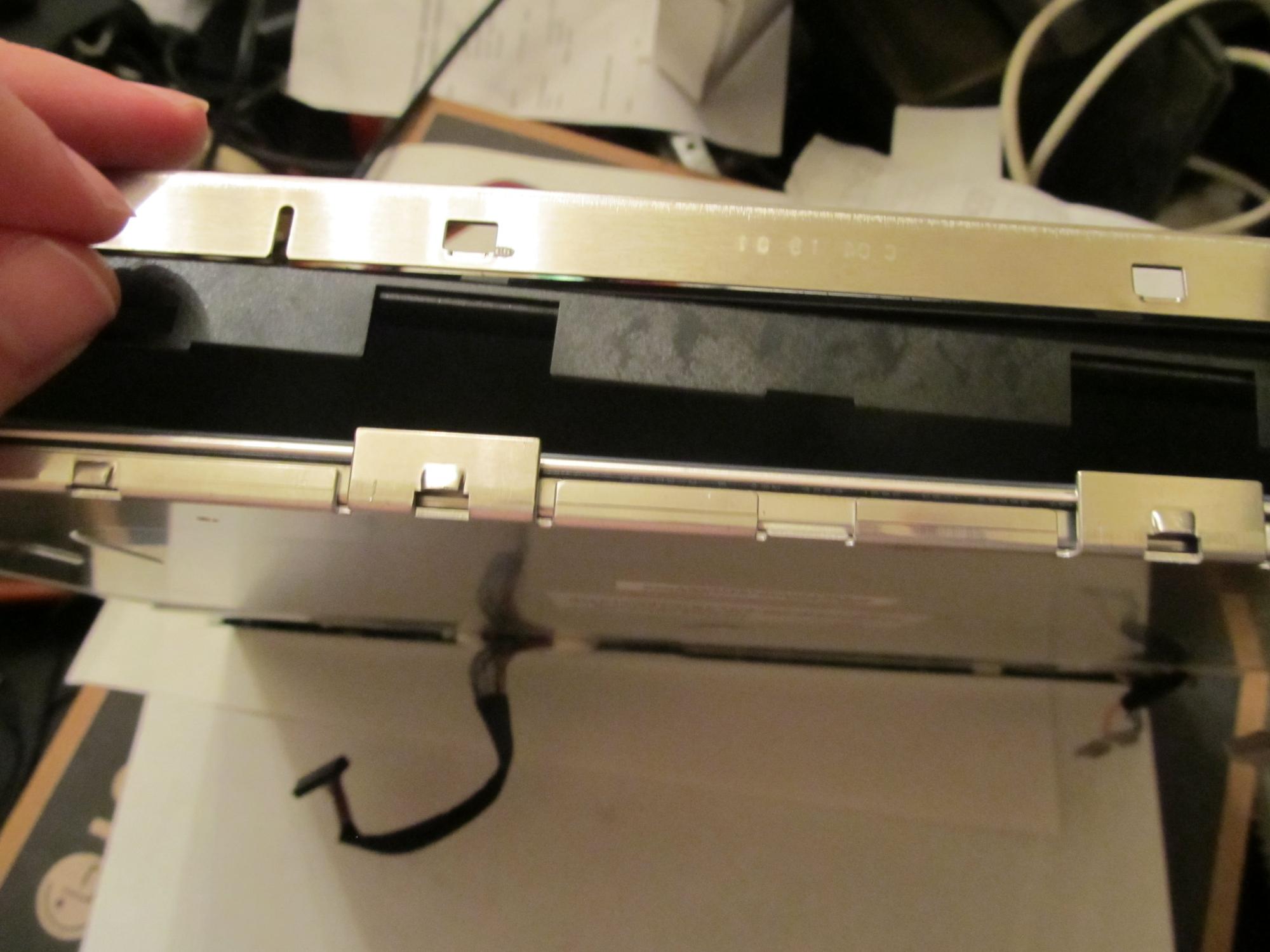

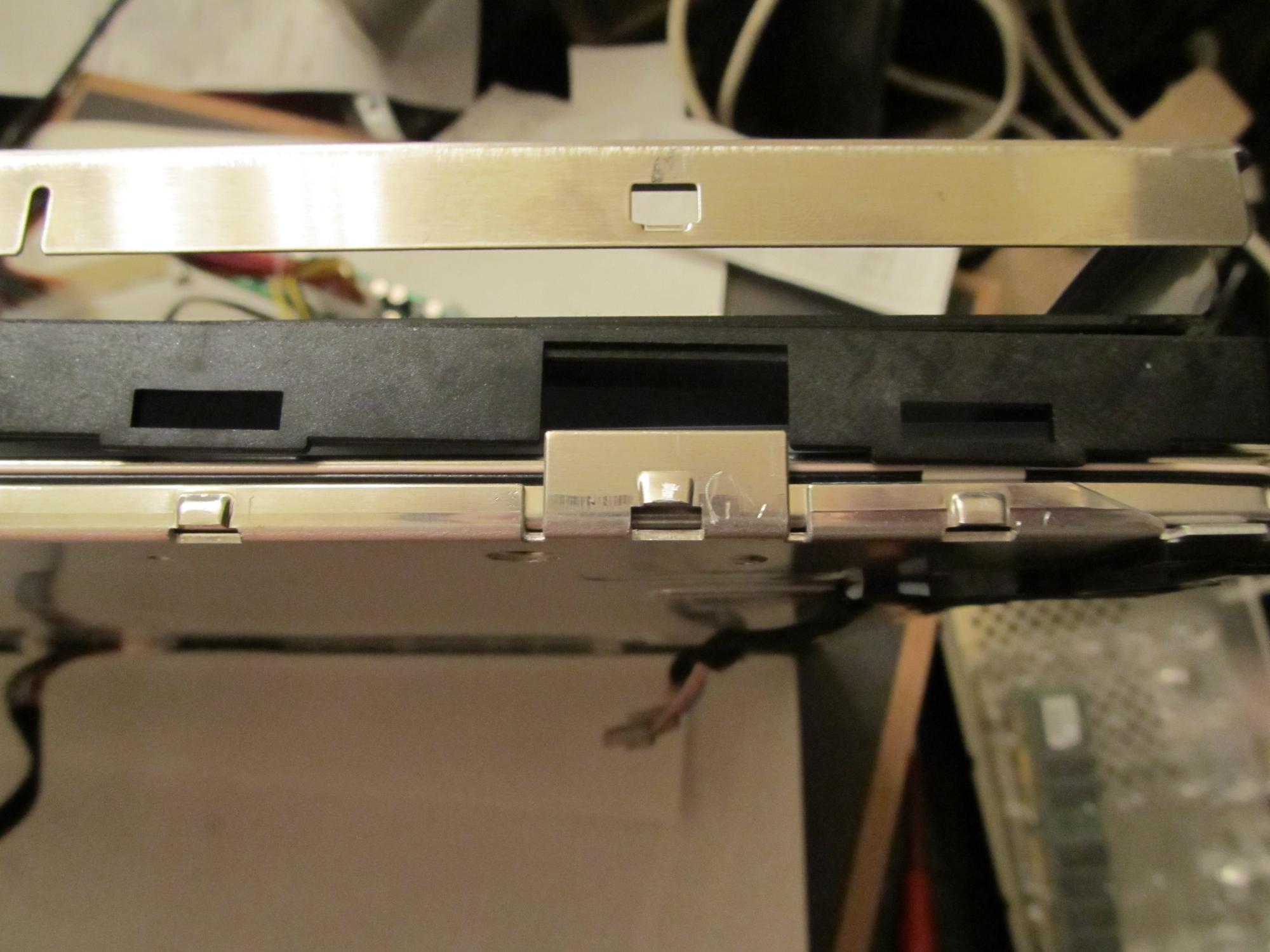

                Yeah. I have just disassembled the panel even more - bottom lamp looks completely OK, wires in excellent condition.
                Also - the monitor died while I was away 5 minutes to get coffee, before that the backlight was perfectly bright, even so much bright that I had to use the monitor on 80% brightness. So I think the lamps will be OK. Also the monitor is 4 years old but had been used maybe 30 days at all (previous owner had problems with her pc all the time and was technically unskilled, so she almost did not use it). Therefore it is practically new.
                Pictures of bottom CCFL attached.
                Next I am going to test the circuits you mentioned.

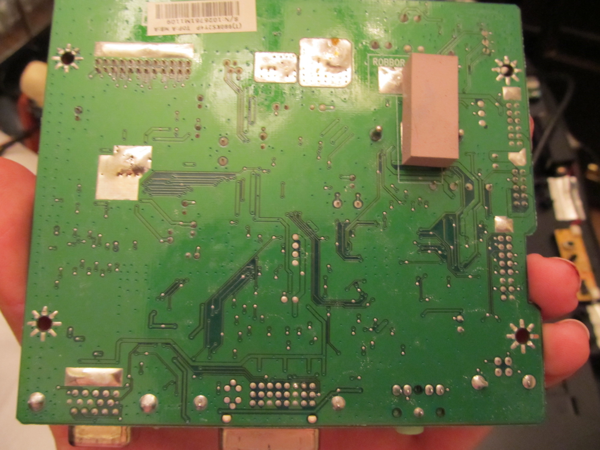

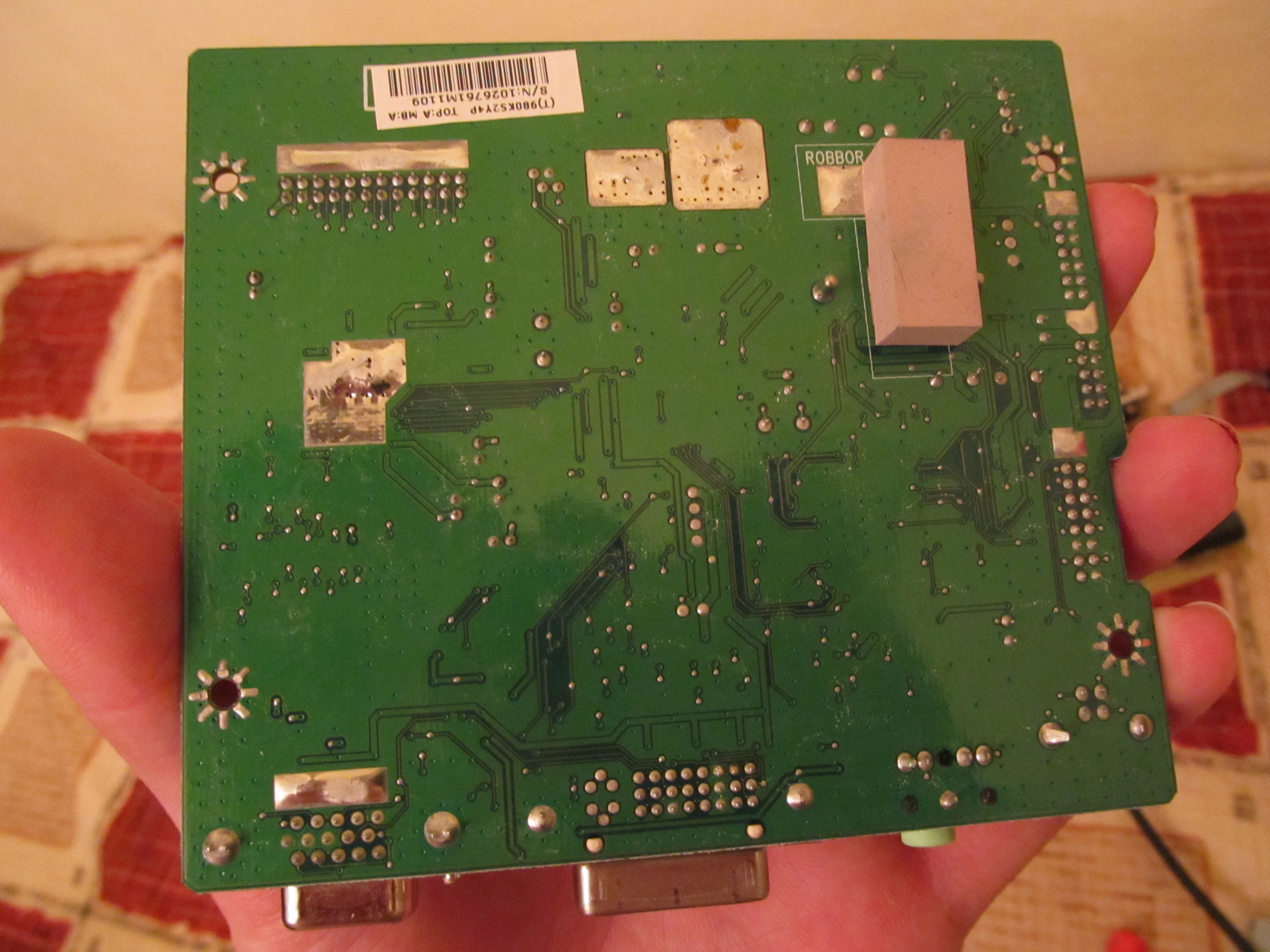

                    #49
                    yeh _ im well outside my comfort zone - I have been lucky so far in getting away with
                    replacing caps. I had worked out that cn701=cn901 but not sure where that led us.
                    I cant see a picture of the back of your main board? unless ive missed it.

                      #50
                      I have taken out the logic board for the first time today - previously I have looked under it and there was nothing - only one rubber pad but no components. This turns out to be true - all components are on the front of the board. I have also checked all solder joints on the back now - seem fine. Pictures of the back side of the board attached.
                      I'd love if someone could came up with some new ideas on what to test. So far at this moment, I'm dry Regarding the capacitor possible problem, is there any way I can test them or do I have to try my luck? I'll go to the local store on monday to ask for low ESR caps and see if they have them.
                      I'll check the other thread you posted. Thank you all so far.

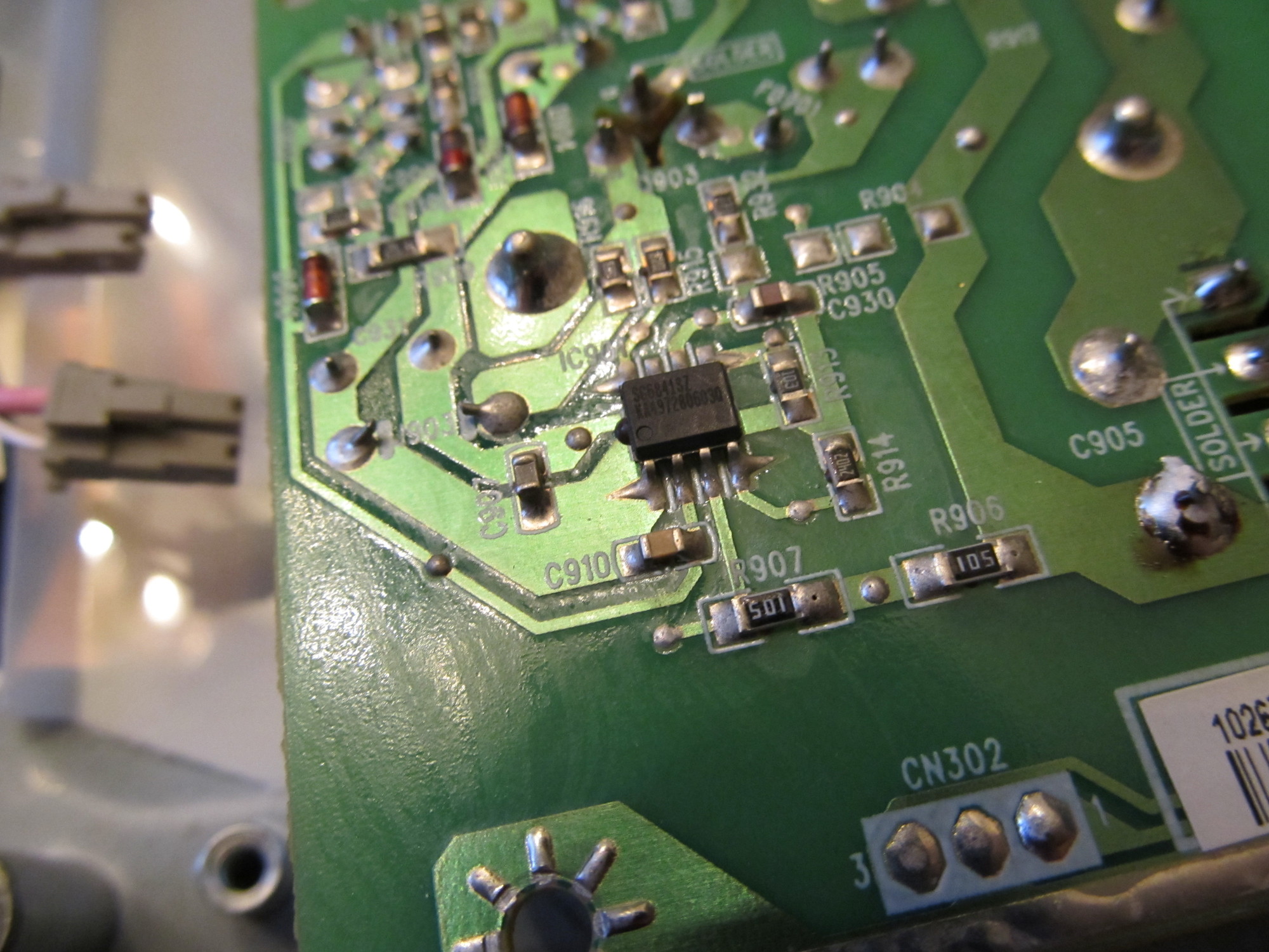

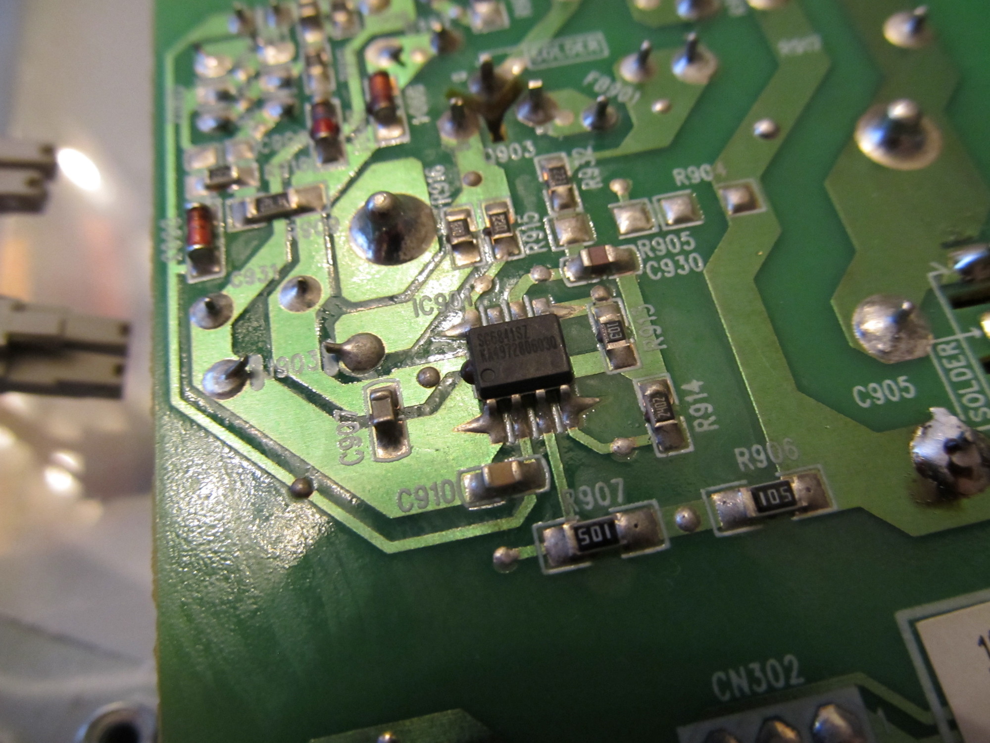

                                  5) the number is
                                  SG6841SZ
                                  KA497280603Q
                                  It is really hard to read, so just in case I got it wrong here is a photo of it (I had no chance to read it using bare eye or using magnifier ;-)
                                    Refer to
                                    http://pdf1.alldatasheet.com/datashe...C/SG6841S.html
                                    1) Use pin 1 (GND) for your black probe.
                                    2) What is the DC voltage for pin 3?
                                    3) What is the DC voltage for pin 7?
                                    4) What ohms reading did you get for fuse F902?
