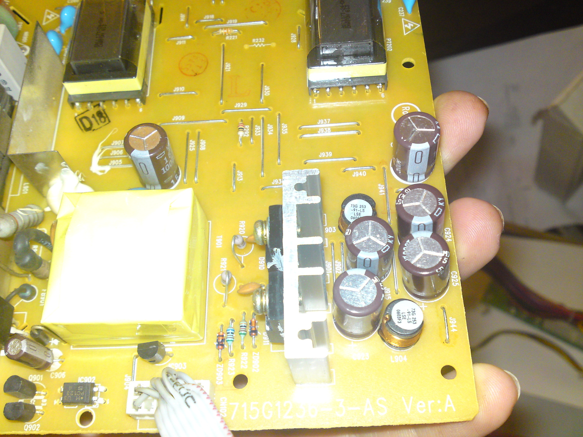

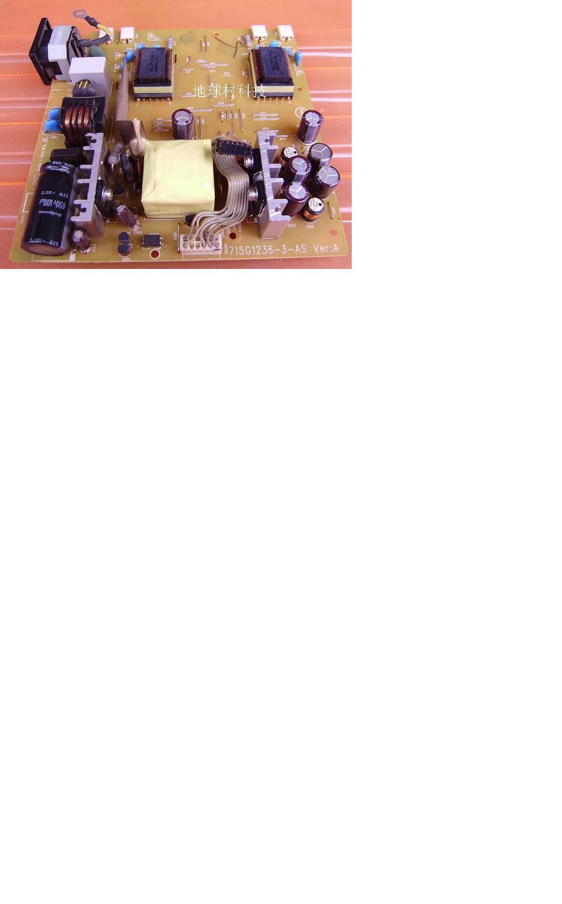

                                        Off current thinking but can you look at Q901 - it looks like a solder blob but is shaped
                                        like the Q902 transistor - has it been snapped off or is it just solder? The schematic whilst a guide has a few differences It has Q901 mentioned in the parts list but cant see it anywhere else.
                                        Hah - found a pic with it on???
                                          #40
                                          Re: iiyama ProLite X486S dead - psu / inverter issue
                                          The Q901 is in normal state, present and is black - on the photo it must be some camera weirdness. It really looks like a blob of solder but you can see it more clearly on photo 4 - also attached here.
