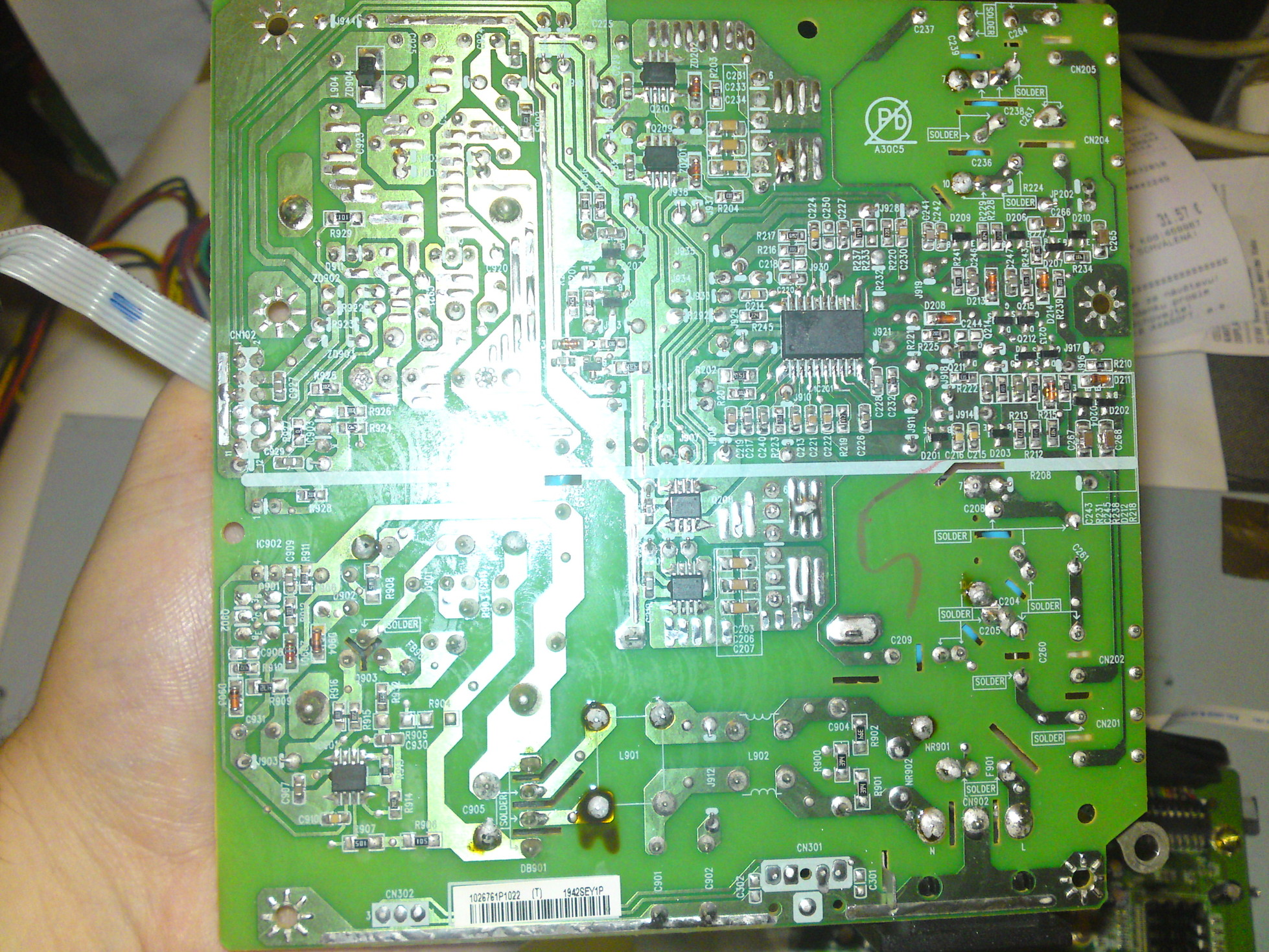

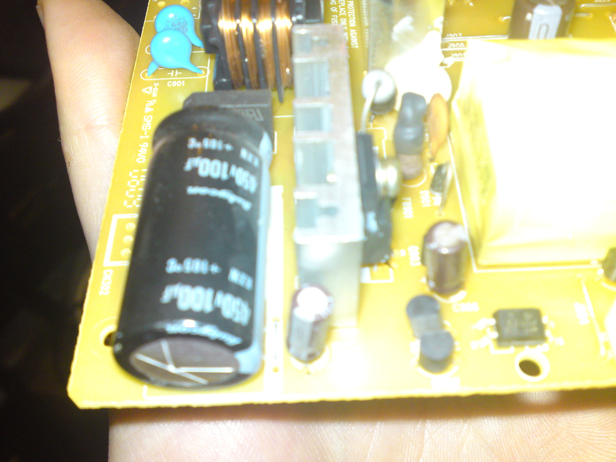

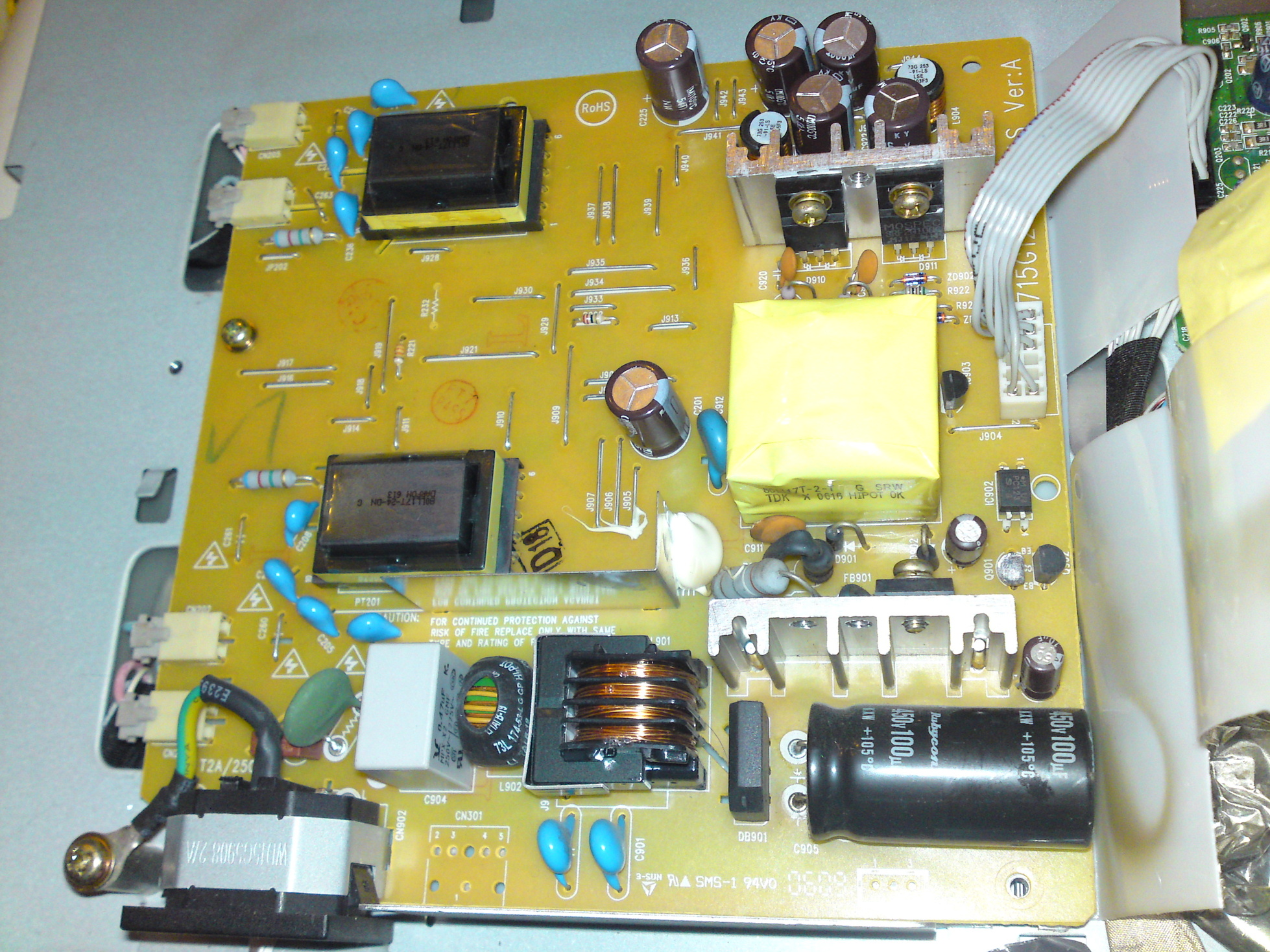

    Hello, I'm looking for some help with my 19 inch LCD monitor.
    My iiYama ProLite x486s monitor has just stopped working. I have tracked it down to be (probably) power supply / inverter board issues.
    The monitor is dead. When assembled (in plastics), it only shows orange (standby) LED. It's supposed to show blue led when ON. This led shines, but shines faintly, so that it's invisible through plastic.
    When disassembled, the blue led is visible - faint - and display is dead, no picture.
    I have found another thread that describes dry solder joints around L101. My board had many dry joints, so I resoldered L101 (on mine it's L901) dry joints and also resoldered any other dry joints that I could find. No luck, still the same. Capacitors are visually OK (not bloated). Board is visually OK. Transistors are not shorted (tried to measure them and some resistance always popped up).
    The problem, I suppose is that on the main connector (to monitor main board), the voltage on pin 12 is 12V when in standby - however when turned on (faint blue led shines), the voltage drops to 9V. On pin 3 (5V line I suppose), the voltage drops from 5V to 1V. I think the monitor wants to display "no signal message", because after a while it goes to standby again (strong orange led shines) and the voltage again rises up to 12V/5V on said pins of connector.
    I'm just guessing here. Also, when I press the power switch on the monitor, the PSU (don't know which part) makes a high pitch / frequency noise for about ~2 seconds [voltage is now STILL 12V/5V BUT blue led shines faintly anyawy], after this period the noise stops (complete silence) and the voltage drops. After a while (~10s) the monitor goes to standby, no noise from PSU any more, and strong orange led shines. Voltage also rises to 12V/5V.
    This repeats when I turn it off via power button and on again.
    It just completely died all of the sudden. No issues before whatsoever. Any help on what parts to check or what could be the problem would be really great.
    Also, the psu part number is 715G1236-3-AS, but I have been unable to find a datasheet for it. I do not even know the actual pinout for the main board connector, so maybe the voltage drops are normal.
    Also, there is no backlight, nothing.

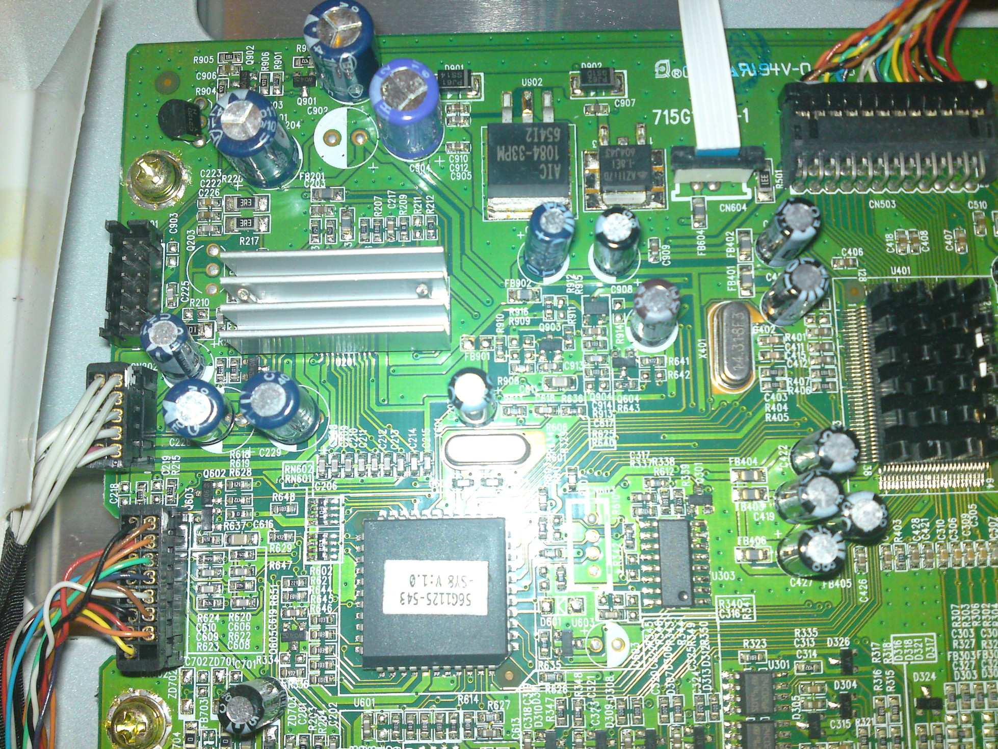

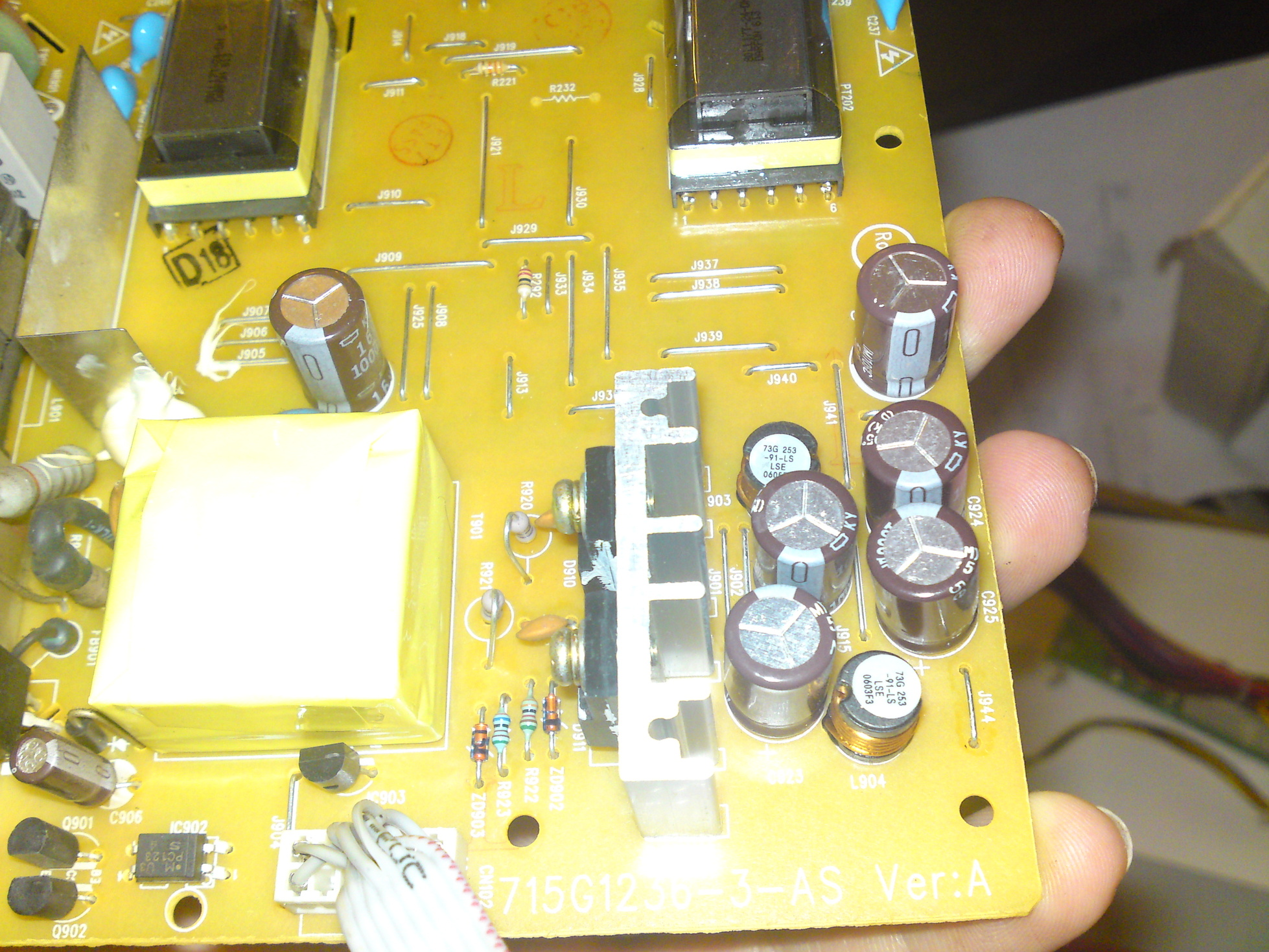

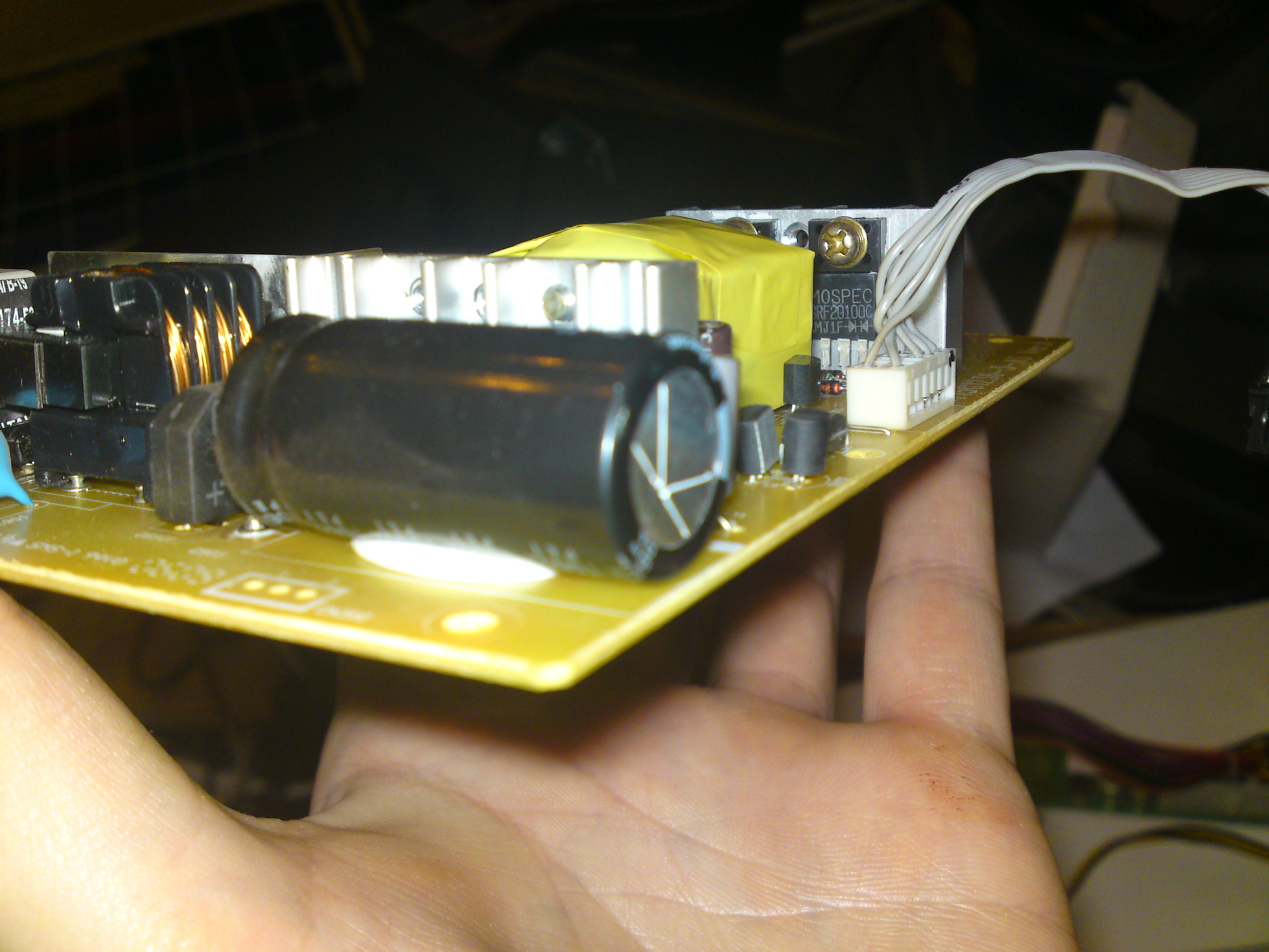

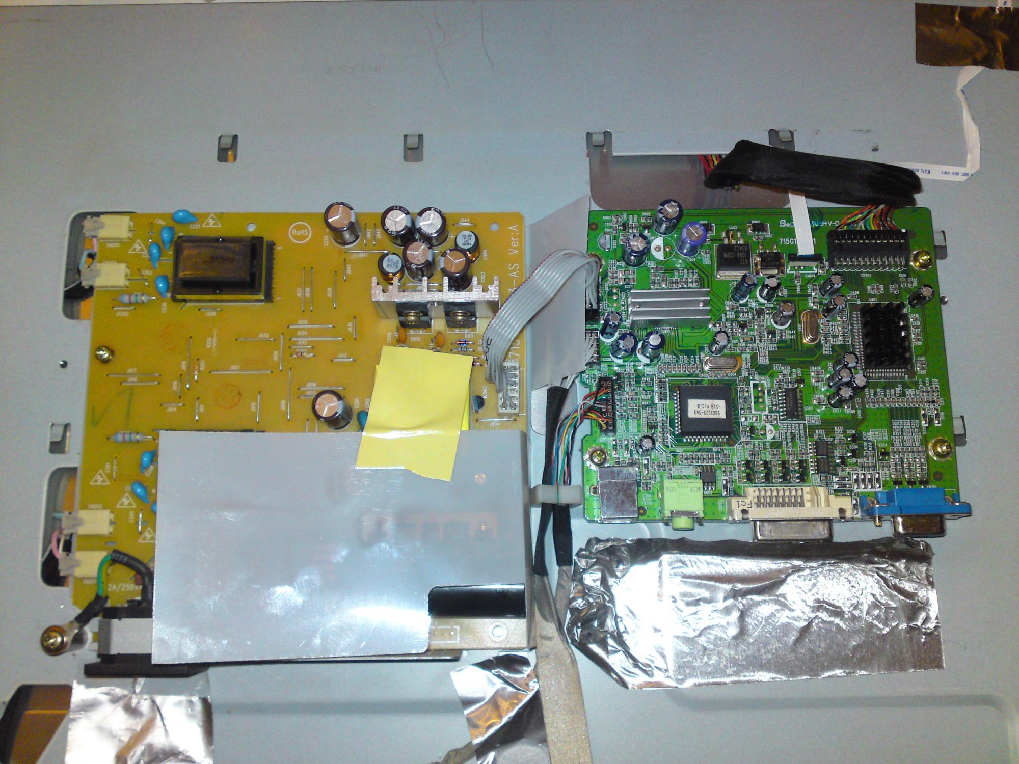

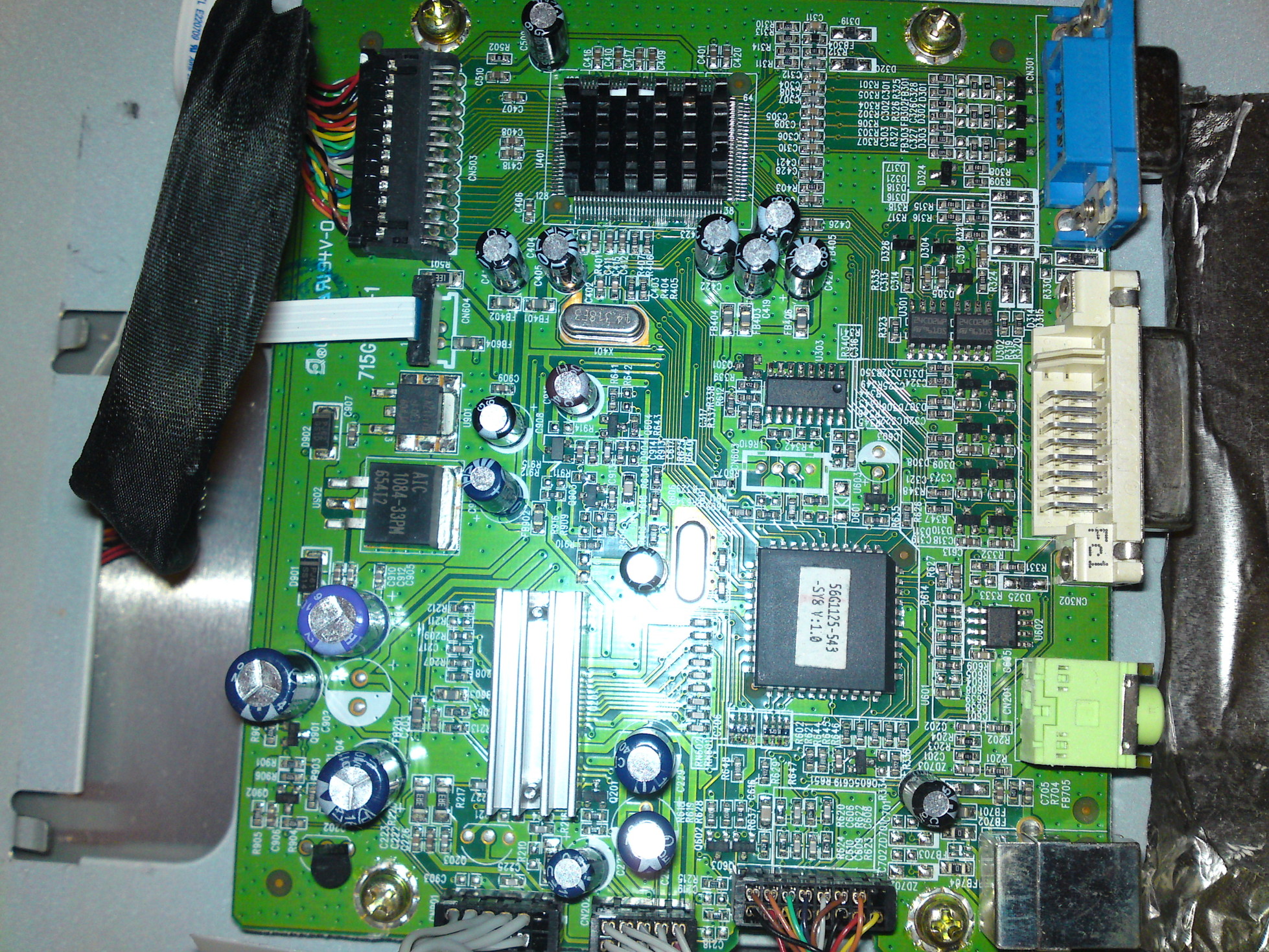

    Detailed pictures of boards attached.
    Thanks!

    Hi bit too much flash/glare on some of the pics.

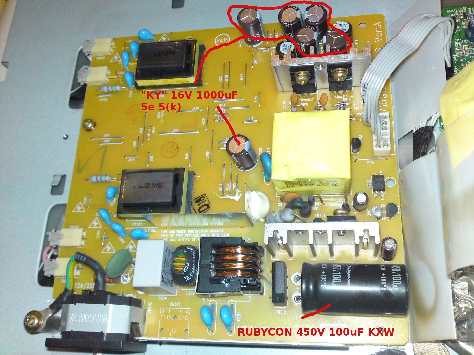

    Are the caps on the powerboard united chemicom?

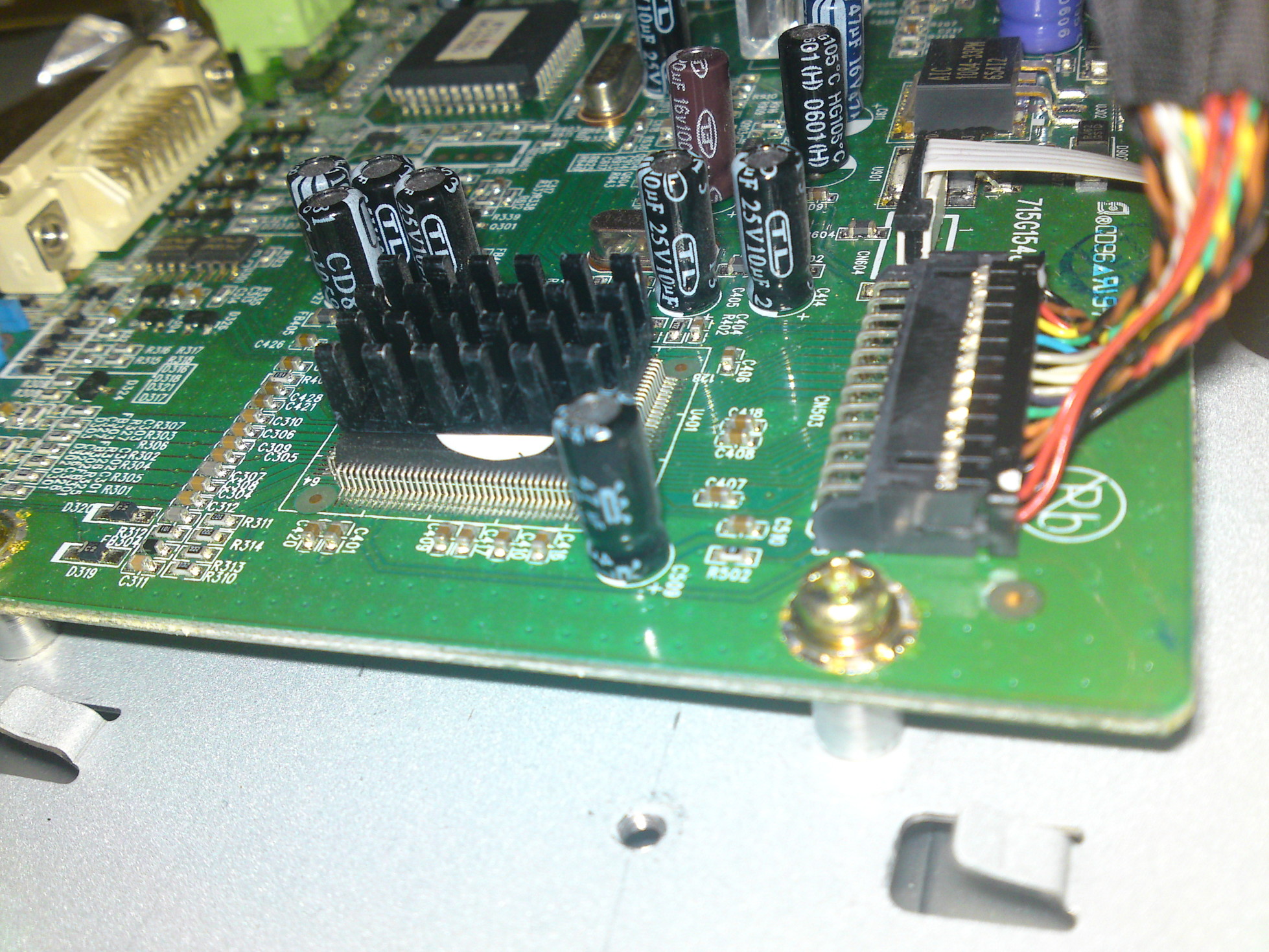

    What make are the caps on the main board.
      Re: iiyama ProLite X486S dead - psu / inverter issue
      Other than the glare, an excellent set of pictures. Certainly they give a good starting point for measurements. And your initial observations were a good start.
      My suggestion is to mount the power supply in place using all the screws, but leave the ribbon cable to the signal board disconnected. Measure the voltage across the pins of the very large cap - it should be 1.4 x the AC line voltage - 165 volts in North America, 330 volts in many other parts of the world. Next, measure and report the voltages on each of the 12 pins in the connector to the signal board.
      Now, with the cable to the signal board hooked up, but the LCD panel disconnected and the power LED glowing amber (standby), repeat the above measurements. And lastly, repeat them with the power LED glowing blue (On).
      By your description I suspect either the inverter or the LCD panel is producing an excessive load. As an alternate explanation, it is possible a bad cap could be responsible, although all look fine.

        Selldoor - I am unable to find any brand information on the capacitors on the main board or the power board, attached are some labels I was able to read off and seemed to make sense (they looked like model numbers)
          Hi - Hermei caps are poor and will probably need replacing The EL and TL may be
          Elite and again are poor. The KY ones on the power board maybe Korea Chemicon
          not much info on them but id guess not very good. The ones on the Main board have logos but I cannot make them out - can you do a side picture of each one.
          There are a few posts on other iiyama monitors which had these caps as well.
          Late Edit - two small caps near the BIG cap on the power board are also important ones - they also dry out as they are near the heatsink
          if you can detail these as well

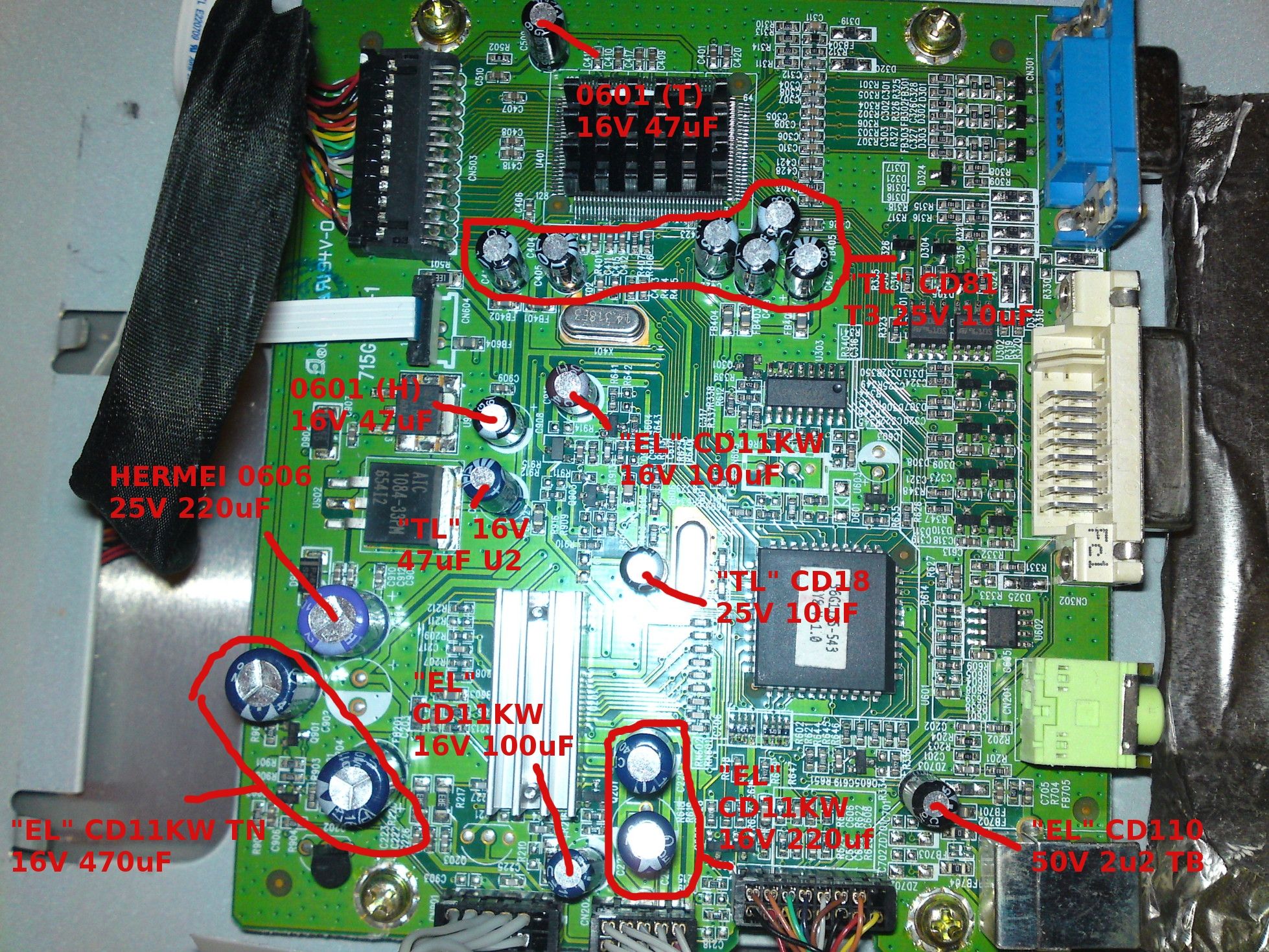

            Oh, sorry, I forgot about those. They are:
            - KME 50V 10uF (the nearest one)
            - KME 50V 22uF (the other one)

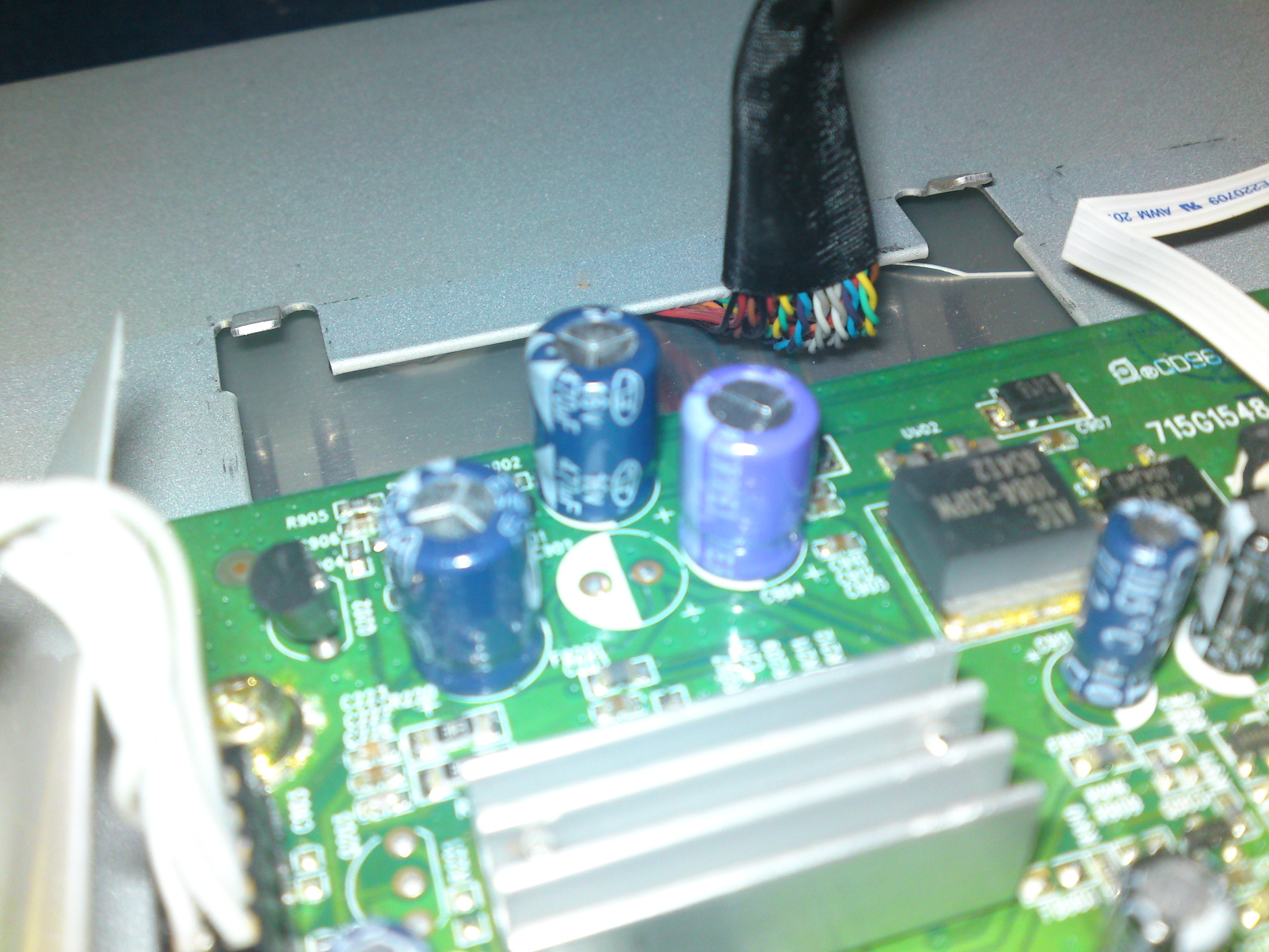

            Below are enclosed close up pictures of main board caps, there are 4 brands of capacitors on the board:
            - first is "TL" in circle
            - second is "EL" in circle
            - third is looks like an eye with three eyelashes (on closeup - nearest capacitor on the photo - sorry for quality) [2 pieces on whole board, second is to the right of the brown capacitor] - the same capacitor (voltage & capacity)
            - the fourth brand is HERMEI - only one capacitor on board - sorry for closeup quality (my camera's macro is not the best)
              Pics will do ok for this.
              Probably a poor set of caps all round apart from the Rubycon.
              KME is probably Samyoung or Korea chemicon - poor
              TL is a manufacturer in its own right but cant find if good or not.- probably poor
              EL is probably the other way up - I see it as a black F in a white T in an elipse. cant find it anywhere.
              Eye with 3 eyelashes is probable WC (a w on top of a c) and is related to Hermei so poor.
              Plainbill may be able to identify EL and may suggest which to replace first to try and get it going if he thinks caps are the problem.
              In the UK I would just replace all as on these boards there are not many and they are relatively cheap.
