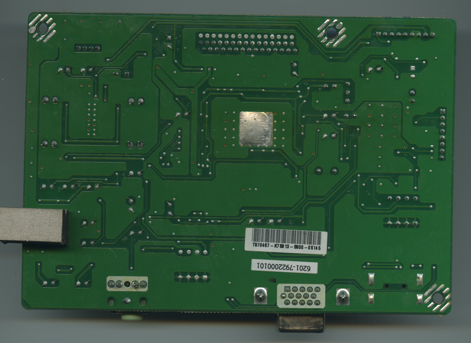

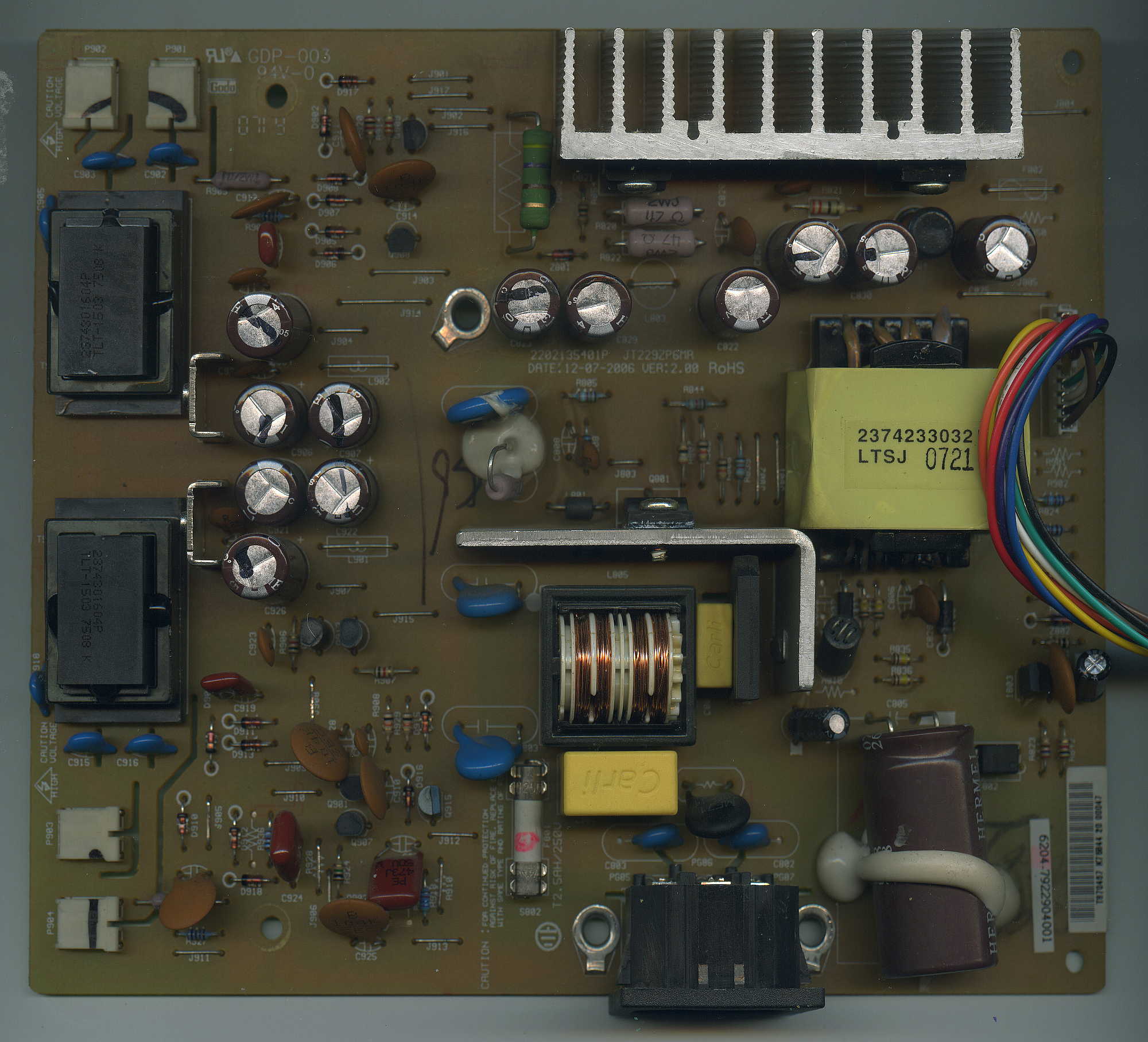

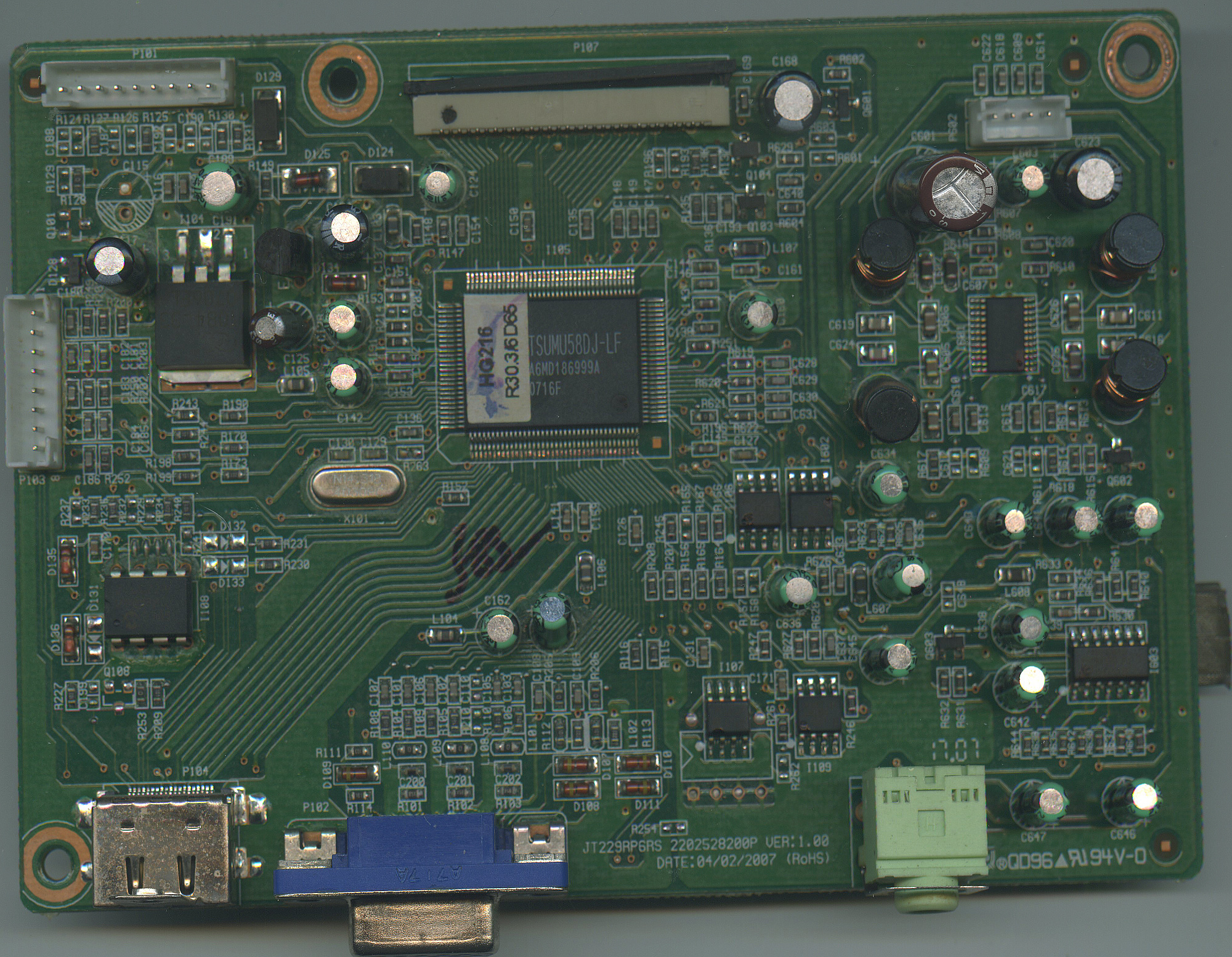

                            Alright, after many attempts I've managed to get somewhat clear images of the boards, front and back. Not so much the connectors, but I'll see about adding info on those tomorrow morning. If need be I also have a service manual PDF I could attach.
                            Power board front
                            Power board back
                            Main board front
                            Main board back

                                Hi, I've got two identical HannsG monitors like this, one of them has this same problem. Boards look exactly like the ones already posted, no sign of anything damaged.
                                @graymon76321: I think your readings are ok, check them with the service manual here.
                                Both monitors were making that buzzing sound previously described, I resoldered C805, L805 and DS-3319. Great improvement, nearly silent now.
                                Tried the working power source with the broken control board; same result, blue led blinking.
                                I suspect the problem lies near Q107 in control board, voltages there are
                                B 2.62v C 2.49v E 3.26v for the working one and B 2.44 C 3.25 E 3.26 for the other.
                                Replaced caps near there, no change. Hope this helps

                                  Fixed it
                                  The problem is in the main board, not the power board. The D124 diode reads 1100 with the diode tester (while still soldered to circuit). Should be around half that value.
                                  D124 is a 1A 100V rectifier (service manual says it should be a GS1B, but it is an M2). I replaced it with an M4 (1A, 400V) from a really broken board from another device. And... IT WORKS NOW!
                                  I also replaced nearby caps while trying to repair the board, so it is possible that C124 was also damaged (however, I think it was not).
                                  If anyone has a HANSS-G monitor with this problem, this should help.
