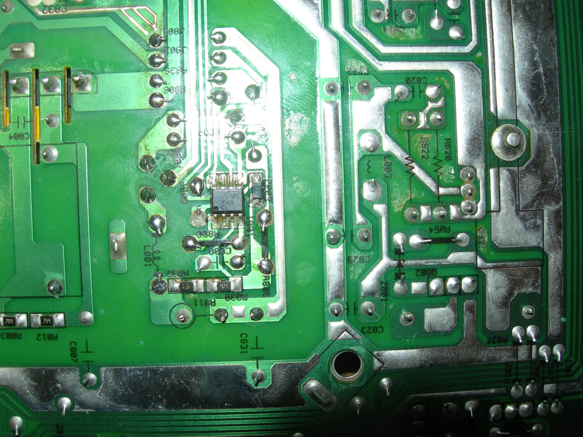

    i have the above monitor and after downloading about 20 schematics (various viewsonic) i still havnt found an exact match to the power board, 24 and 5 volt lines are present but the monitor just flashes the power led, there is a ticking noise which seems to be coming from the video card, if i disconnect the power cable from the video board then the monitor powers up with a white screen, i intend to recap the power board as soon as i can get to a supplier which is open after the xmas break, i replaced 2 caps in the power supply a 22uf 50v one and a 10uf 50v one because the originals looked burned and on the positive leg of the i am getting a very high dc voltage (150v) any help would be appreciated.

    ion the positive leg of the i am getting a very high dc voltage (150v) any help would be appreciated.
    1) You should be getting around 165V DC on cap C805 and only C805. 150 V DC implies that you are AC is around 106 V (150/1.414) which is pretty low.
    2) There is one voltage regulator on the main board. It is I104.
    a) What is the part number?
    b) What is the DC voltage on each pin?
    3) Some monitors require an input. Hookup a working computer with your favourite wallpaper.
    a) Does the power LED still blink?
    b) If yes, what color?

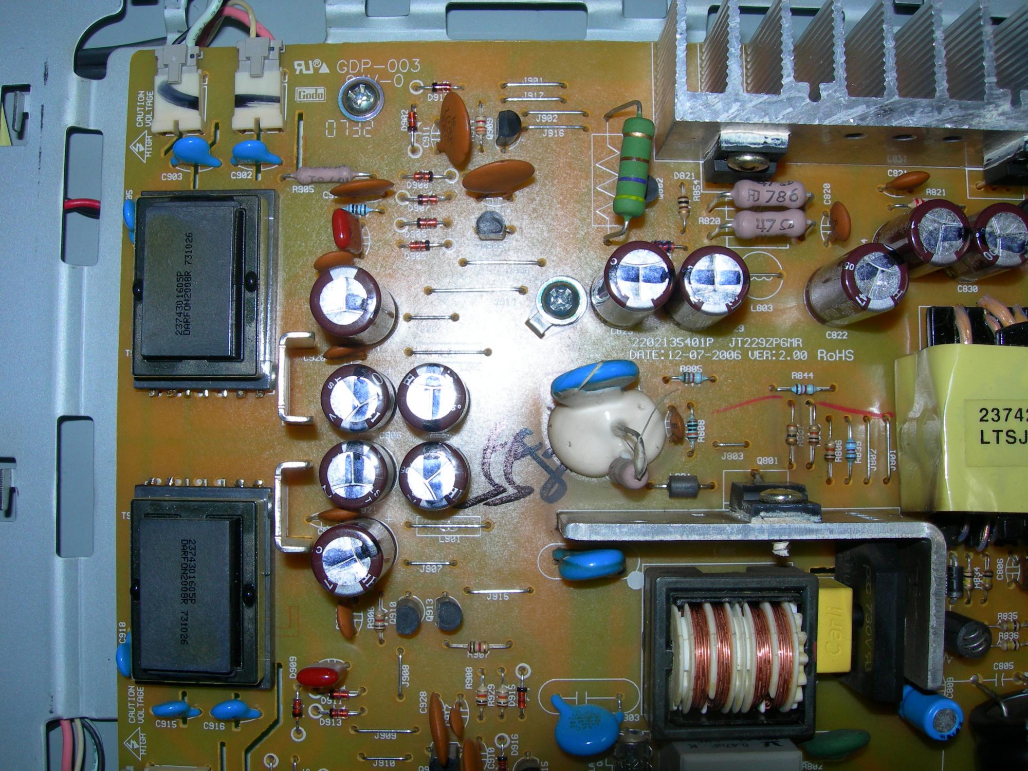

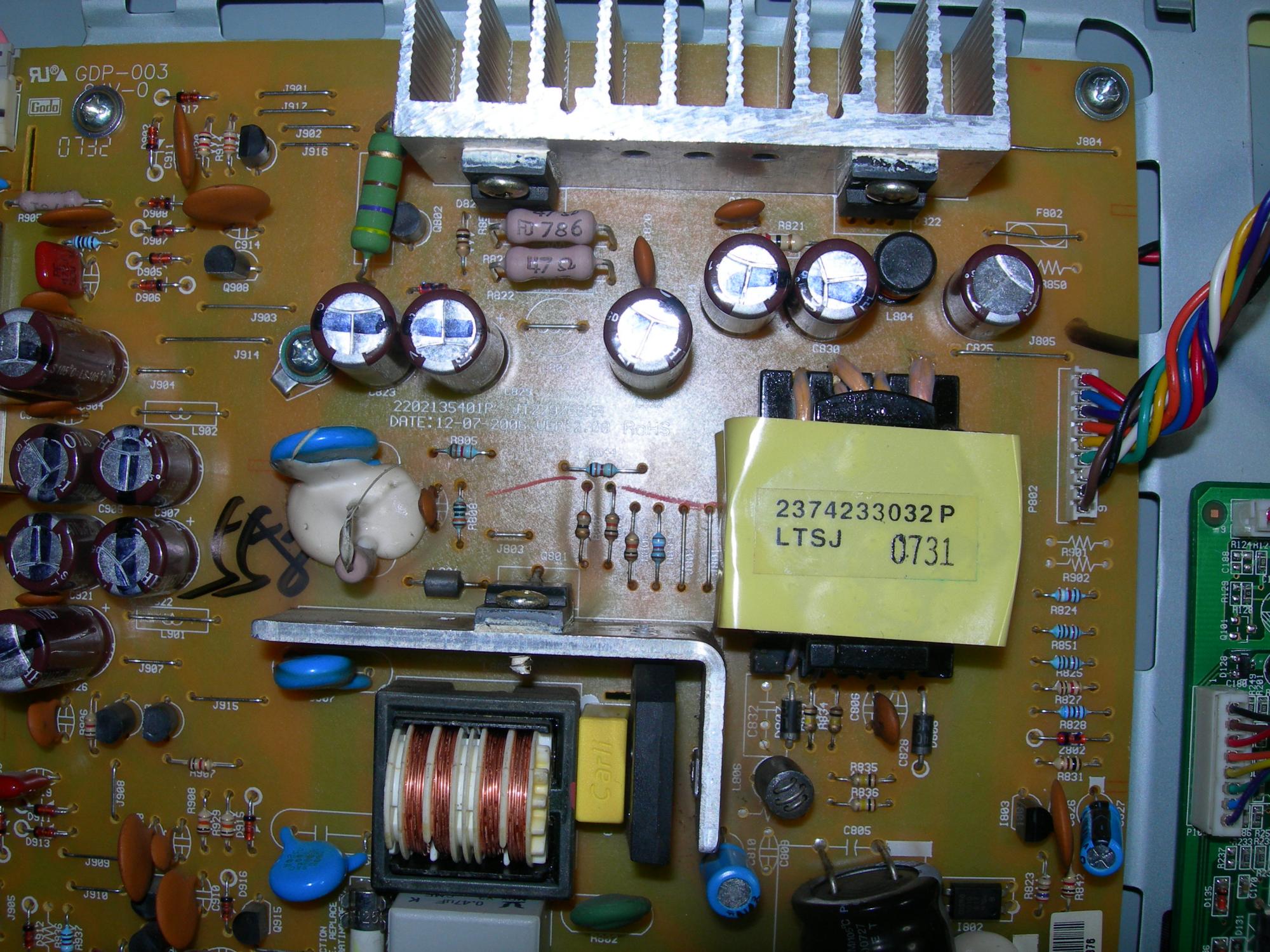

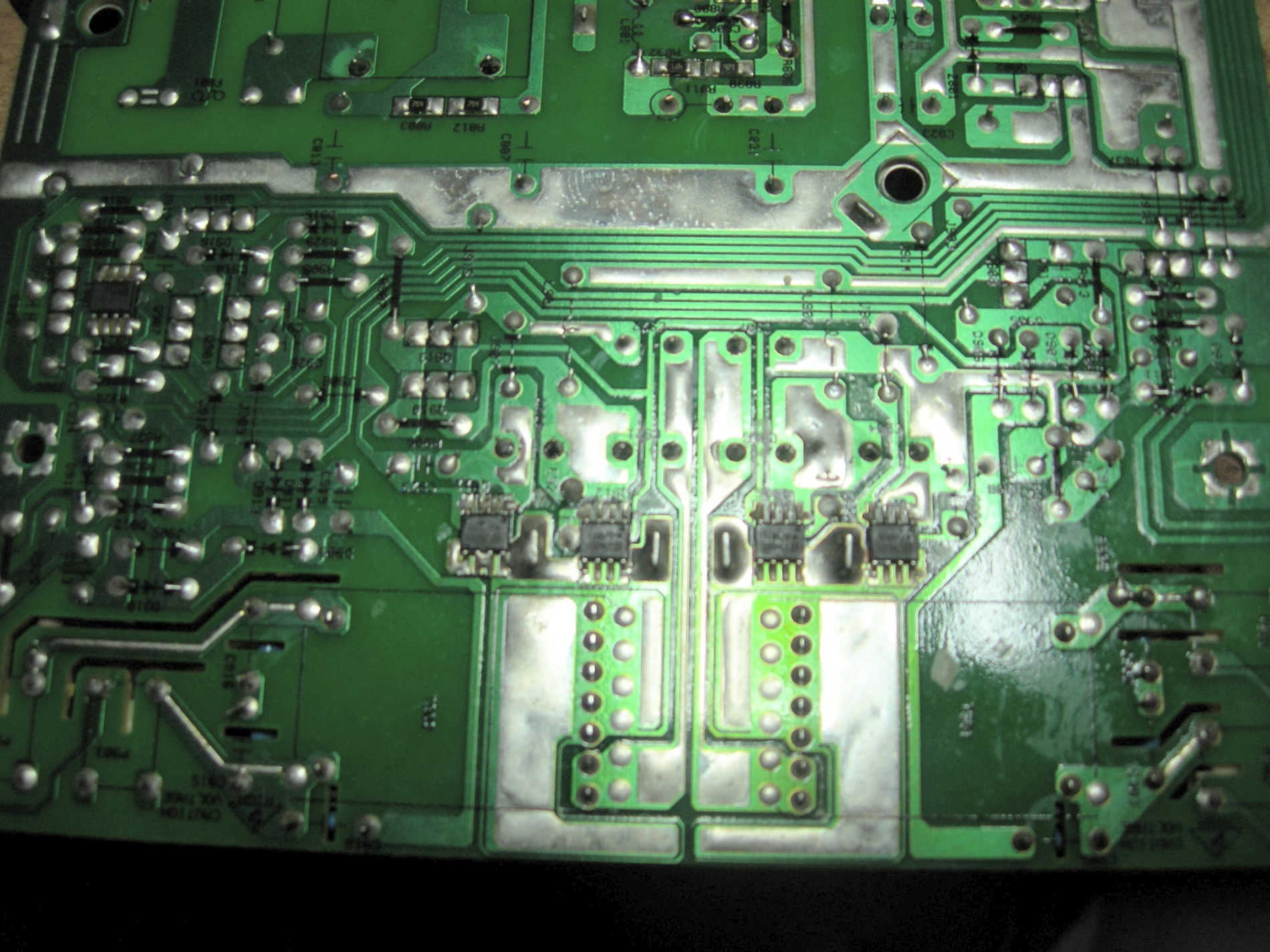

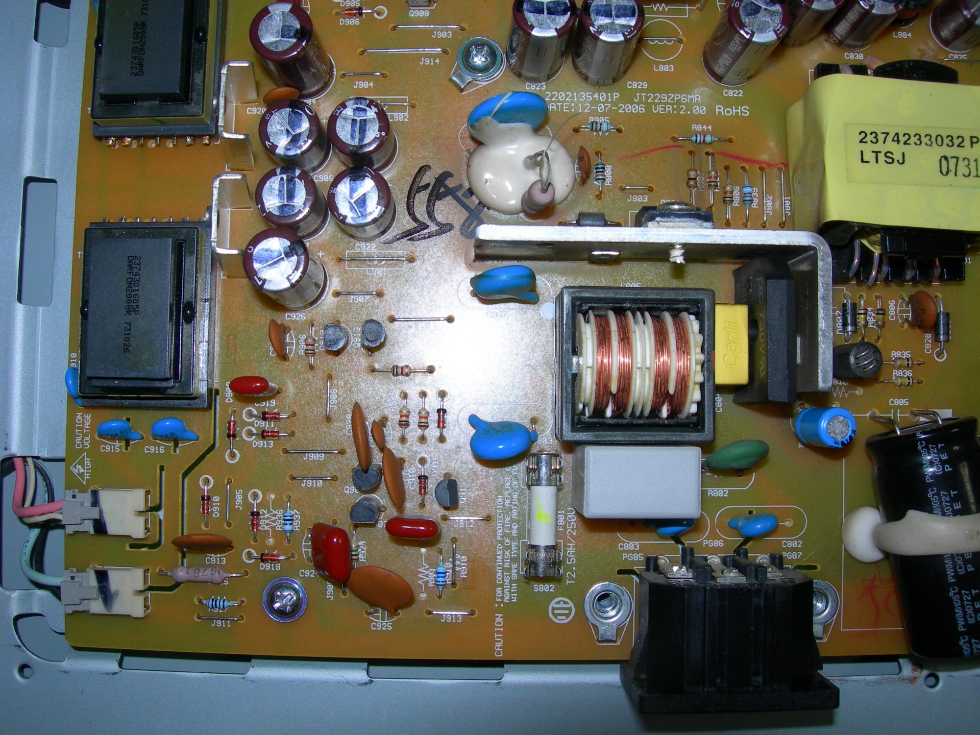

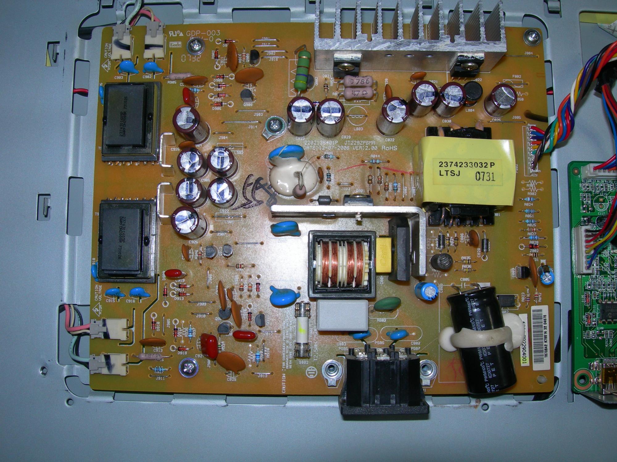

            Can you post a photo of the bottom of the power board? There may be some mosfets there that should be checked.
            • Sparks88
              • Sep 2011
              • 110
              Re: Hanns G HG216D flashing power button
              power section and inverter reverse side of board

                What are the part numbers of the 4 8-pin devices in your 2nd photo?
                • Sparks88
                  • Sep 2011
                  • 110
                  the 2 outer ones are stm6920 the 2 inner ones are stm4953, I801 is ld7575ps
                  • jetadm123
                    • 2169
                    The 6920 contains 2 n-channel mosfets and the 4953 contains 2 p-channel mosfets. Their datasheets can be found at alldatasheet.com
                    I suggest you try checking them for shorts. With your meter set to resistance, start with:
                    S1-G1
                    G1-D1
                    S1-D1
                    Do the same for:
                    S2-G2
                    G2-D2
                    S2-D2
                    Perform these tests for all 4 chips and post your readings.
                    • Sparks88
                      • Sep 2011
                      • 110
                      all readings are consistently high and no shorts measured across any ic's
                      • jetadm123
                        • 2169

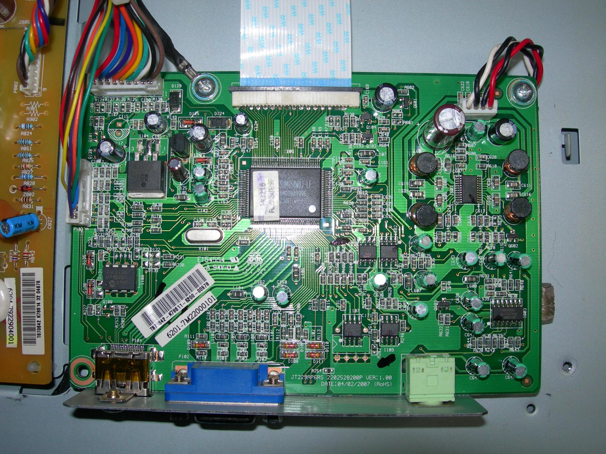

                        At this point, I don't see recapping the power/inverter board will do any good, since your getting voltage output for the inverter section and the signal/logic card.
                        The problem lies with the signal card. Since you think that there's a ticking sound comming from that card, it might possibly indicate a bad capacitor. Try listening for the sound using a cardboard tube from a roll of paper towels. As another test, use a hair dryer to heat up the caps on the signal card to see if that makes any difference.

                            when i disconnect the power board from the logic board i get a white screen, i did not leave it too long as i was worried in case i might damage the inverter/lcd section.

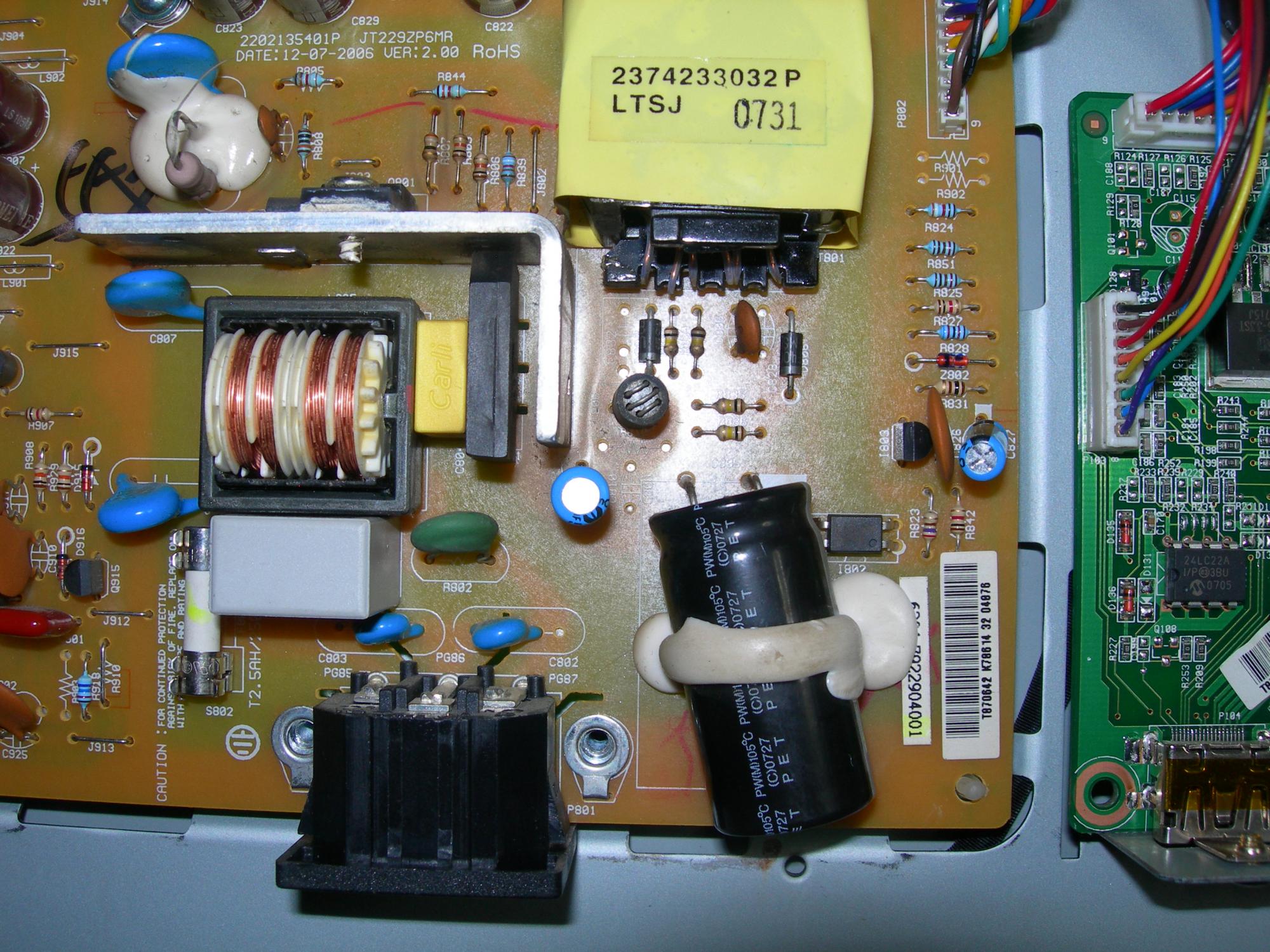

                            Today i took a longer look and the ticking noise is actually coming from the mains input side of the power supply from the area of the optocoupler/main dc cap and if i disconnect the logic board the ticking changes to a very faint buzzing, disconnecting the lcd ribbon does not change anything from the original fault, i have looked over the logic board with a big illuminated magnifier but there isn't anything obvious, i have ordered a esr meter from portugal so when it arrives i will be able to test further as this is turning into a epic battle which i dont want to lose just on principle and i thank everybody for the help they are offering.
