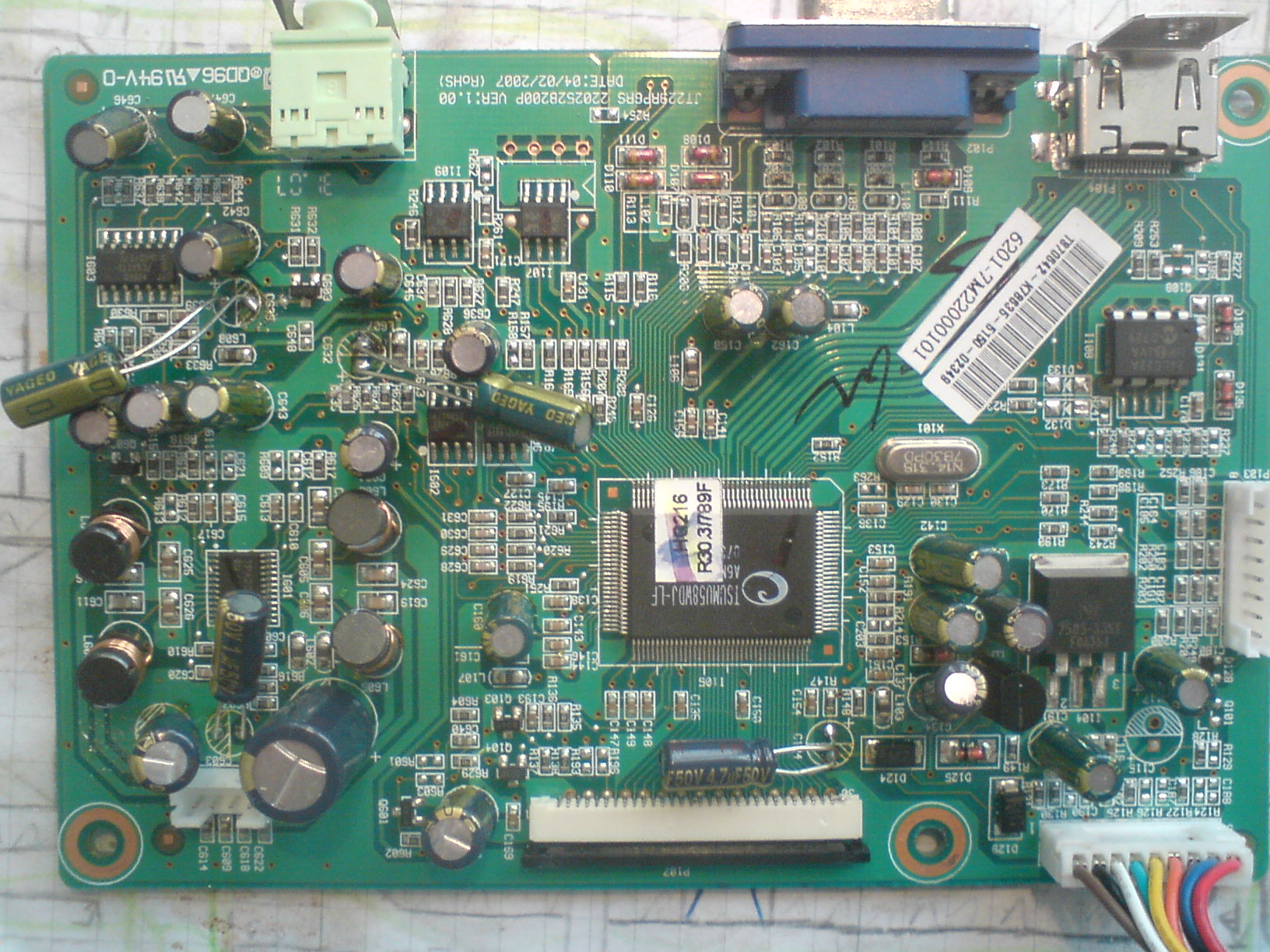

                        I replaced all electrolytic capacitors on both boards now, but it didn't do anything. Symptoms are still as mentioned above.
                        The only difference I could find is that I do not get a 3,9 V AC Voltage at Pin 1 of the Power Board-Logic Board connector.
                        Furthermore I hear a repeating short noise from the big cap C805 that sounds like a loading capacitor - again and agein. I hope that is understandable.
                        Any idea what I could do?
                        As a notice: Since I'm in Germany, I've got 230 V AC input.

                              Re: Hanns G HG216D flashing power button
                              First: Thanks so far.
                              I'll try to answer all additional questions as good as I can.
                              Pictures: Both boards originally looked exactly as seen on the photos in the first post. Since I have altered the caps, I cannot provide photos of the Boards in their original state.
                              Furthermore, I have no High-Res Camera at hand, but I'll try to borrow one. I assure you, that I didn't alter anything except the caps.
                              Summary of the Problem: I got monitor already nonfunctional (for free). The screen stays black, the power LED flashes rapidly as soon as power is connected. No other response.
                              When I disconnected the logic-board from the power-board, I got an all white screen.
                              All voltages on the boards seemed okay in relation to the test mentioned in this thread, except that I have around 300 V on C805, which is, I think, due to my 230V AC input.
                              I heard a very faint clicking noise from the logic board, which I do not hear anymore.
                              Pins:
                              pin 1 no dc volts but 3.6v ac
                              pin 2 2.9v dc
                              pin 3 low voltage pulsing in time with front power led about .8v dc
                              pin 4 5v dc
                              pin 5 5v dc
                              pin 6 0v
                              pin 7 0v
                              pin 8 5v dc
                              pin 9 0v
                              The Pin numbers above are the ones of the logic board, the numbers on the power-board are vice versa.
                              My pin 1 on the logic board measure around 1V AC, but even the ground-to-air measured around 1V AC, I didn't think it was important, but maybe it is? If I remember correctly, I got the "correct" voltage before I changed the caps.
                              Noise at C805:
                              If that wasn't clear: C805 was not changed. It the voltages there was ok, and it dicharged as slowly as it should when I diconneted the power. I didn't change it because it was said, that this cap was not likely to fail, it's quite expensive compared to the other ones and it seemed to work fine.
                              I think I heard that noise before, but to be honest, I'm not completely sure. I thought this would be easily repaired, so I didn't pay much attention.
                              Caps used:
                              I used the Panasonic FC series mostly, some caps for the logic board were not available and I used Yageo SC. I tried to use the exact matches concerning to voltage and capacity.
                              Soldering: Although I had some problems installing the new caps on the logic board (and I looks awful), I tested every single connection, and they were fine. I didn't see any other damaged connections. I checked all caps three times for the right polarity, I know how dangerous it is to connect them the wrong way round.
                              Board discription: I'm not sure what you hope to see, there are only numbers as discribed above, nothing more.
                              I'll try to get some addional pics, If you still need them.
                              Any suggestion is welcome!

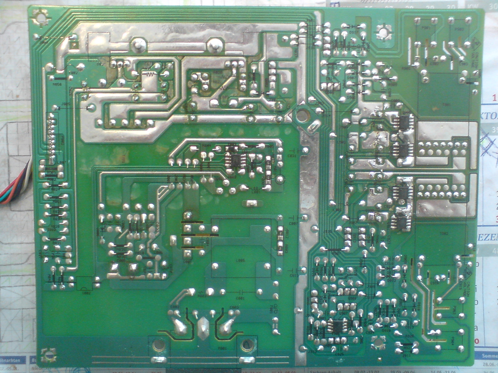

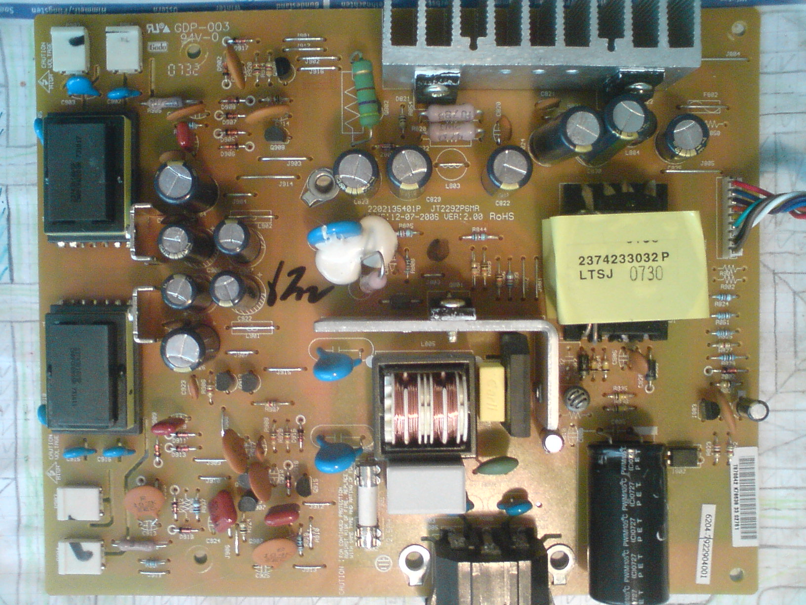

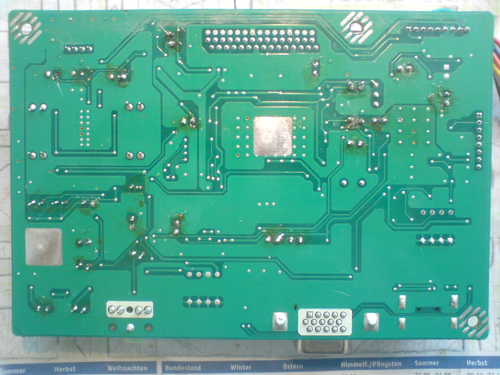

                                      Alright, I made some photos with my mobile phone.
                                      They're better than I expected, I hope you can see enough.
                                      The logic-board looks terrible, I know, my bad. But I assure you, there is no visible collateral damage to other parts, all contacts seem to really contact and there are no shortcuts any more. But there could have been, because some pins could have contacted the monitor's housing when I powered it the first time after recapping.
                                          If your mains voltage is 230V AC, then the DC voltage across the large filter capacitor should be
                                          230 x 1.414 = 325V DC.
                                          It is likely your monitor uses PFC
                                          http://en.wikipedia.org/wiki/Power_factor
                                          If yes, then it should be closer to 400V DC at the large filter cap.
                                          At the logic board, all the voltages used for normal operation are DC.
                                          Some of those caps on the main board that are not sitting flush looks really bad. I suggest using a stainless steel needle and getting the holes cleared out so the caps sit flush and make sold mechanical contact with the board.
