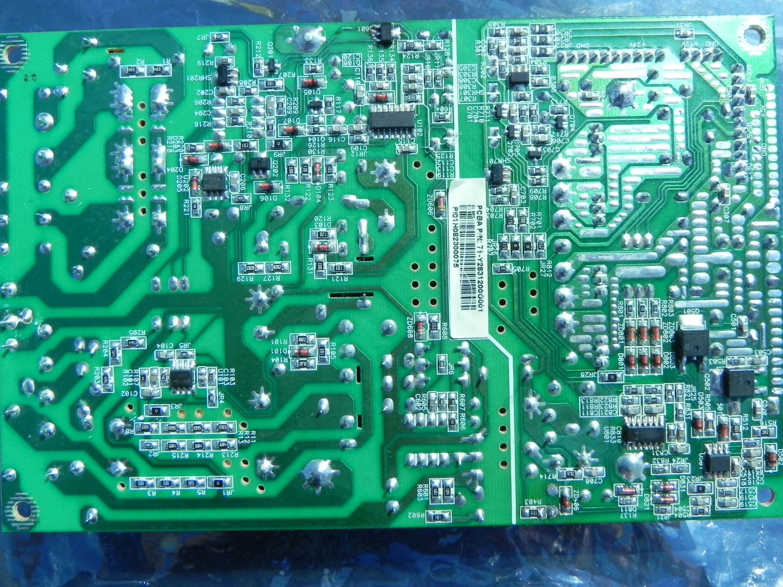

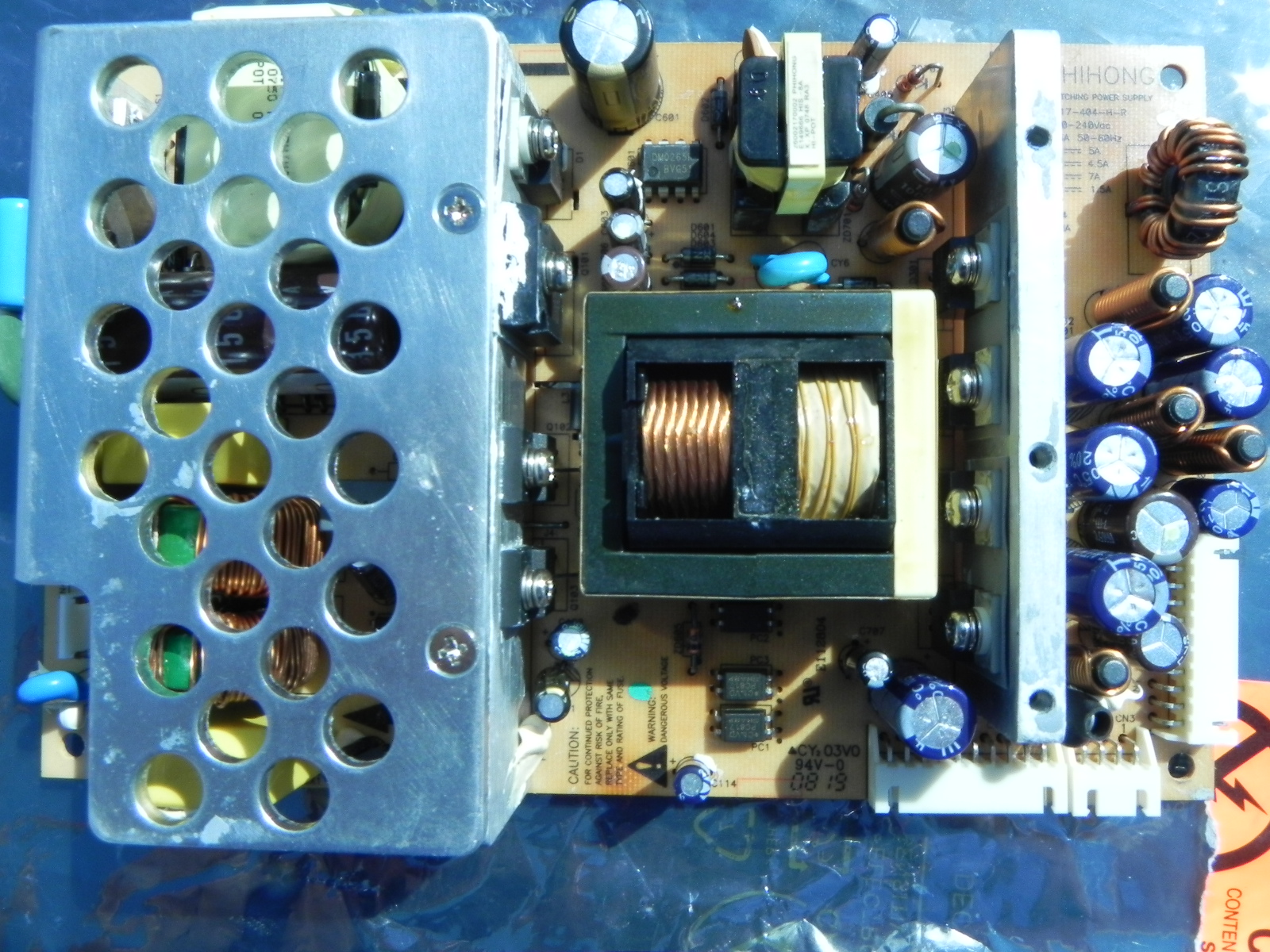

                                  I am having similar trouble with this board, I have already used a cap repair kit. There is no blue led in front, and there is no 5v during standby (with or without the video board).
                                  Any help would be appreciated.
                                    The same thing we tell everybody else. Take good, well lit, sharp pictures of the top and bottom of the power supply board. Attach them to your next post using 'manage attachments' - below the text entry area.
                                    Also, a brief history of the problem would be helpful.
                                    PlainBill

                                      Unfortunately I don't have too many details about the monitor, it was going to be recycled at my job. When I first looked at the power supply there was no bulging or leaking caps that I could see, but since I found so many repair kits online I decided to give it a shot. All the blue caps are my new ones from nte.
                                      Any input would be appreciated
                                      Jason
                                        Jason
                                        The first mistake. NTE caps are overpriced, and do not have the low ESR characteristics required for this application. At a rough guess, you could have bought the caps to completely recap this power supply for $15 - $20 (including shipping) from DigiKey.
                                        The second mistake is some caps were not replaced. These can cause problems.
                                        There is an 8 pin IC on the top of the board, U601. The pin in the lower left corner is pin 1, pins are numbered counter-clockwise. Using pin 1 as ground, what are the voltages on pins 2 and 5?
                                        In the upper right corner of the picture of the bottom side of the board is the connector to the signal card. Using the bare metal around the mounting hole in the upper right corner of the board as ground, what are the voltages on each pin of that connector?
