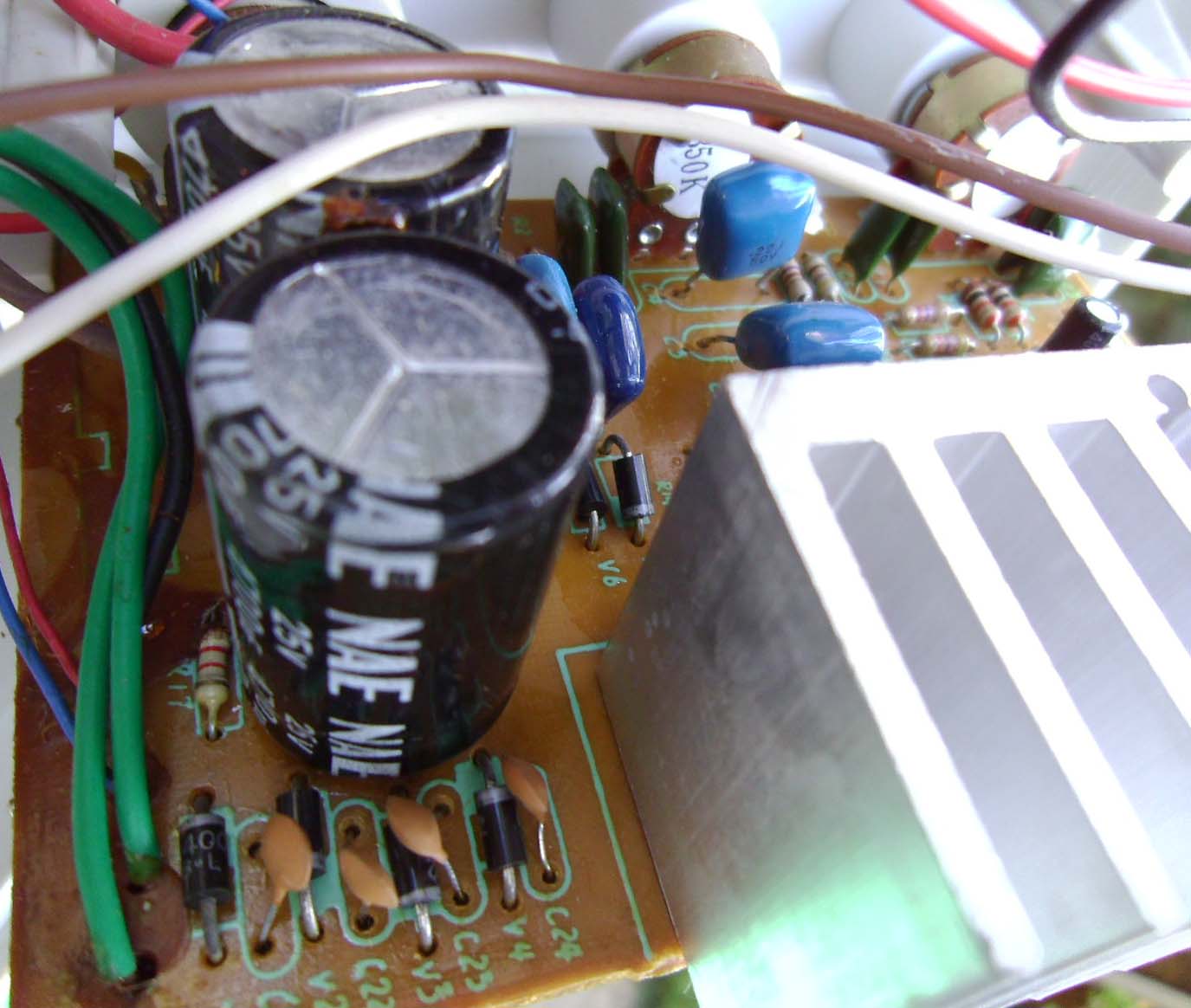

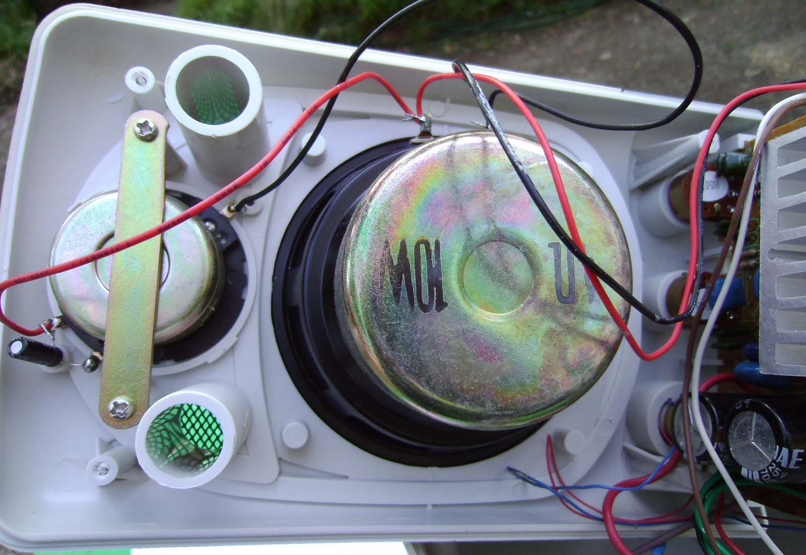

    I've had these brand X speakers for >20 years - great sound, thought they were worth hanging onto
    But they've been developing a bad hum, which has been getting worse, until now it overpowers the sound
    Would replacing any or all of its six capacitors maybe fix the problem ?
    - 4700uf 25v - two of
    - 33uf 16v - two of
    - 1uf 63v - two of

    I would look at the Power Supply section and change-out the big e-caps.....Yes probably those 2 e-caps 4700uf 25V are the problem....
      • 31111
      Re: Computer speakers - fixing hum
      change the lot.

        Also check for bad solder joints on the input jacks.
        +1
        Though, you might as well change all of the other electrolytic caps then, as stj suggested. They won't be nearly as expensive as the two 4700 uF 25V units.
        Another thing worth mentioning is that, depending on the output voltage of the transformer, you may use a linear regulator to feed the amplifier. When you do that, this should eliminate pretty much all of the hum. Something like a 7812, 7815, or 317 (adjustable) should be fine, so long as you put a proper heatsink on it and don't exceed its specs. But this suggestion is perhaps more fitting if you like playing with amps an audio gear.

                          I replaced all six caps with:
                          - 4700uf 25v - Nichicon PW
                          - 33uf 16v - Rubycon YK
                          - 1uf 63v - Panasonic EB

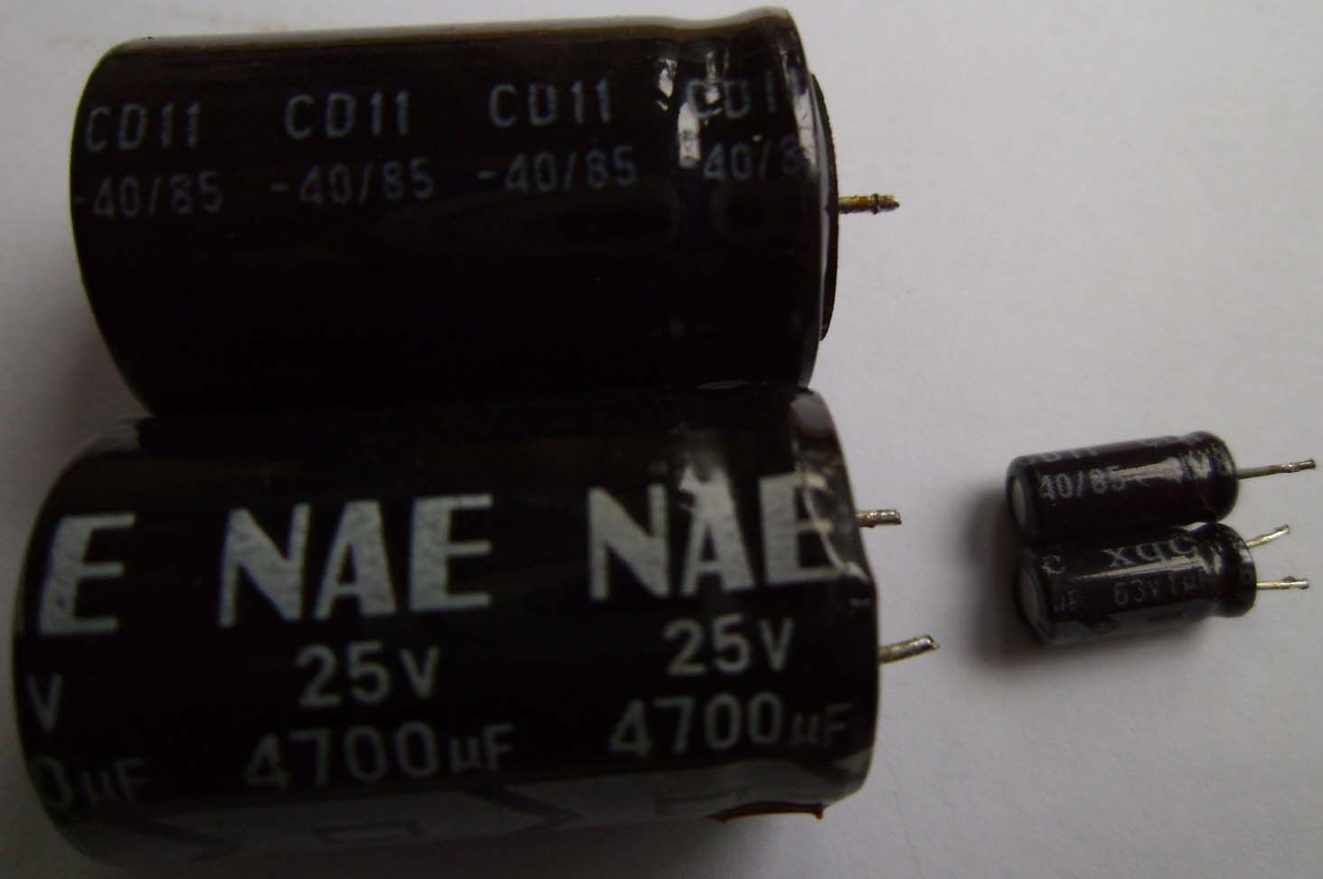

                          I reckon they're all genuine, otherwise pretty convincing fakes - and all tested OK on Banggood kit Transistor Tester
                          FWIW, both old 4700uf & one 33uf tested as "No, Unknown or Damaged"
                          All the old ones were marked 85 - but no way did I buy those speakers in 1985, more like 1995
                          And the outcome - no more hum and clear as a bell
                          My thanks to everyone who contributed
                            85 is the temperature rating in C.
                            Nice fix BTW.
                              Full disclosure:
                              I assumed 40/85 was a date, but maybe it's tolerance/temperature
                              better to keep quiet and be thought a fool, than to open your mouth and remove all doubt
                              • Per Hansson
                                • Jul 2005
                                • 5895
                                • Sweden
                                No it's temperature rating.
                                From -40°C to +85°C
                                CD11 is the datecode
                                  Wow, even the 4700 uF units tested open?!?!
                                  Those are some seriously crappy caps then.
                                  Nice job on the fix. Those Nichicon PW caps should not give you any trouble for at least the next 15 years (I'd say at least 25, though).
