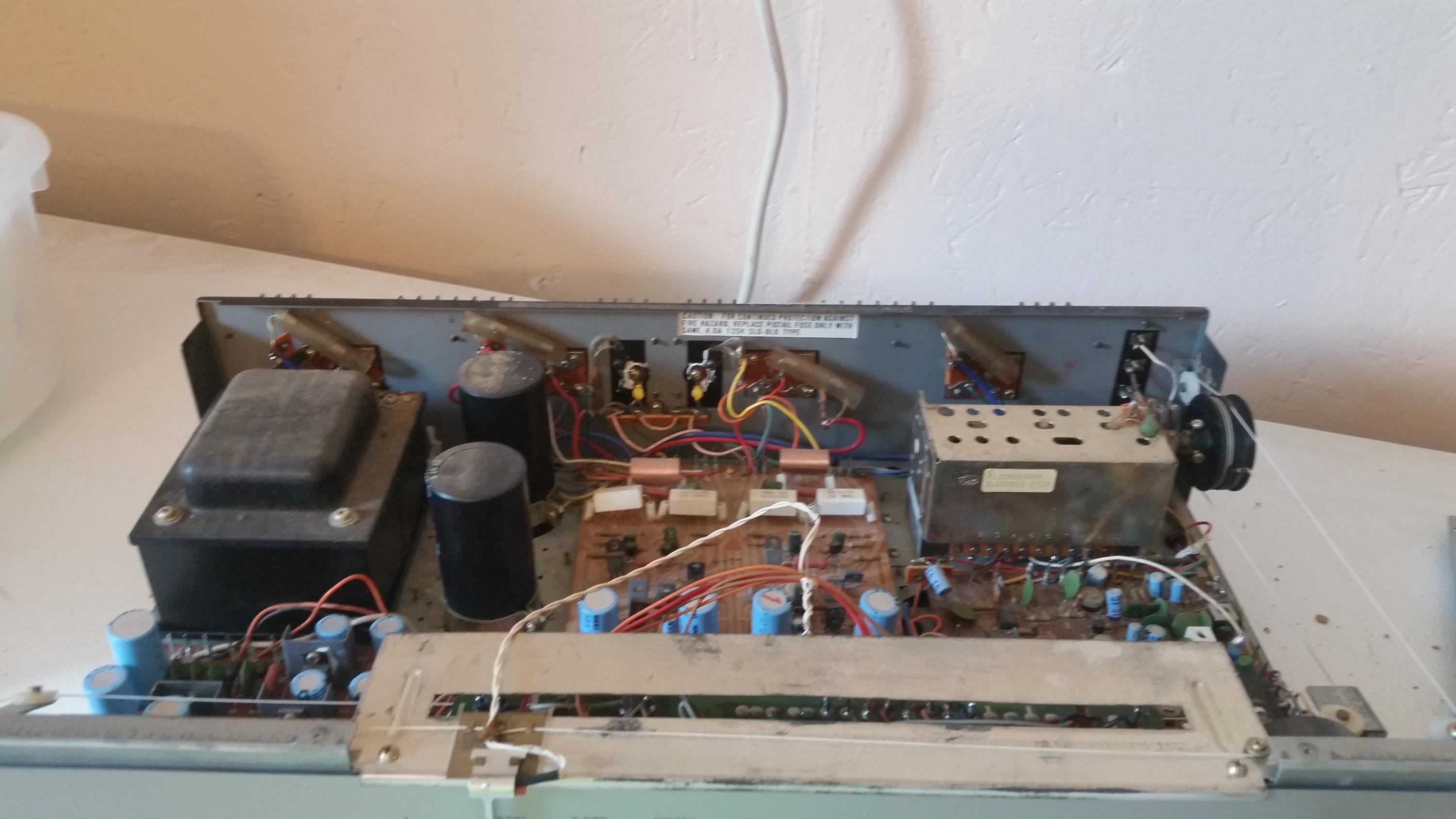

    Hi all. Yesterday, I got a load of old electronics and all but this Fisher RS-1056 work. The stereo receiver is very dirty and a dirt dobber was found in it, along with some other bugs, and it appears to be from the 70s. Here, let me attach some photos:
    I have no variac, so no slow controlled powerup, and I also do not have an ammeter, so no way to measure current draw. It has no blown fuses, and I just want to see this thing work. SOME caps are of Japanese orgins, but there are these unknown quality 'SHOEI' caps. There are no blown and/or bulging caps.
    Also, I am wondering how rare this particular unit is. Please help. Thanks.

    Be brave it can only go bang right
    Probably needs few parts replacing too, maybe use like a 100w light bulb in series with the Ac input to limit current ?

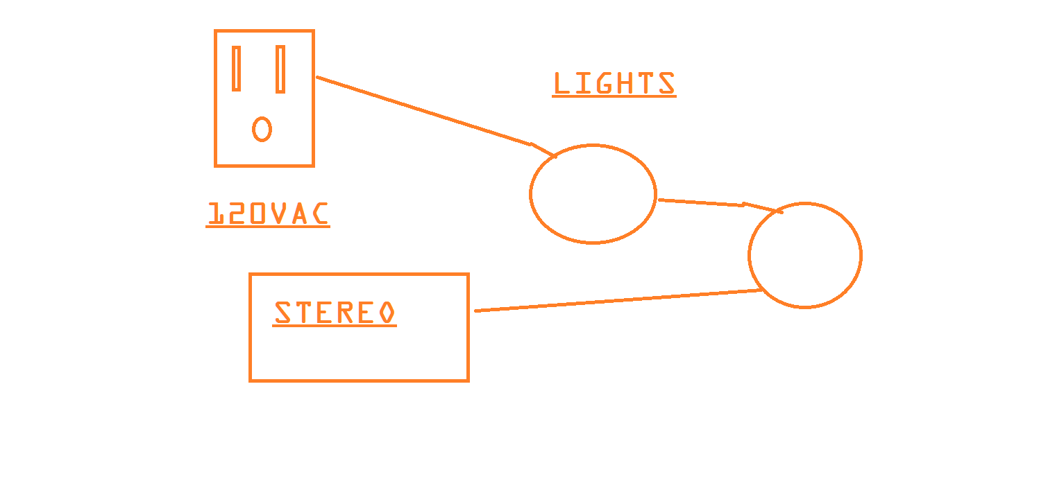

      more wattage=more current limiting capacity? I could series-string 2 60 watt bulbs for 120 watt load. Where would I hook up the load? In series with the bulbs?

        Higher wattage, less resistance. So put in the 60W and good is.
        I just would do a visual check over, check the bridge rectifier and the output diodes on the PSU. Other than that, turn it on and see what happens. I had a pre driver fail after the unit ran for 3 minutes. So who knows. Don't be shy. When you turn it on, make sure to measure if you find DC on the speaker outputs. Not sure if this thing has protection (relay click) or not.

          I said 100 as there would hopefully be more of a drop on the input hopefully help as much as possible just to get the caps energised a little. Also yeah 60 should be fine though if you only have em on hand see what it does, never know it might work
          However the caps will need to be changed in good time as they are old.

                If you feel lucky. I've done it plenty of times with 40-50+ year old receivers/radios (just plugged them in an hit the switch), but there is always the possibility it could go bang and/or release the magic blue smoke.
                Looks like RS-1056s are going for between $50-175 on eBay depending on condition, so it has some value, but isn't exceptionally valuable (probably about average for a quality 90WPC receiver from that time period), so there isn't a ton of risk in doing this. (If you want your head to explode look at what Marantz 2270/2275s are selling for, a good one with a wood case can sell for $1k+ and even non working they can go for $300+)

                                You can use 60 Watt lamp for now, or use two 60W in PARALLEL to give 120 W.

                                  That's a big myth. A Variac doesn't limit current. How would it? It's nothing but a variable autoformer- a dead short on its output will pull excess current even with the knob way down.
                                  IOW, even with a Variac, you still use a "dim bulb." Try a 40W lamp in series with the line, and verify all power supply voltages begin to come up. Then a 60W, 75. The amp should be working at this point- check across emitter resistors for excessive voltage= means amp bias "ran away." Fix this before larger lamp or full line voltage.
                                  DC offset should be below 250mV at the point amp comes up on reduced voltage. Some had more offset at reduced voltage- long tailed pair isn't quite symmetrical at this point. If offset minimal, a larger lamp/higher voltage should make DC offset decrease.
                                  If there are offset and bias pots, clean them! A bad bias pot can take the output/driver transistors out, as well as other components. A set of four Motorola/Onsemi 2119x is about $20.

                                    Since no silicons are shorted , fuses are okay , then why not ..Capacitors , if dried , will show different symptoms , but not much more than the fuse can handle .
                                    Those Fisher were something , Akai are better , and the twos were formidable if equipped with JBL's , the good old days .

                                      How do I check transistors for shorts and/or rectifiers? The output diodes on the PSU are far from shorted, one reads almost 200K resistance.

                                        A regular diode would pass the voltage one way and block it the other way , put your DMM on Diode level , and test diodes in the PS . Rectifiers are primarily diodes , like one rectifier is composed from 4 diodes typically , so you measure rectifiers like a 4 diodes measuring ..
                                        Note that some diodes could give erroneous measures on board if it's relayed with some resistance . In such case , you have to remove one leg of the diode .
