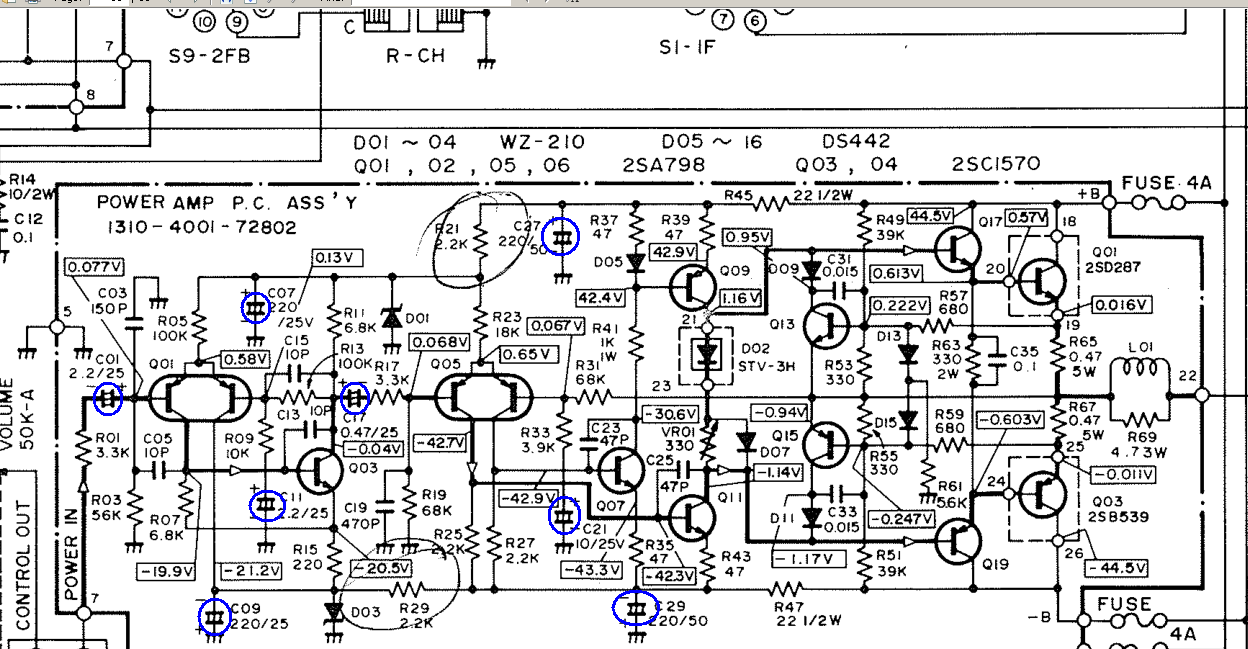

                                If DC comes into the amp driver boards from other questionable caps further back, like in the tone controls and preamp, the power amp will amplify this DC if the input coupling caps (on driver boards) are leaky.

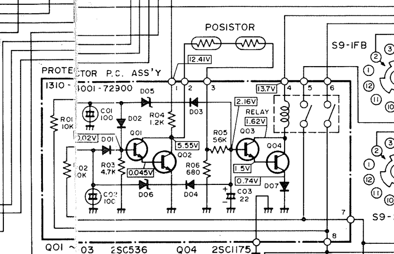

                                You do NOT want to amplify DC and send it to the speakers; yes the prot ckt should pick this up, but you see those non polar lytics on the board with the relay? IF those non polar caps in the protection ckt are also leaky, the prot ckt won't pick up til the DC at the spkr terminals is higher than it would otherwise be.
                                If the non polar caps on the prot board are shorted, it won't drop the spkr relay even with full DC on the output(s)!
                                Also, for driving the "high side" of the power amp, there's either a discrete constant-current source or a "boostrap" network with an electrolytic (100-470u, 35-63V typically) and two resistors. If the cap opens up, the high side of the amp is poorly AC driven- you get distortion. If the cap shorts and depending on the bias chain, the output transistors can be over- or asymmetrically biased.
                                If it were mine, I'd change the caps indicated in the power amp. I've shown one channel; you've got twice as many to change as the attached image shows. Also replace all the lytics on the prot relay board. Clean the bias pots (VR01 and compliment on the other channel)- if dirty or open, full bias is applied to the output transistors. This unit was from before the pots were wired such that an open was "failsafed" against. Bias current is obtained from a discrete CCS; no bootstrap ckt or cap in this one.

                                  I checked for DC on the outputs of A, B, and C, and I saw as high as 6VDC at full volume, one connection only. The protection circuit cut the outputs for a 1/4 second, brought the outputs back up and didn't bother to cut them out again. So it needs recapping?
                                    Three things need recapping.
                                    The DC protect relay board (not dropping out, even with DC on the outputs)
                                    The amp, because there are small caps which can upset the center points of both long-tailed pairs. Each dual-transistor, near the input, is an LTP, each with input and feedback nodes.
                                    The "low level" preamp-tone ctl board, which is putting DC into the power amp. There's leakage from one or more caps, leading to DC at the top of the volume control, which explains why it varies when you turn that pot. I have a Sansui 881 which did the very same thing, before I recapped it. You'd turn the vol pot UP, spkr cones moved out. Turn the vol pot down, from mid-range, the cones sucked IN. Don't worry, I used junk speakers.
                                    To verify the DC is getting into the amp via the preamp, remove the two "Control Out->Power Amp In" jumpers in the back of the unit. That ~6V should vanish. You noticed one channel gave 6V, but the other did not; the one that's dumping DC corresponds to that preamp channel with the offset.
                                    The output channels come into the prot board via R01 and R02 (10k). The audio is shunted by two 100u nonpolar caps (C01, C02); any remaining DC is supposed charge these up and trigger the Darlington-connected transistor pair (Q01-Q02); anytime DC is present on the spkr outputs, this shunts drive to the relay drivers Q03-Q04 dropping the speakers.
                                    C03 is part of a time delay that causes the relay to close some time after AC power is switched on. If leaky, the relay never closes (also happened on my Sansui); if open, you lose the delay-close.
                                    Looking at the R-C ratios in the triple tone control, they're pretty typical for better sounding Japanese tone ctls. Quite similar to my Sansui (again), you'll like the way it sounds, even if you're a "basshead." You've also got the loudness control... Judging by the B+/- voltages and size of the transformer, it's an easy 60-65WPC.
