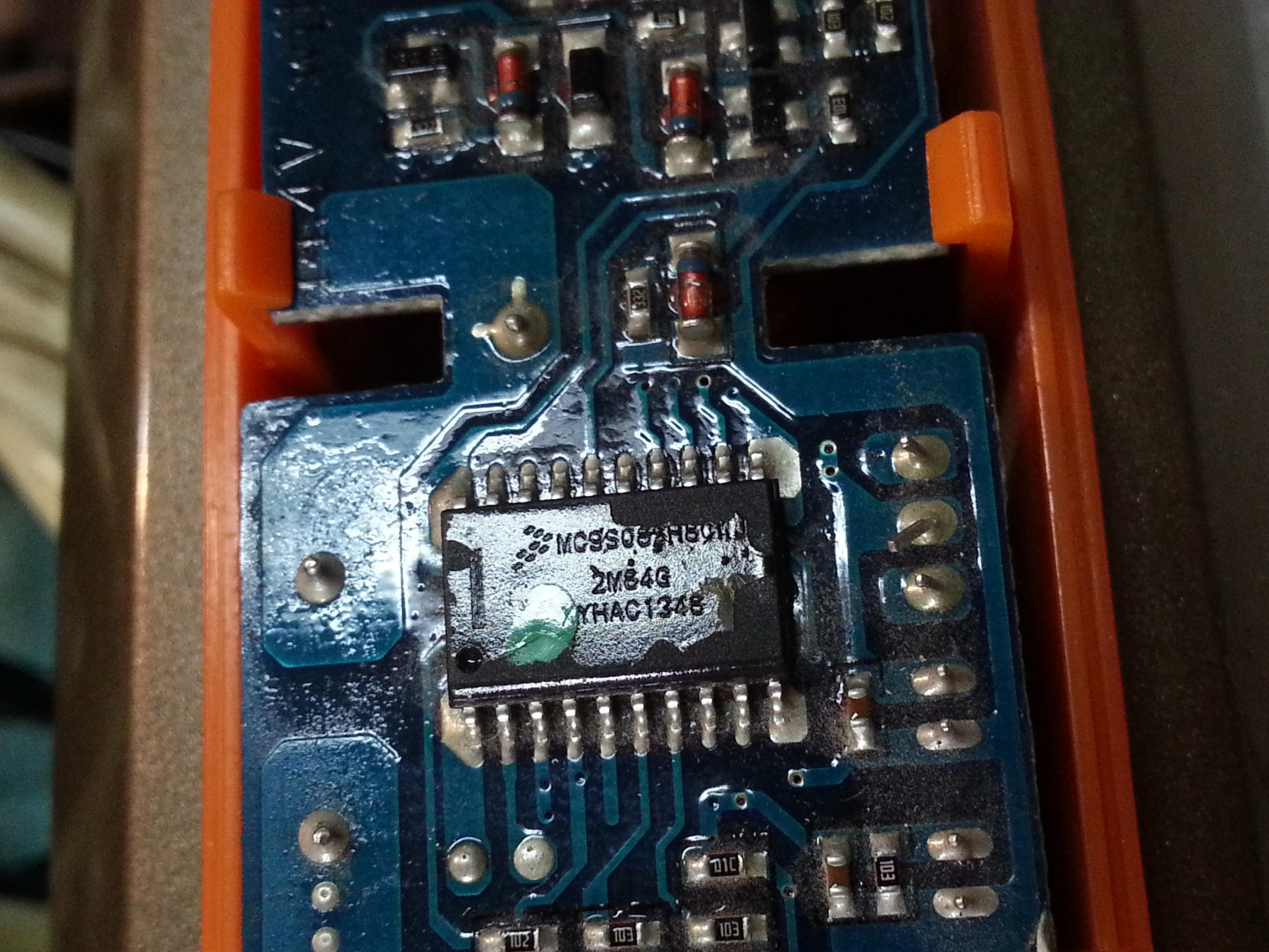

                Ok guys update: so my brilliant co-worker, who is a genius (he is ! a ge-ge-ge-ge-genius ) came back to this vac which he set aside for a few days and is still trying to hack the charger portion, which is probably a good idea at its roots, but not as easy to pull off with such a complex circuit in practice.
                According to him, he discovered the batteries are being overcharged to 20v or something and that's what kills them....which is true - LiIons certainly don't take to overvolting as kindly as say SLAs do, so it's plausible, but adapting a circuit designed for NiMhs to charge LiIons is tough or maybe impossible IMO (and might be called a complete waste of time in the long run)...
                Wattevah...

                  Not really if you take out the charging controller board that is in there now and replace it with a battery charger controller board that is made for the type of battery that you want to use you can find them on eBay

                    Yeah, but he's trying to do it "as is" with what's already in there, that's the catch

                        UPDATE: here's the IC at last: a MC9s08sh8, so it's like a "computer" in there, making the job even harder, since it's likely going to do "UVLO" if he tries to modify just the incoming adapter voltage in an attempt to decrease the charge voltage, or sense any number of different things. "Charge voltage" is a bit of a misnomer in this case, since it's not the sole factor - CURRENT is just as important of course...

                              UPDATE: the solution ? Tell the client to simply not to leave it plugged in for charging more than 6 hours

                                    A fairly easy alternative method would have also been to rip out the charging circuit and build a simple LM317 voltage reg circuit and put a resistor to the Li-Ion cells for current limit, so that the reg circuit doesn't burn out when the batts are low and charging.
                                    This "solution" of course still wouldn't address the batteries from over-discharging. But with a few MOSFETs/transistors, Zeners, and possibly a 358 op-amp, you could design a very crude shut-off circuit. But I imagine all of that is way over your "pal's" head.
                                    Come to think of it, he should have just put a long cord on the vacuum and wired the motor straight to AC. Then tell the customer, when you want to use it, just plug it in.

                                      Now about the circuit: it's actually not possible to "remove" the charge circuit by ITSELF, at least not with extensive mods, since the "system control" is part of that board I pictured in the handle and it's required for speed control, on/off and other functions. It's got a 1-button, 3-speed setting on it, as well as control for the roller brushes, so all those would be lost along with the board unless you have a lot of time on your hands to emulate those functions again.
