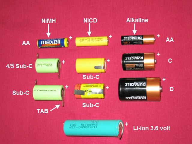

        I have a similar problem... an old vacuum cleaner that uses three sub-C NiCds and they're shot... The vacuum cleaner draws 10+ amperes, and more than that during startup.
        What's the cheapest re-cell using any technology that can sustain that current...plus the fact that my tab welding equipment is nonexistent...
        Running 3xLi-ion in series is definitely a recipe for disaster, but fortunately three NiCd voltage is not too far off from 1-li-ion (or have them all in parallel), but getting a li-ion that can pass in excess of 10 amperes is pricey?

          Sub-C size is a real bear to find and NiCd are low capacity around 1,300-2,200mAh so I try fit AA NiMh which have more.

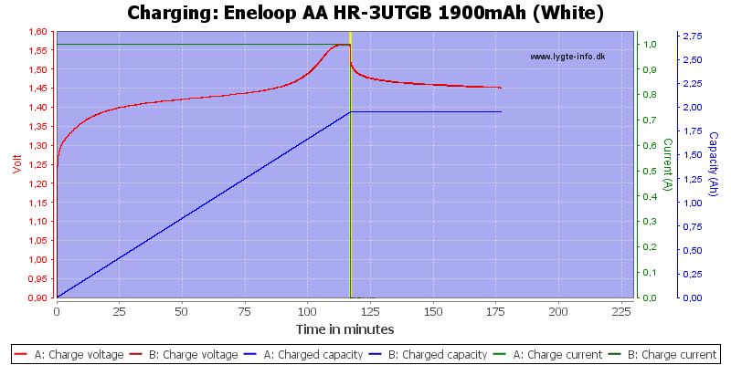

          Ikea Ladda batteries I find different than Eneloop Pro's. Charging to 1.50Vpc the Ladda's roasted at 1,000mA where the Eneloop Pro's back off. You can't fast charge Ladda's, it's written right on the cells.

            I think NiCd is the most forgiving for fast discharge, I think the vacuum cleaner is drawing at near 5C+ discharge rate for the original sub-C. If replacing with NiMH AA's I don't know if they can pass that much current repeatedly without damage.
            I tried a single 26650 li-ion cell and its protection board refused to power the vacuum. Hah. Figures...
              you may be comparing different generations of cells, there have been 4 generations of loops so far.
              i'll try to find the datasheets
              your over-charging them anyway - 1.5 is too high.

                  I replaced NiCd AA pack with Energizer, Eneloop, Eneloop Pro, Ladda AA NiMh batteries.
                  The problem is the NiMh pack loses capacity after a month ~20 cycles. It seems to be the charger's voltage is a bit low, the NiMh never get a "top off" charge and it does something to the batteries. Voltage depression happens and I constantly get low battery alerts.
                  If I manually charge to 1.50Vpc things are good for a few months; CC 500-1,000mA at most, and 100mA when it's at 1.50Vpc for 1/2 an hour to top up. I got that from the charging curves. The battery pack behaves for a few months.
                  But Ikea Ladda whites are not liking it at all. They get hot at 1.5Vpc while the previous Eneloops never did. Ladda 2450 says "standard charge 245mA for 16 hrs. Made in Japan".

                      The Lii-202 tests show going above 1.55Vpc and "With NiMH the charger turns off current to measure the voltage and will terminate on voltage without doing a top-off charge. This means the batteries will not be fully charged, but they are fairly close."
