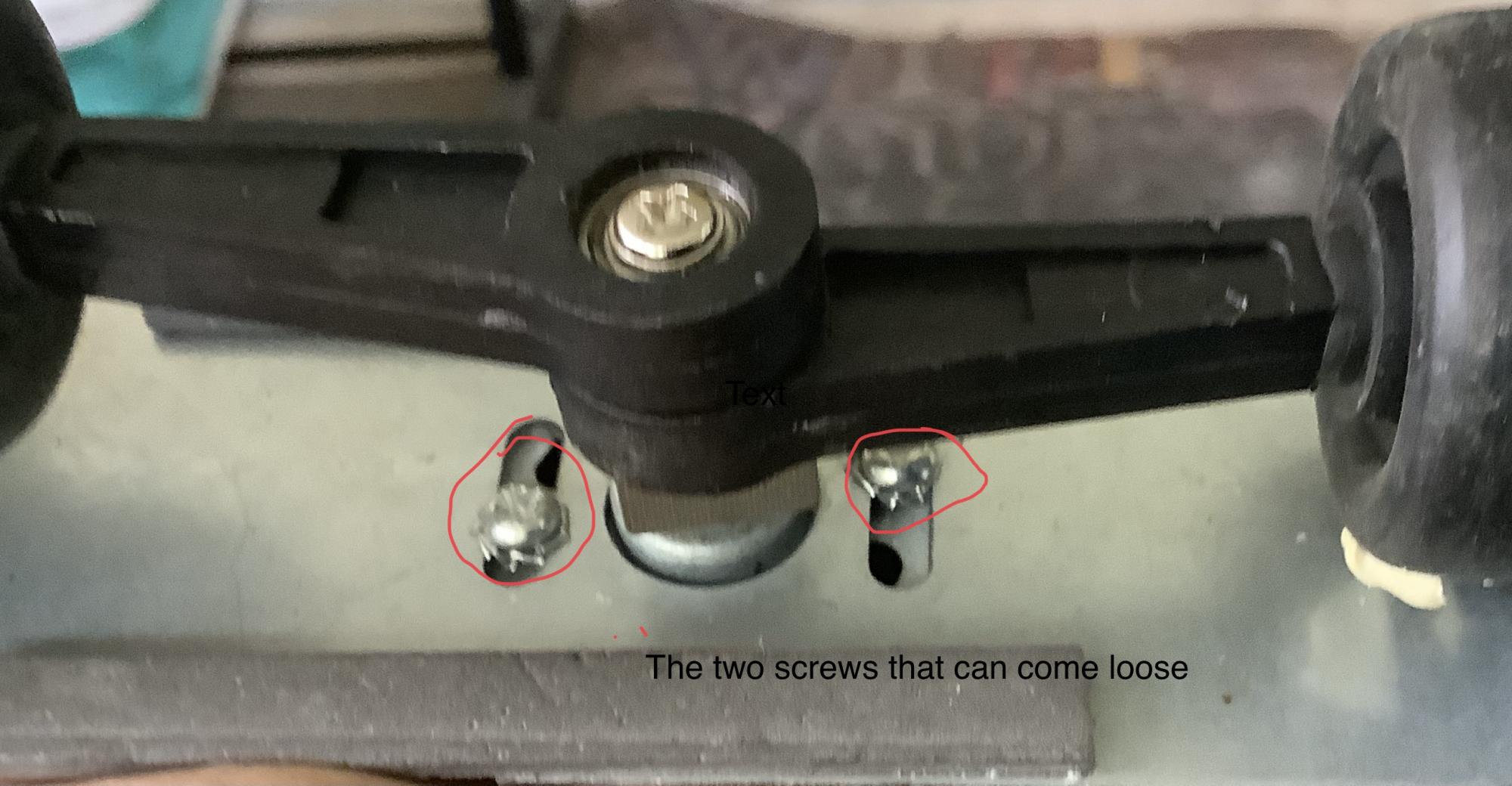

    If you have this Desoldering Gun Station there is something you should be aware of the two screws that hold the motor to mounting for pump can come loose and make raddling noise
    One note this unit has been repaired already once because of switching power supply regulator ic chip failure
    Now this with the vacuum motor mounting issue yes I give this Desoldering station a very hard work out and use about every weekend to do some type of project
    The fix is taking the vacuum pump assembly out and take the metal cover off and you will see the two screws on it
    One note if you are also having low vacuum suction from the pump it is serviceable to some extent
    This is how you determine if you have a low suction from the pump with a new tip and the temperature set 775*F and using a the smallest diameter tip it should be able to suck the solder from the tip open if not then you might want to service the vacuum pump
    Remove the two outer rubber cups and take the middle screw from the connecting rod that is in between the two cylinders and carefully pull the piston out from cylinder there is a flat washer and rubber “O”ring clean up both of them and put some very light grease on the metal washer and on “O” ring and reassemble the vacuum pump assembly and by hand rotate the connector rod several times to make sure it very easy to turn
    This should bring your vacuum pump back to useable state again it might not be as good as but very close

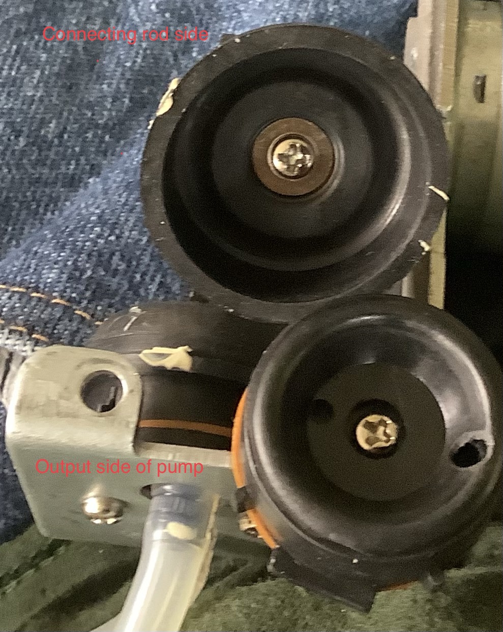

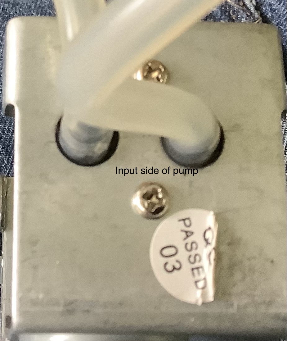

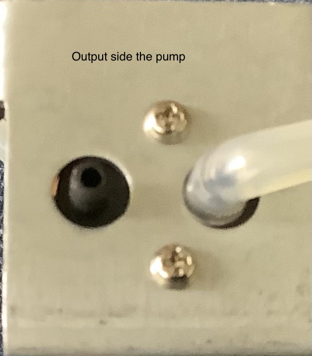

    Here are some pictures of the pump assembly
    When I was describing the inside of the pump I was thinking about another type of small pump I also have worked on this one is a little bit simpler with that said we will move on
    There are tie wraps on the suction cups that need to be replaced when do this because they are not pulled thigh enough and will work loose
    The suction cups screw needs to be removed and check the back of the screw and washer for rust if it has any it needs to be cleaned then reassemble this side
    The side is made out of plastic and also has on screw which also need to be removed and check to see that are no rough edges on the two holes if there any clean them so they are flat reassembly this side
    Then reassemble the two halves and reinstall pump back on the metal frame then do the other side
    Once you done both side of the pump assembly then it time to turn on the pump and test it at 12 volts you should have a good vacuum from the pump and you should see the suction cups move when you put your finger on the suction tube and then see it move back when you release it you need to look at both sides that is end of servicing of vacuum pump you should have gotten better suction from the pump after servicing it
