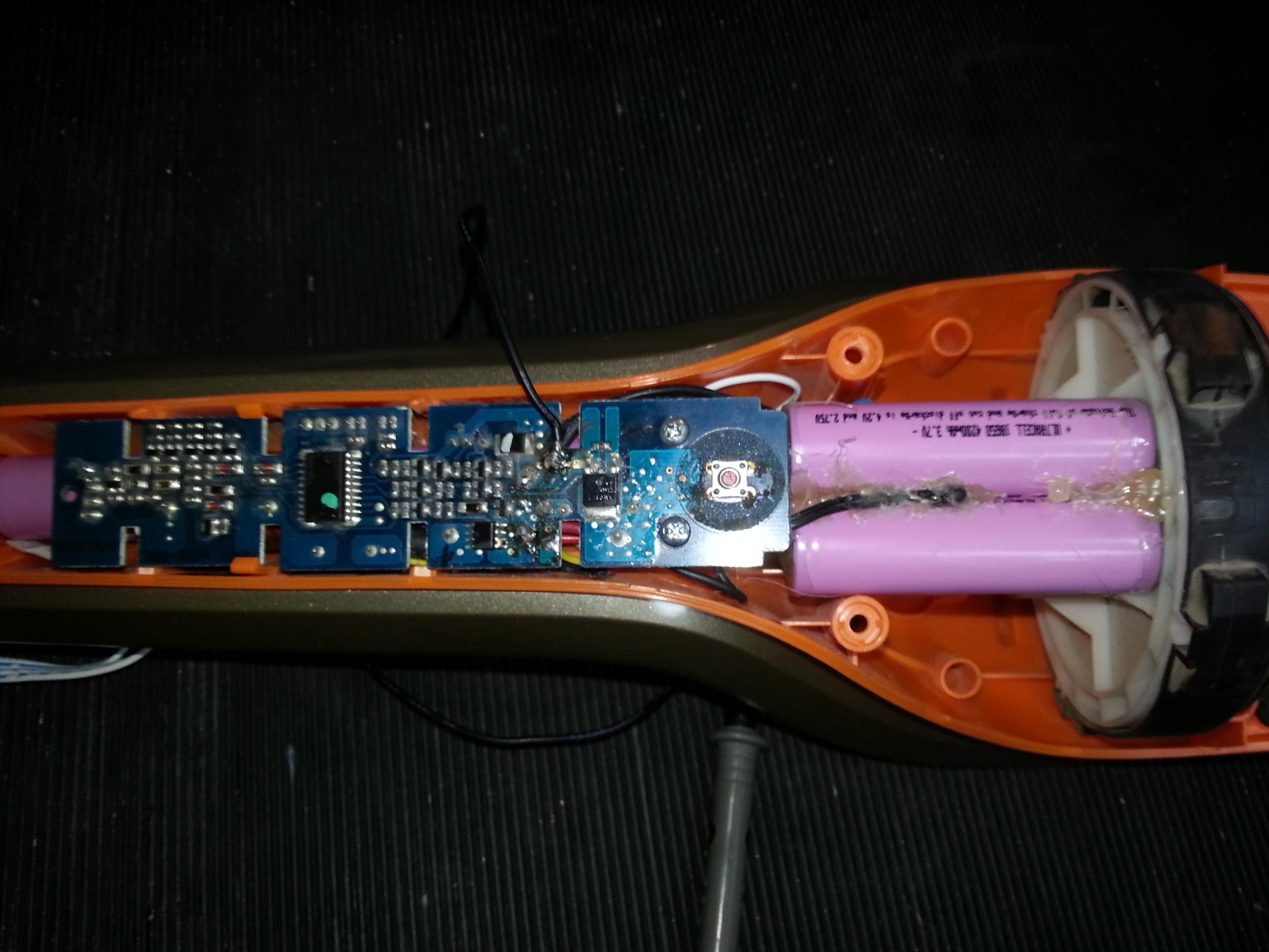

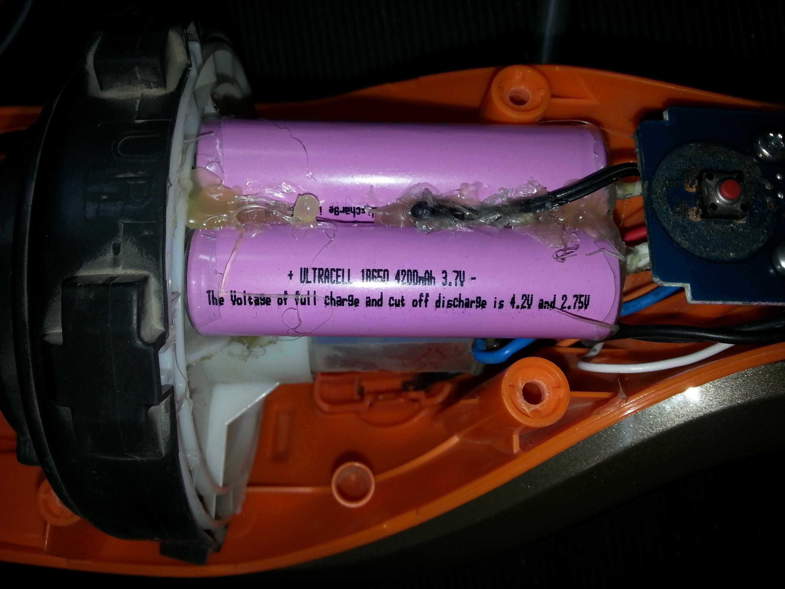

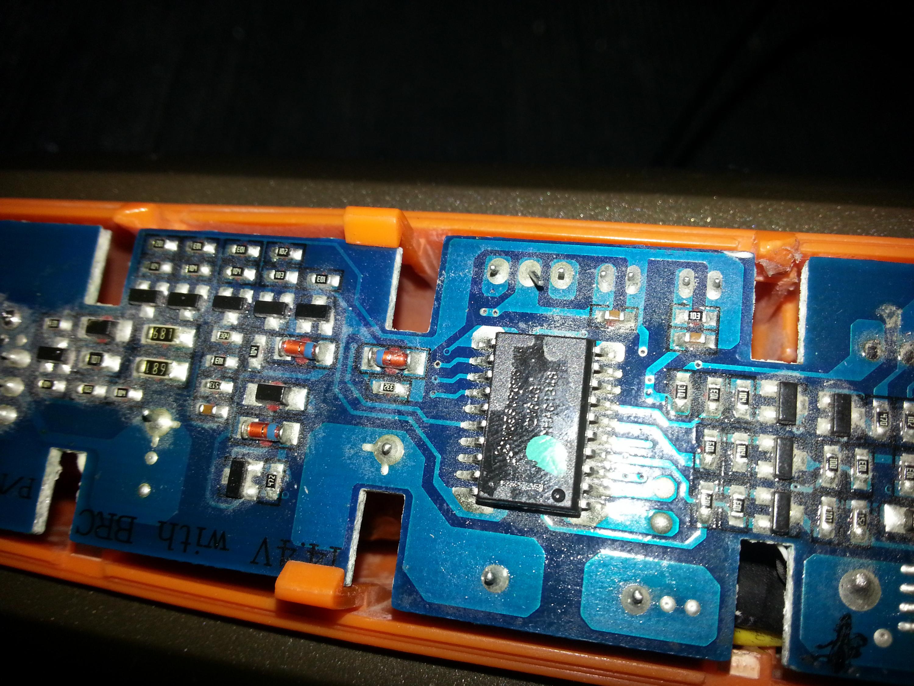

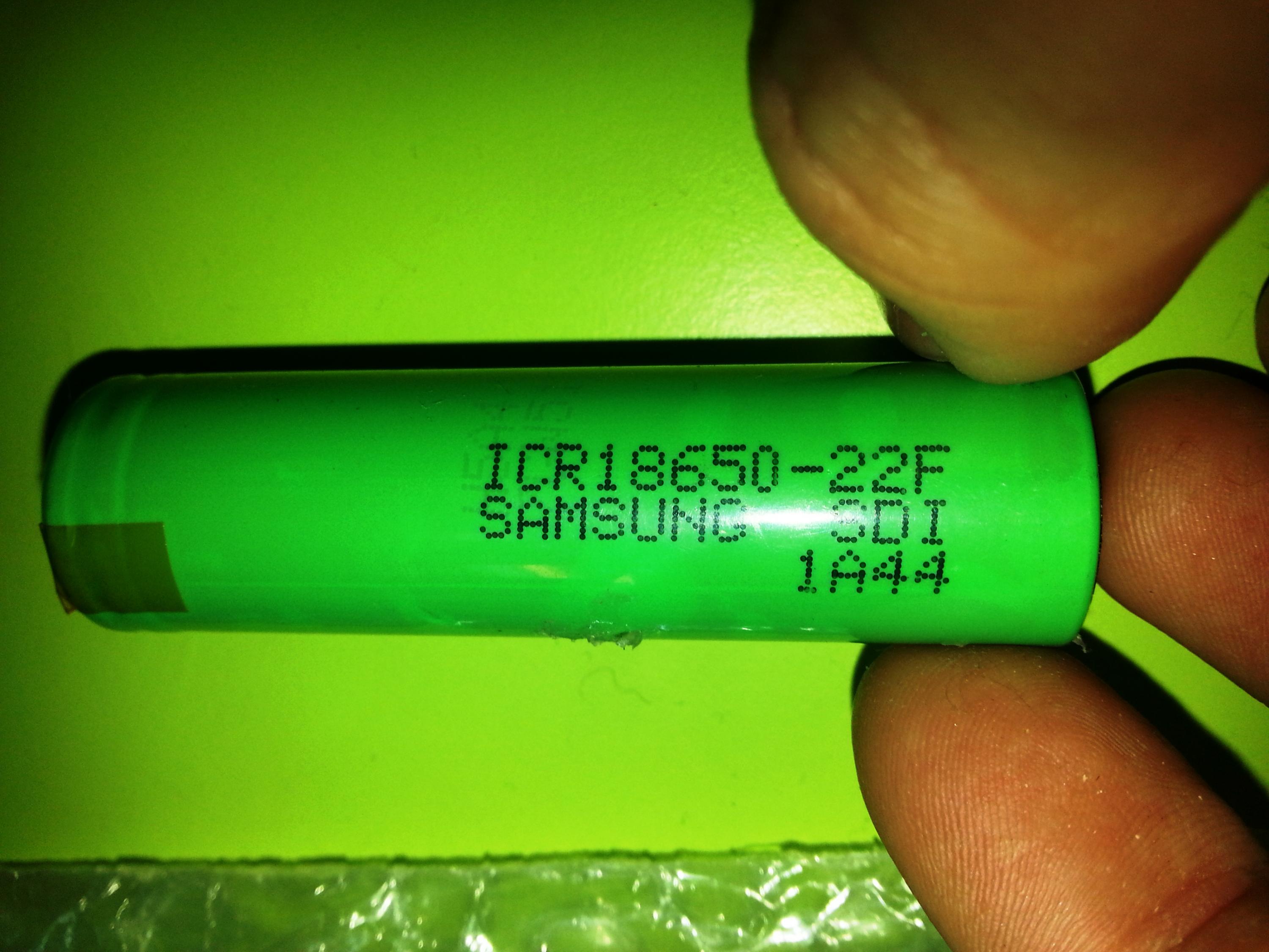

                        #51
                        Re: Directly replacing NiMh cells with Li-Ion cells - bad idea ?
                        I snapped some pics of the thing today. Here's the batteries I got this time that my boy put in and also a close-up of the IC that's in there...had to do it rather on the sly so unfortunately the model is not visible, but the point is it HAS some pretty advanced tech in there. It probably handles charging and motor speed control. It's an Electrolux ErgoRapid or something like that, forgot to mention for anyone who might be interested...at least that's what it says on the outer case - I don't know the exact model because I didn't bother.
                        The green Samsung cell is what he attempted to use the first time when it failed.
                        I actually got it wrong: the charge circuit is built into the handheld part, as you can see, but the LED I was talking about is at the top of the handle which you use for converting it into an upright vac for the floor. This whole apparatus then slips into a dock which does nothing but connect the wall adapter to the handheld portion which has the 4 metal shims I mentioned and handles the charging internally. The LED on the handle now comes on as well when docked...apparently, according to him, someone had been inside before they brought it back in and they had messed up some wires or something along those lines. Either way, it looks like the problem's solved - at least partially...we'll see how long it lasts this time.
                        Wattevah...
                          #52
                          So the charging Voltage for 4 cells is about 16V, is that the charger putting out? He should also monitor the charging current.

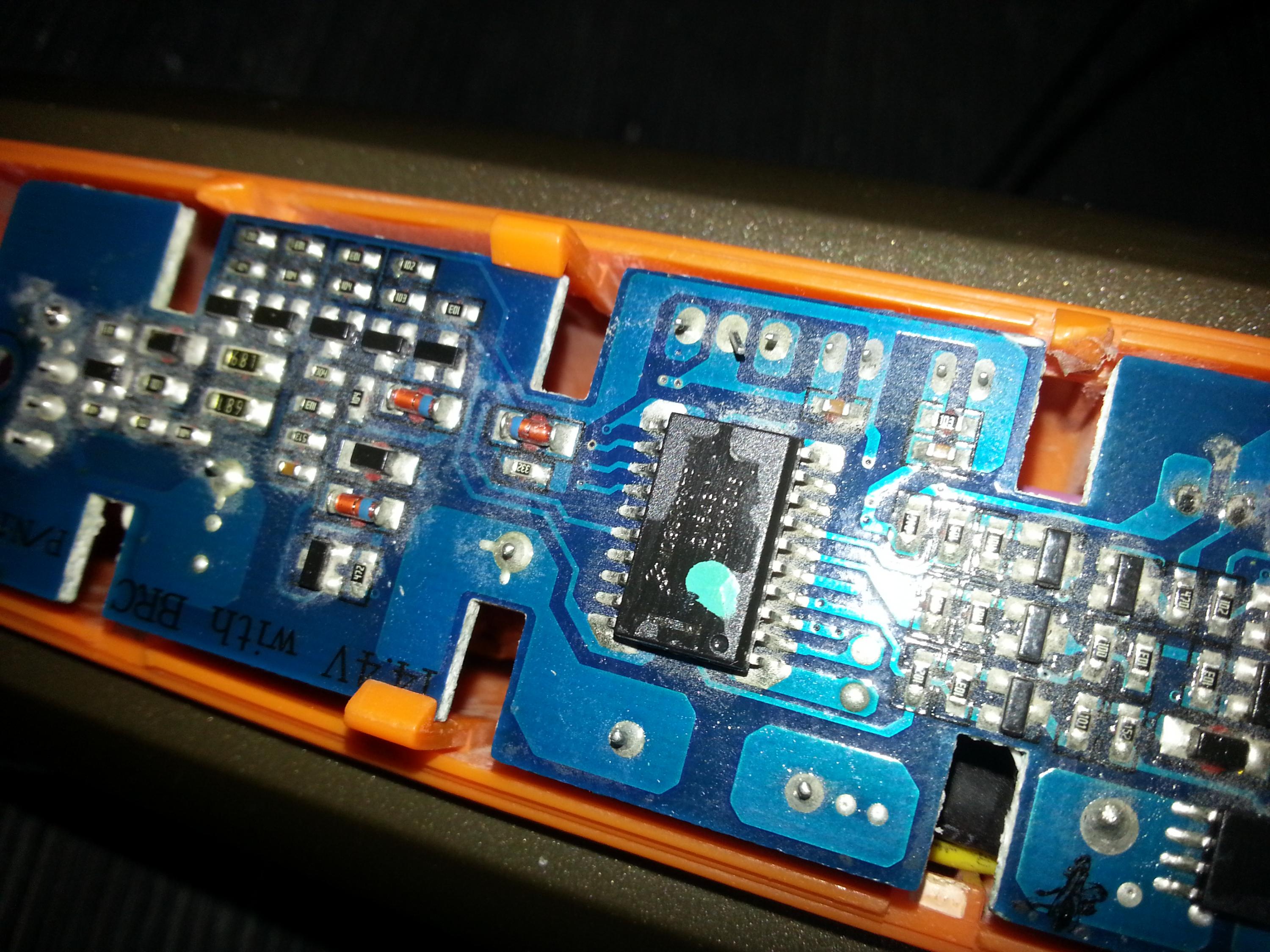

                            • 31187
                            #53
                            that chip looks like a charge controller - there is no way in hell it will touch those cells!!
                            the green cells arent bad - lets not speak about the ultra(fire) ones!

                                    • 31187
                                    #57
                                    too bad we cant see the number on the chip.
                                    • Dannyx
                                      CertifiedAxhole
                                      • Aug 2016
                                      • 3912
                                      • Romania
                                      #58
                                      Should I seize another opportunity to sneak a peek at it, I'll post back undoubtedly.
