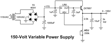

attempt to clone LED TV Backlight Tester
  • capwizard
    • Jun 2016
    • 1991
    Re: attempt to clone LED TV Backlight Tester
    Yes, one or two LEDs voltage drop more on the MOSFET . I will Put a switch for low and high voltage usage. low switch for one to one led strip testing, high switch for Dled tv whole screen and Eled tv strip testing. Or variable power supply.

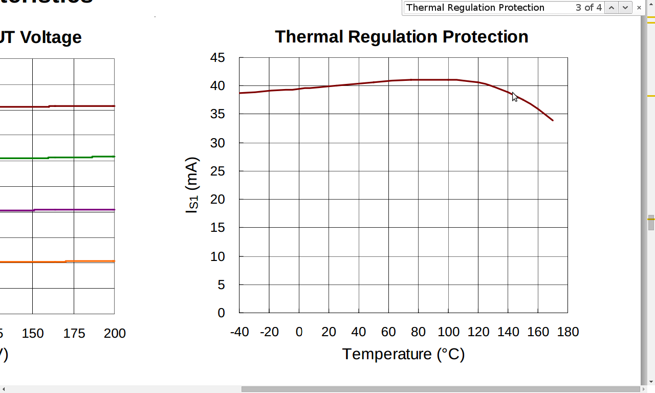

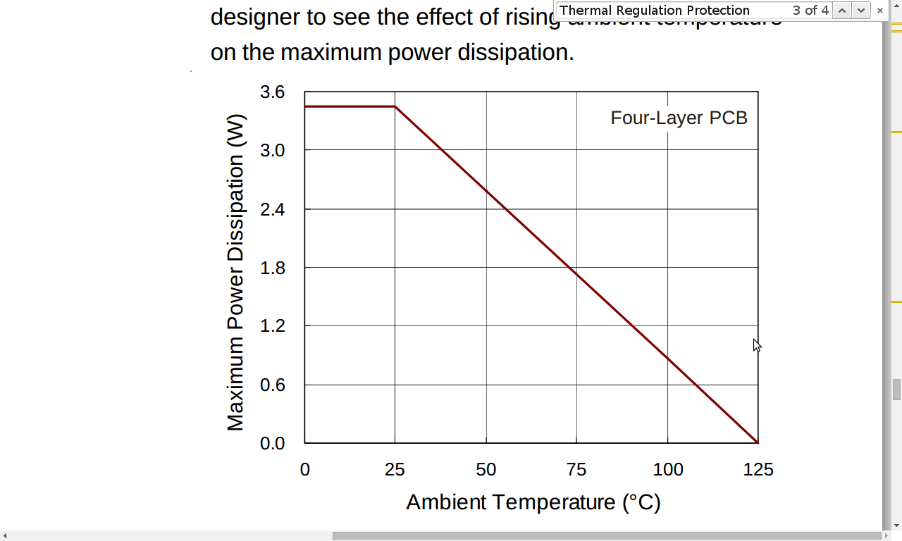

      RT7320 also provides a thermal regulation protection, instead of traditional thermal shutdown, to suppress the
      rise of IC junction temperature and prevent LED lamps from flicker.
      Page 3: Thermal Regulation Protection
      When the IC junction temperature rises above 125°C (typ.), this
      function starts to gradually reduce the regulated LED
      current, depending on the rise of the junction temperature.
      Meanwhile, the system power dissipation is also reduced.
      Finally, the temperatures in the system will be well
      controlled and enter their steady-state. The function can
      achieve both of the two targets : to protect LED lamps and
      to prevent them from flicker.
      The maximum power dissipation can be calculated by the following formula :
      PD(MAX) = (TJ(MAX) − TA) / θJA
      where TJ(MAX) is the maximum junction temperature, TA is the ambient temperature, and θJA is the junction to ambient thermal resistance. For recommended operating condition specifications, the maximum junction temperature is 125°C. The junction to ambient thermal resistance, θJA, is layout dependent. For SOP-8 (Exposed Pad) package, the thermal resistance, θJA, is 29°C/W on a standard JEDEC 51-7 four-layer
      thermal test board. The maximum power dissipation at TA = 25°C can be calculated by the following formula : PD(MAX) = (125°C − 25°C) / (29°C/W) = 3.44W for
      SOP-8 (Exposed Pad) package The maximum power dissipation depends on the operating ambient temperature for fixed TJ(MAX) and thermal resistance, θJA. The derating curve in Figure 1 allows the designer to see the effect of rising ambient temperature on the maximum power dissipation.
      Is that mean IC never going to burn out?
      At picture 2: When temperature rising to 125c, The power dissipation go to 0.0 w.

        Are you not better off just using a variable precision bench power supply with adjustable current limiting.
          "At picture 2: When temperature rising to 125c, The power dissipation go to 0.0 w" It means at that point, there will be no current flow through the device to produce any heat, no Vdrops no heat, the higher the ambient the less current you can let it pass through the device otherwise it will be damaged.

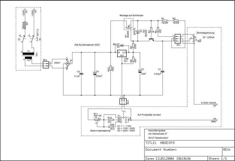

                              I did some tests on a GJ2C loaded with resistors from 470 ohms to 10K. The open circuit voltage is about 330v. When I connect a resistor, there is a brief spike of about 5ma then it settles briefly to 1ma then it ramps exponentially for 2 to 3 seconds to about 30ma.
                              The built in voltage meter is accurate.
                                Thanks for your testing results.
                                330v dc / 1.414= 233.38v AC. So SID GJ2C use a 1 : 1 isolation transformer but over 110v AC region they use 1 : 2 isolation transformer or ac doubler. SID GJ2C testing voltage is DC 330v / 3v LED = It can test 110 LEDs
                                " ......to about 30ma. " Current is too high for LEDs long time testing. 110 LEDs x 30ma = 3.300ma = 3.3A
                                "..........then it ramps exponentially for 2 to 3 seconds" In pic1 We can change C2 to 10uf - 100uf capacitor, give the circuit 2 - 3 seconds to charge to 1.2v for it to reach the current limited. ( I constant = 1.2v / R).

                                  The interesting areas of the PCB are covered with a very tough black epoxy. There appears to be a MOSFET in series with the output that does the fast current control. There is a large drum inductor which must be part of a Buck regulator on the isolated side also.
                                  The current ramps up in steps so must be controlled by the same micro-controller that does the voltage meter function.

                                    The TV had 2 series groups of 40 LEDs each. The tester developed about 150v for the 40 series LEDs.

                                      "There appears to be a MOSFET in series with the output that does the fast current control. " My guess, it is the LR8 (HV version of LM317)?
                                      " a large drum inductor which must be part of a Buck regulator on the isolated side also." My guess, That is for smooth the output voltage?
                                      "The current ramps up in steps so must be controlled by the same micro-controller that does the voltage meter function." My guess, U6 only uses for voltage meter? The current ramps up using capacitor.
                                      PS: Why they use Epoxy because they don't want you to know it is so easy to built.
                                      The poormans LED tester current is at 6.8ma, with no ramps up current I can calculate LEDs characteristics. Pic2.
                                        That's wrong
                                        Current is 30mA no matters LED's number.
                                        110 Led's -> 330V
                                        330V x 0.03A (same 30mA as people say previous) = 9.9W
                                        Almost 10W,I think is a little too much for simple or single LR8K
                                        Also I don't see isolation transformer or 1:1.
                                        Could be live connected.
                                        Also for 110V line could be using some voltage doubler.
                                        That little transformer could be some part of SMPS that deliver power to microcontroller and 330V at 30mA or only for microcontroller and LED's voltage is from main line.
                                        More clear and detailed photos can be usefull to solve the mistery.

                                          You're right.....My bad, Constant current means all LEDs in series at 30ma.
                                          "Also I don't see isolation transformer or 1:1." This I just guess because I did not have this LED tester.
