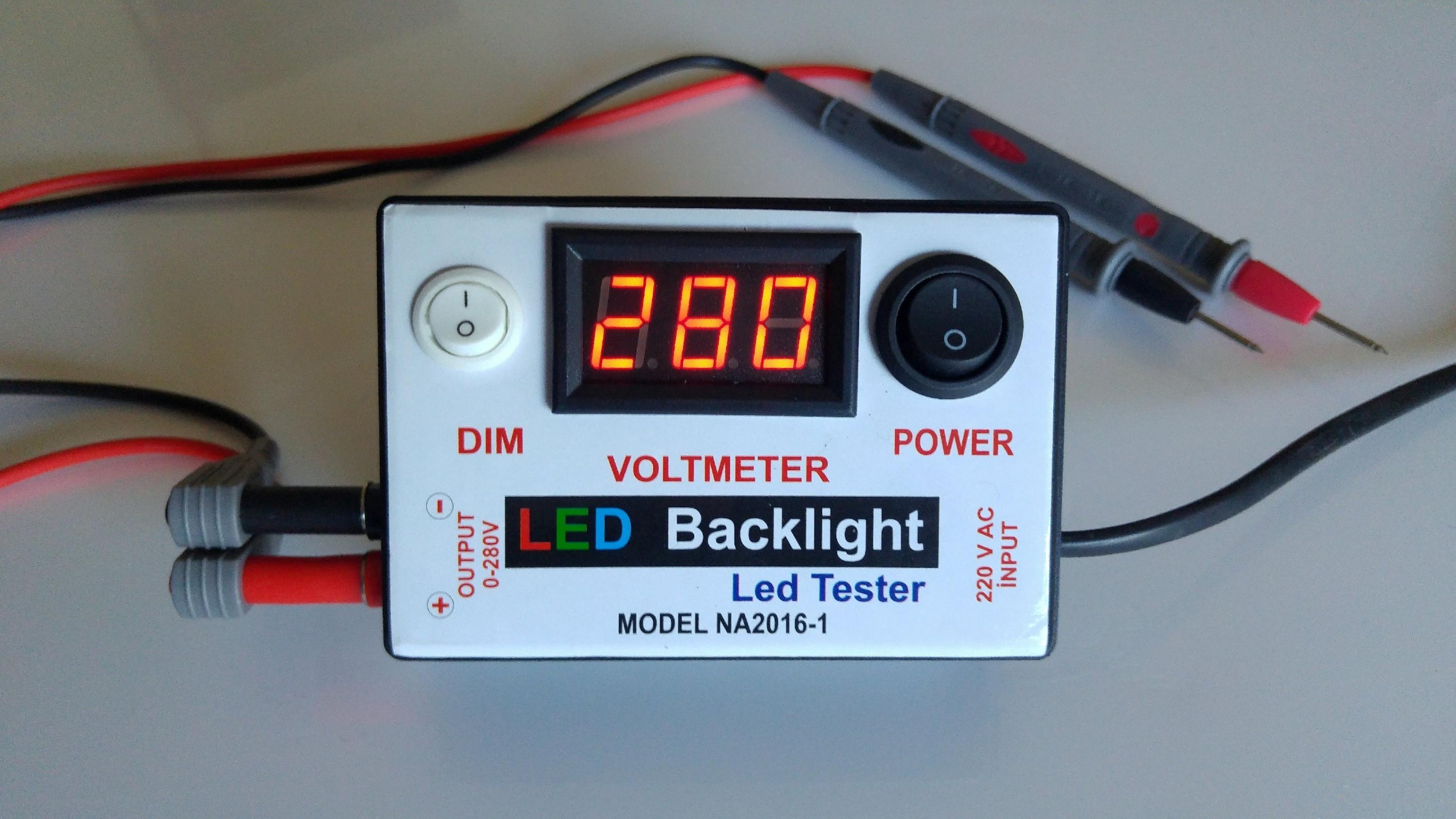

attempt to clone LED TV Backlight Tester

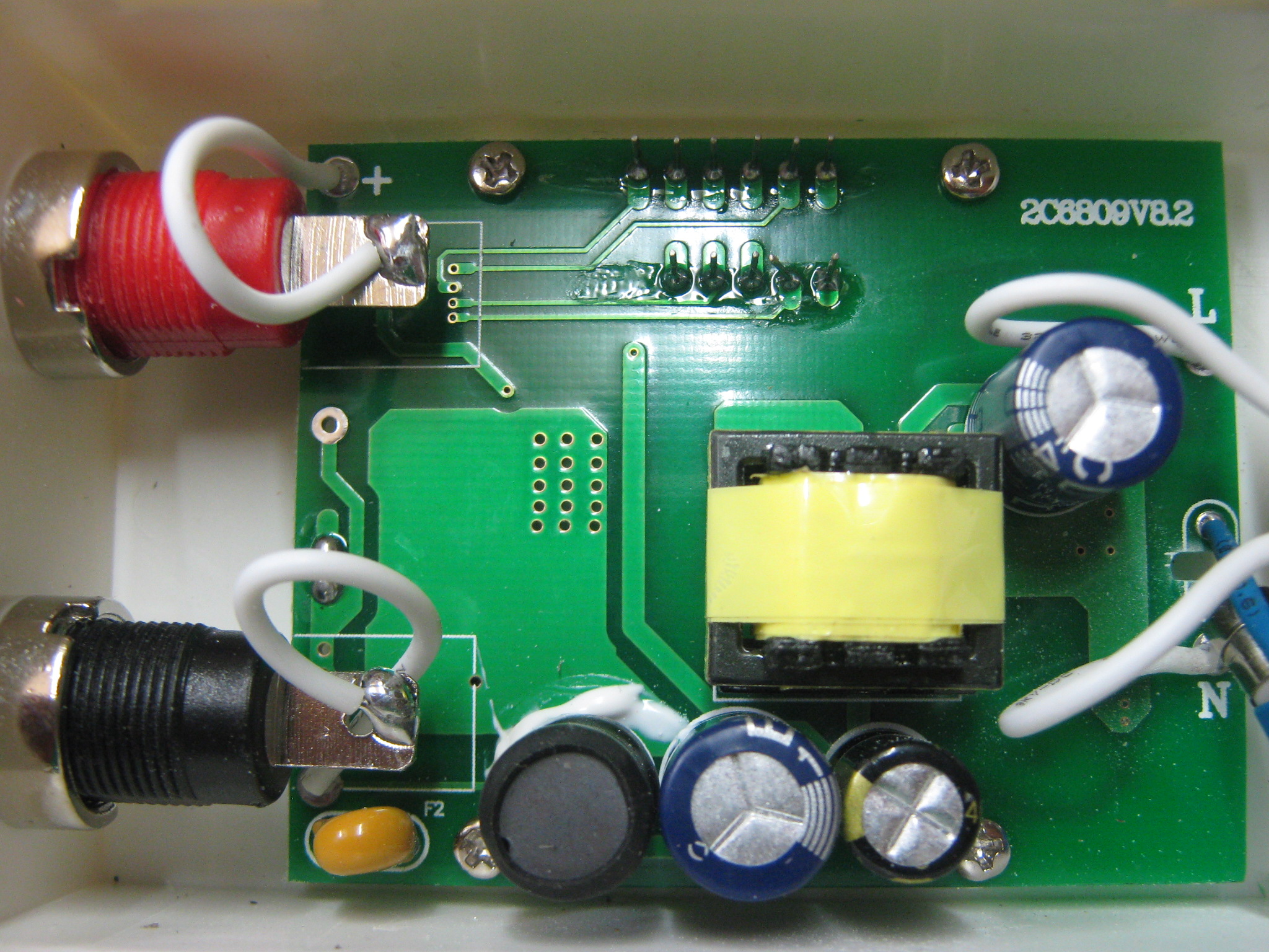

    The photo in post 38 is different. The one I have has more parts.
    • rievax_60
      • May 2012
      • 897
      • australia
      #42

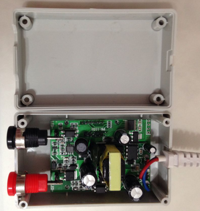

      Re: attempt to clone LED TV Backlight Tester

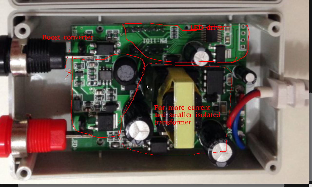

      I took some photos of its PCB. Although it was purchased by someone else, I think the price is reasonable.

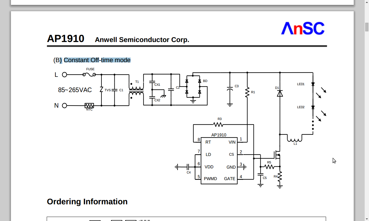

        The more LEDs in series the less power dissipation for the LR8K because you will have less Vdrops on the IC, it is worst when you test 1 LED.

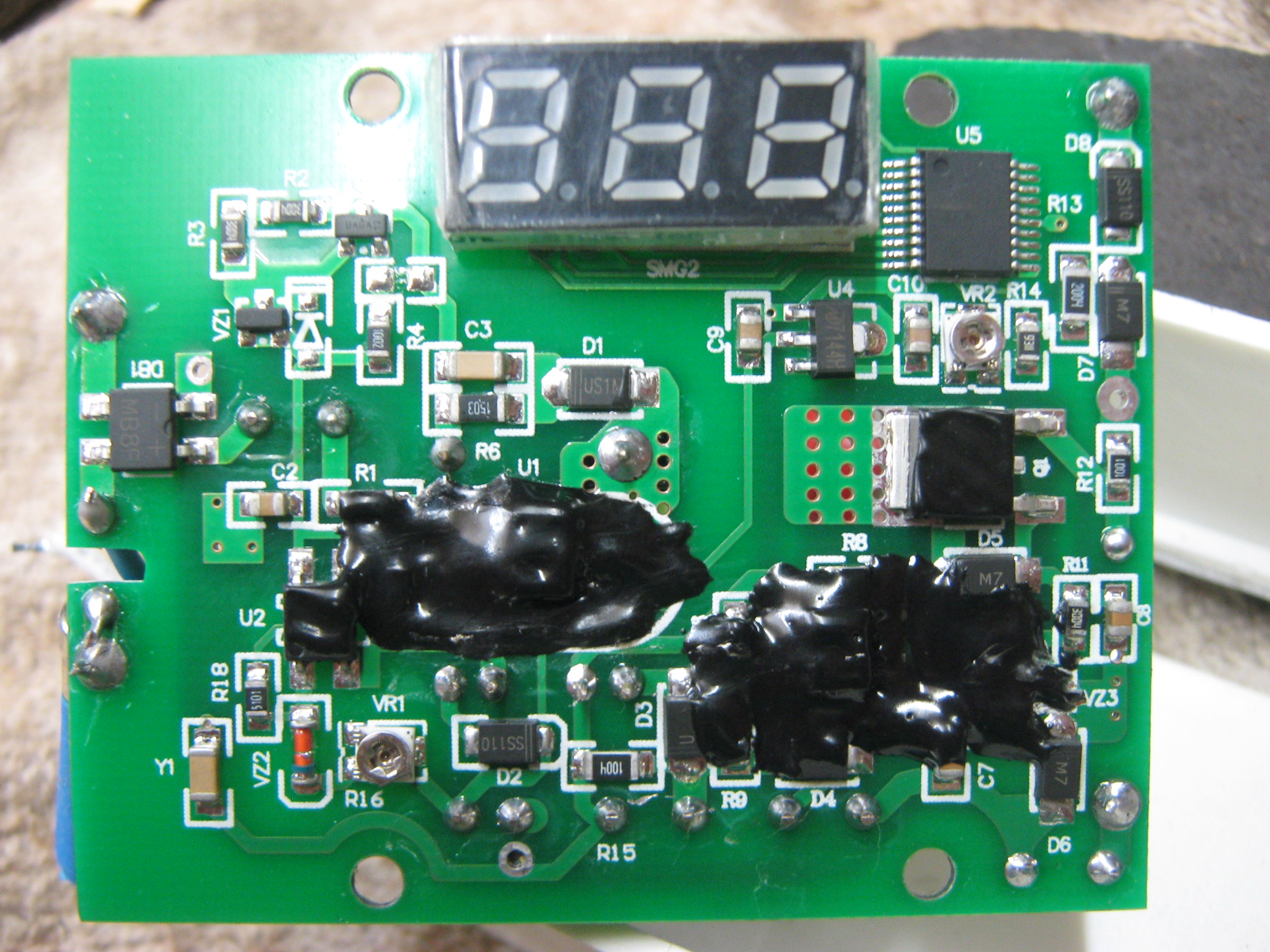

            rievax_60 Thank you for the fotos. This one do has a MOSFET, Maybe they designed similar to this circuit.
            gabiz_ro Would you please try to design A battery powered LED tester? If you have time.

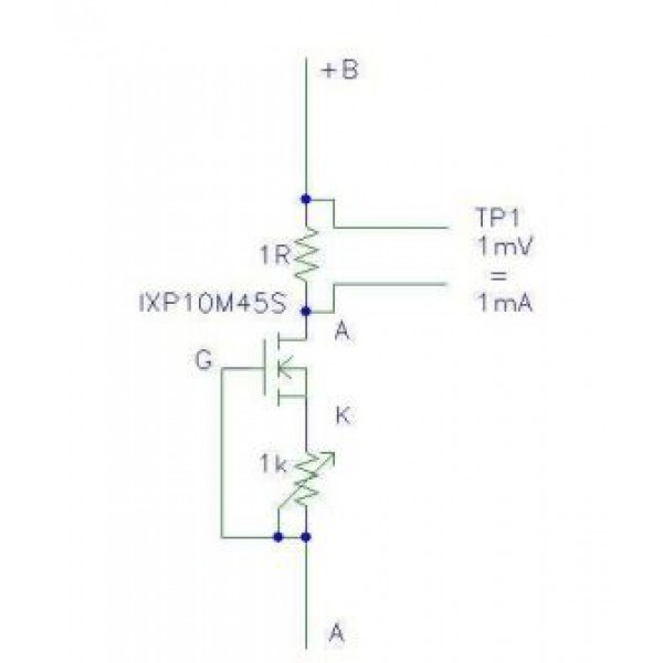

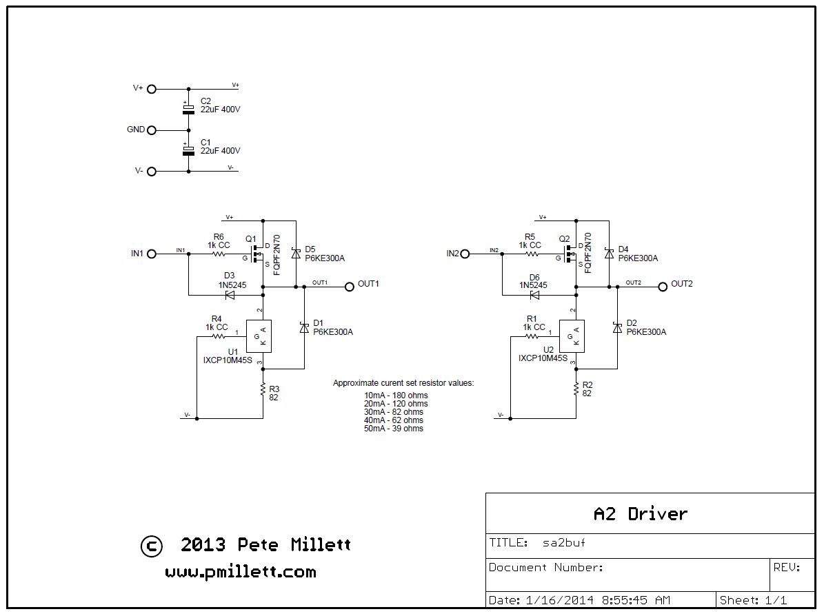

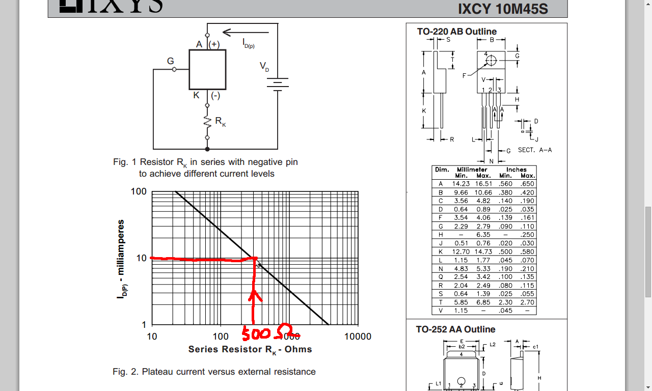

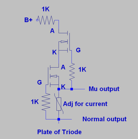

                I whip together a HV constant-current source using depletion mode MOSFET. It needs a heatsink because it is in linear mode. It's a couple resistors and a diode, good to 400-1,000V. Then I use any HV DC power supply.
                See:
                IXYS 10M45S and Supertex DN2540
                IXYS IXTP08N100D2 depletion mode MOSFET 1,000V
                Resistor calculator here

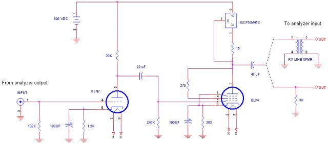

                  i never heard.... Switchable Current Regulators IXCP 10M45S...People used for Tube Asylum(tube current source). Thank you, I've learned from you.
                  Why can we use junk LED power board from manufacturer, Modify it to A variable current and variable voltage power source.........From the feedback of the driver IC maybe it just needs two Potentiometers for voltage divider. .......... as A LED tester and LEDs strips (screen) power supply? This gonna be my next homework.

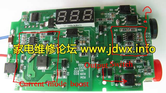

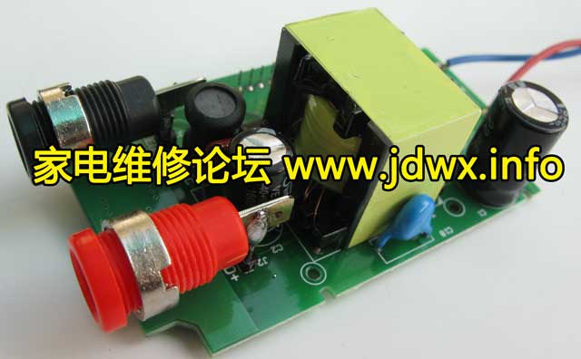

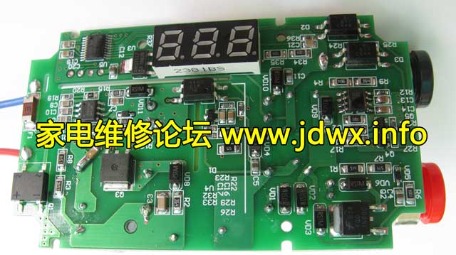

                    SID GJ2C's competitor. it Looks like a AC Adapter, LED voltage meter + current mode boost converter of which is for higher current purpose.
                    Who knows in the picture (pic4) the question mark aera circuit is for?
                      May be some voltage comparator.
                      Nothing connected SMPS is driven by optocoupler D1
                      Some LED's connected depending on voltage resulted D2 or D3 override somehow D1 as result SMPS output could be 50V or 150V or 300V
                      That decrease power disipated by series regulator.
                      But maybe I'm wrong.Who knows.

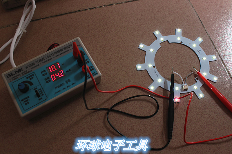

                          #52
                          https://www.badcaps.net/forum/attach...5&d=1490812596
                          Hmm something is not right, it shows 20 LEDs, but the Voltage reading is showing 18.1V
                            https://www.badcaps.net/forum/attach...9&d=1490803893
                            The section you marked as 'CURRENT MODE BOOST' is the hot primary side SMPS showing the SMD power MOSFET driving the primary winding of the power transformer, you can see the Drian pin connected to one pin of the transformer and the RCD Snubber network (R2, C3, VD8).

                              " it shows 20 LEDs, but the Voltage reading is showing 18.1V" ............18.1v / (20 / 2) = 1.81v The color of LEDs are amber because they are cheaper than white one. http://www.torchstar.us/5m-5050-ambe...ip-lights.html
                                #55
                                They look white to me, unless the photo is not color corrected.
                                "18.1v / (20 / 2) = 1.81v " are they two strings of 10-LED per string connected in parallel?
                                  Yes it is.

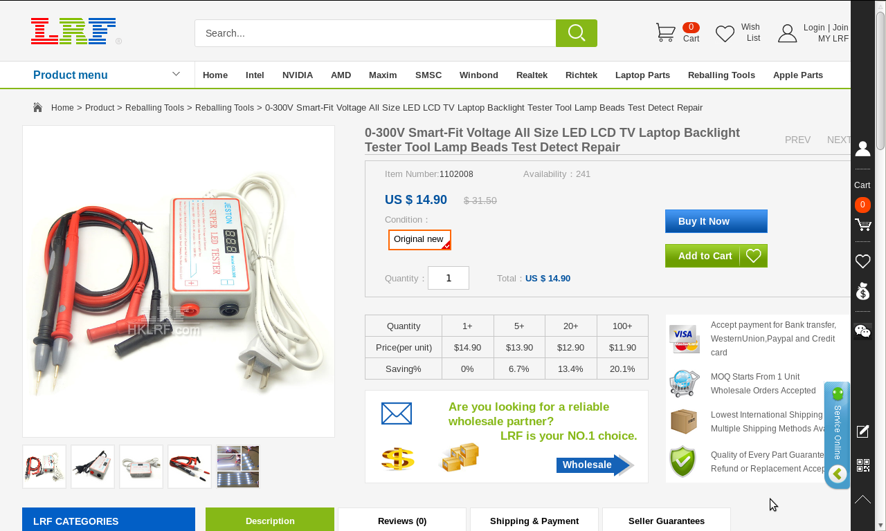

                                  pic1 : Clone LED tester for sale $14.90 but shipping and payment ? Be careful.

                                      #58
                                      https://www.hklrf.com/0-300V-Smart-F...pair_1948.html
                                      I have just tried to create a account it says a extra 10.10 postage to the uk
                                        #59
