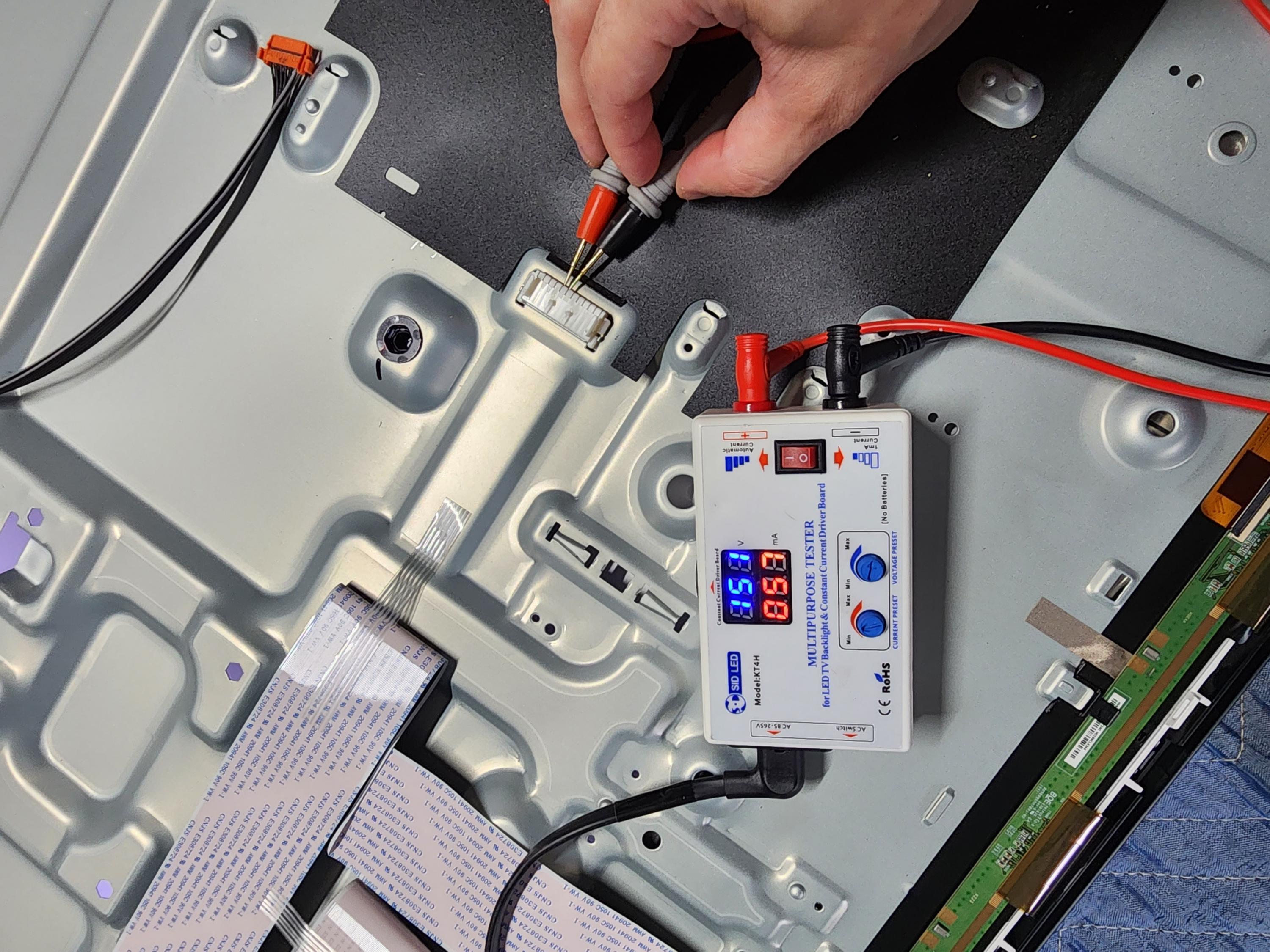

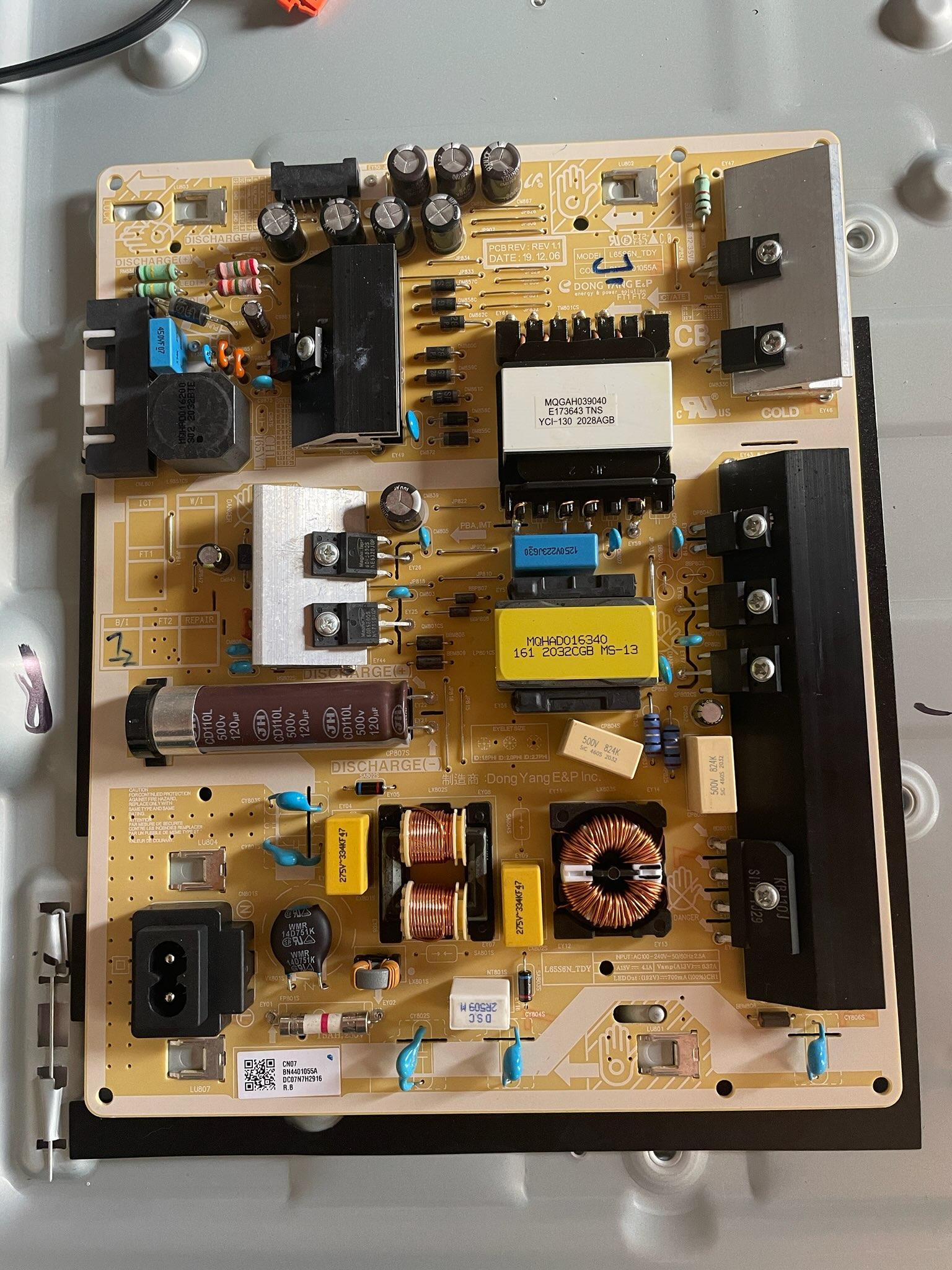

    on the board i see that there are only 4 pins going to the LED backlight and 2 of them are bridged together (2 and 3)
    to recap i was seeing 100v when i applied positive probe of LED tester to pin 1 and negative probe to pin2
    and i was seeign 64v when i applied positive probe of LED tester to pin 3 and negative probe to pin 4
    when i bridge the gap between pin 2 and 3 of the LED connector with 1k resistor (its all i had on me) and power both of them at the same time i got 190v on the LED tester.
    100+64 does not equal 190v so i dont see why there is such a difference.
    with the psu plugged into wall power:
    with my voltmeter i see 280v at the LED output of the PSU but not even a flash of backlight. this voltage does not vary whether the power supply is plugged into the backlight or not.
    and it doesnt vary when i inject 5v to any of the pins ANA_DIM, PWR, or BLU_PWM
    i dont understand how i can have this high voltage at the LED and have no backlight lighting up at all.
    high voltage but no current is flowing...??
    its not throwing any blink codes...just acting totally normal with no backlight.

          First all there is no such thing as open box new power supplies. They all come from broken TVs, whether it be broken screens or what not but they’ve all been installed in a tv.
          Unplug power supply from mainboard and remove backlight socket from power supply and plug tv in. Measure voltage output on backlight circuit.
          If voltage is good and steady for all outputs then your backlights are bad. If no power output or if it fluctuates its the power supply

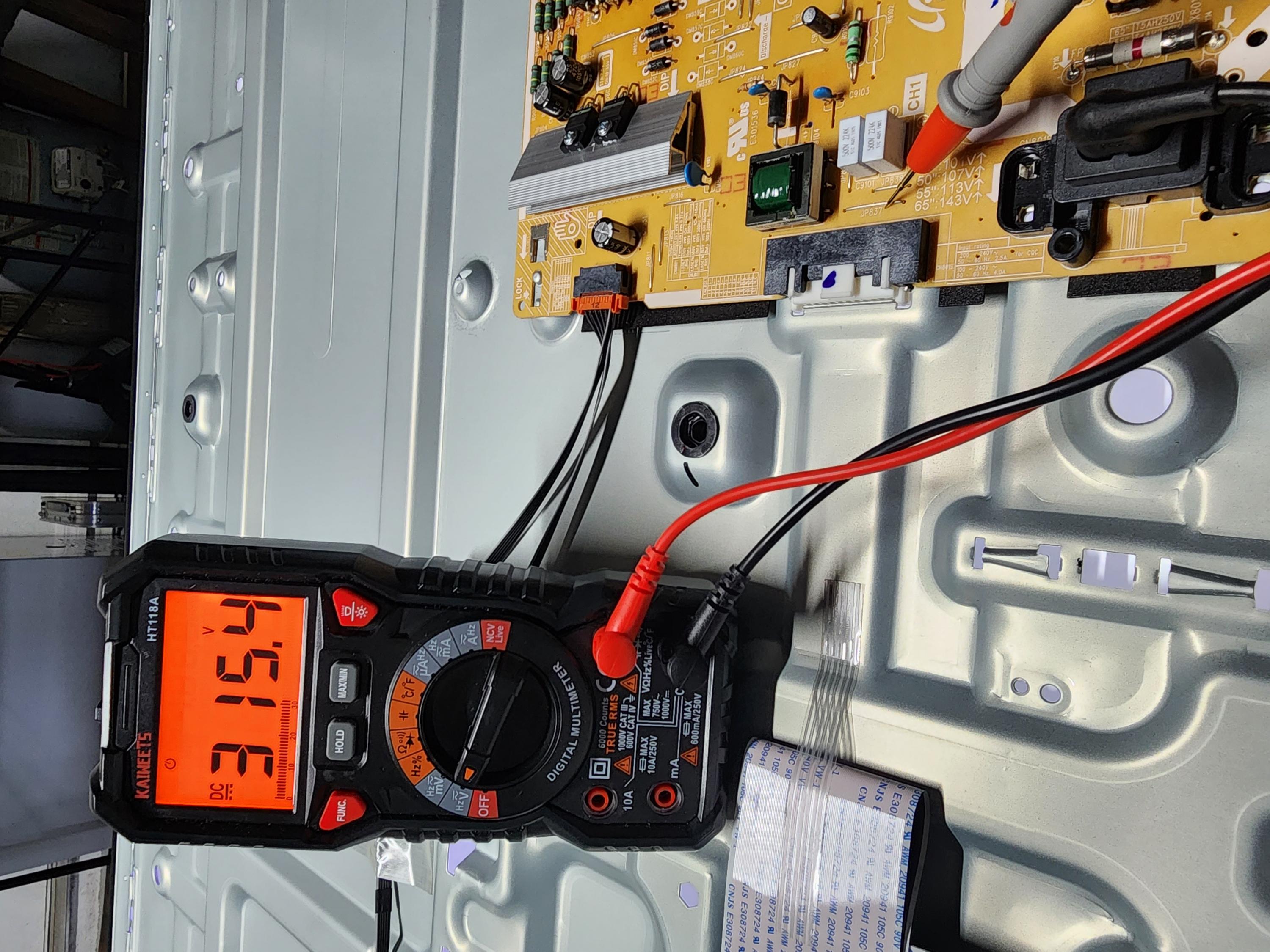

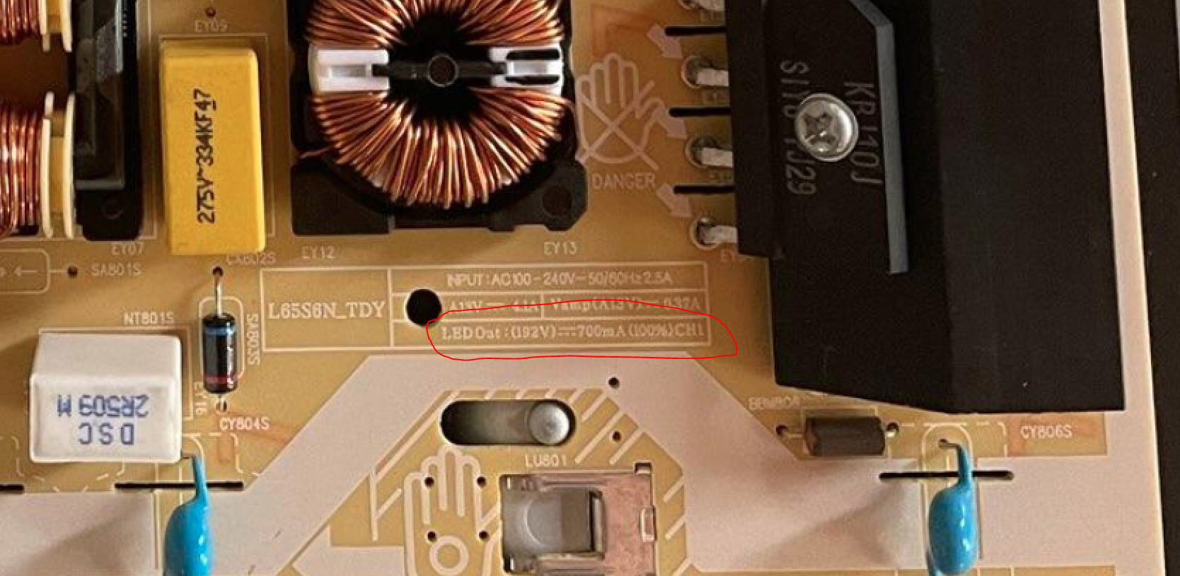

              You have a failing backlight led, The normal led supply is 192v@700ma When one of the led's fails the voltage is high due to no current so no voltage drop. Your led tester likely supplies about 10ma, those testers are ok for testing one led at a time.
              With full current the bad led will go open.

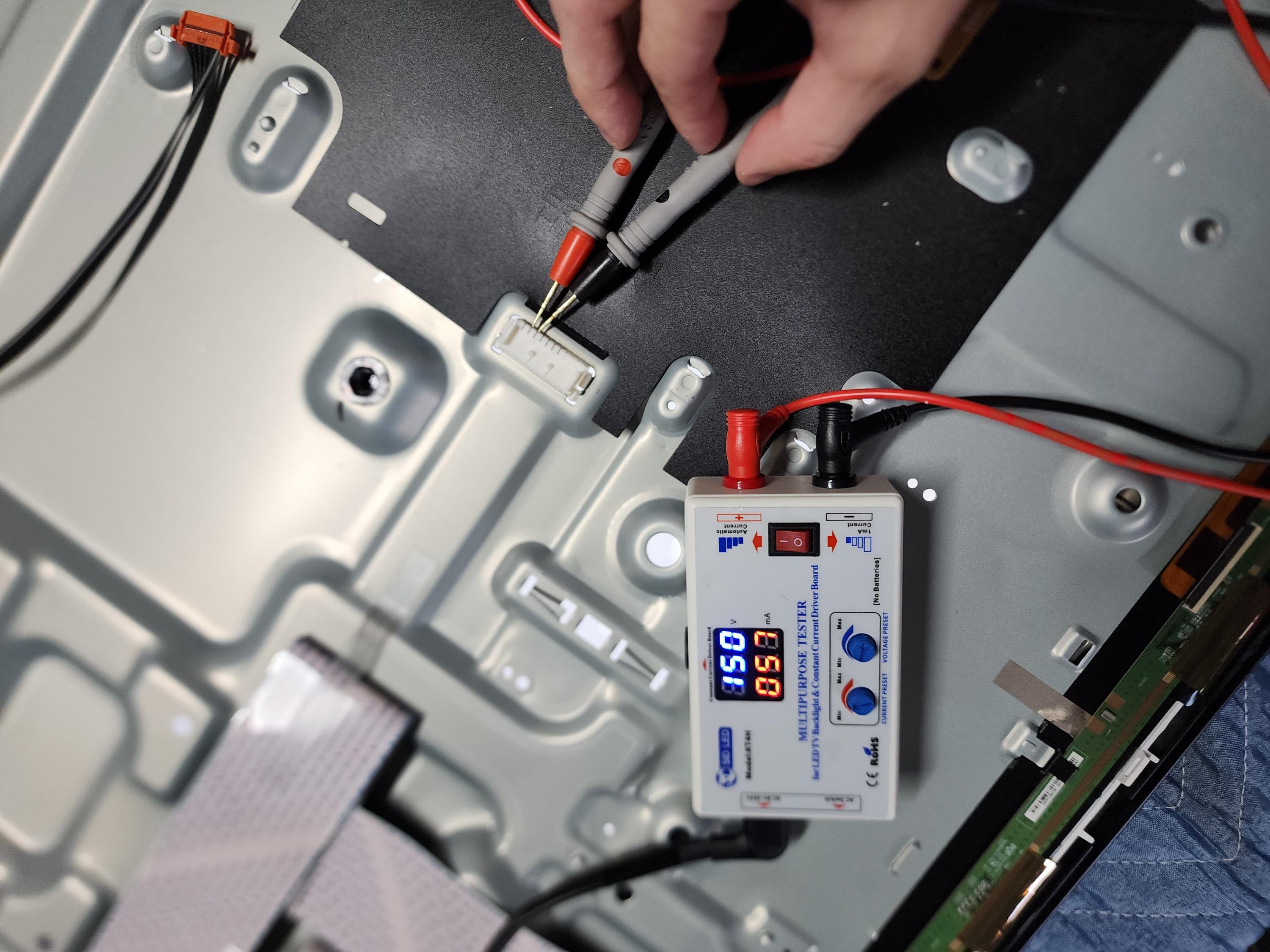

                Re: UN65TU700DF picture and sound but no backlight. BL tests ok but repl. PSU didnt f
                I'm working on this exact TV right now. I have it open to the LEDs right now. When I used my LED tester while it was open 3/4 of the LEDs would light up. The TV still worked but it shows you that with these edgelit Samsungs you can still "test" as if your LEDs are lighting up but that doesn't mean they are good. I have 142 volts from each set of strips. As rj says it's your backlight.
                As a test couldn't you unplug the power board from backlights, hook up main board, turn it on and then take LED tester to the backlights and you'll see that some are out. I've done this with other tvs, never a Samsung.
                **142 each side with new LEDs put in. Not the 3/4 LEDs, I tried to test that strip but no longer works cause I yanked it out. Good luck

                  So what should it be 142 or 192 volts?

                    so what should it be 142 or 192 volts?
                    192v
                      192 is the maximum so at full brightness..

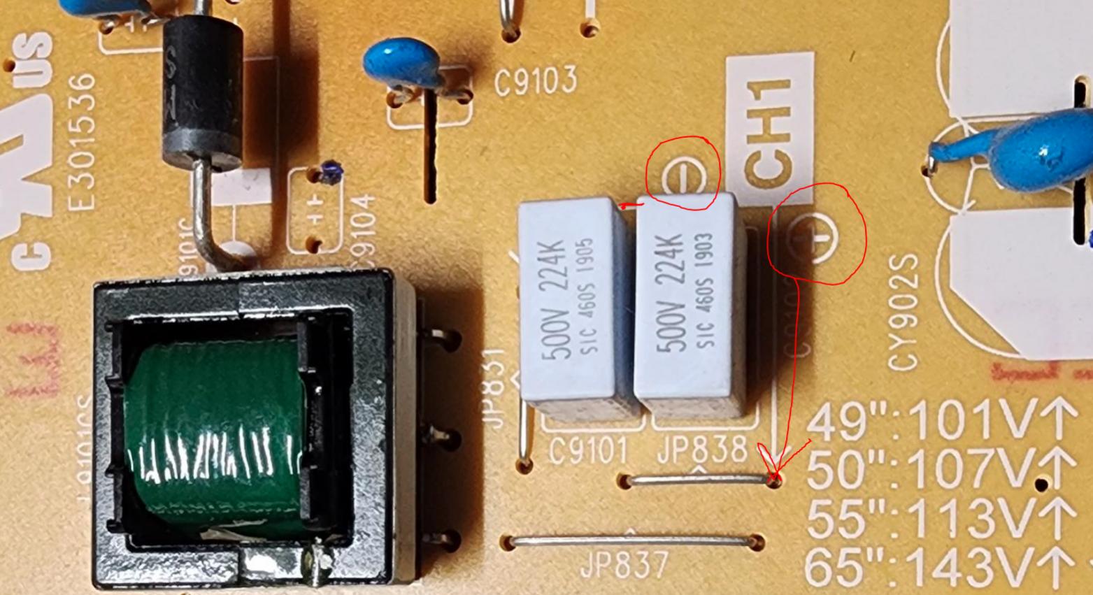

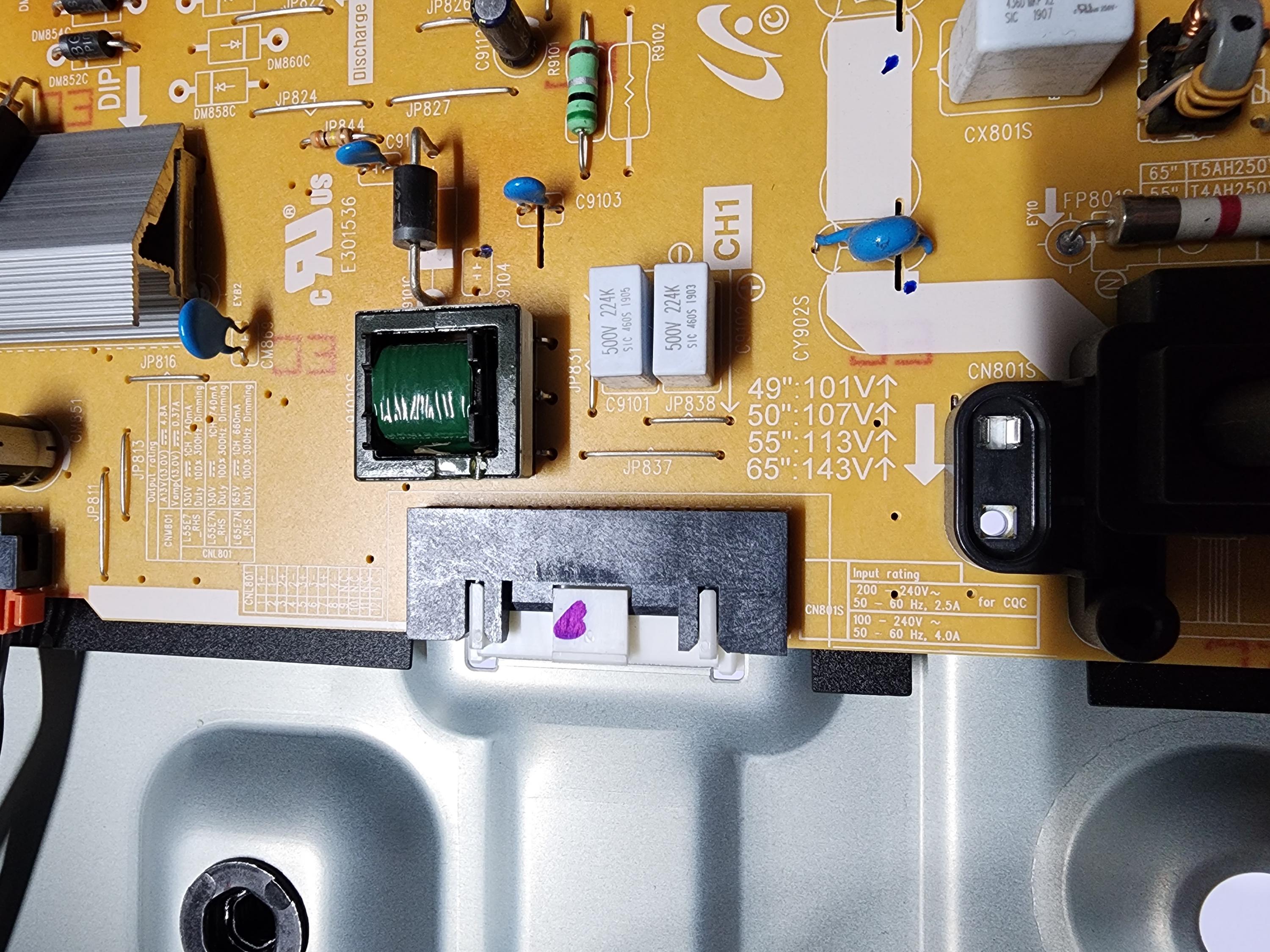

                        Ok, another case of could have solved sooner had the legends of the powerboard been in focus, tried to read it but could not, thought 280 was too high for that tv.

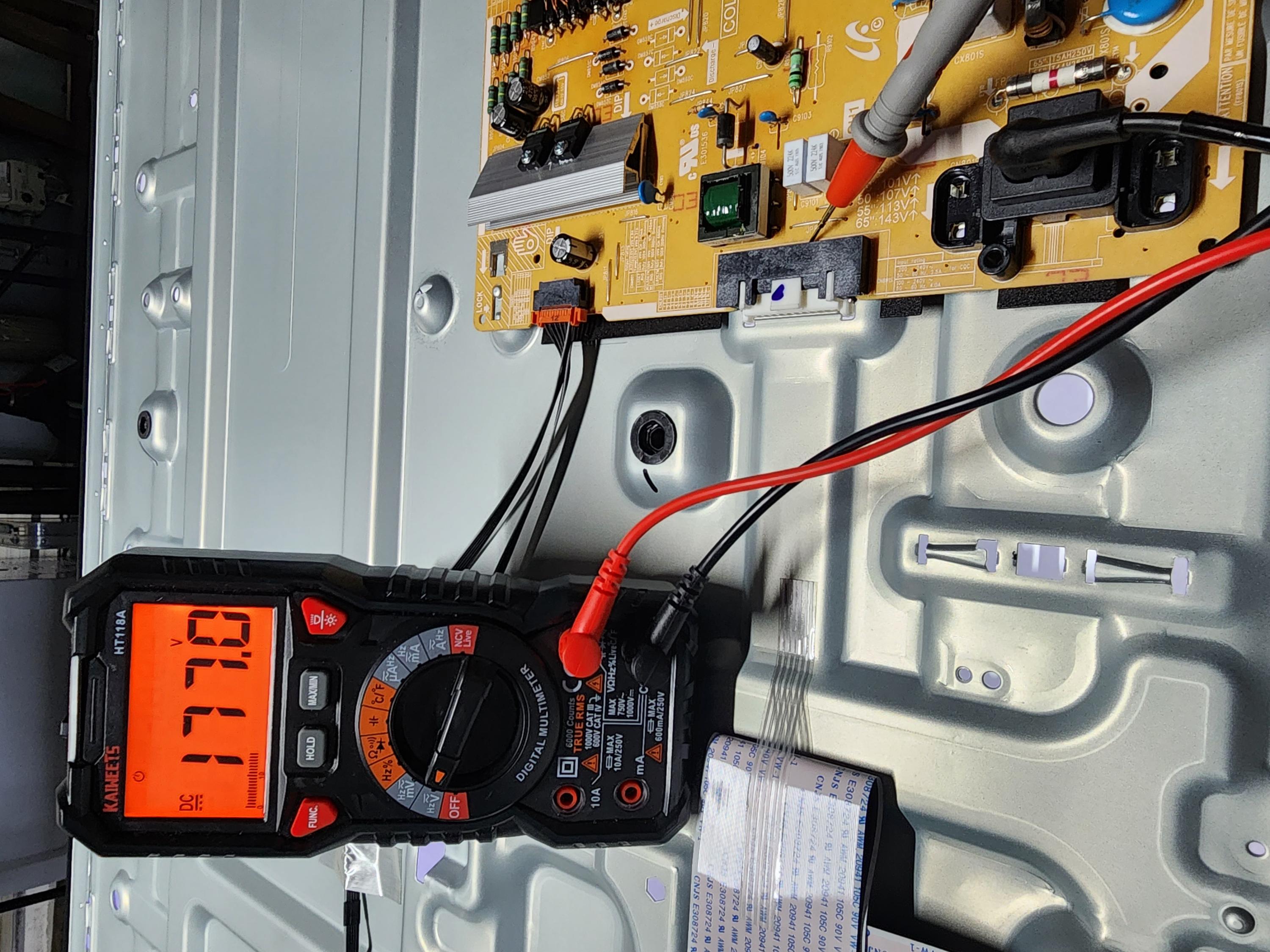

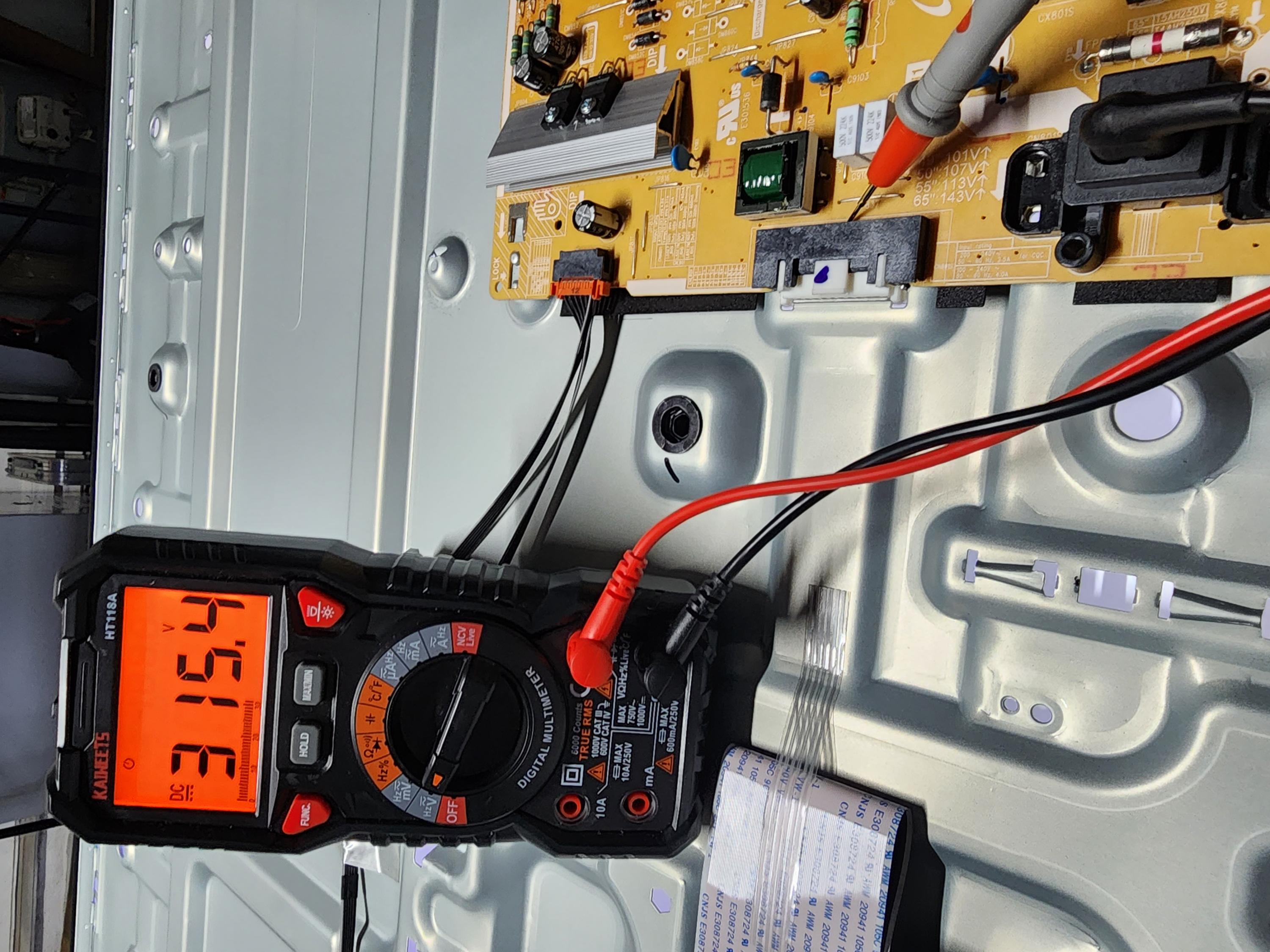

                          Here's some pics and voltage. My board also says 143 volts 65 inch.

                            So you had same situation, bad backlight but your voltage was 315 before replacement if I see it correctly, that should help lots of people if they find this.
                                No one measures voltage this way (there is no common gnd), you need to measure between + and - (led - and led+...)

                                  Ok, I wasn't even looking at how it was done lol.
                                    See I learn every day lol

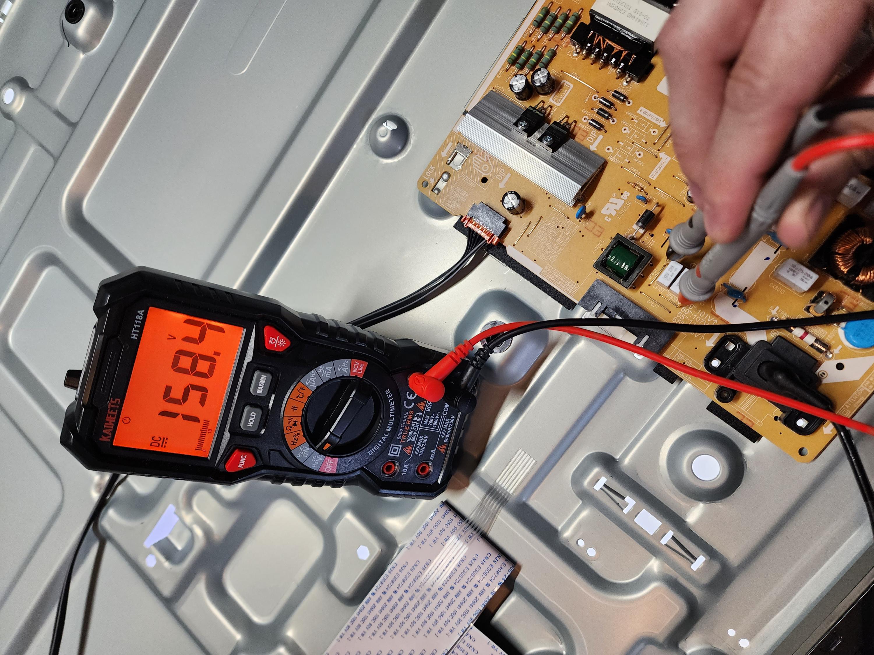

                                      measuring LED BL always depend on what kind of LED build in. LG had ziner build in, the way of it LED+ & GND chassis for each group. this also to any other brand which had LG panel. other with non ziner LED+ LED- to compare the high and low of each group.
                                      • EazyBone
                                        • Jun 2023
                                        • 1351
                                        • United states
                                        Here's a pic.
                                        And thx diah for info, and lotas. Looks like 158v
                                        Either way I still think this is backlight
