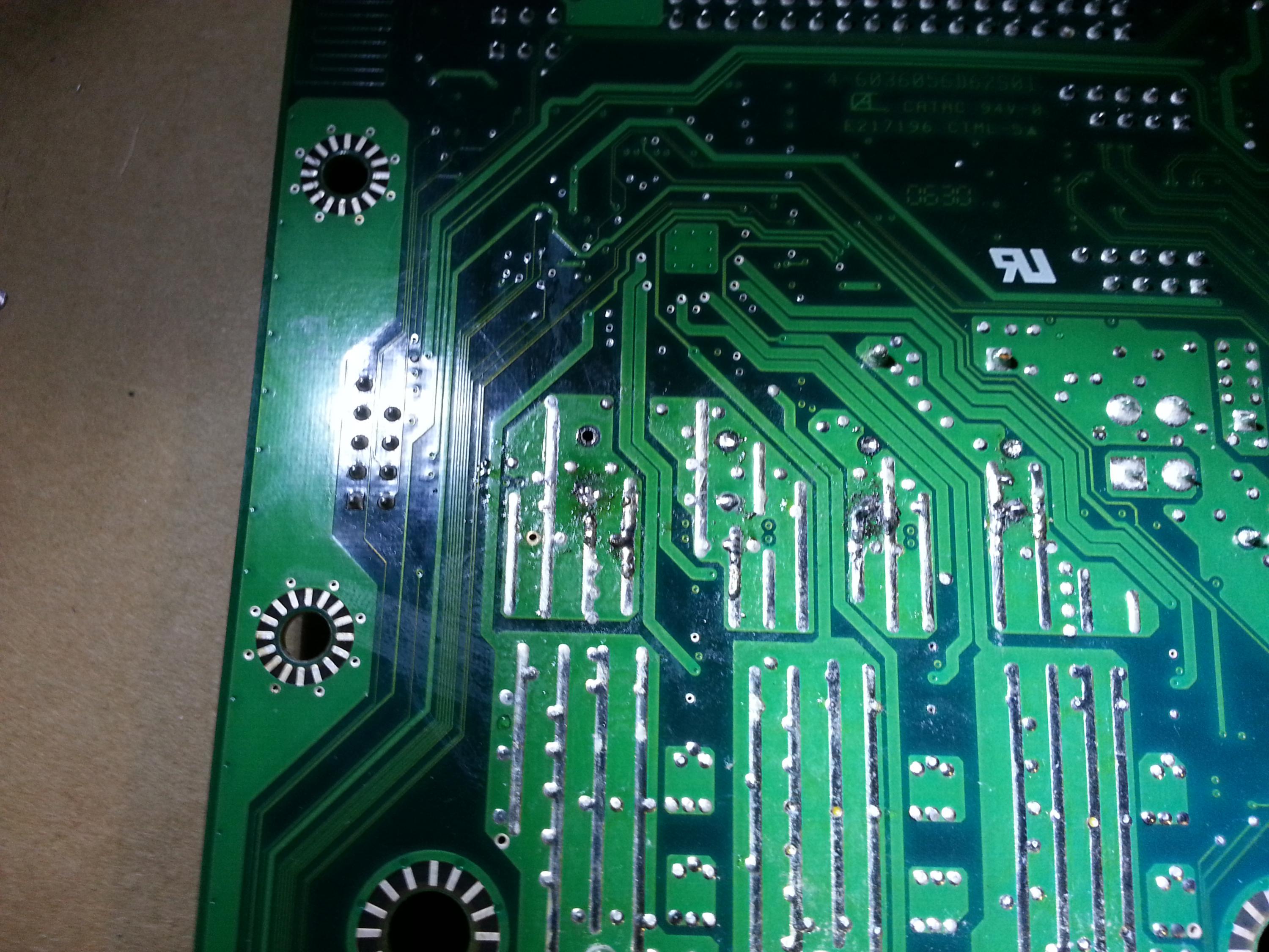

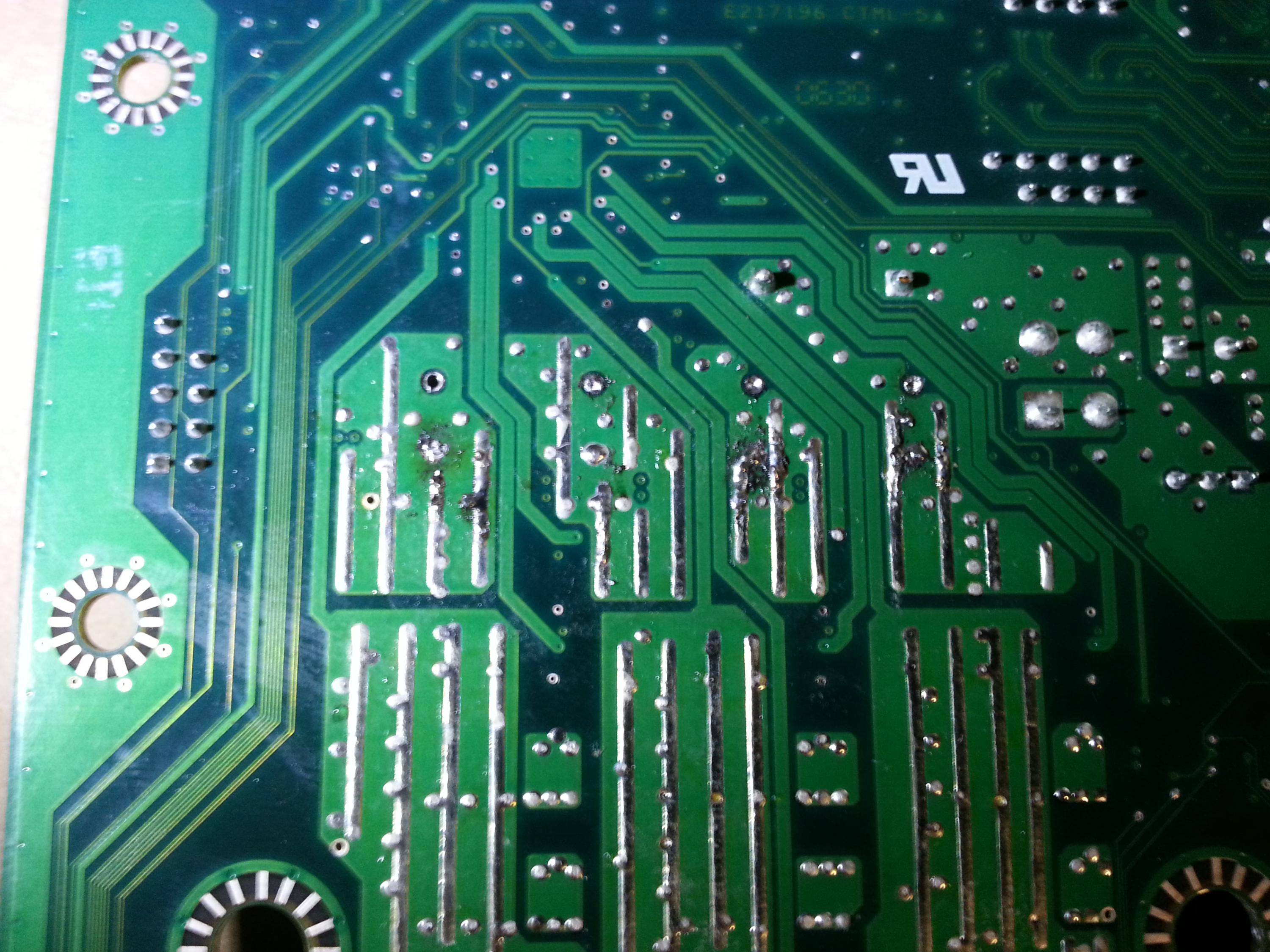

                            Well I was able to remove 4 capacitors but I was only able to get one hole completely cleared from the solder. I have tried using a piston type solder sucker and solder wick to no avail. I also had to add a little bit of solder to get the caps removed but some overflowed and are now touching the metal lines beside it. What would be the easiest way to clean those up? I am using 1.2mm solder, maybe that's too big?
                            Also any ideas how I can clear the solder from the remaining holes, I don't have a dentist pick on hand. I am using the chisel tip on my hakko fx-888d maybe I should be using a conical tip? Here are some pics of what I have done so far

                              Maybe you haven't got your iron hot enough ?
                              I use a chisel tip and mechanical pump. I add a little solder, heat the hole then slide the iron to the rim so the hole is exposed with the molten solder in. I get the pump in tight to the iron and click the pump, this should clear the hole.

                                I have the iron set at 842 degrees Fahrenheit, is that hot enough?
                                • diif
                                  • Feb 2014
                                  • 6978
                                  • England
                                  Re: What is a mechanical solder sucker?
                                  That seems too high, i have my cheapo iron set to 400c, turn it down and hold it on until the solder melts. Maybe practice on some scrap boards. It took me a little while to get my soldering right.

                                    i use a safety pin instead of a dentist pick that is the same thickness as the hole. have a few safety pins of differing thickness for different sized holes. never seen the solder adhering to the safety pin. it must be made of stainless steel too.
                                    never ripped out a via or trace after fully recapping three boards. (that means i've cleared over a hundred holes with the safety pin) never burnt myself either holding the safety pin to clear the hole. if the pin gets too hot, it means u are overheating the board with the iron!

                                      Good idea, I never though of using a safety pin. When I was removing the capacitor I was feeling it getting hot in my hand, was I overheating the board?

                                        Also what size solder should I be using? And can I use the very end of the tip of the iron to solder or you have to use the side? It's kind of awkward to use the side with a chisel tip on something small, maybe I would need to use a conical tip?
                                        Another thing I noticed is when I melt the solder in the hole with the iron, the solder comes up and follows the tip, as soon as I remove the tip the solder is already too solid to suck it up with the solder sucker.
