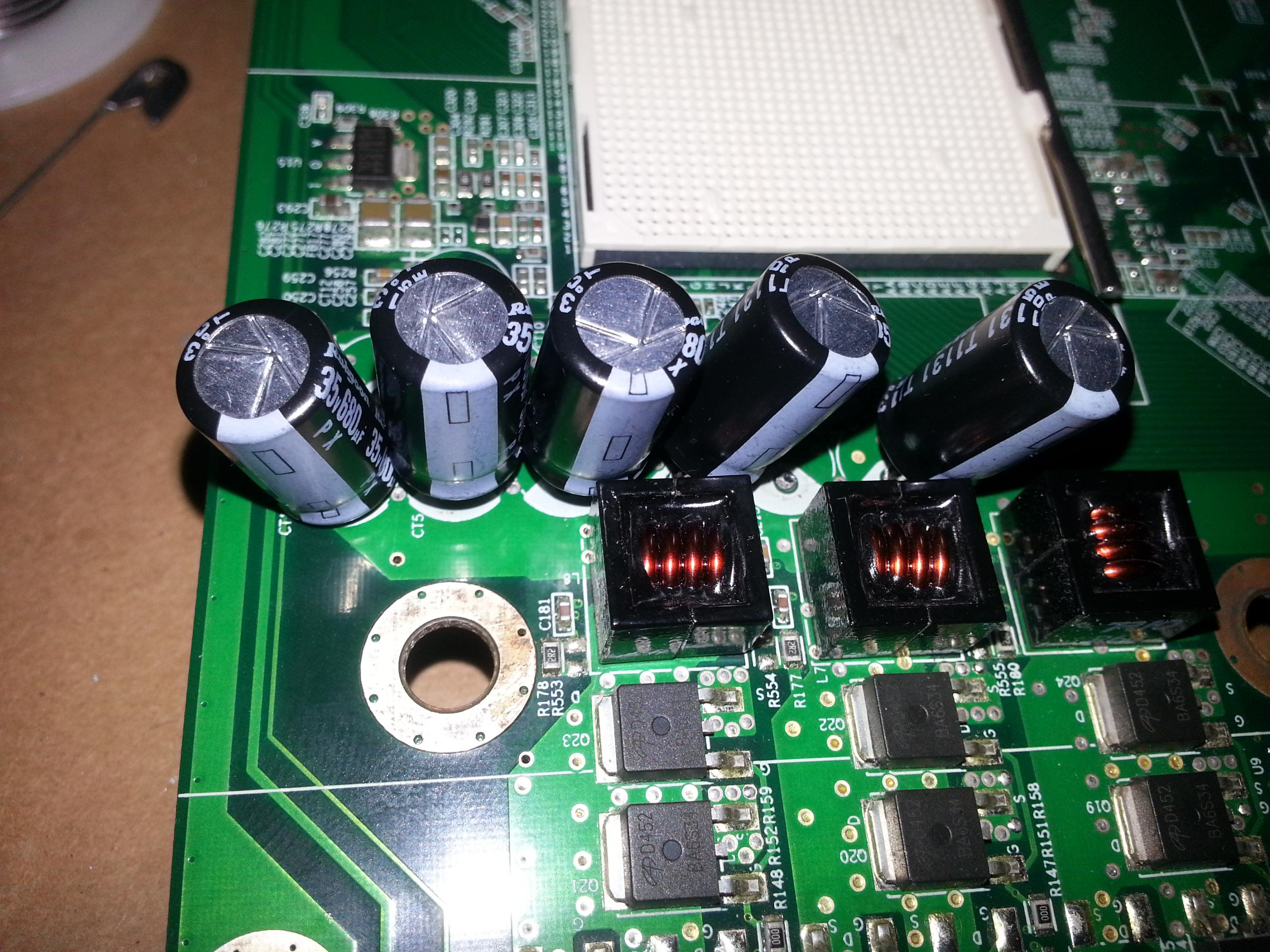

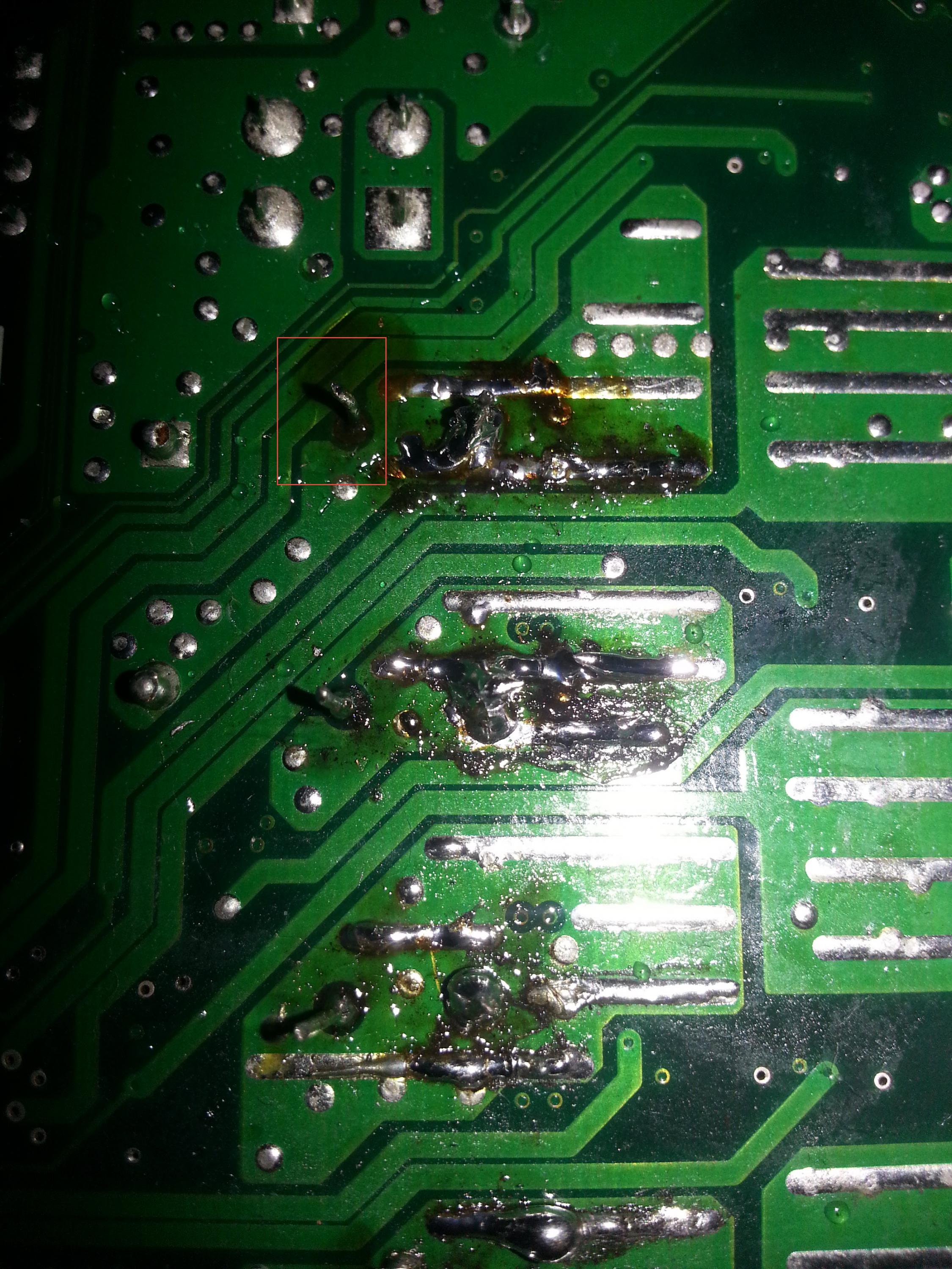

          #84
          Re: What is a mechanical solder sucker?
          Ok, thanks for the help. Here is a picture of the capacitors I am trying to solder in. I squared the area of the one that I think has a lifted pad.
            • 31283
            #85
            you lifted the surface-pad, but the sleeve is still in the board,
            you can flow solder down the leg of the cap into the sleeve.
            btw, get some damned IPA and clean the board!

              #86
              I was thinking that my 1.2mm solder might be too thick? If I purchase 0.8mm solder, should I use lead free solder or buy leaded solder? I know lead free is harder to work with but is there less chance of having a cold solder joint if the board uses lead free solder?

                #87
                Smaller dia solder might help in some cases but if your pics are an indication of your skill then you need to practice a lot. Lead free is not harder to work with provided you know how to work with it, and there again that takes practice. For you I say stick with leaded rosin core and not complicate things. 60/40 is ok but 63/37 is better.

                        #91
                        A steel pin may stick but you should be able to turn it out. Multi-layer boards present more difficulty. You have to get the spot hot enough and fast enough to not damage the board and still work. It's about temperature and timing. Remember, these boards were soldered quickly by a machine. They may have been pre-heated before soldering as well. They were not made with component level repairs in mind.

                                  #96
                                  Well thanks for all your help, I figured out a technique where I apply flux to the solder on top of the vias to be clean and then I align my safety pin and I apply heat with the iron. The the pin goes through almost like butter and I then wiggle it and pull it out and it clears the hole.
                                  Now some of my caps are the right capacitance but too big physically for the ones they are replacing(1800uf 35v instead of 6.3v) or they hit each other side by side, if they don't touch the board does it matter if they don't interfere with other components on the board?
                                  Oh by the way, nothing is soldered yet.
                                  Here is a pick below

                                    #97
                                    Now that I think of it I think these caps will be in the way of the heatsink so I will order some new ones 8mmx8mm. If I replace polyester caps with aluminum caps would that be ok? The only ones that would work from digikey are aluminum caps 680uf 6.3v and they are 8x8mm.

                                          #100
                                          Originally posted by stj
                                          no
                                          polyester caps arent polarised, electrolytics are.
                                          unless you mean polymer
                                          Sorry I meant polymer.
                                          Originally posted by SteveNielsen
                                          I would not replace polys with aluminum electrolytics. They have some different properties and the designers of the board decided to use polys for a reason, otherwise they'd have gone with less expensive aluminum caps.
                                          Actually it's the other way around. Right now I have aluminum electrolytic and I'd like to replace them with aluminum polymer capacitors, would that be ok? I can't find 680uf 4v caps in aluminum electrolytic only in aluminum polymer. I can find 680uf in higher voltage like the ones I have now but the dimensions are usually too big and I don't think they would fit.
