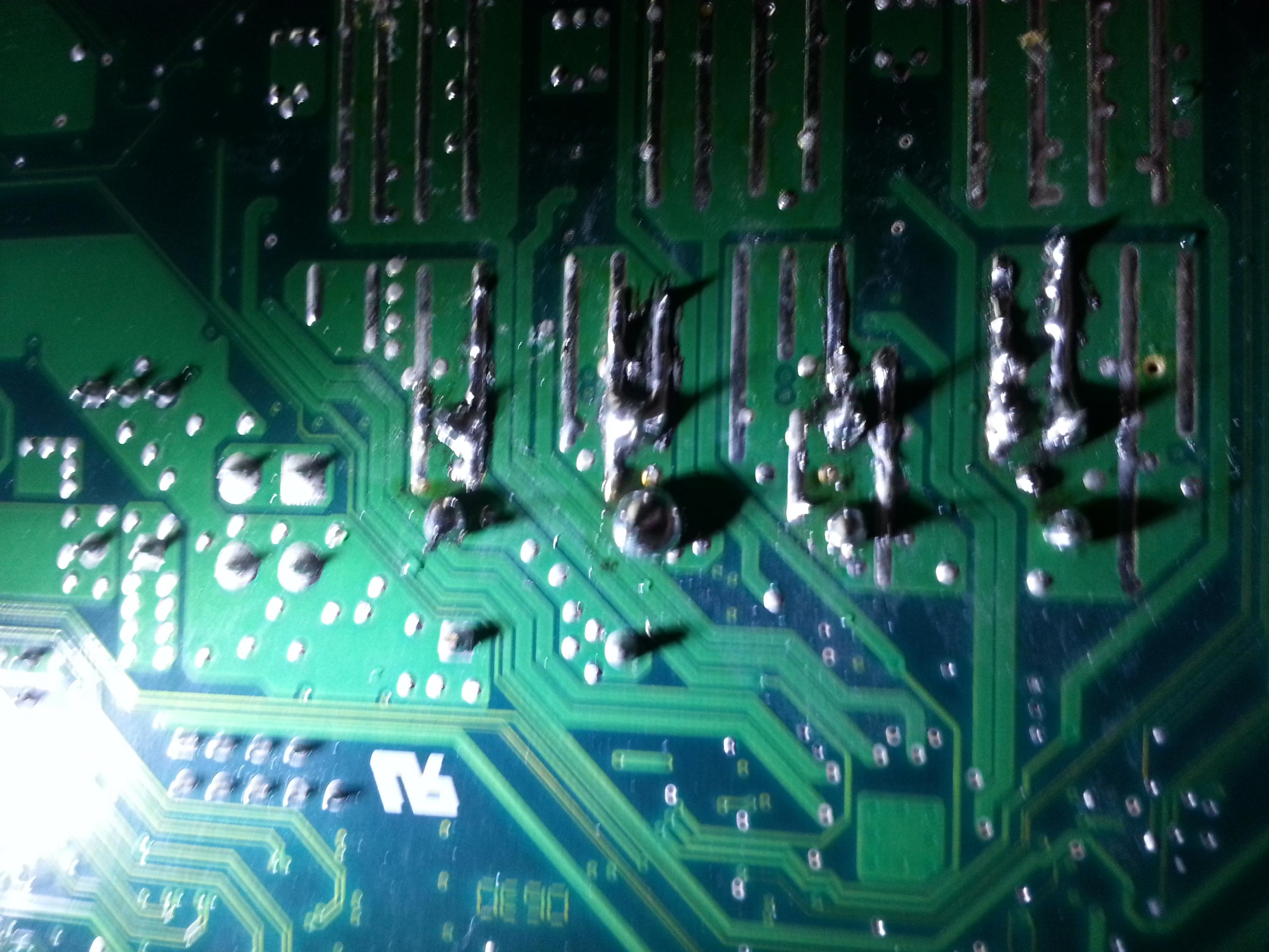

        ok and according to my picture, what would be the easiest way to remove that excess solder that was dragged across the pcb? Should I buy some flux and add it to the solder wick so the wicking will be a lot easier?

                the excess solder is only on areas that dont matter, there is no short.

                  Oh, ok. Yes they don't appear shorted but a tad sloppy is all. Depends on how much of a perfectionist one is. I've seen (and done) much worse

                    point is, those exposed strips are supposed to be loaded with solder to increase the current flow on the tracks.
                    you dont want someone cleaning them off with braid!

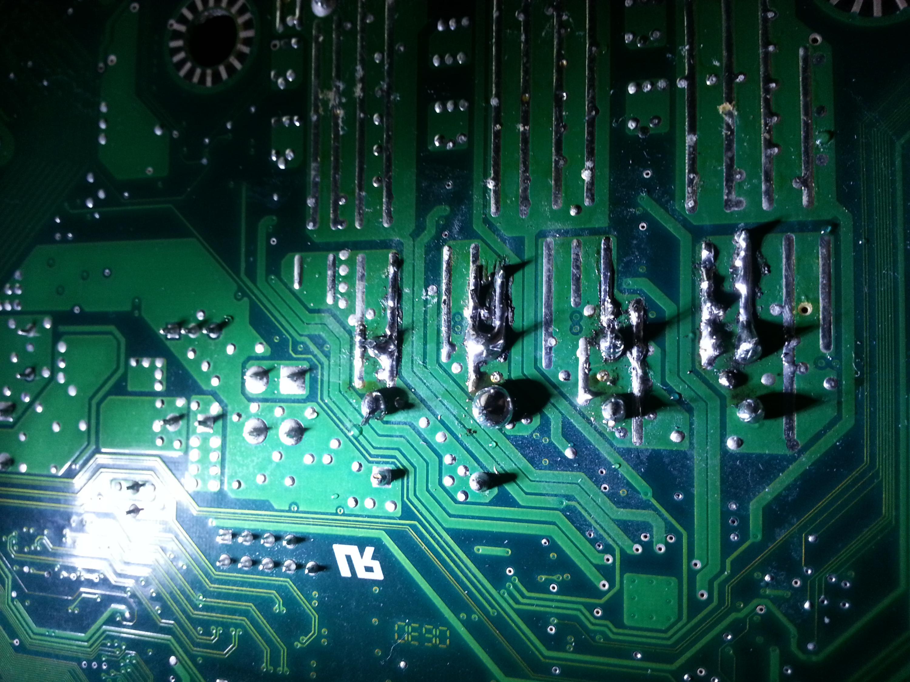

                              How do these joints look? I know they are not too nice but are they acceptable?

                                wtf, it looks like an adjacent solder track has been bridged with solder. it also looks like u got a huge spherical blob of solder in the center and its also bridging an adjacent pad.
                                a good joint should look conical, bright and shiny like the ones on the left of the picture. it looks like u put too much solder on the center one. if u got a circular solder blob instead of a conical one, u have to desolder the cap, clear the hole again and try again. or if u are lazy, just try to use the sucker to remove some of the excess solder.

                                  Well there is something I am doing wrong, either too much heat(852F) or solder too thick(1.2mm)? When I apply the iron to a solder joint, it doesn't transfer heat to the solder it seems, I always have to add a little fresh solder. There is something I must be doing wrong every youtube video I checked they just touch the capacitor leads and the solder melts after 1 second.
                                  I also notice when I apply heat to the pad and the lead, the heat never seem to transfer to the other side where I apply solder. I always need to apply a little bit of solder to the tip while touching the pad and lead and then it begins to melt on the other side.

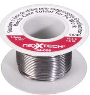

                                    show us the solder label btw.

                                        the solder is 60/40 with rosin-based flux - so looking at "real" brands for data.
                                        http://www.rapidonline.com/Tools-Equ...der-Wire-30236
                                        http://www.rapidonline.com/Tools-Equ...er-60-40-30459
                                        so there's your temps.
