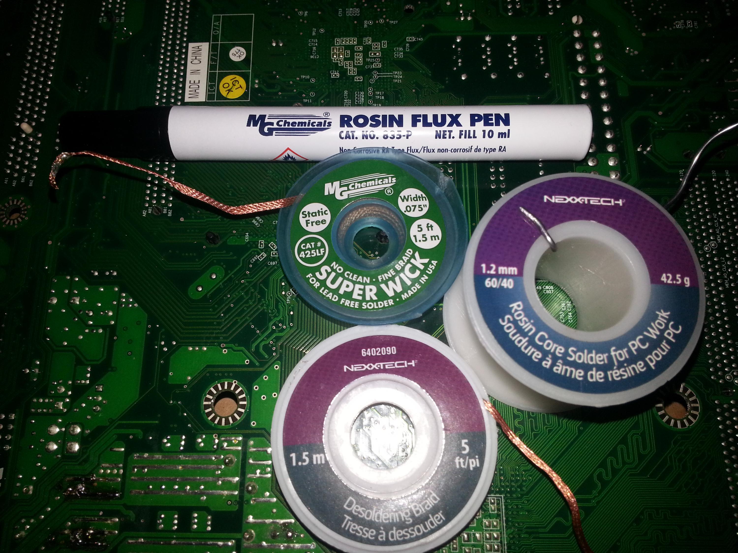

                                      • johnnyh55
                                        • Oct 2015
                                        • 44
                                        #59
                                        Re: What is a mechanical solder sucker?
                                        Ok so I took a picture of everything I am using right now. I also bought a 3.2mm chisel tip today, it seemed to help but I still can't pick up all the solder that i need to pick up. I tried both wick's to no avail. I also noticed sometimes when I tin the tip, the solder that was added to the tip gets transferred to the board and I end up with excess solder, is there something i'm doing wrong?
                                        I know the super wick says for lead free solder but I don't know what kind of solder was originally used on the board, the nextech one doesn't meantion lead free but wether I used one or the other, it doesn't make a difference.
                                          • 31283
                                          #60
                                          well the flux is o.k.
                                          the mg braid is good, but probably not for this type of work.
                                          the nexxtech junk is a mystery.
                                          personally i would be using a pump - i'v never got braid to work on something large like that.
