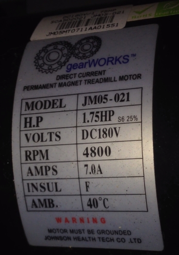

                  Unfortunately, as I've said above, the treadmill is in a room that I cannot remove it from, nor do I have easy access to it.. When I brought in the battery this evening my plan was to confirm that the motor was working, and then take away the motor controller board with me.. I was more than a little surprised to find that the motor would not turn...
                  This is a picture of the motor label.. It's a permanent magent DC motor, and I presume that there's a commutator with brushes, and that that is what is causing the sparking... It is not easy to picture IN the treadmill, but it is almost identical in form to the picture in my first post..
                    • 30965
                    Re: Treadmill motor not working
                    you lost me.
                    that says 180v
                    your testing with 24v
                      This motor can be tested with 24VDC just to see if it will spin.
                        Originally posted by stj
                        you lost me.
                        that says 180v
                        my 230 volt drill spins on 24 volts just slow and very low torque.

                              Hi guys, I got that idea for testing the motor with 24V on this site, but it seems to be commonly done to test the treadmill motor with the 19.2V battery from a powertool... https://www.youtube.com/watch?v=sdR4JGcygnQ
                              @JonathanAnon, did you hook up the batteries to the Red and the Black wires?The dcr of the motor will be VERY LOW.
                              Yeah I hooked them up properly. I put two 12v batteries in series with an inline fuse, and put a couple of male spade connectors on the end. Measured 24.6V dc on the spade connectors and then connected them to the female spade connectors of the motor. I found it very hard to get a DC resistance measurement. Only in one position could I get a measurement of 216 ohms, and in every other position it measured in the high K ohms. I would have assumed that I should be getting the same low resistance measurement across commutator / coil / armature in each position.
                              next step is to pull out the motor and get a look at the commutator / brushes. Cant seem to get those motors online. I'm trying to learn about DC motors anyway, so this is great practice.
                                It sounds like you have bad winding or brushes:
                                Typical treadmill motor http://www.mc70repairexpert.com/default.html
                                It should be VERY LOW Ohms.

                                      Yeah, I'm gonna have a look at the commutator... But I would have thought at the very least that in certain positions I would have got a good resistance measurement... Unless there is huge amount of damage to all parts of the coils or commutator..
                                      I did that other test, where you change to volts DC, hook up the red and blue to your probes, and spin the motor with your hand.. I was getting 2-3V as it turned.... But I'm not sure this test is of much use... I would have thought that testing the resistance would be a "purer" test of the state of the rotor.
