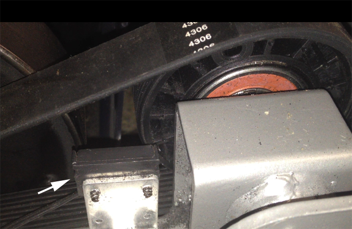

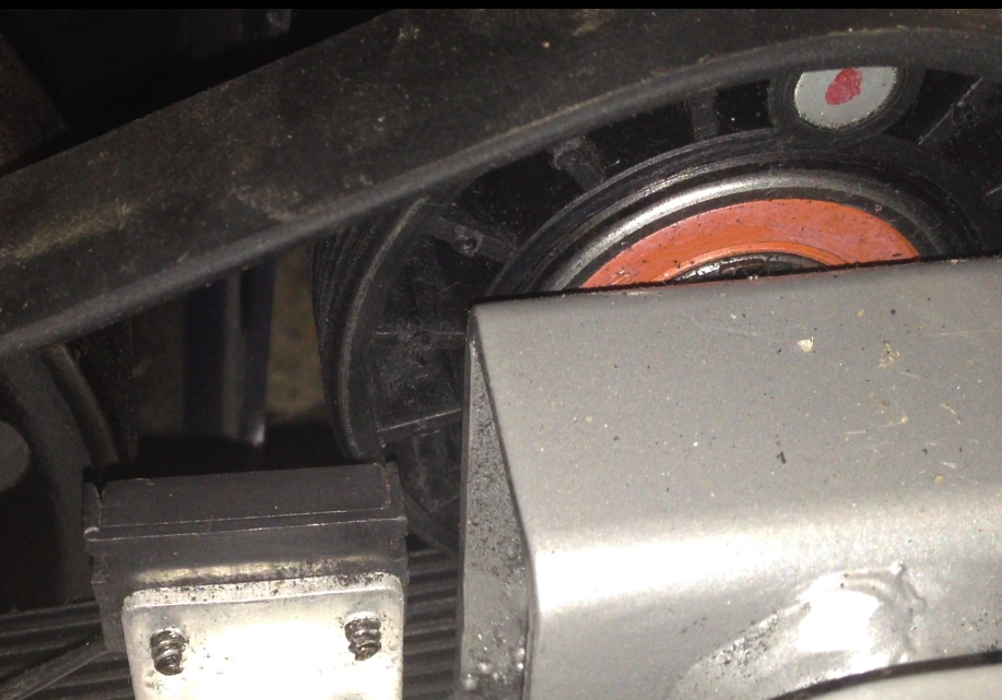

                                    #37
                                    Re: Treadmill motor not working
                                    Hi there Xelectec, I thought we were the last to get broadband here in Ireland!!
                                    Attached is a pic of the sensor..
                                    I pulled out the board this morning. Soldered a few cold lookings joints and checked a few components but it's like looking in to the abyss without a schema.. Gonna look for one now.. It's a JohnsonFitness JDYF07L.

                                      #38
                                      I don't recognize the sensor, or see how adjustable it is; however, the portion of the pulley right below the belt's marking of '4306' looks like a place where a magnet could go (that round serrated-looking hole), so I'm guessing that the magnet fell off; could be wrong
                                      though, wouldn't be the first time.

                                        #39
                                        I've adjusted it every which way but it shuts down as soon as the magnet rotates past the reed switch.
                                        That's what I thought at first as well... But there IS a magnet in the front roller as you can see from the attached image. I also thought that possibly there was meant to be a second magnet in that "round serrated looking hole", but I've looked up lots of videos and manuals and there should only be one magnet. The second image that I've attached is the stock image of a brand new front roller..

                                          #40
                                          Could be right
