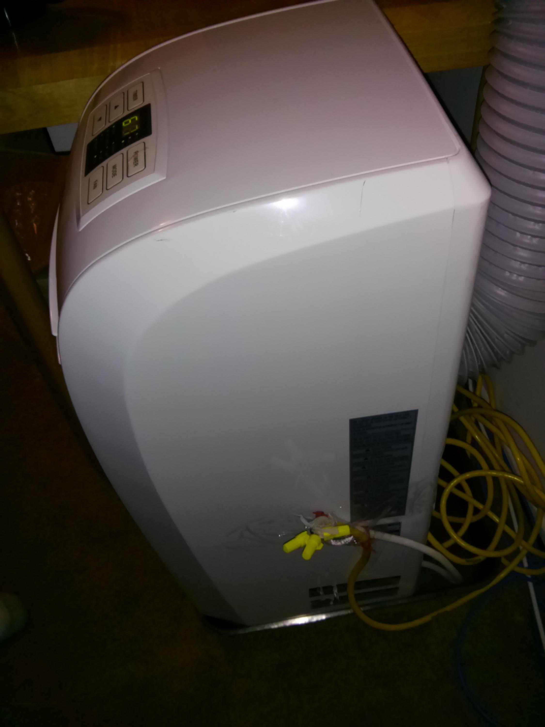

    Hi BCN peeps...
    Finally got an AC for free from work... in the owner of the recycling place's words: "you can fix it, you can keep it"...
    So, I did a ghetto repair job using those yellow twisty caps and a random yellow extension cord, and yay, it works perfectly. (a friend with a car helped me get it home)...
    Anyway, pushing almost 900W (measured with my kill-a-watt) the unit's only rated at 820W but it goes over... I don't trust my ghetto repair...
    I came up with an idea I think is a good idea since I don't trust the yellow twisty cap thingies and I don't think electrical tape would be good enough either...

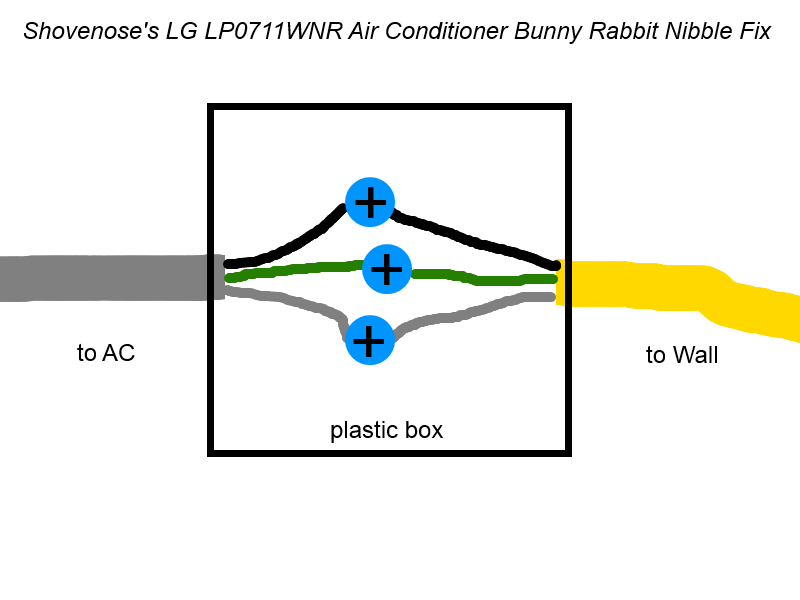

    I want to make screw terminals inside a plastic box to connect the two ends of the cord...
    Where could I get this plastic box and would that be the safest option? Also, can I keep using this extension cord (it's copper and looks to be of decent quality) or do I need something special?

    Re: Shovenose's LG LP0711WNR Air Conditioner Bunny Rabbit Nibble Fix
    You may be able to get something like (20A rating) this at Electronics Plus or from Mouser, I use to get them from HSC in Ronerth Park.
    http://www.mouser.com/ProductDetail/...nc7h8GLZHdk%3d
    I would get the 3 terminal but do not use the middle one for more clearance between L and N, the ground wire then attached directly to the chassis with ring lug, use 12AWG wires if you can. I would not use it without Grounding the chassis since it not likely to be double insulated unit and it will have moisture built up inside the unit.
        You can mount that terminal inside the protective plastic box, that terminal block will be screw mounted to the box/chassis. It's the grounding that is important or you can plug it into GFCI outlet for ground fault protection.
          I don't follow - could you please make a doodle for me?
          Thanks,
          shove
              You can get plastic junction box and cable clamp from HD: for example
              http://www.homedepot.com/p/Raco-3-4-...u#.UfKhbtK1FQA
              http://www.homedepot.com/p/Carlon-4-...7#.UfKhvNK1FQB
              Then get the terminal block to mount inside the box.
                    I wouldn't trust that extension cord, not one bit!
                    The startup current of the compressor motor is quite high ... it will make the lights in your house dim!
                    My dad is a firefighter and I have seen WAAAY too many devastating house fires started by A/C units used on an extension cord! We had one fire just about a block away from where I live ... the friggin owners have abandoned their house and it is just sitting there, rotting away... >
                        get a nice heavy 12/3 cord and connect it inside the unit properly.
                        the wattage demand will change with line voltage and temperature.
                        if you get 20 or more degrees drop from room temp its fine.thats how i test units i repair.
                        2 digital thermometers.1 in the room and one in the vent.
                        if you forsee needing a longer cord get the right length for the job now.
                        NO EXTENSION CORDS!

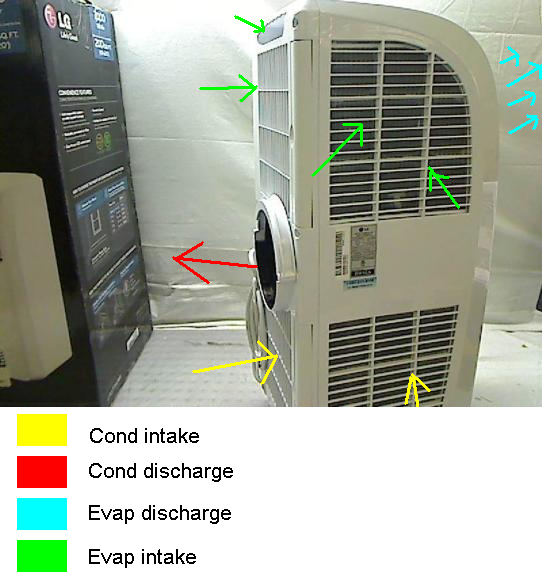

                              Regarding that hose going out the window:
                              That's the discharge air from the condenser. Where do you think it's pulling intake air from? That's right, your house!
                              When these units got popular a few years ago, there was always the "convenient" omission of the fact that these units will pull hot, outside air into the very house/area you're trying to cool! When only places like Grainger were selling these, that fact was made clear.
                              You should find a large knockout on that back panel to connect the "optional" (should be mandatory) condenser air intake.
                              Sorry, but those things are just disgustingly marketed. Originally, "portable" aircons were used to provide "spot cooling" in factories, garages, bakeries, etc, where there was no penalty from using indoor air to feed the condenser. But because of rotten things like QVC, these units and their cheaper "derivatives" began to be pushed on homeowners.
                              Get that condenser intake duct and stop pulling hot air in, only to have to cool it! If you've got a Lowes or Home Desperate nearby, they'll have flex duct you can use.
                              I'd go with 8", and uninsulated...
                              Also, when (not if) you redo that splice (properly), resolder the relays that control the motors. Do this even if they look ok. Cheep little boards such as the ones in there are, well, cheep. And check the wiring, too! Appliance makers like to "cheat" and use wire sizes that normally wouldn't be code. I know that higher temp insulation can allow a fudge factor, but there's still the problem of the terminals being a weak point.
                              Get some CRC 2-26 and undo each terminal. Spray a bit on and then reconnect. I see too many high-resistance connections in both ACs and space heaters. Very "accident prone."
                                Um... OK?
                                Besides the fact you probably just explained why thing is almost entirely useless (yes, it barely lowers the temp of my room when it's hot), I'm entirely confused as to what motor relays have to do with rabbits chewing on power cords?
                                PS: no, there's nothing on the back to connect another tube to.
                                  Originally posted by shovenose
                                  Um... OK?
                                  If you're gonna open it up to replace that power cord, you might as well inspect all the connections for oxidation. Clean and/or repair as required. Units having electronic controls will use relays to switch power to the motors, and also change speed taps for the fan motor. I prefer preventive measures, which is why I mentioned the 2-26. There's also "dielectric" grease you can use- seals out moisture from the connections.
                                  Some relays are soldered to a board, others have only the coil and power feedthru (to operate the control) terminals soldered, with the hot and switched-hot-out have terminals on the top of the relay.
                                  Uh-oh. I hope that thing doesn't use a single air intake for both the evaporator and condenser. If it does, there's probably no easy way to run the condenser on outside-air-only!
                                  So your room temp actually goes up when you run this thing? Or stay the same?
                                  BTW, what's the voltage at the unit with compressor running? Just "backprobe" those wirenuts. I wonder about voltage drop in the ext cord.
                                    BTW, what's the voltage at the unit? Just "backprobe" those wirenuts. I wonder about voltage drop in the ext cord.
                                    Room temp goes down 0-3C depending on whether I'm standing right in front of it.
                                    The entire left side of the unit is two big intake vents. I'm assuming that's the intakes you're referring to?
                                      See my edits.
                                      It looks like those two lower intakes feed the condenser and its fan. You may verify this by putting into "fan only." Do not perform the following test with the compressor running!
                                      With only the fans running, block off the round discharge hole where the flexduct normally connects. With that blocked off, you should feel nearly zero suction on those two lower intakes.
                                      If you can confirm this, it's still possible to feed that condenser outside air. Like it should've been originally.
                                      Come on, LG, no provisions for that? Wow.
                                      You'll need to make or buy something to adapt a flexduct to those intakes. Either plywood boxes or something called register boots.
                                        See my edits.
                                        One problem: not enough space in my room to put something around it!
