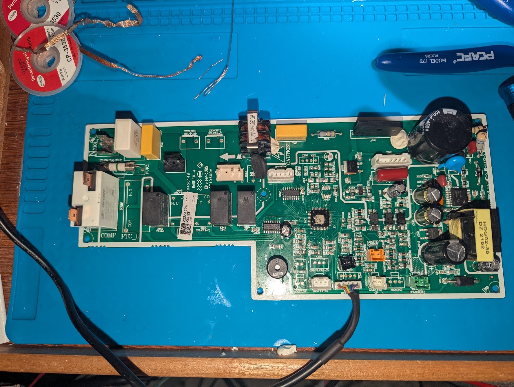

    I just acquired this portable aircon, history unknown. Its behaviour is quite strange:
    • When turned on and placed into cooling mode, the upper fan (cold air out) just spins slowly. The compressor and lower fan do not run.
    • If the device is then placed into heating mode and then back into cooling mode, the lower fan and compressor kick in and start cooling, but the upper fan still only spins slowly.
    • If the device is placed into fan-only mode, the upper fan does not respond to low/medium/high speed toggles - just keeps running slowly.
    • Display and buttons all behave normally aside from the malfunction.
    Here is what I've done so far:
    • Replaced all the caps except the big filter cap (they were junk AiSHi caps). No change in behaviour.
    • Checked +5V, +12V, +15V and +18V rails referenced to appropriate grounds - all within range

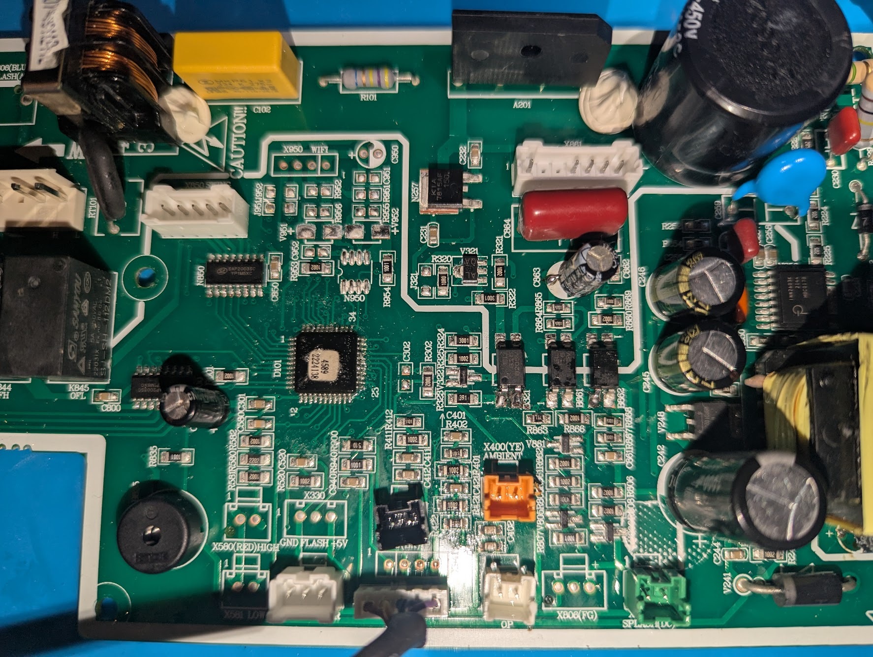

    • Noted the middle opto is not activated. If injecting 1.2V into pin 1 of the opto the upper fan motor makes a revving noise but the fan doesn't actually increase in speed
    • Measured the upper fan voltage outputs - VDC = 330V, 15V = 15V, FG ~ 10V, VSP ~ 3V - regardless of whether the speed toggle is set to low, medium or high
    Drawing a blank with this to be honest, I have been tracing the whole board trying to find any readings that correlate with the low/medium/high speed toggle but can't seem to find one. I am starting to think the main control IC is hosed but I haven't had any luck tracing the pins just yet, partly because I am having trouble removing the conformal coating. Pics attached - note the iffy looking solder around the optos is just from me lifting the legs etc, I had a good up-close look at the board before I started working on it and did not see any abnormalities. The main components include two SAP2003SC transistor arrays (one seems to control the small vent cover motor and the other controls the relays), a 48 pin unknown control IC, and an INN2063K flyback switcher.

    Update - I've since disconnected VSP from the upper fan and injected voltage into it from a bench supply - it does respond to voltage increments so it appears to be a fault in how VSP is generated
    Update 2 - the lack of VSP appears to be a GPIO fault, I've ruled out everything downstream of it. I can activate the fan by pulling BC807's base to ground through a 10K but it still doesn't seem to respond to low/med/high inputs and I can't figure out what is supposed to be generating them? Another dead GPIO pin perhaps?

            Does it have a programming port?
            • spleenharvester
              • Mar 2010
              • 921
              It has that three pin unpopulated spot marked 5V/flash/GND, I assume it's that if anything but I have no idea what kind of interface that is. The only other thought I've had is maybe the frequency generator pin (FG) has something to do with it. They went to the effort of putting an opto in to communicate with the logic level side but I can't seem to figure out what the purpose is, the machine doesn't behave any differently with it unplugged and VSP seems like it's supposed to be controlled entirely from the display interface

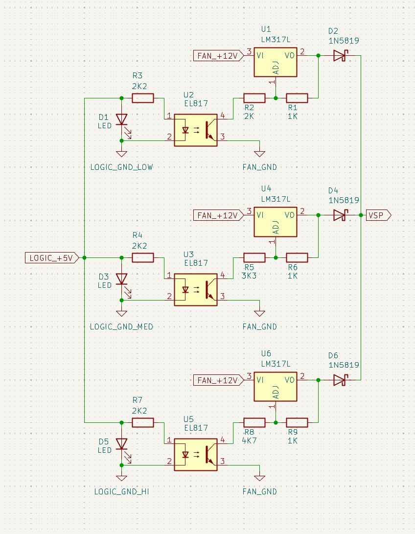

                  So I'm building a bypass circuit based on LM317 to read the status from the LEDs on the control panel and pass 3V, 5V, or 7V to VSP accordingly.

                    Unfortunately I couldn't make the bypass circuit (turns out the LEDs only run on 0.4V which is insufficient to run an opto from, and logic ground is not tied to system ground). So I troubleshooted the board a bit more and basically ended up ruling out or replacing everything in the VSP signal path except the MCU, and I can't find any other points on the board to determine what setting VSP should be based on the panel LEDs, so I've had to settle for keeping VSP pulled up to 7V permanently. But before I closed it back up I got some more information for other troubleshooters in the future. These are the error codes that occur when various things are unplugged (not exhaustive!):

                      • 31278
                      what is the mcu part number under the sticker?
                      • spleenharvester
                        • Mar 2010
                        • 921
                        The etching is gone so no idea - I had to remove the conformal coating to remove the sticker with acetone and the process of doing that seems to have erased it.

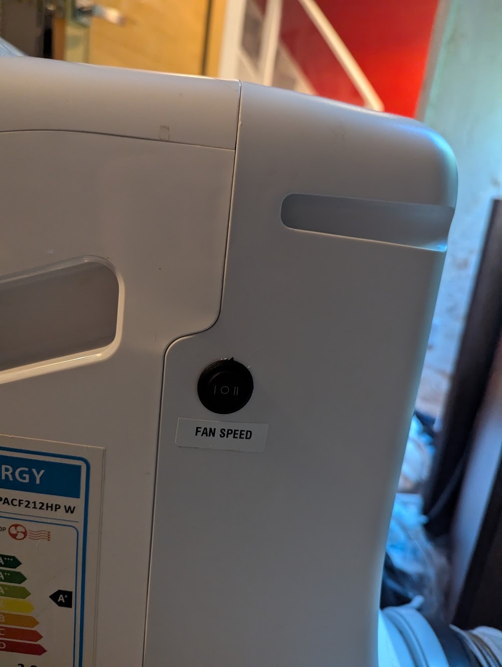

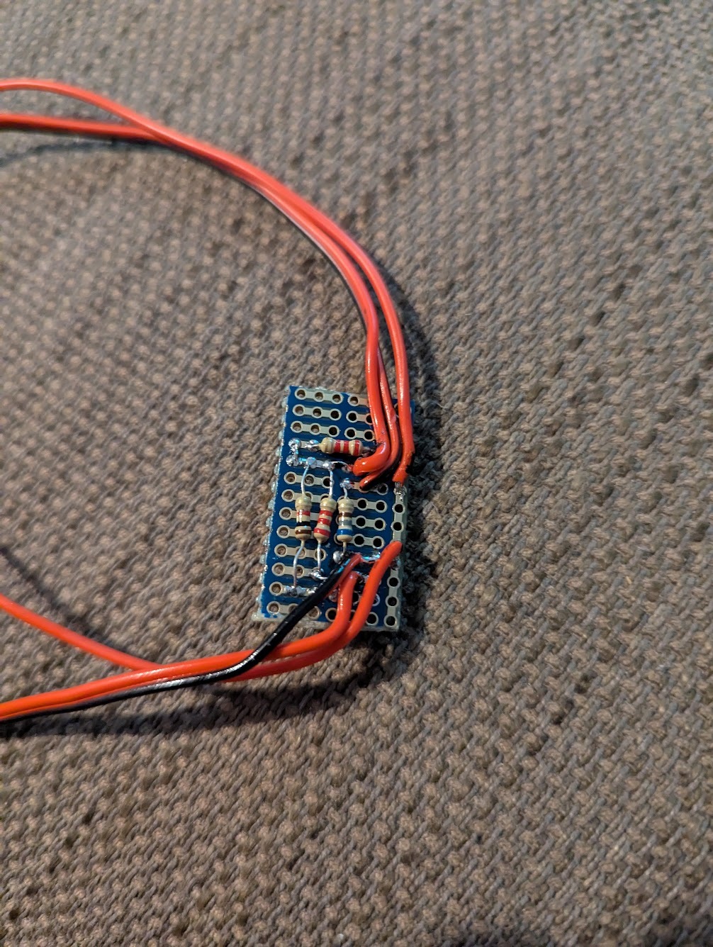

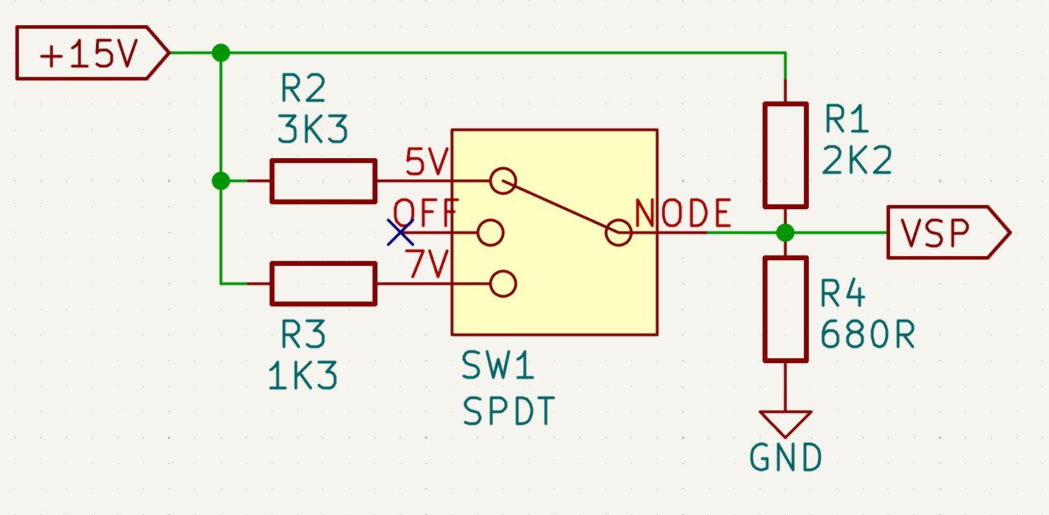

                            Revisited this as I wasn't getting good performance out of the unit with the fan on the highest setting, and I had a theory that the air was being turned over too quickly to be properly cooled down (together with it being quite an inefficient unit and the hose being 3.5M to the window).
                            I built a really simple circuit out of 4 resistors and an ON-ON-ON SPDT rocker switch. From the crossflow fan cable I took the +15V and put it through either a 2K2 + 680R, 2K2 + 680R + 1K3, or 2K2 + 680R + 3K3 potential divider to feed either 3V, 5V or 7V to VSP depending on the position of the switch. Replicates that low/medium/high toggle without messing around trying to piggyback off the display panel LEDs etc.
                            Does seem to perform better with the fan on low, but no better than my 7000BTU Black & Decker conditioner (the PACF212HP is 12000BTU). I think there is probably just diminishing returns on the amount of heat transfer with the hose being this long (it gets very hot along its whole length).
