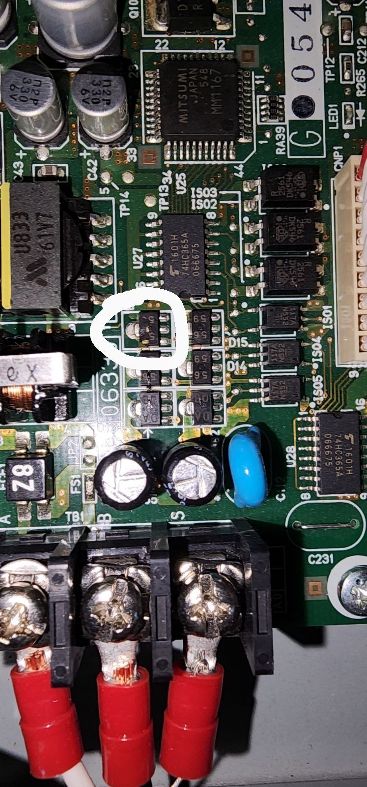

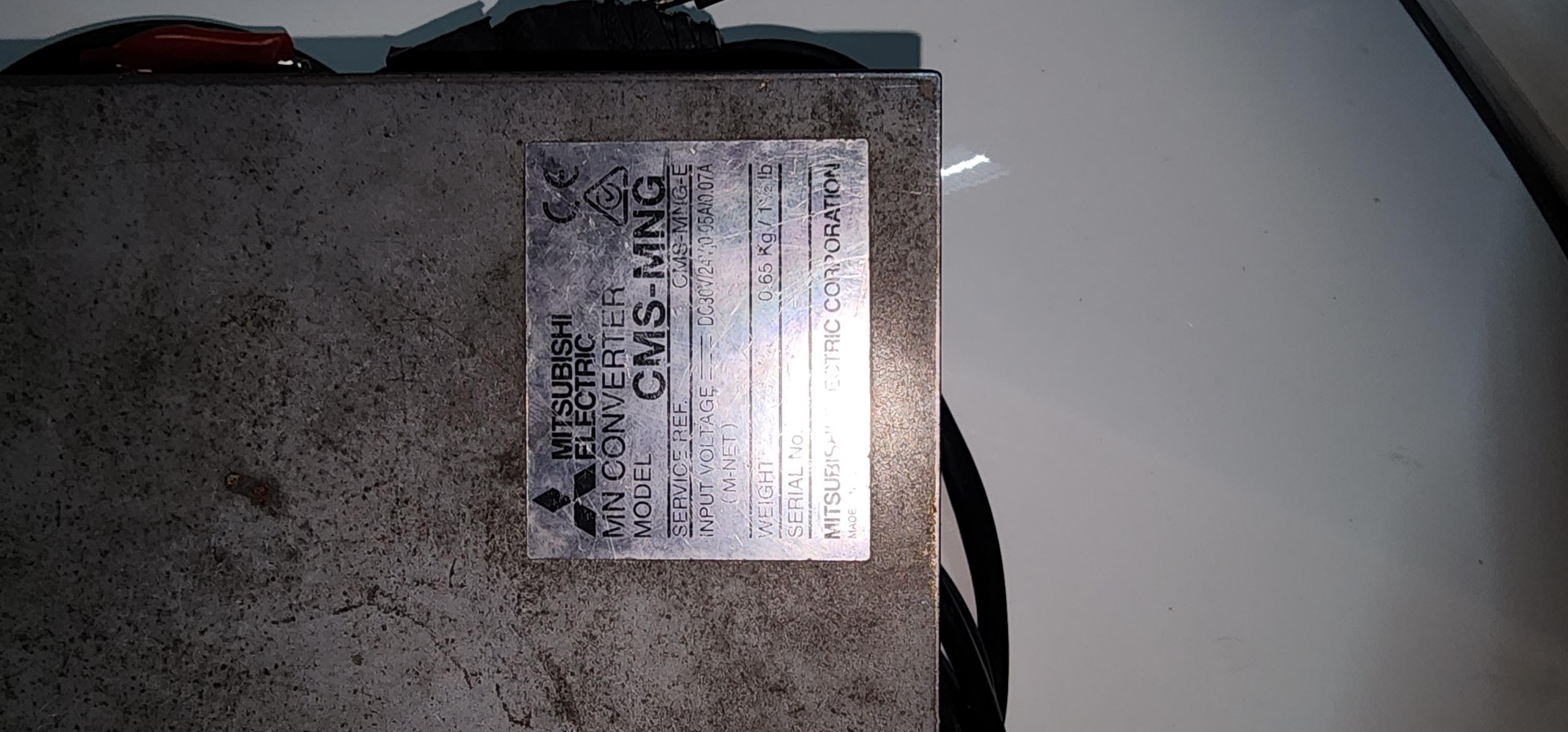

    Looking for a component labelled 56 on top 59 on bottom. It's from a MITSUBISHI ELECTRIC Air-Conditioner Network system. Thanks!

    They seem to be Renesas Technology RD56P-T1-AZ zener diode

      Re: Help identify chip MITSUBISHI ELECTRIC Air-Conditioner Network system
      How do you know? I'll see if I can find them. Thanks again.

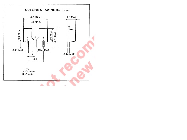

        BZV49-C56 could be a replacement, check the datasheet and see if it matches, Pins 1 & 3 are likely connected together
        The part is obsolete but I found a case style used on there lower voltage zeners that has pin1 NC

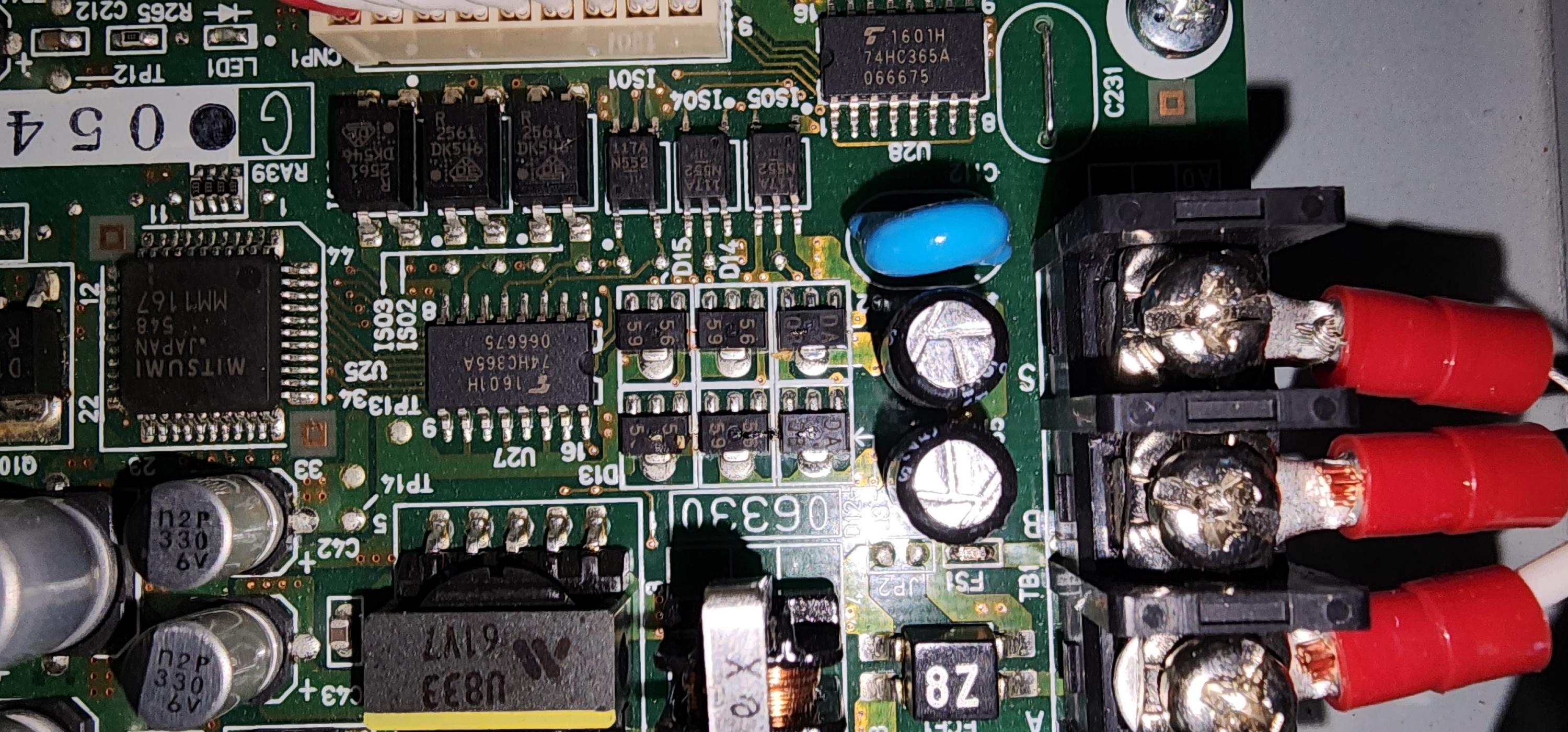

          it's there for protection, find out why it blew up first.
            The guy plugged in AC instead of DC. The diodes did their job I guess.
