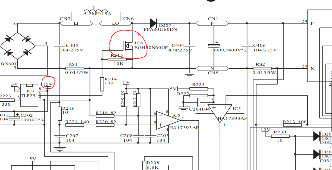

    I have an air conditioner outdoor control board that I'm trying to understand how it functions. In short, the board takes in 240VAC and splits it into 4 other wires, 2 of these go to power the indoor unit and another 2 go to power the outdoor unit module board. the 310VDC capacitor bank on the outdoor control board get charged up from a rectifier on the outdoor module board. Now what I can't wrap my mind around is the fact that there is a relay in between the 2 mains wires that go from the outdoor control board to the outdoor module board which is normally open, what this means in theory is that the relay can never close as the 12v needed for it's winding to energize is generated only when there is sufficient 310VDC. Unless of course the 12v needed is generated on the control board itself however I could not find a separate supply from the schematics.
    Any help would be greatly appreciated. I have also included the schematics below.
    https://cdn.badcaps-static.com/pdfs/...2306ad82cb.pdf
    pgs.14-15 show PCB(1) -outdoor control board- AND PCB(2) -outdoor module board-
    pgs.71-73 show the respective schematics
    terminals P and N in the schematics are the capacitor bank terminals (310VDC)
    I'm interested in this as the module board had a short on it causing the control board to go into what I presume is short circuit protection mode and I'm trying to figure out how to reset it as currently the main caps are not charging up.
    Thanks!

    +12volts and +5 volts are supplied by the smps on page 72, likely bad ic1 and shorted M1. The schematic is hard to read but I suspect PTC1 could be open. If PTC1 is open I suspect K5 relay contacts could be bad.
    Also check RS1
    If there was a short on the module board it was likely IC8 shorted or the main drive ic PM1

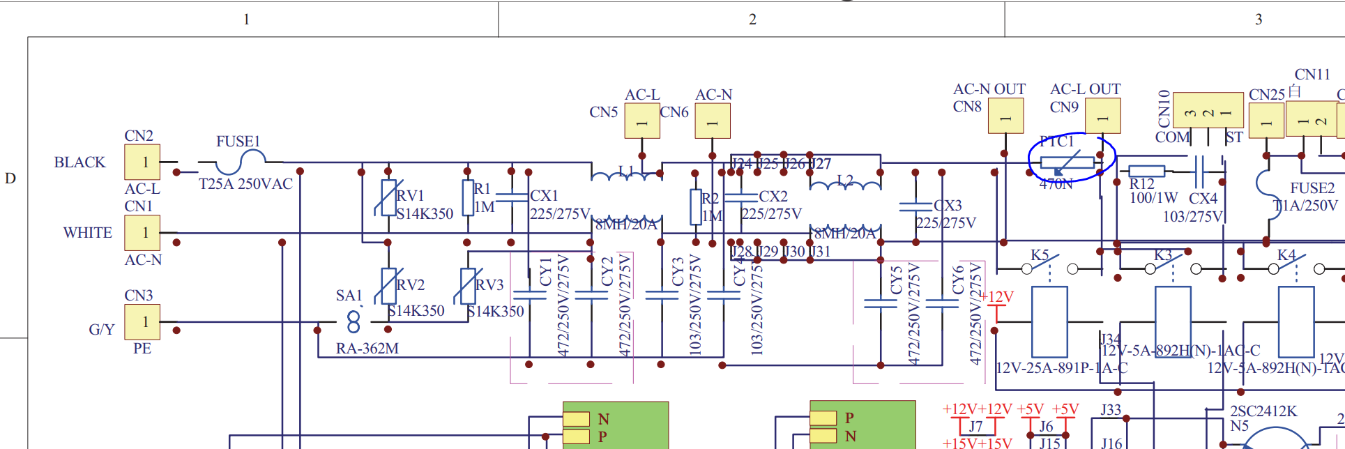

      Thanks for your reply, PTC1 is not open and is in fact 40ohm I'm not sure if that's a good reading as it seems a little high. RS1 checks out fine too. I'm getting 160VAC after PTC1 which I'm not sure should be the case I would expect it to be closer to 220. This results in 220VDC after rectification which is still too low. Am I looking at a fault PTC relay?

        Is the circuit more like an inverter, is the inductor connected to the board? Power passes through it to the diode bridge (sometimes there are two bridges) and a powerful IGBT transistor and to power capacitors, and the main power supply is already powered from them (check the IGBT for a short circuit).

          What is the a/c voltage before the ptc? You need to check between Neutral CN6 and CN5, then check between CN6 and CN9
          CN8 and CN9 supply the bridge rectifier BG1, The ac could be low because it is dropped by PTC1 until K5 shorts it out.
          You should have around 220 VDC across CN5 (N, ground) and CN1 P
          This voltage will be enough to power the smps circuit for the low voltage +5, +12, +15

            voltage at input of bridge is 160VAC which as you said is caused because of PTC voltage drop and between CN7 and CN5 which are the bridge outputs is 220VDC, currently this never reaches the P and N terminals as I have the inductor between CN7 and CN6 removed as it is inside the air conditioner housing and is disconnected, However going off of what you said, once I reconnect that inductor relay K5 should switch and short out the PTC giving full 310 to the caps. My main concern really was that the initial 220VDC would not be enough to generate the 12v 15v 5v rails needed for K5 to switch but you have answered that

              Yes, you will need to connect the inductor to get voltage across P and N. Page 72 shows the smps, it will operate with a wide range of dc input.
              You will need the smps to be working before K5 will operate

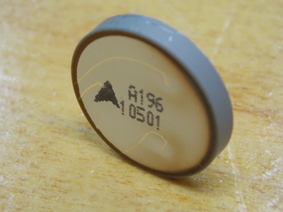

                          No traces were damaged I made sure of that. Apparently PTC1 is what's called a PTC relay mainly used in HVAC, never heard of it before but it's the only thing in the way of 240VAC mains reaching the module board. the 40ohm I measured where across it's contacts.
                          it looks exactly like the one here and is soldered on the PCB: https://www.indiamart.com/proddetail...113490830.html

                            PTC1 is an INRUSH THERMISTOR, it is NOT a relay. I know the hvac people call it one. K5 is the relay
                            Inside that black case is a thermistor disk mounted between two contacts
                            Have you checked if you get +15v, +5VD or +5V on the smps with CN22 removed?

                                  Check the IGBT transistor for a short circuit (and +15v power is important for it).

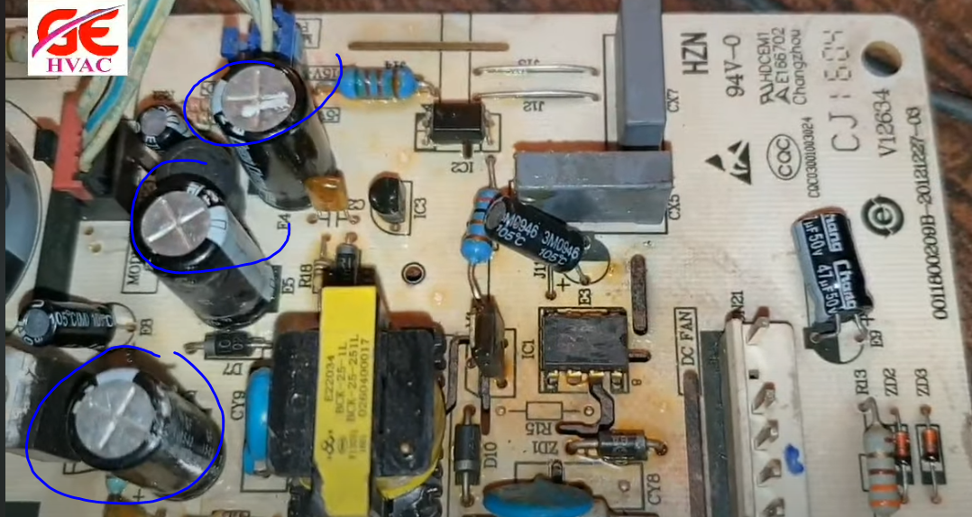

                                    below is a pic of the smps circuit as well as the 3 caps I replaced circled in blue.
                                    I suspect IC is dead as I didn't find a short on the FET, no short on the IGBT lotas mentioned either

                                      If the 3 caps were bulged I would also replace E3 22µf/25v as it is most likely bad causing the smps not to start.
                                      Measure the DC voltage across E3 it could give an indication of the state of the ic.

                                        I suspected E3 initially also so I removed it and checked it but it tested fine so I put it back in. I did not measure the voltage on it however so that will be the next step. According to IC datasheet VCC is generated by the IC from the HV so if that's not present then the chip is dead
