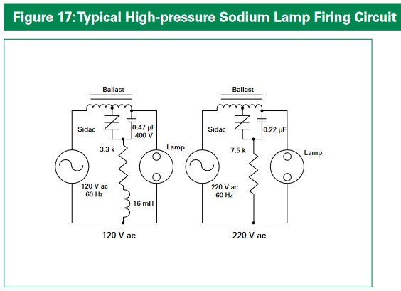

            • redwire
              • Dec 2010
              • 3900
              Re: High Pressure Sodium Yard light when air conditioner turns light momentarily turn
              I thought it might not be the lamp at all. The air conditioner voltage sag might be restarting it. The sag gets worse with old wiring and breakers, A/C start cap and compressor aging, the daisy-chain or wiring. I wonder if you could look at MIN/MAX voltage with a multimeter and see how much mains sags when the compressor starts? Or if these are all on one phase, is this 120V or 220V lamp and A/C?
              K1200 is a Sidactor or Diac as I call them, triggers at 110-125V, 120V nominal. It is moreso a trigger diode to start the lamp, not a protection diode.
              How it works is, when the voltage across it is high enough say >120Vpk, the Sidac avalanches and dumps the start cap into an inductor (or a 2-turn tap on the main ballast inductor) to make the 3-4kV spike it takes to start a HPS lamp.
              Once the lamp is running, there ends up being insufficient voltage on the start cap (due to voltage drop in the ballast inductor) to avalanche the Sidac, and it just sits there off.
              They are not the strongest part, I would guess they can age and their firing voltage goes wonky but it might also be the lamp voltage (impedance) going high with age, or the start cap maybe.

                    • redwire
                      • Dec 2010
                      • 3900
                      If the start cap fails low value, I think it will just struggle or fail to start.
                      Most are like motor caps: film caps but I do see some oil-filled ones out there. But these ballasts run hot and might be hard on them.
                      I read "High pressure sodium lamps require approximately one minute to cool before restriking." I doubt it gets this with the A/C causing false restarts?
                      If the ballast is failing, it gives the tube excessive current so short life and blackened ends I think.

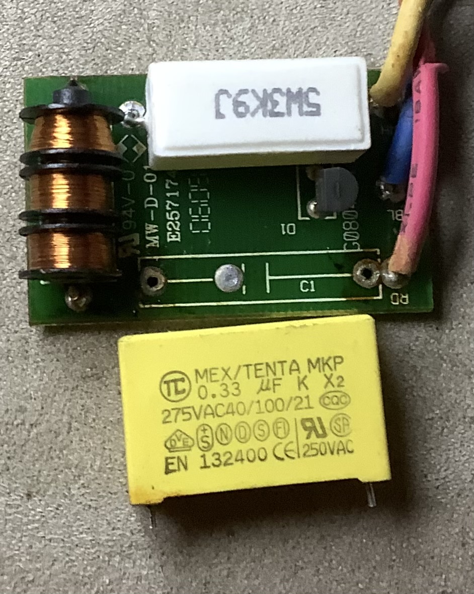

                                  • Jul 2011
                                  • 6024
                                  Here is a pictures of the ignitor board and capacitor that are on this board
                                  I have never looked up these type of capacitors can you please tell how I would find them on Digit-key so I can order some of them and see if this helps it works correctly again
                                  This is a newer looking board that I got from the place that I used to work at before they closed and a few of these light fixtures were doing the same thing every so often cycling when something would turn on in the building and it was also doing this at my house as well
                                  Remember that these light fixtures are probably about 15 years old by now

                                    Have you measured the capacitor and made sure it's bad?

                                      It measures around 0.31 but I am not sure that it good with a load on it so I would rather just replace them to rule out the possibility that this might be the issue

                                        Would this be a good replacement capacitor for this high pressure sodium light fixture that I have been talking about in the post above #16

                                        • redwire
                                          • Dec 2010
                                          • 3900
                                          No. It's the wrong value at 0.033uF and your pic and measurements are 0.33uF or 10x bigger. The lead spacing I see 22.5mm for the old part and PC board, or it will accomodate 15mm.
                                          B32922C3334M000
                                          495-2321-ND
                                          CAP FILM 0.33uF 20% 630VDC X2 305VAC LS=15mm.
                                          But I think replacing the cap will change nothing because the lamp starts OK and its value is still in spec.
                                          You have to replace the trigger Sidactor D1. Board says "G080xx" what part number is there.
                                          Digi-Key still has the K1200 in many different packages too.
