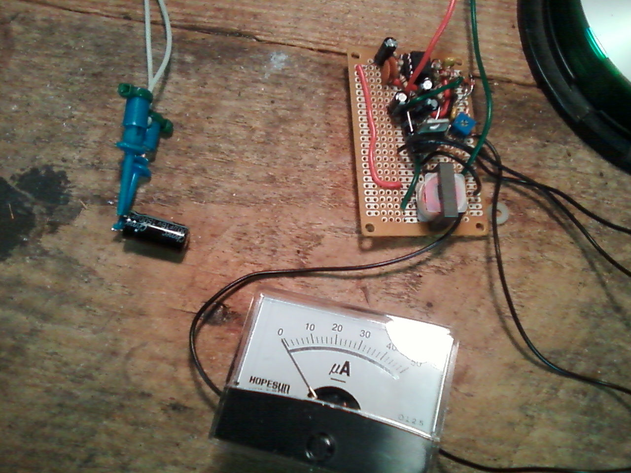

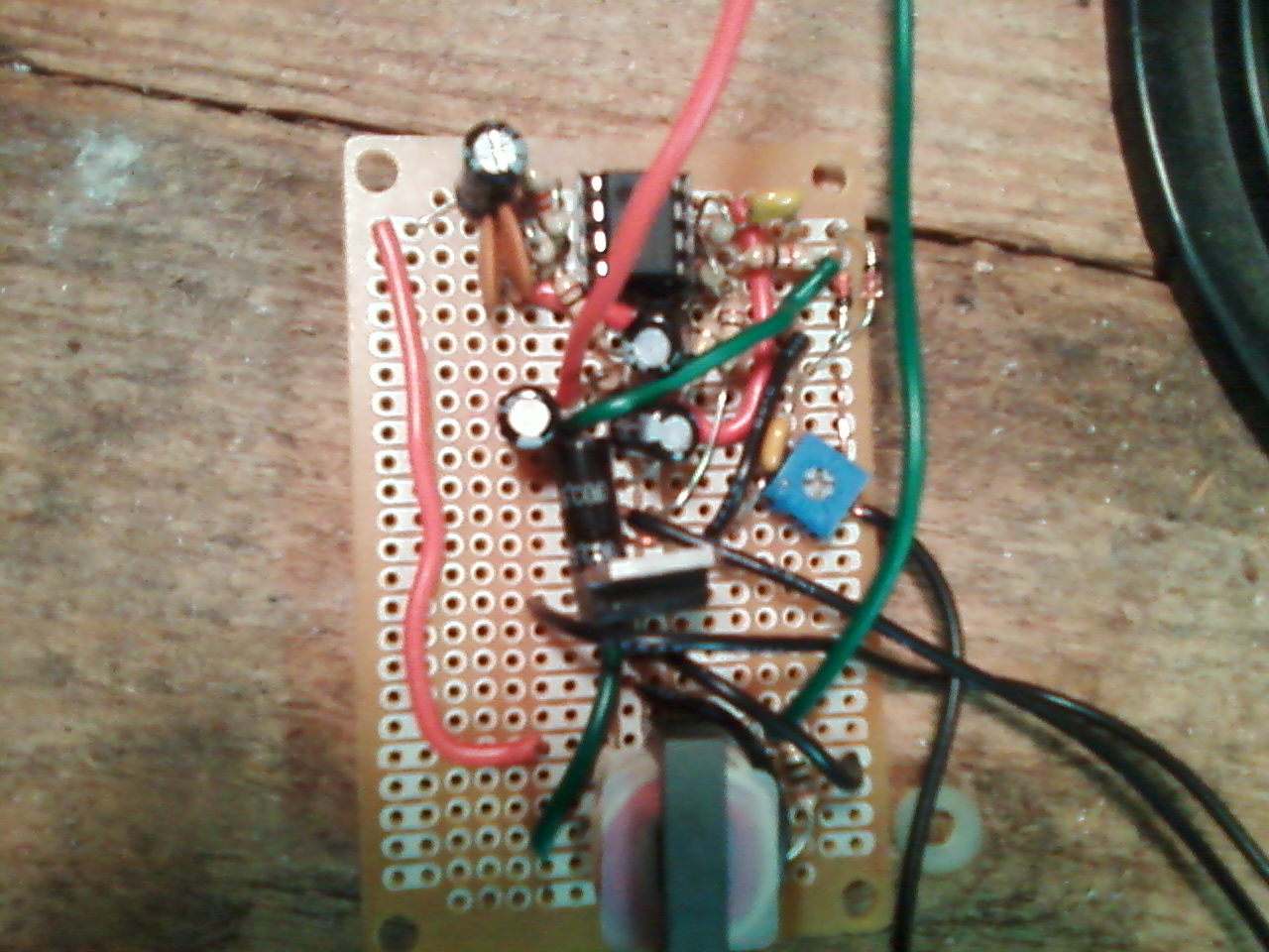

    Ok, I built an ESR meter using the schematic and instructions here (I think it's fairly popular, maybe one of you guys have built this before?). I've went through the process of tracing all the components through the circuit and comparing to the schematic, All seems well. The problem most likely lies in my knowledge of transformers, I ordered the EA-77-188 Tiny double E core and the same gauge magnetic wire used in the guide (AWG #36 and AWG #26). On my first attempt I initially started winding the #36 wire perfectly around the bobbin, each loop adjacent to the last winding. That is until I realized it would probably take at least an hour to wind 400 turns like this. So I kind of sped up the process of winding while negatively affecting the uniformity and neatness. I finished up with some masking tape and started the next run (20 turns of #26 wire). Again I used masking tape to finish up. I then slid the E cores into place (although I didn't glue them in any way). I then put the transformer onto my circuit board and applied voltage to the circuit. The needle on the uA meter jumps ever so slightly upon turning on the circuit but nothing else. I've tried a few caps and resisters on the test leads and adjusted the trim pot in every position. I'm getting a steady 5V on the board, but I haven't really found many other helpful results from other test points. I have an oscilloscope but I'm not exactly fluent in using it...

    1) When you say masking tape, do you mean paper painters tape or something else? hopeful you mean electrical tape.
    2) Did you check to see if the two coils were isolated, meaning no continuity?
    While the "E" cores don't need to be glued, they need to be wrapped with tape to hold them together

        Re: Help troubleshooting homemade ESR meter
        Are C2 & C3 installed correctly?
        - Neg of C2 to T1 // Pos to U1 Pin 1
        - Neg of C3 to test lead/R6 junction // Pos to R7
        You should also have 2.5v on U1 pins 3 & 5.

                    Ok, so I checked the caps and had to change one around, I didn't notice polarity was indicated in the schematic. I checked the voltages on the IC, pin 3 was around 2v and pin 5 was closer to 3v. I pulled the transformer off, the 2 coils are not connected shorted. When I check continuity on the 400 turn (#26) coil I get a high pitched tone from my meter instead of the normal beep and a reading of 19 ohms. I am going to *patiently* rebuild the transformer soon. Any tips on the actual making of the transformer? I couldn't find any help online. The first transformer I made I ripped the wire trying to sand off the enamel and had to start all over. Any help would be greatly appreciated, and I'm sorry it took me so long to get back to you guys!

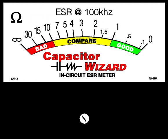

                      hello everybody. i need help to make my panel meter. i designed esr meter from this website
                      http://kakopa.com/ESR_meter/
                      and i think that's function. but i get problem with meter measurement. i try to fix my small vu meter with esr wizard i found on googling.
                      the problem is the panel meter didn't match the exact value with resistor i measure.. of course i think esr wizard don't have a same specifications with my esr meter. it was factory built of course with good quality
                      i just try anyway.
                      when i test 15 ohm resistor it just nearly 15 ohm on my meter. don't exactly pointed on 15 ohm . when i test with 10 ohm resistor it give me a same result as before i just try to modified value on that image with photoshop. but it didn't makes me satisfied enough.
                      so i think i need a software designing my panel meter. i try googling and got result Front Designer 3.0 but it just using Russian language. i didn't understand Russian language so the point is i want a software that could design panel meter easily and freeware of course.. hehehe.
                      please someone help me suggest a freeware software to design panel meter or if you don't mind u can send your software that u usually used for design panel meter to my email too.
                      i really want a professional looks on my esr meter.

                          You would probably get better results if you use a vector-based image editor like Inkscape or Illustrator
                              would u mind give me a link that i can download it? but hopefully it can free. maybe u think that im crazily man who is always wanna free software. but i just think i may using that software for a 3-4 times, not more. after my meter have been done. maybe i just lay it down on my computer

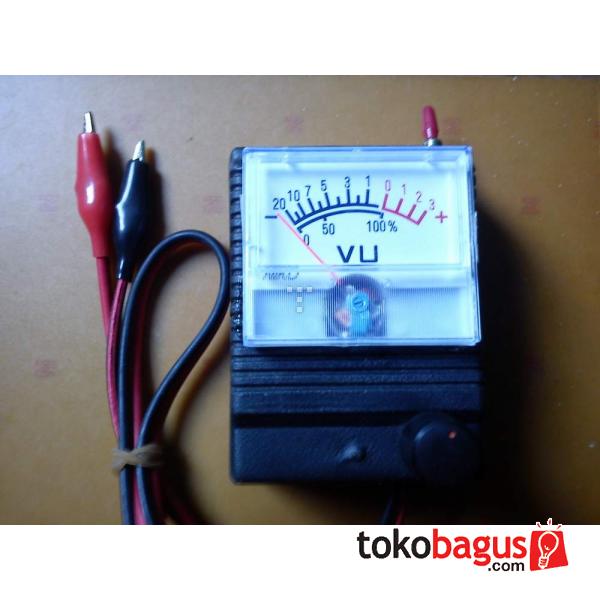

                              yeah at one end of the range the resistance values are enough closer to each other. so what i must to do make it linear likes as other esr meter? i just want to make my meter can read even 0.xx resistance like this esr wizard meter
                              yes, i have tried to adjusting the potentiometer and the scale can deflect to 0 ohm on my vu meter (-3 values on vu meter)and the led is glow with probes lead shorted >>i think that my project is success and i have tried it measure any leaky caps between good caps.. i just try to fix esr wizard scale panel meter and the result is just like I said before on my post. it must to rescale again because it didn't match. i have ever read on another homemade esr meter link that it is always must to rescale with small value resistor. so i try to measure it and it didn't give me a satisfied result about the scale.
                              so i think the problem just make a new scale looks profesional that describe the value same as when i measuring small value resistor. i have edited before with photoshop but you know what i means. it didn't present any real scale. just present 1-30 ohm resistor, for notes i just measure and the max scale that i can measure is 30 ohm and it almost not a deflection (little deflection) on my left panel meter. so i means that it can't present when we want measure different between 0.22 ohm and 0.33 ohm value.. maybe the esr meter doesn't success yet?? or i just have to make a new panel meter to fix on my vu meter?
                              my vu meter looks like this
