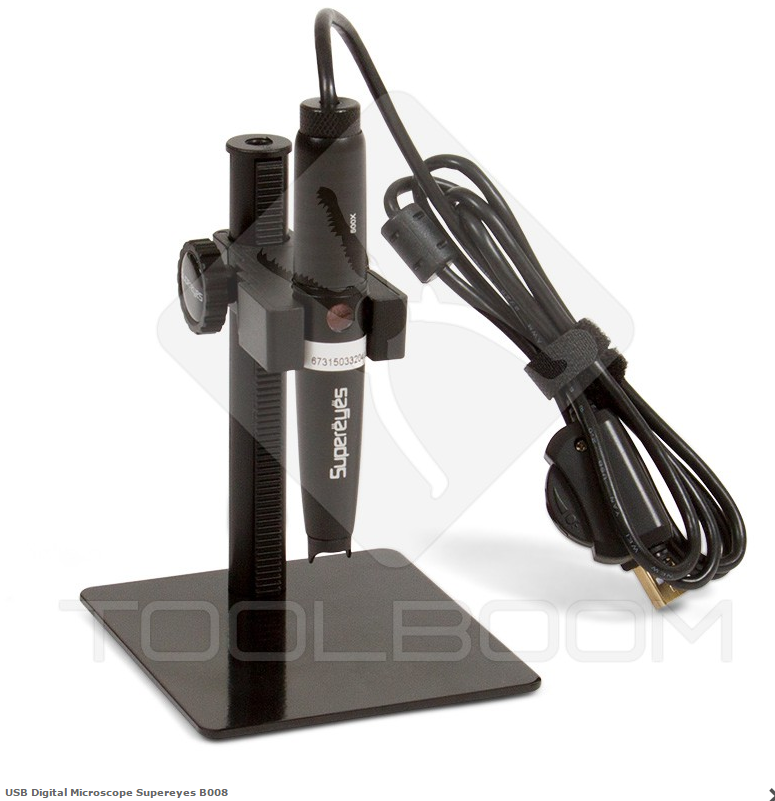

    I don't have one yet, but this one appears pretty good.
    http://toolboom.com/en/USB-Digital-M...reyes-B008.php

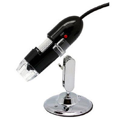

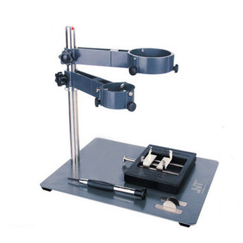

        This is what I have on my work bench, I think it works great for the price. I didn't buy the stand and holder combo you see on eBay.
        I needed another setup for the hot air gun.
        So I brought this stand and holder (see picture)
              I have that too - I use Yawcam to view the output.
              I use it to look at chip ID etc handheld - the stand is sort of ok
