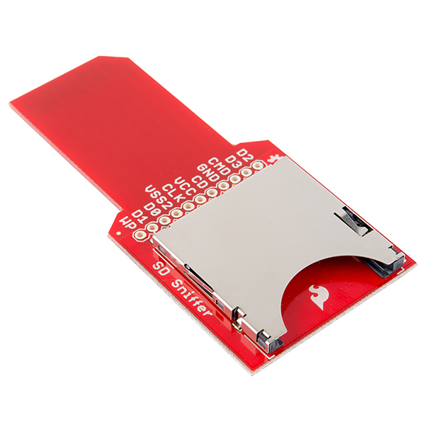

    I have seen many posts where the eMMC can be read via a SD card reader, however can the opposite be achieved?
    Read/Write a Micro SD Card from an eMMC Socket.
    I have a Motherboard with a Kingston BGA153 ball socket, using HS400 bus mode, which is 8bit, as Micro SD is usually 1bit or 4bit mode, I accept that a loss of speed in read/write will occur, but I would sill like to convert.
    Theoretically speaking, Im thinking if I hard solder DAT0-3 from eMMC to SD Card Reader, this should force 4-bit mode, or only DAT0 to force 1-bit mode.
    Not to remove the underlying socket, but run some of the traces to a micro sd socket.

    • 31204
    maybe,
    but check the datasheet for the emmc - it has to be 3.3v
    you cand link am sdcard if it's 1.8v

      However, does the host(motherboard OS) expect/request 8-bit mode? as we would only be soldering DAT0-3, leaving DAT-4-7 unsoldered, due to sd card being 1 or 4 bit mode.
      Or are all host read/write requests are the same? IE the eMMC controller decides the bus modes etc?

        Look at my Dreamlink T1 thread. There may be some useful stuff in there, I read and wrote to the eMMC using only DAT0. Less lanes slower read and write, However if that resistor on these DAT lanes fucks up by going higher in resistance, the data transfer does not work. You can see all the crap I did to these poor little boxes in that thread mentioned above.
        If it would be me, I’d start with one data line, then add the others.
