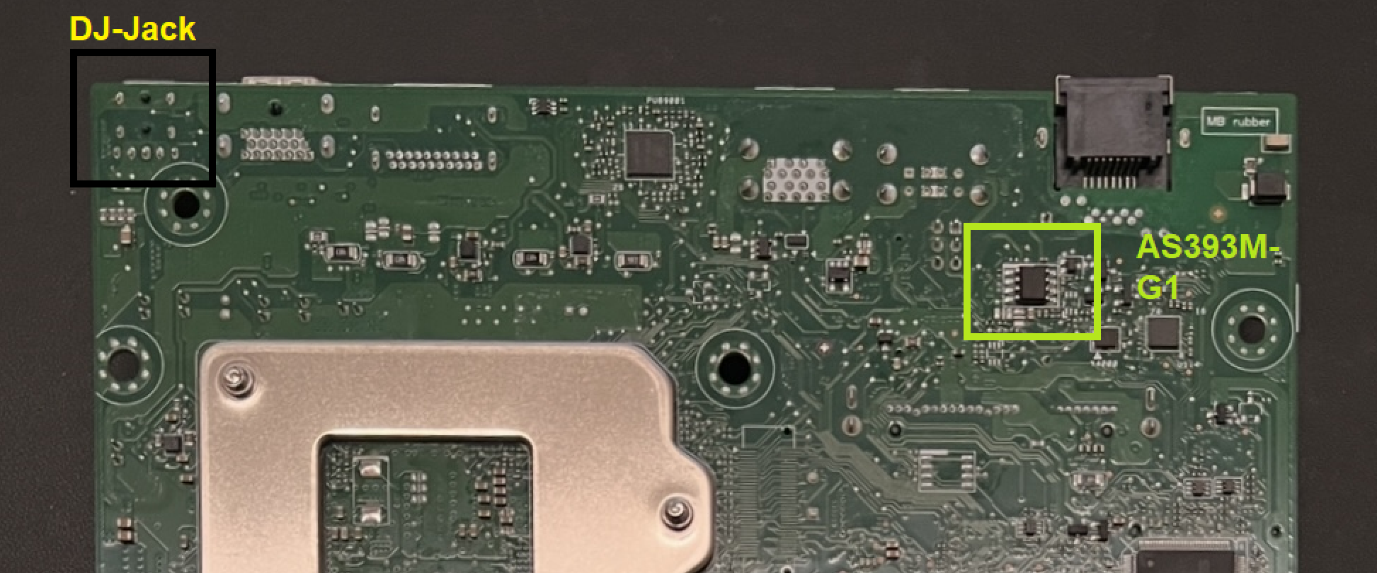

For my tools, I have a soldering iron and a digital multimeter, microscope, IPA and other basic utilities. I also already downloaded the board view and board diagrams from the other thread here on badcaps, but i am not very experienced in reading them correctly yet.

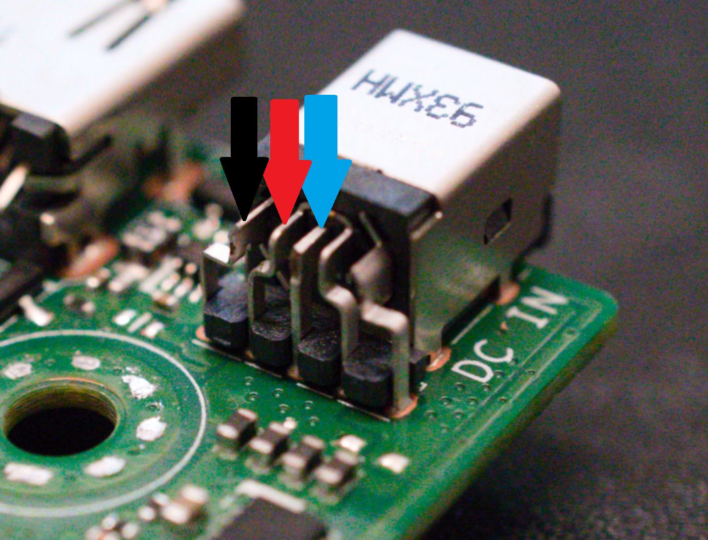

The DC-Jack itself on the motherboard looks good to me, there is no physical damage.
I already measured some of the components, e.g. the coils (mentioned in another thread) which all seemed to have resistance to ground on one pin.

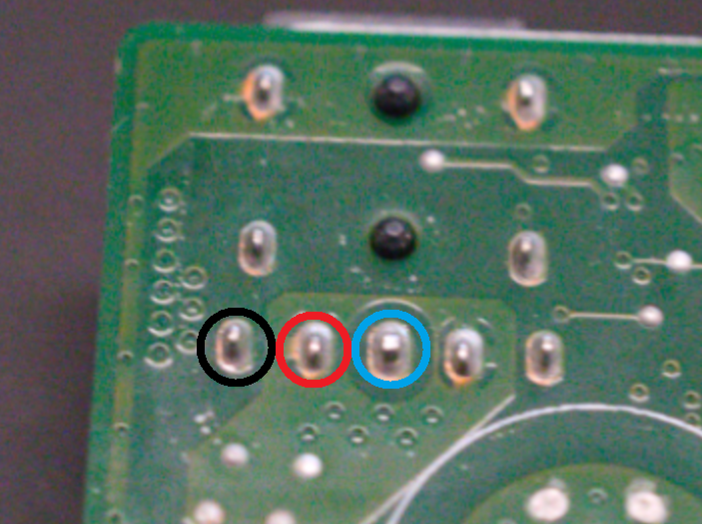

Also, on the DC-Jack I measured with the diode-test / continuity function of my multimeter:
outer pin (ground, black) <-> inner pin (vcc, red) .556V
outer pin (ground, black) <-> center pin (data pin, blue) 1.473V
inner pin (vcc, red) <-> (data pin, blue) open line
And for resistancy I measured (multimeter in 2M Ohm mode):
outer pin (ground, black) <-> inner pin (vcc, red) .273 M Ohm
outer pin (ground, black) <-> center pin (data pin) .114 M Ohm
inner pin (vcc, red) <-> (data pin, blue) .388 M Ohm
How do I proceed? What should I measure next?
