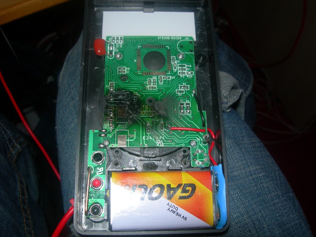

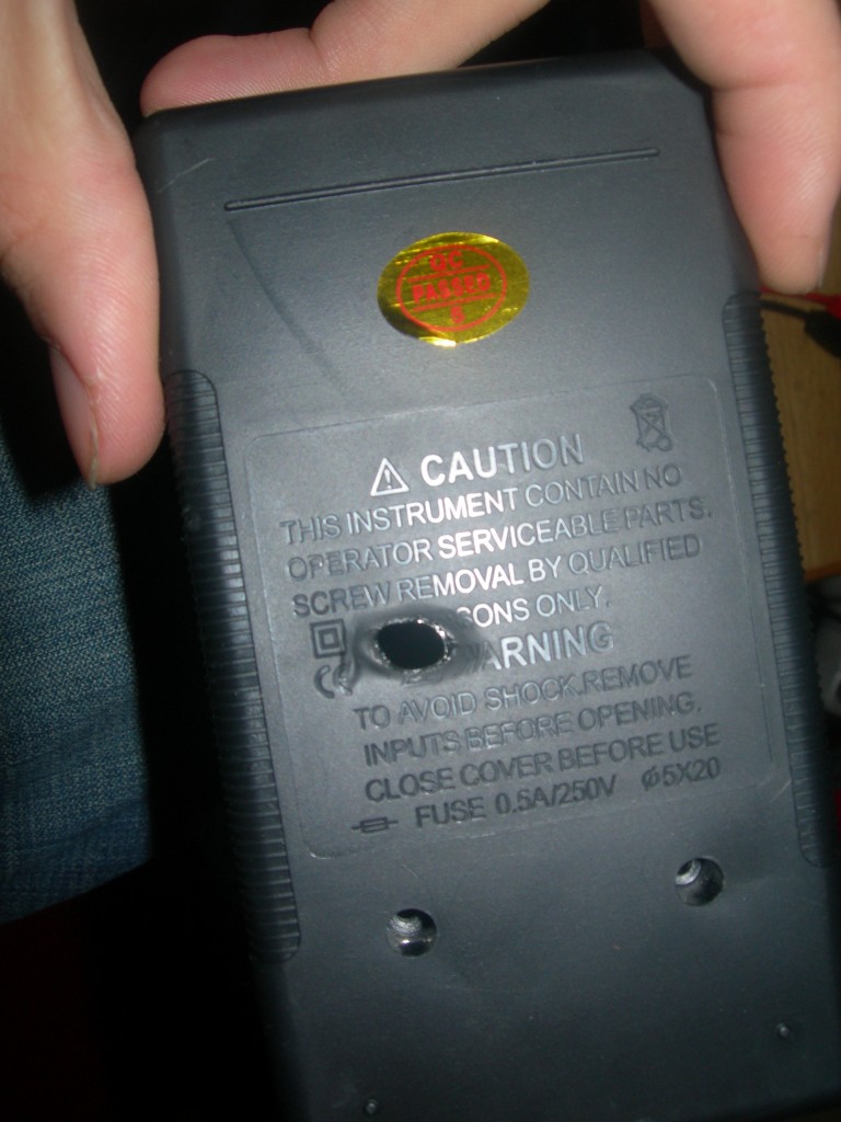

                            Re: This is why you don't buy cheap multimeters.
                            My DT830B blew up, rather spectacular. Hole in the plastic case, charred PCB, not quite sure what went up!
                                        What were you trying to measure? The explosion does look pretty spectacular.
                                        Reason I ask is because I have a 830D (a variant of the 830B). I regularly use it to measure high voltages on the primary of PSUs and whatnot and never had anything bad happen. A few times I tried to measure DC on the AC mains - again, no explosions. Perhaps I've been lucky?
