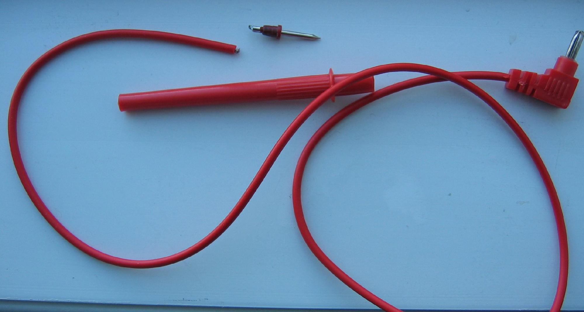

                • PeteS in CA
                  • Aug 2005
                  • 3583
                  • USA, Unsure of Planet
                  Re: This is why you don't buy cheap multimeters.
                  This is normal for the 830B and part of it is due to the crummy probes it comes with. With good probes it should read 0.6 to 0.9 ohms when shorted.
                  This is a prime suspect - both the probes (either end) - and the banana sockets into which they plug. I'm spoiled rotten - HP 73As are the "worst" DMMs in my test area, plus some Fluke 187s and some top-end Agilent handhelds. When you're trying to set voltages in the 4000 volt range to +/- 1 volt, a +/-1%, 3-digit meter is not adequate. I'm not the paying for the meters I use, while you guys are. Still, cheap @#$% meters will cost you more in the long run - in $$ and time wasted - than a Fluke 10, 20, 70 or 80 series DMM (also, look into Extech, which seems less expensive, but still decent quality). This is in the US ... not sure what's commonly available in EuroLand and Asia.

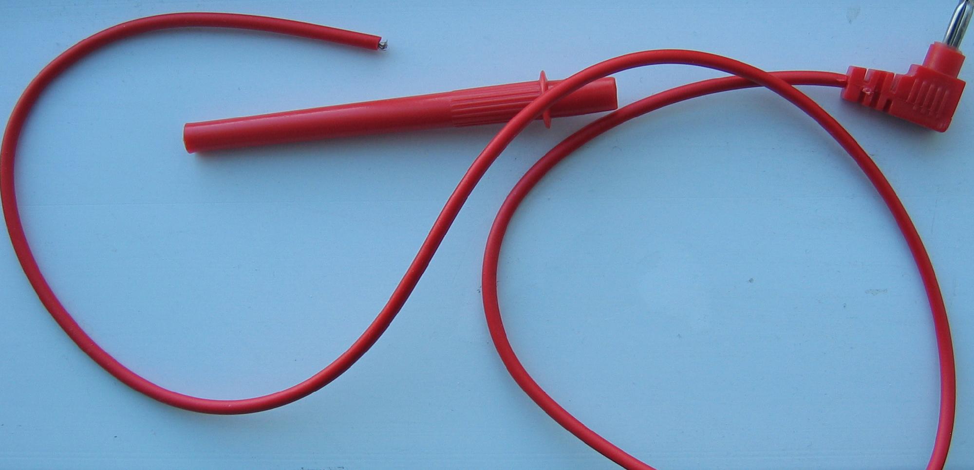

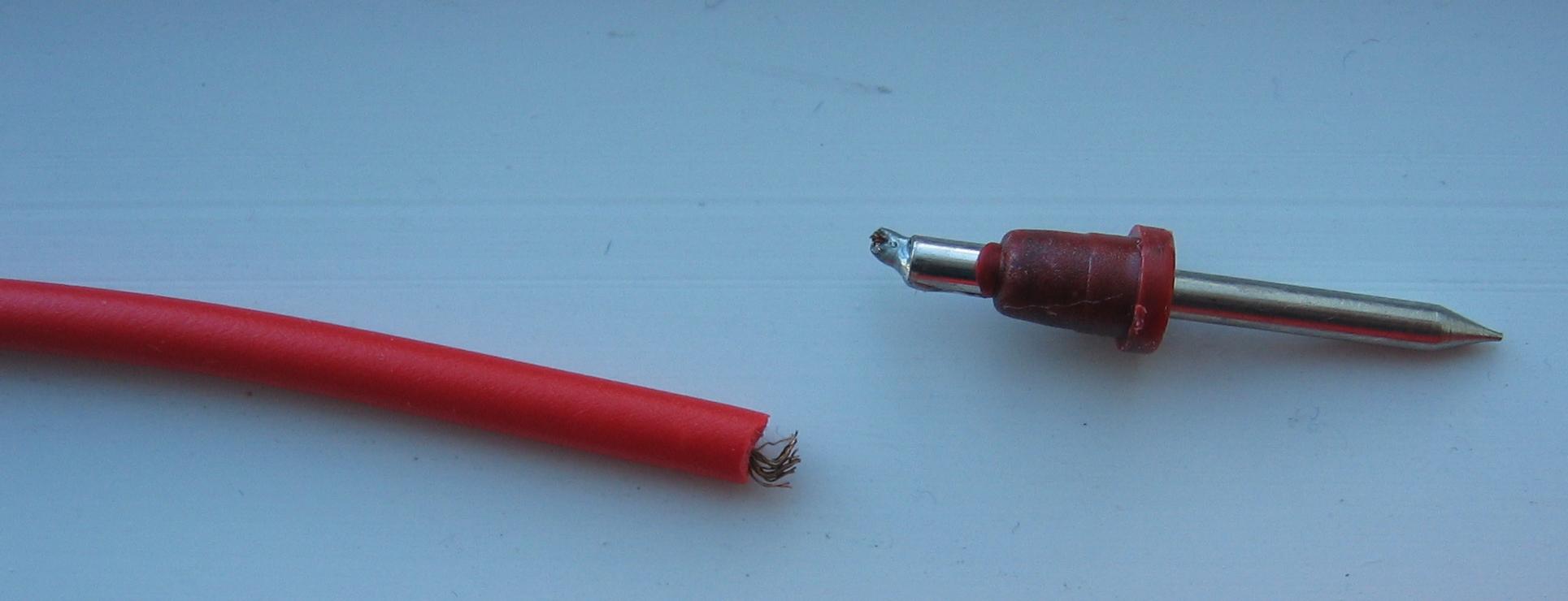

                    • retiredcaps
                      • Apr 2010
                      • 9271
                      #30
                      Since my 99 cent 830 variant from ebay arrived DOA back in June 2010, these probes were NEVER used and have been put away. I took them out last week due to some of these threads and it literally fell apart in my hand.
                      Evidence.
                      And yes PeteS, I have much better quality name brand multimeters now.

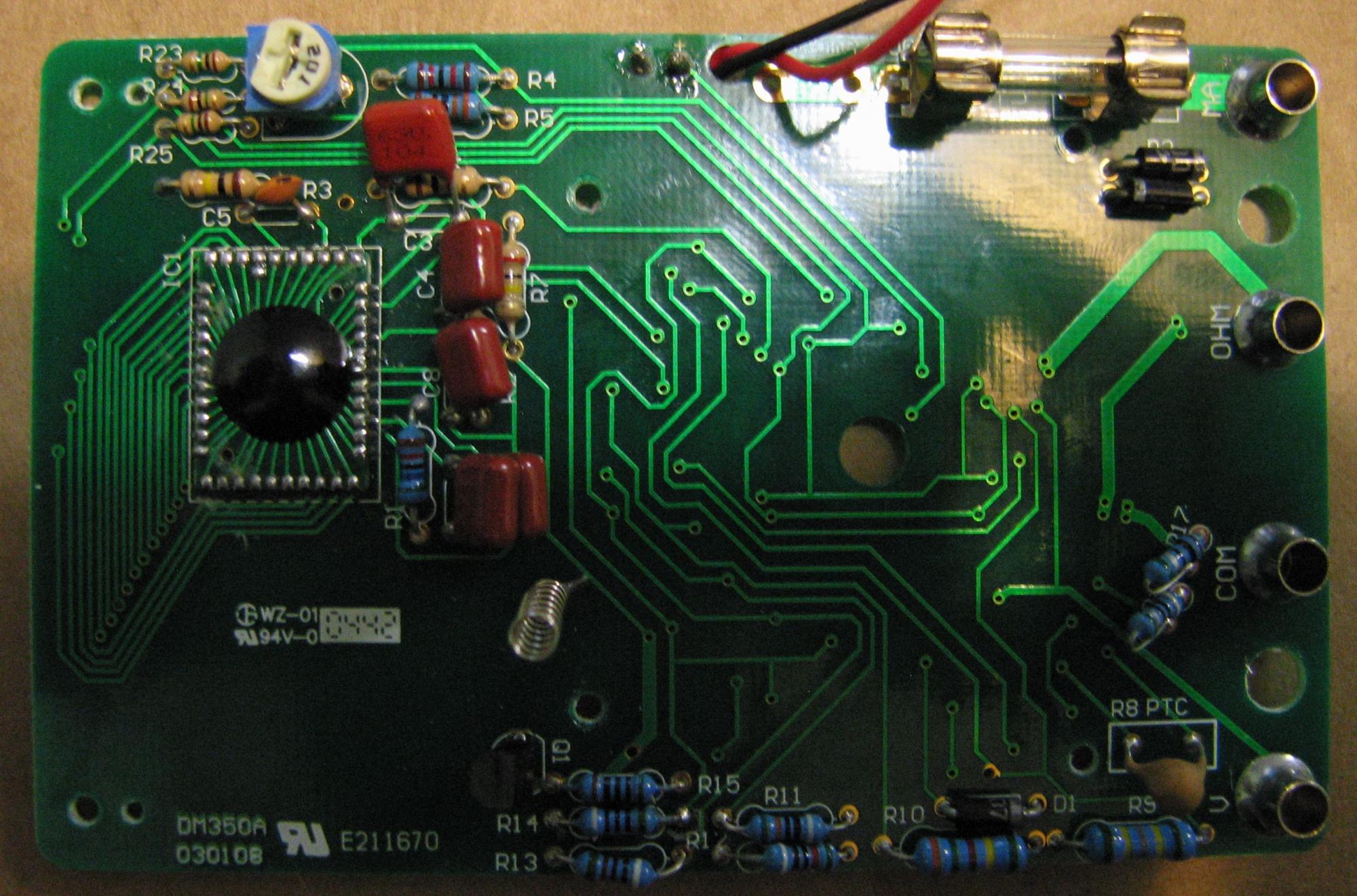

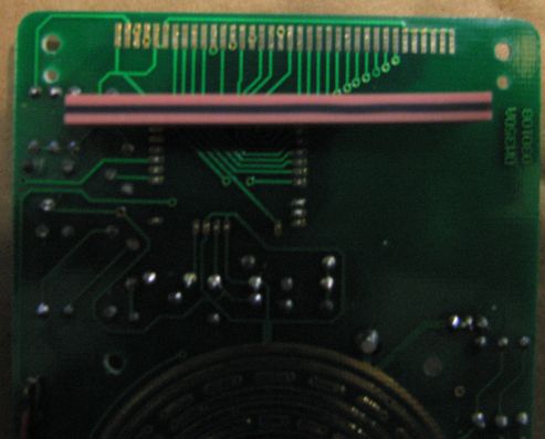

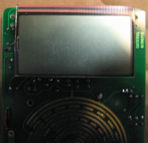

                            • mockingbird
                              • Dec 2008
                              • 5488
                              #34
                              And here is the PCB (Full size 300+ KB version is attached to this post)L
                              Fuse is ok... Could it be the custom IC or you think it's a diode or transistor?
                              • retiredcaps
                                • Apr 2010
                                • 9271
                                #35
                                Originally posted by mockingbird
                                The LCD has some really weird connection, like some sort of plastic block with black things sandwiched in-between that somehow links it to the PCB... Does anyone know how that works?
                                That black/pink thing is a zebra stripe.
                                http://www.repairfaq.org/REPAIR/F_au...#AUDIOFAQC_012
                                For those curious, I figured out these are Sperry brand multimeters through some searching. Sperry DM-210A and DM350A.

                                • retiredcaps
                                  • Apr 2010
                                  • 9271
                                  #36
                                  If you are talking about that black circular blob, that is a chip on board (COB). It is probably a ICL7106

                                  • mockingbird
                                    • Dec 2008
                                    • 5488
                                    #37
                                    Thanks for the model... Yea, I knew it was the IC, I was asking if he thought the IC was the culprit or maybe a diode or resistor was shot. I've read about transplanting these ICs, but like Unique said, for a $5 DMM... I dunno.
                                      master hoarder
                                      • May 2008
                                      • 12175
                                      • Bulgaria
                                      #38
                                      Yep, cheap probes are cheap.
                                      I was measuring some current last week with my 830D. After measuring about 1.7A for over 2 minutes, the wires on my probes were actually warm to the touch!
                                      ... and to think the meter can measure up to 10A. I bet the probes will melt at 5A.

                                          master hoarder
                                          • May 2008
                                          • 12175
                                          • Bulgaria
                                          #40
                                          No wonder they don't put fuses for the 10A current setting - it's just not needed when the probes are acting as a fuse .
