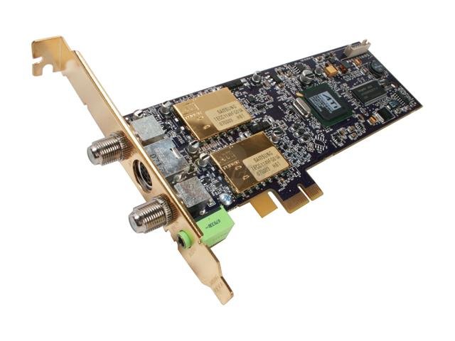

    A Diamond HD Wonder ATSC tuner card, with the ATI theater chip which does hardware MPEG-2 decoding and interfaces with my Radeon 4850's GPU to ensure my CPU doesn't do a damn thing in terms of video decoding.
    My computer was already running Windows 7 Ultimate, which features the excellent Windows 7 Media Center.

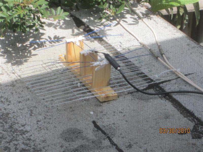

    The Lumenlab forum has a sticky with diagrams for a basic DIY antenna that can be built for less than $10 (free registration required to view thread):
    http://www.lumenlab.com/forums/index.php?showtopic=9613

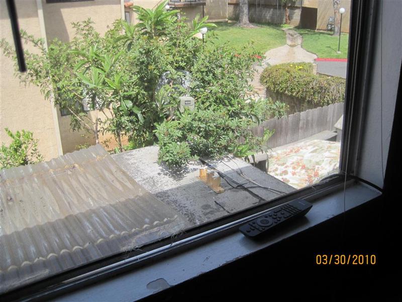

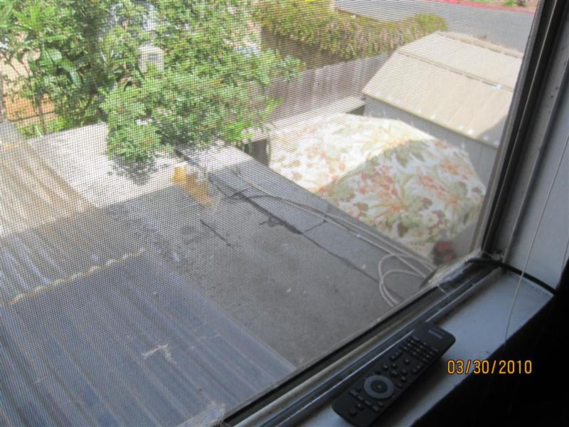

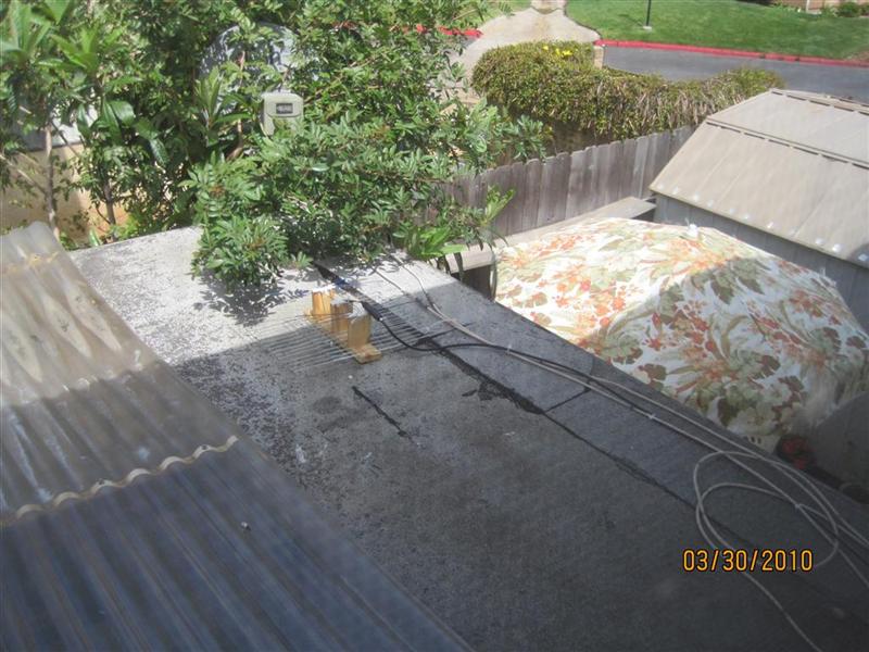

    If you look out the window of my room, there is a supply shed that belongs to our neighbor that extends out a few feet. I decided I would mount my antenna there and run some weatherproof shielded RG-6 inside my room.
    I built the antenna using a 2x4, two sets of dollar store cooling racks, bent coat hangers, and sloppily-applied silicone caulking for weatherizing. Additionally, I brushed a thin coat of motor oil over the entire thing to further protect it. Folks, it ain't pretty - but it works. Here are the pics:
    Here is the homebuilt antenna itself.
    Zoomed out a little bit so you can see what it's sitting on. This is what you would see if you were to look directly out my bedroom window. My neighbor has a satellite dish and a pair of anchored RG-6 wires, so I just piggybacked MY RG-6 and the antenna onto her wire with zip-ties.
    Picture of my window and the outside view. I had to run the RG-6 in through a hole in my screen (you can see it in the pic). The weather is starting to warm up, so I can leave the window cracked 24/7 but I need to get something figured out before the end of summer.
    The antenna has been serving me for almost two months now. I have gotten steady reception on all the major OTA networks (Fox, NBC, another local station, PBS). I have ZERO dropouts, even momentary ones. Really clean, steady signal.

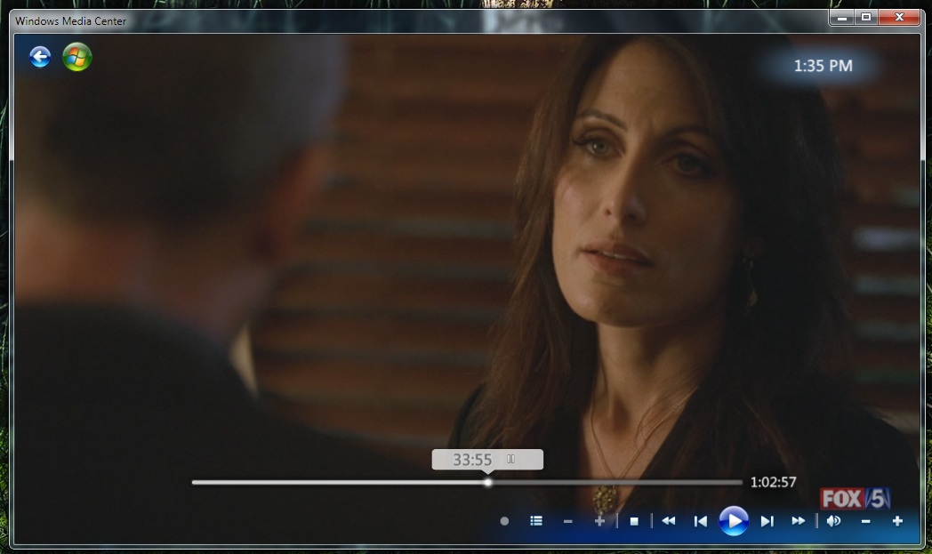

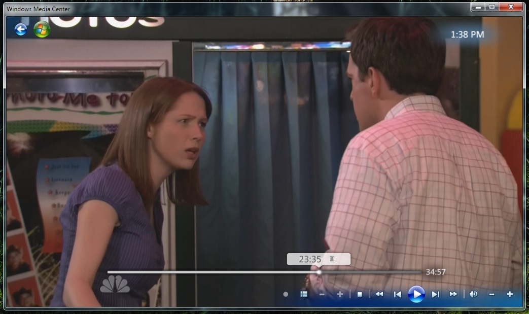

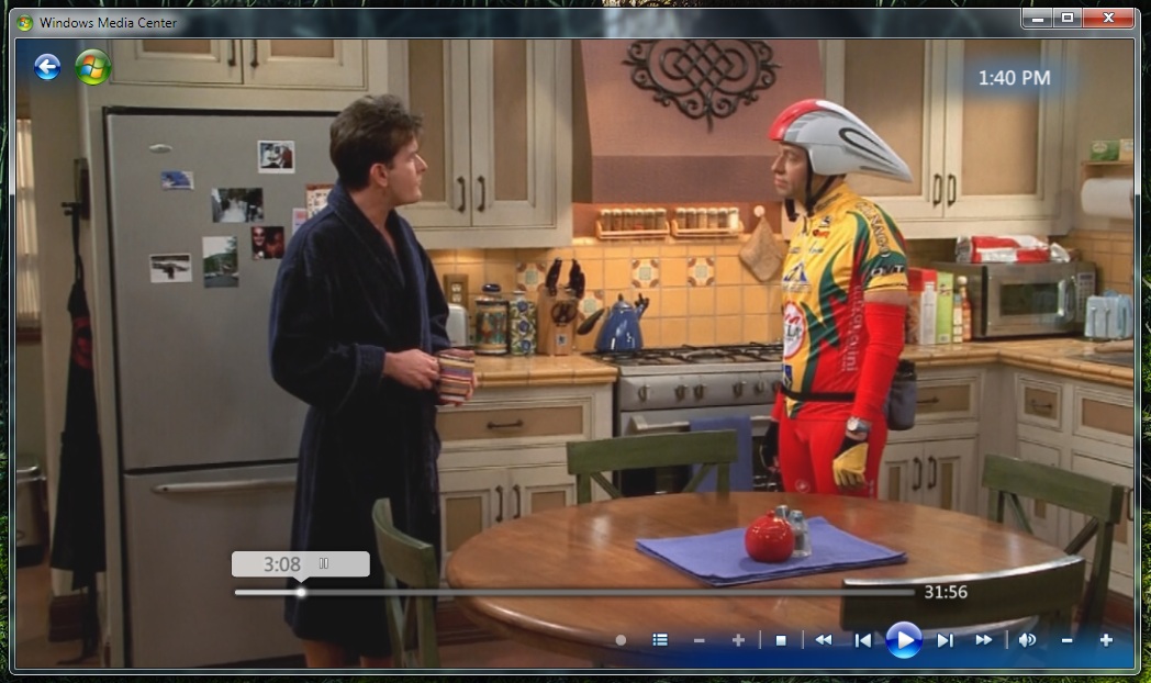

    Here's some screenshots of recordings I've made:
    Cuddy (House):
    The Office:
    Two and a Half Men:
    ATSC OTA is really amazing, as long as you have a decent signal you will get steady HD with no dropouts. Using an antenna to watch TV today is nothing like how it was years ago when we had NTSC.

            According to AntennaWeb.org, I'm 31.7 miles away from the nearest cluster (I'm in northern San Diego county), and my reception is fantastic with this home-built antenna jig I have going.
            You should register at the Lumenlab forum and take a look around. I've seen several variations of the DIY antenna and there's plenty of people who are 40+ away from the towers. Lots of good info if you want to get some OTA going.
