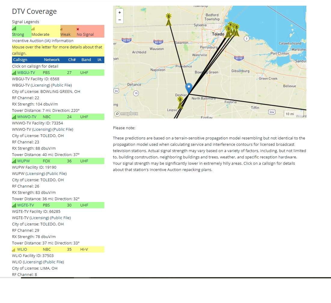

    So I would like to get a antenna that I could mount inside my attic. This would avoid the wind/weather and avoid some of the mounting limitations. Also it would be above my tree line and above anything for 10s of miles.
    I believe I could work out a rotational setup in the attic, if needed, as the roof peak is about 7ft from attic floor but that is where my questions start coming into play. The attic is large and is storage at best (no sub-floor yet just rafters).

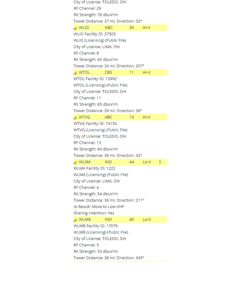

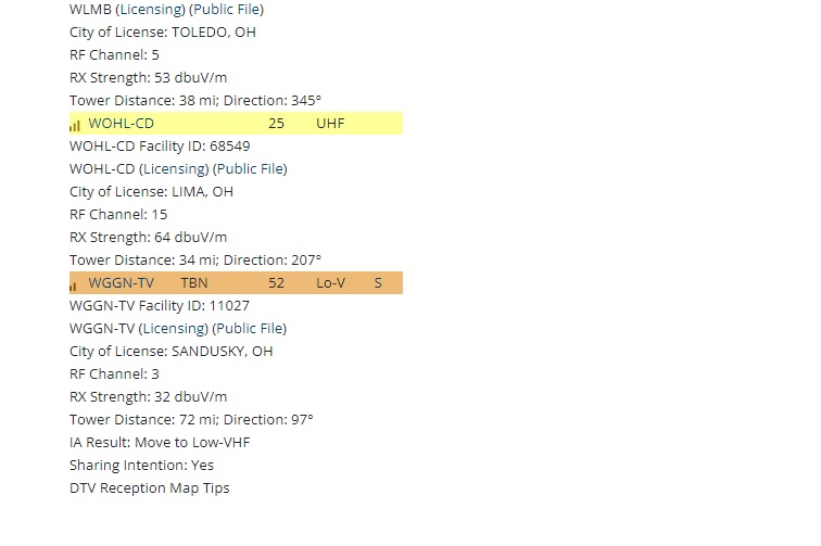

    I have included in this posting the DTV Receptions map based on my address. Most seem to be greater than the mid 50s DBU. Most are in the 60s DBU. Honestly I have cities that are 50 (Lima),75(2 - Fort Wayne, Sandusky),90(Columbus), 100 (Detroit) miles away that are all major urban centers. So these images are probably not a clear representation of all the possibilities.
    First question my roof is a Tin Roof. Original I am told to the house from when it was built in 1900. Its thick compared to modern metal roofs. Will this cause any issues when I choose my Antenna?
    So What kind of Antenna should I look at for this project?
    Mileage? Omni-Directional? Directional? Amplified?
    Suggestions?

            Guess it's not ideal: Will a metal roof interfere with TV antenna in attic?
            A metal roof will work against the antenna reflecting the signal. IF the antenna is inside the house, near a window; it should not be a problem.
