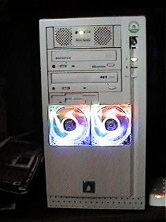

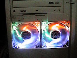

        i fit a 92 or 120 on the front,
        i put it in front of the floppy/3.5" bays and cut the metal out so it cools the drives.
        fit the fan on the outside of the metal, and cut the plastic front so it sit's flush - almost.
        then fit a filter.
        here is one i did for a friend - not filtered.
        double 80mm bb fan's going direct to the drives & mobo.
        no metal behind them.

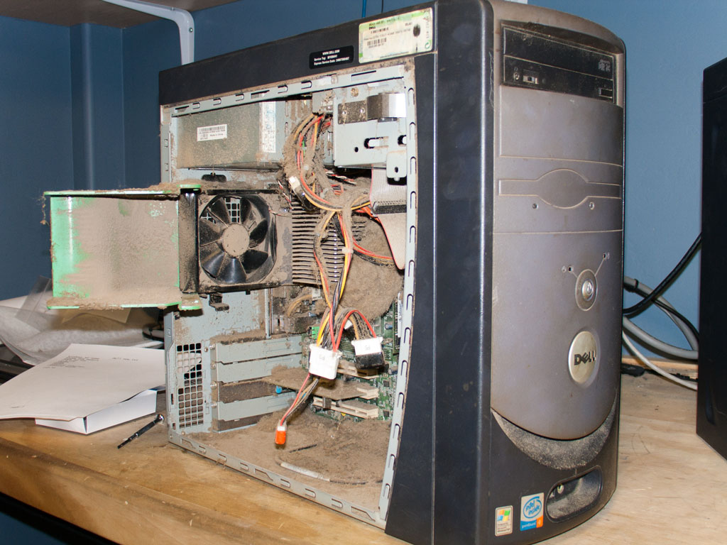

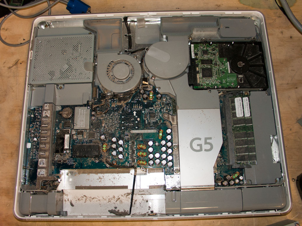

          I get lots of computers with rusty cases. One that I had in a few weeks ago looked 10 times worse than that. Some look so bad that I reckon I could just push the grills out.
          Just before the motherboard died on this dell, my boss was getting data off it for the owner. He said that the fans would labour hard even under very light load. There was a coat of dust about 5mm thick over the CPU Heatsink.

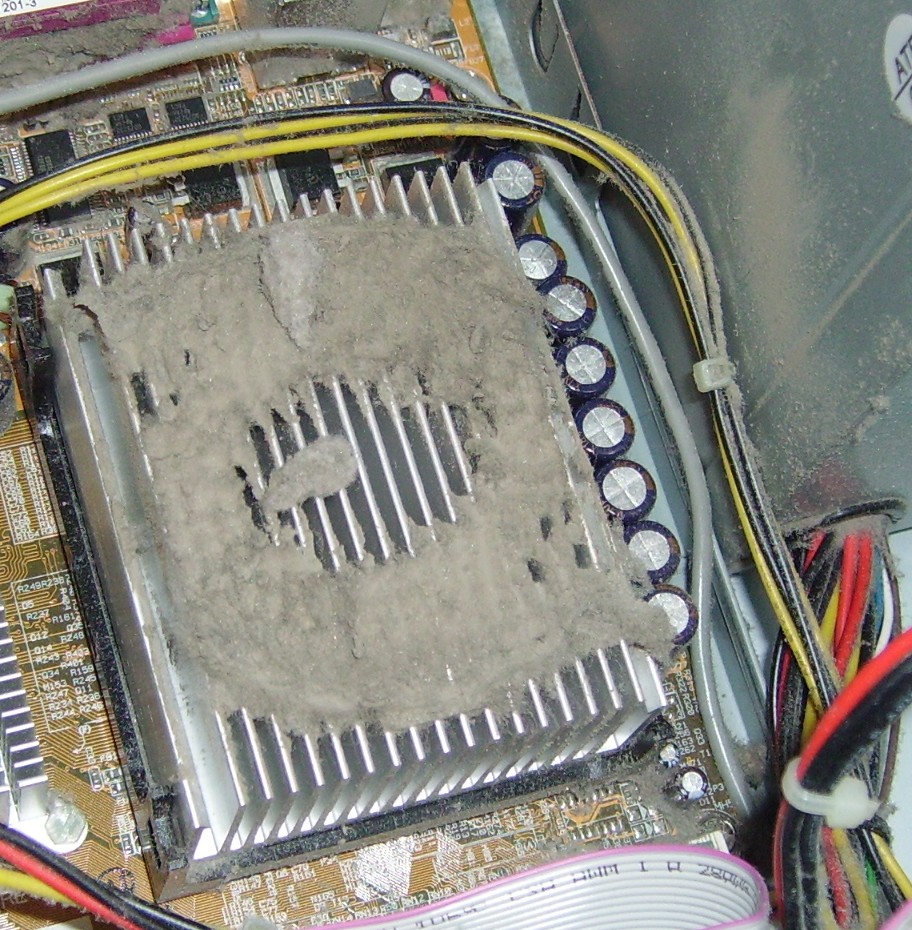

            I wonder when this last saw a good cleaning?
            It was in a dustbin of a case so nasty I tossed it outside. It was so dead the sparkle PSU in it wouldn't even power on.

              Looks like this decent heatsink was from a AM2 or AM3 AMD cpu, wouldn't this CPU be saved and put on different board?
                  Cheers, Wizard
                  It's for a socket 478 P4 actually and I'll put it aside for later once I figure out how to separate the CPU from the heatsink. It feels like it's glued in place.

                    Clean off dust and warm the heatsink with your hair dryer or heat gun. The heatsink grease will soften. The OEM heatsink often is heat-melt termal pad that reharden when cooled.

                      That is what happens to the 478 socket cpu's with stock Intel thermal paste. It dries bloddy hard and is very difficult to separate the cpu from the heatsink.
                      What I did with mine was gently heat up the heatsink with a hair dryer..and slowly twist the cpu and heatsink and eventually I was able to separate the cpu from the heatsink.

                        If heat doesn't work, try popping the thing in the freezer for a few hours and then trying your luck again.
                        That's what I had to do to get a 478 P4 off an aftermarket heatsink in an old home-built computer someone gave me that their uncle had put together for them a few years back.
                        The reason it was stuck? The idiot who put the thing together put the heatsink on without taking off that plastic tab that all heatsinks come with to keep the copper surface unmarred during shipping. He must have assumed it was some sort of pre-applied thermal paste.

                            thats a close contender for the cruddiest hsf ever.
                            and i use my heatgun to warm it up then gently pry the chip off if stuck .if the board runs you can also run it a short while with the fan unplugged and when warm gently twist the hsf to break the cpu loose.yanking it out without releasing the lever probably isnt good for the very thin gold plating on the contacts and pins.

                              Dang if you didn't say it was dust I would say it was penicillin .

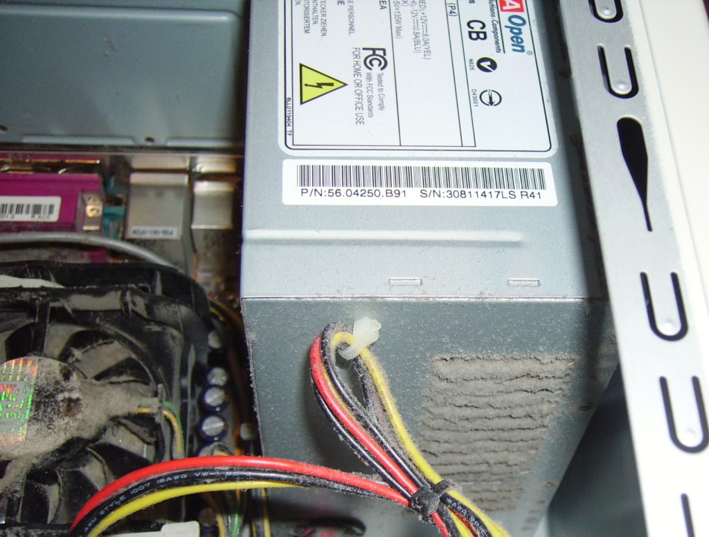

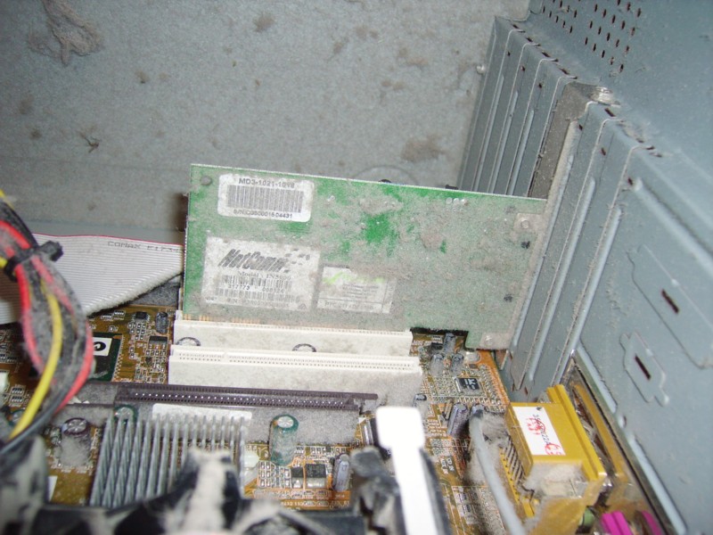

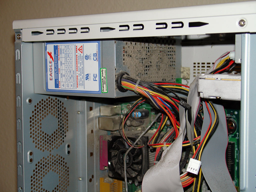

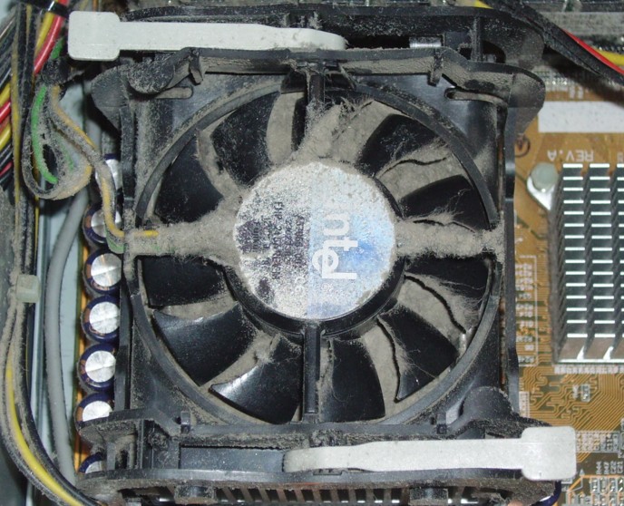

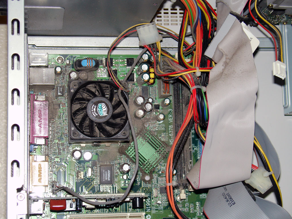

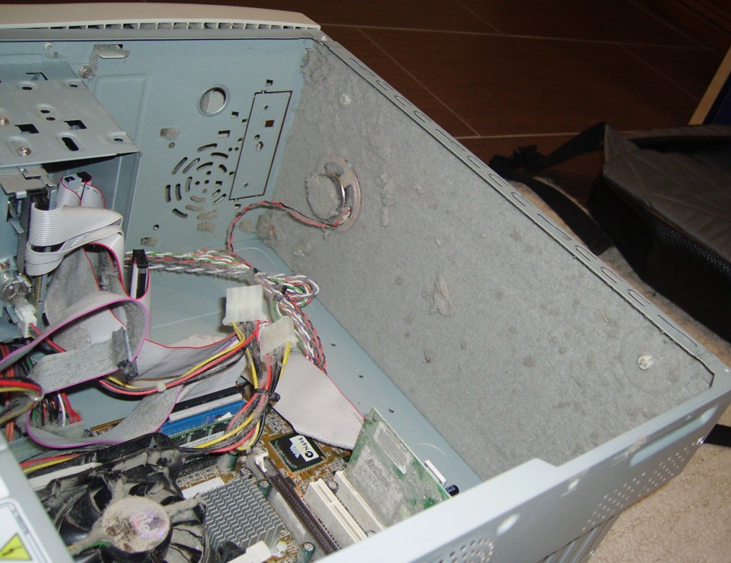

                                This looked brand new after I gave it the leaf blower treatment, but here are the before pics. There was so much dust on the CPU cooler that the fan could not spin

                                  Re: The dust thread
                                  It's like there's a carpet at the bottom of the case .
                                  By the way, one of the Teapo caps next to the CPU heatsink looks bulged in that last pic.

                                    Re: The dust thread
                                    Probably every one of those caps is cooked to death... whether they show it or not. Sandwiched between the CPU HSF and the PSU. That CPU HS was probably hot enough to take your finger prints off.

                                      The cheapo teapo caps are indeed bulged. I will be recapping it.

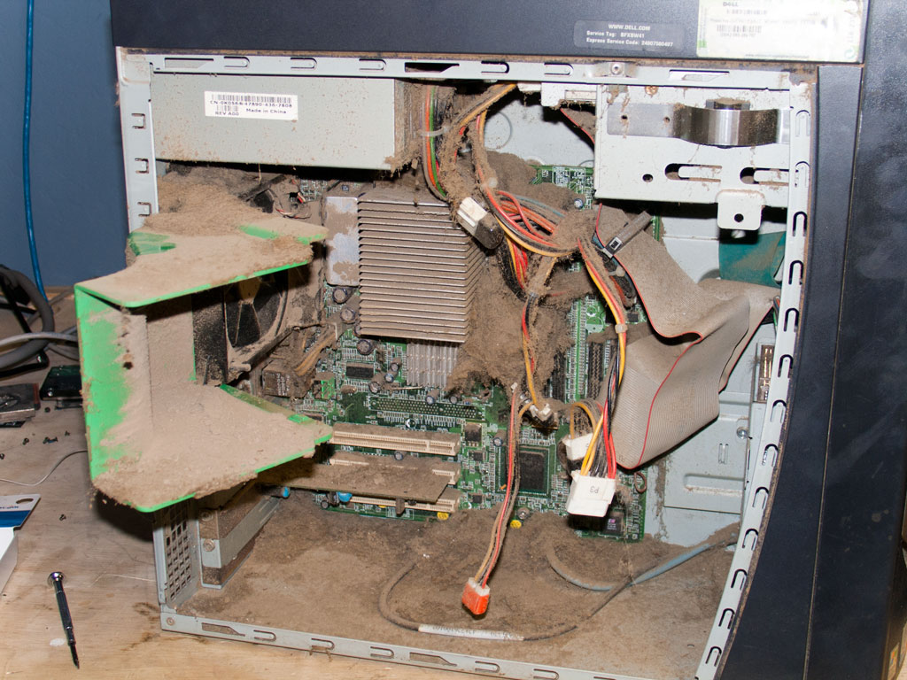

                                        Just a few shots of some of the computers I got pictures of. We nicknamed the Dell the "Dell Planter". Ugh, how can anybody let a computer get this bad...

                                          Go to Mexico and you will see this almost on a daily basis. And do you want to know the best part? You'll see it in Government units ....
