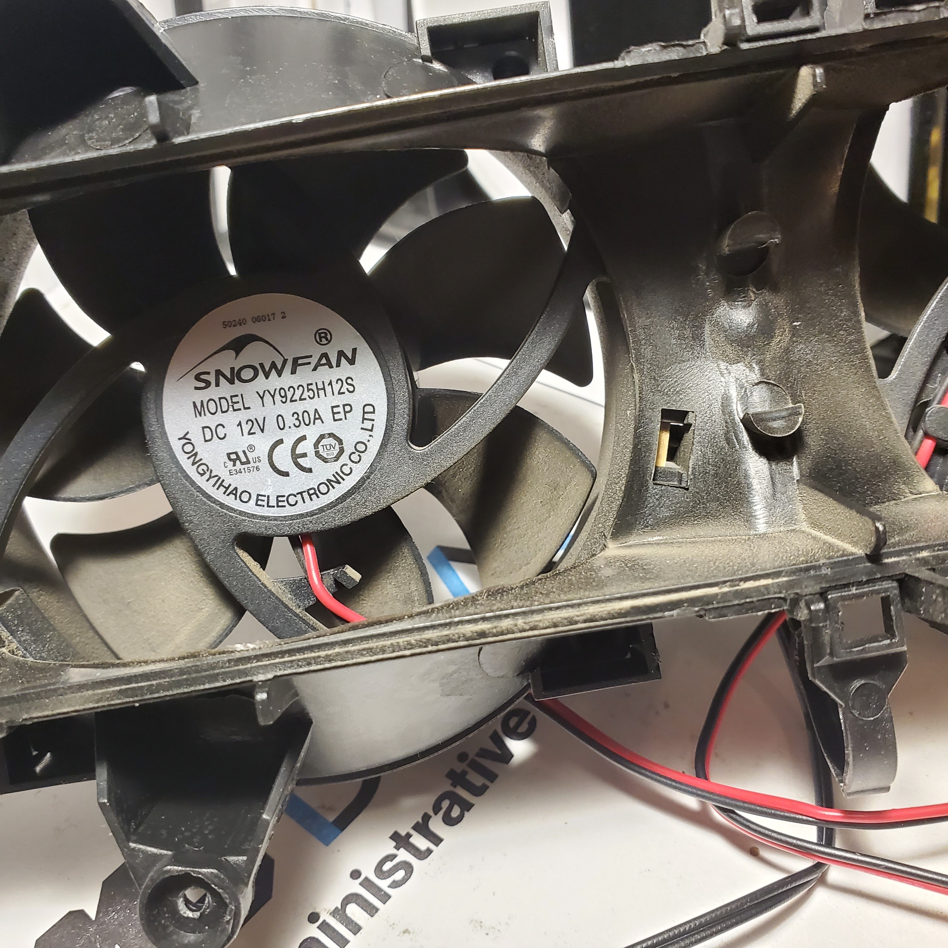

              So... I ripped apart a bad floor heater type thing I found at work, and these are the power ratings for the fans. (see pic)
              For anyone who is still with me, what I want to do is place these fans (two identical fans) under the 4.5 foot long radiator and have them come on when the boiler triggers the pumps in "zone one". Then, when the boiler and the pumps shut down, have them continue to run for 20-30 min (shorter or longer to be determined) on a timer of sorts. Are there any electronic device anyone can point me in the direction of to accomplish this? Could you walk me thru it a little?

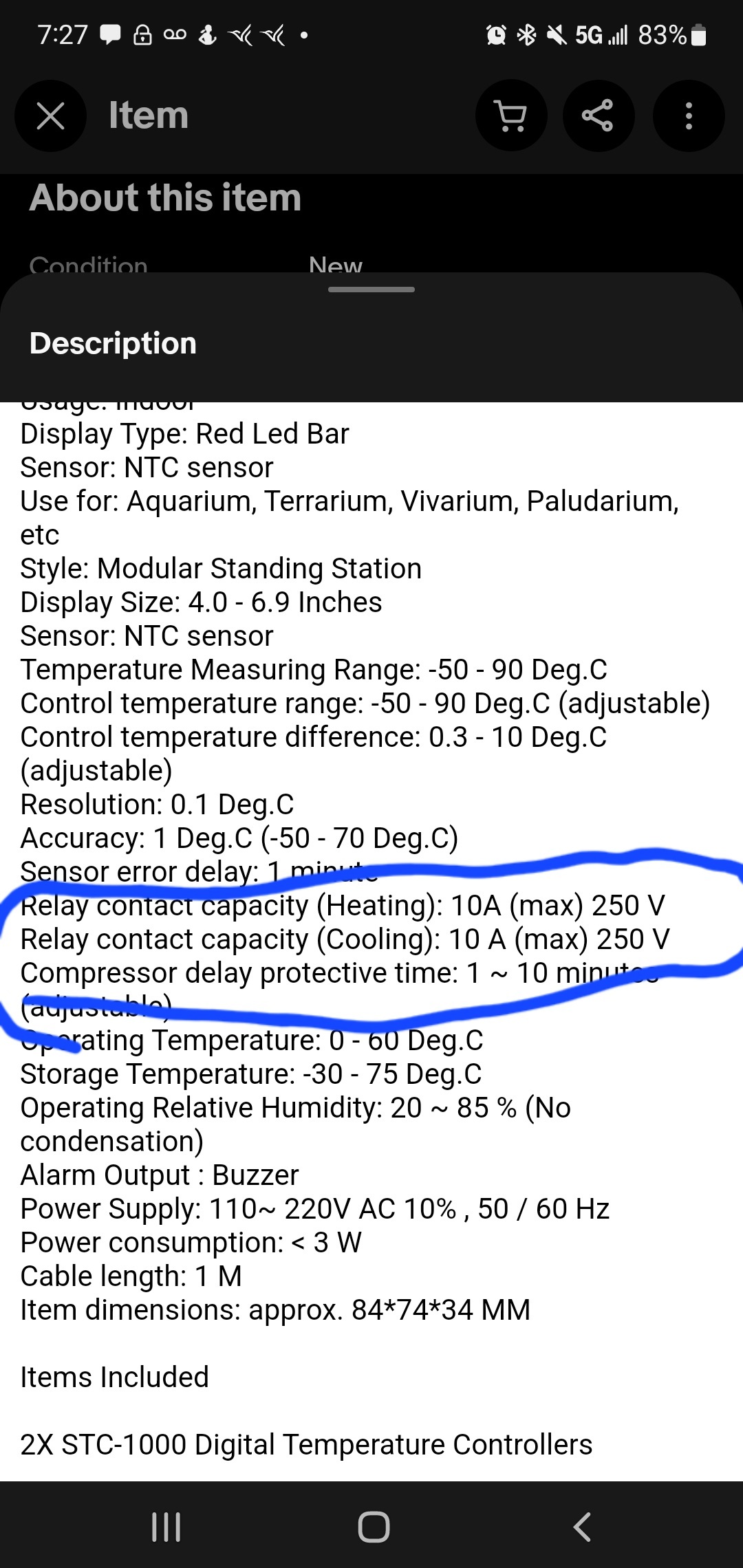

                  I do have a quick question though. This item (and I could just use it as a launch point for my search) seems to feed a lot of power to heaters for a water tank/aquarium...? The fans I am thinking to use are less than 1 amp. I would be willing to go as high as say,,, 2 amps, but 10 amps? Seems like a lot for my application. No?
                  Honestly, I would prefer to just have a timer switch that turns on (is switchd) when the hot water pump turns on,,, and then remains on for a set time once the pump turns off. Is there something like that out there that will feed low amperage and 12v to small fans like the ones I have?

                    The problem you are going to run into is when your boiler gets to cold you will be defeating the purpose of what you are trying to do you a temperature controller to shut off the fan when your boiler is not producing heat now you could run the pump with out the heat on and use that heat but you still need to have way to cut off the pump when the water temperature is too cold to do any good
                    I think you are over looking this fact if try to run the way you are describing it you will be blowing cold air once the pump turn off
