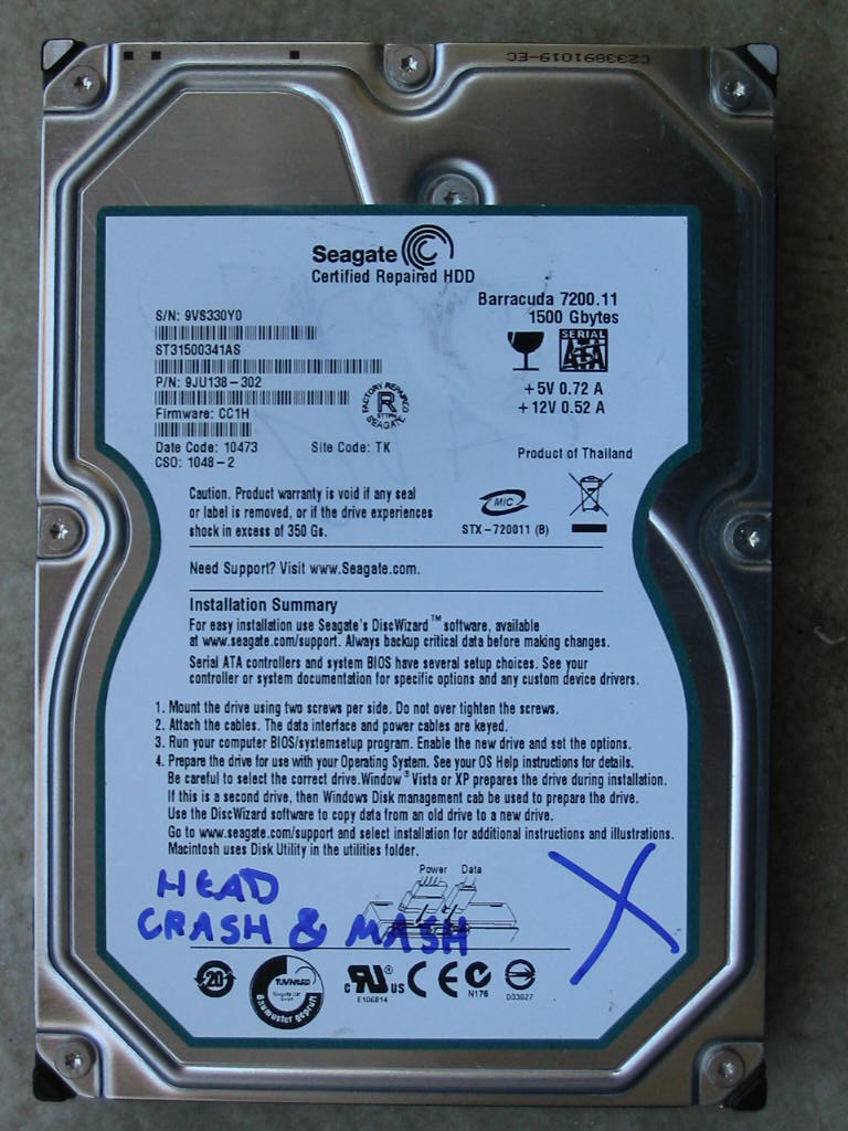

    Here's a good example of one: Seagate 7200.11 series, 1.5 TB, model ST31500341AS
    It didn't look bad on the outside or anything like that (I put that note on the HDD after I opened it… so there's some foreshadowing for you .) But as soon as I plugged it in, it sounded absolutely horrible, making loud clicking and grinding noises. I thought it might be bad spindle motor at first. Curiosity got the better part of me, as usual, so I decided to open it. And this is what I found:
    And a high-res picture (link format to save on loading bandwidth)
    https://www.badcaps.net/forum/attach...1&d=1580607991

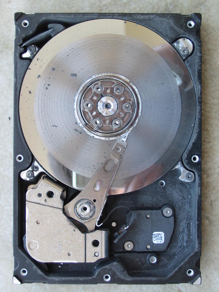

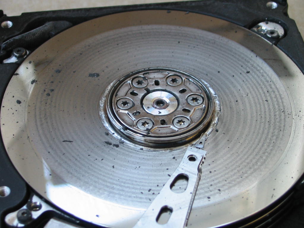

    Uh-oh… Goodbye precious data! Hello magic “pixie dust”.
    I should have known to expect this, though: while opening the HDD, I did notice some black “dust” started sticking to my fingers “out of nowhere”. As I started opening the HDD more, I saw more of that dust pour onto my carpet – and let me tell you, this crap is hard to get off from there. Had to vacuum my floor several times to get rid of the few spots where the dust fell. Also took dish detergent to wash the dust off the skin on my fingers, as it is very fine.
    Fortunately, I didn't loose any data, as this wasn't one of my HDDs. It's a failed HDD I got from work. Still not a big loss in terms of data, as the HDD contained old surveillance video footages that were backed up elsewhere (and at this point, not really needed either.) Moreover, I don't even have to low-level format the HDD now.
    It's interesting that this HDD still kept the platters spinning, despite the obviously failed head(s). Maybe I should cut a round piece of sand paper and glue it onto that top platter – table top bench grinder/sander! Fitting purpose, given the above images.
    (No really, I might actually do that ^ )
    Anyone else have extreme HDD failures like this to share?

      Yep worst I've seen was a 15k that had dead motor driver IC, melted spindle motor coil, destroyed heads and all platters surface gone into dust. Was stress-tested for a day to make sure it works then a couple of months later it died randomly while idling.

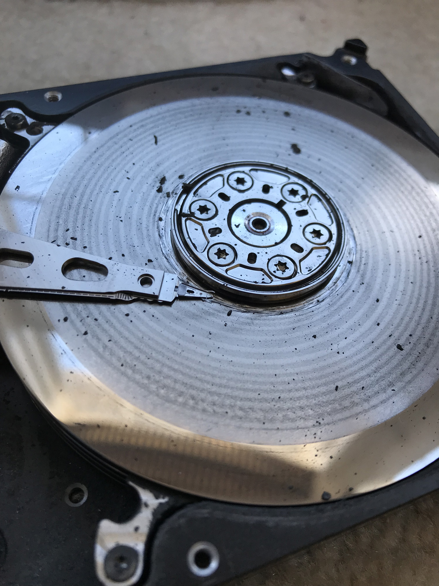

          Screw BSY (that's a 7200.11 ya' got there, had a 1TB model to work with that had BSY), that thing is WAY worse.

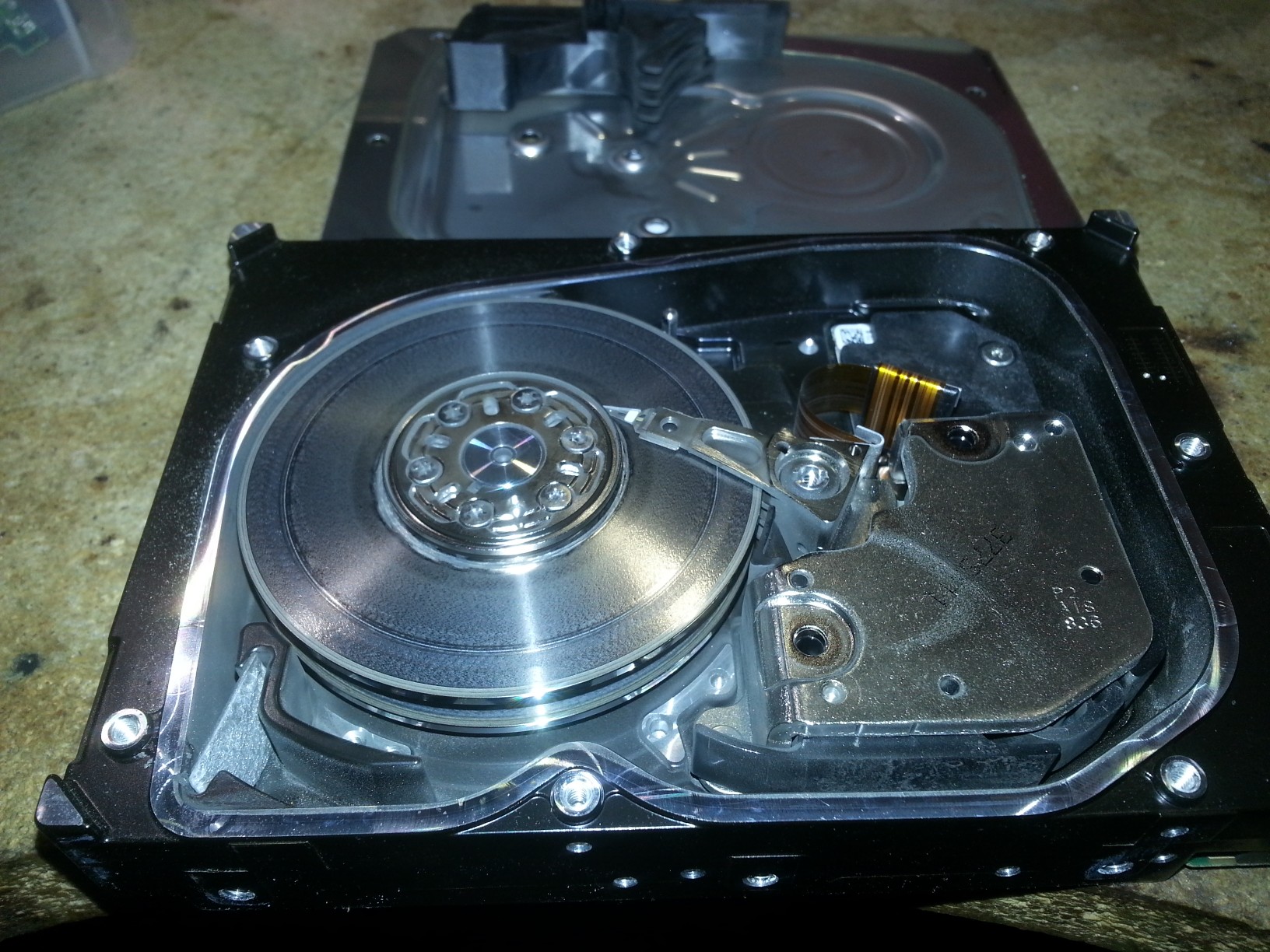

                  I have a similar model: ST31000340NS, Seagate, ES.2 1000Gbytes, It would not spin up, I check that there was drive to the motor, and it was ok. So I opened the drive and the bearing is seized solid.

                        I thought there were clock mechanisms (just like the $3.88 clocks you buy at Wal-Mart) that could be fitted to the center of one of these platters. Are they still available at craft and hobby stores?
                        This clock would stand out from the "typical" hard drive platter that was turned into a clock.
                        Edited to add:
                        ...some piece of foam in the drives thats flaking apart....
                        Don't many drives (consumer drives, at least) have a "recirculation filter" (piece of foam or other material) to filter the air inside them? Many pictures of disassembled hard drives are on the web. Just like an old foam seat cushion, these filters may be falling apart due to old age. (There is also another filter to allow air to escape when the drive heats up and air inside the drive expands.)

                            The filter in this drive is not foam but more similar to a cloth fiber, it is located in the top left of the of the drive above the platter in picture #2

                                      At 15k RPM, those platters have a lot of momentum. Ain't no head going to stop them just like that. I imagine it looked similar to the one above, if not worse.

                                      You sure it's not the heads stuck to the disk? Older Maxtor HDDs were notorious for this. I've also seen it happen to a 2.5" WD Blue (250 GB, IIRC.) When it comes to heads sticking to platters, that's where Hitachi shines, as they use those head ramps. Toshiba does too, IIRC... but that's all they got going for them. Hitachi, on the other hand, had/have some pretty decently reliable HDDs.
