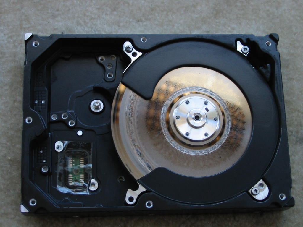

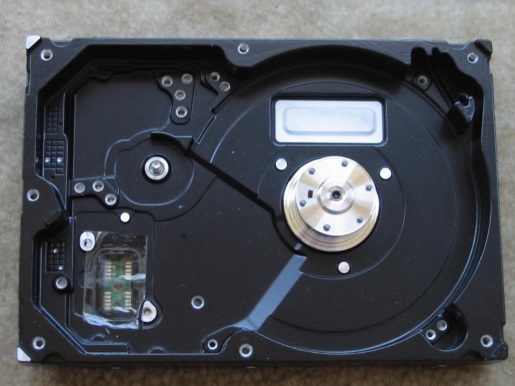

                          #52
                          A Colossal HDD Failure - Part 3 / SOUNDS
                          Perhaps only hardcore geeks may appreciate this post, as I am including an attached file with the *sounds* from the two failed HDDs. Hope you enjoy.
                          failed HDD sounds (112 kbps mp3) ZIP file
                          What's interesting is that while the 2nd HDD was in storage, the heads (or whatever was left of them on the actuator arm) got stuck to the platter, so the HDD couldn't spin up and made this beeping noise instead (which I recorded as well. ) I opened the 2nd HDD up and gave it a manual spin, then closed it and recorded the sounds.
                          And what do you know, it works now!
                          Nah, just kidding.
                          Both HDDs are still dead as a rock.
                          In any case, I decided to disassemble the 2nd HDD and clean it, as I had a project in mind for it. So the first thing to come out for the cleaning was the headstack assembly. Notice the missing heads. I found a few of them (in pieces) stuck to the actuator arm magnet.
                          While at it, I noticed the bearing on the actuator arm had some seriously rough spots when turning it by hand (suggesting failing/failed bearing.) I wonder if this is from wear from high # of power On hours. Perhaps this is what caused the heads to touch the platters? Or was this rather a consequence of when the heads got ripped off from the actuator arm and the force from that damaging the bearing? As you may recall, I mentioned in the first post that as I had the 1st HDD running for the first time, it made a loud *whack* noise after spinning for a while. When that happened, the HDD jumped a little from where it was resting (perhaps that was most likely another / the last of the heads getting ripped off?) If this happened, I imagine the actuator arm bearing saw quite a bit of force exerted on it.
                          Another thing I noticed while removing the actuator arm from the 2nd HDD is that I didn't need to loose the screw on the bottom of the bearing. Once I removed the top screw (that holds the actuator arm bearing through the top cover), the screw holding the bearing from the bottom was already loose. You can actually see it in the pictures shown below that it's still sticking up from the bottom. Normally getting to that screw requires removing the PCB and also a few shiny warranty-like stickers.
                          This makes me wonder, since this is a refurbished HDD, if someone at Seagate didn't torque the bottom actuator arm bearing screw properly. And if so, perhaps this is what led to the head crash. After all, why did both of these refurbished HDDs crash the same way? Given where the HDDs came from (CCTV recording equipment), they probably had high # of power On hours and probably a good number of reads/writes (though nothing excessive, I imagine, as the footage was low bit rate.) Still, I don't think that kind of wear alone could loosen the bottom bearing screw. Or could it?
                          Anyways, I gutted all of the “unnecessary” components away from the 2nd HDD (for the project I will show a bit later.) With that said… let me just warn everyone once more - DO NOT get that fine platter dust on anything you care about! It's really fine stuff and really hard to wash out. I imagine it's probably bad if you breathe it in too, given how fine it is. Luckily, it's magnetic and prefers to stick to metal surfaces rather than stay too long in the air. But it can stay up for a little. Regardless, DO NOT breathe that dust in!
                          Also, this dust was so fine and sticky that I couldn't just brush it off (and for the above reasons, I had no reason to anyways.) Thus, to get the HDD clean, I had to remove all of the platters and wipe everything down with damp paper towels soaked in soapy solution. Here are a few more pictures I snapped while doing that. (BTW, notice the scratching occurred on ALL platters and not just the top one.)
                          Kind of ironic about the cleaning part, given the project this HDD will be used for.
                          Stay tuned!

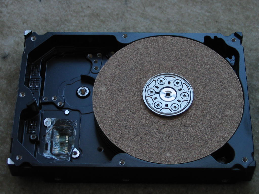

                            #53
                            A Colossal HDD Failure - Part 4 / HDD Bench Grinder
                            And here’s the project I was talking about.
                            It’s a desktop bench grinder!
                            (Get it? OK, maybe not so funny… I’ll lay off the excess water drinking. Clearly it’s drowning out my brain cells too much. )
                            Silly jokes aside, this thing is actually not that useless. The motor in this particular HDD is fairly strong, because it hardly slows down when grinding smaller objects, like sharpening drill bits or grinding away wood and plastic. I’m guessing this probably has something to do with the fact that it’s a 4-platter HDD, so it probably has a slightly more powerful motor than, say, a 1 or 2 -platter drive.
                            Now, I’d love to claim this idea as original… but it’s not. I saw someone do this to an HDD more than a decade ago (it was a YouTube video, if I remember correctly - back when YT was still a new thing.) So the idea to try this has been sitting in my head all these years, and I finally decided to execute it.
                            That being said, to make one of these, first make sure the HDD you use doesn’t mind the headstack assembly being gone. Some HDDs will not spin up or will spin up and spin down when they can’t read anything from the heads. Mine actually does that (spins down after a while), but it stays spinning for around a minute or two, which usually gives me enough time to grind whatever it is that I need. And secondly, I think it helps that I happened to pick a 4-platter HDD, as probably the motor and motor driver IC are a little stronger in order to cope with the extra spinning mass, as mentioned earlier. So I think this is probably what gives my HDD grinder a bit more torque. I’ve tried slowing down a few other HDDs by hand before, and they seemed much easier to slow down / stall.
                            Also, for those who are curious how I attached the sandpaper to the platter: wood glue. It spreads nicely and evenly, so it won't create bumps on the sandpaper sheet. Basically, once I had the sandpaper cut down to the proper shape, I applied the wood glue to it and then put in on the platter (the platter was separate from the spindle, as shown in my previous post.) After that, I flipped the plater with the sandpaper facing to the ground and placed the whole thing on a flat, even surface. Then, I put a heavy object on it (a UPS transformer, in my case) to keep the sandpaper glued flat to the platter. Wait for a day and it was perfect.
                            Anyways, that’s all I have for this project for now. I might eventually get different types of sandpaper sheets and do the rest of the platters too. That way, if I need finer or coarser grinding, I can just swap the platters to swap sandpaper. And I’m also thinking maybe add a small “table” / shelf in front of the disk, so I have a surface to lean objects against when sanding. IDK, we will see as I get more ideas.
