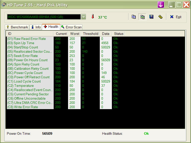

        haha! here's a wd cav blue 500gb ide drive i bought used off junkbay with 56k+ poh. it also has over 50k start stop and load unload cycle counts.
        i like those line of drives! they are tough old boats! tho one died on me recently a couple of years ago and totally bricked itself. undetectable by bios and wont spin up. just makes a few clicking noises on power on and then no further noise or activity from it. ah well... no drive or drive line is ever 100% perfect. all hard drives fail... eventually... but other than that, those drives have been pretty reliable for me so far. i have hoarded like 5 or 6 of those drives. hahaha! im such a hoarder too rofl!
          I see only 149 "hard" power cycle counts. The 50k start/stop and load cycle counts may just be head parking jobs, depending on how the HDD is made to report these. That's still a lot... though nowhere near as bad as WD Green drives - now those drives really like to waste time parking heads more than doing anything else.

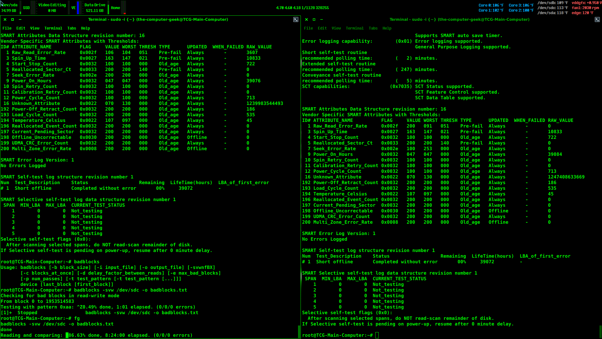

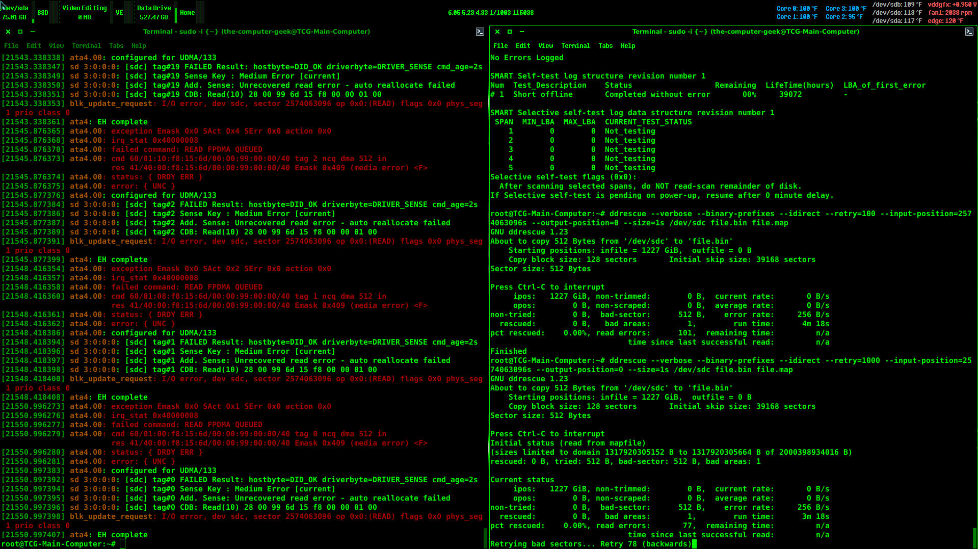

            Ugh looks like the WD205BA just choked on me... cant write new data ...
            Still can read existing data however.
            Well it said it was bad, it really is!
            • eccerr0r
              Solder Sloth
              • Nov 2012
              • 8704
              #66
              Re: A Colossal HDD Failure
              FSCK this...wtf.
              badblocks -n reports 0 FAILURES!!! Come on, write the bad block locations to the ext4fs bad block list!!!

                  Look at the fact that I specified -n : a non destructive write... This reads data off the disk, writes test pattern, and then writes the old data back - nondestructive (and is very slow!). Without -n would have meant read-only, but it definitely wrote..
                  Note that I already know there are a lot of sectors that had problems writing in the past and was hoping to get them ignored by software (NOT HARDWARE) by adding them to the software based bad sector map. It completely ran out of spare sectors already.
                  And no, I'm not disposing of this drive yet, I'm milking it until the motor dies or head scrapes the rust off...

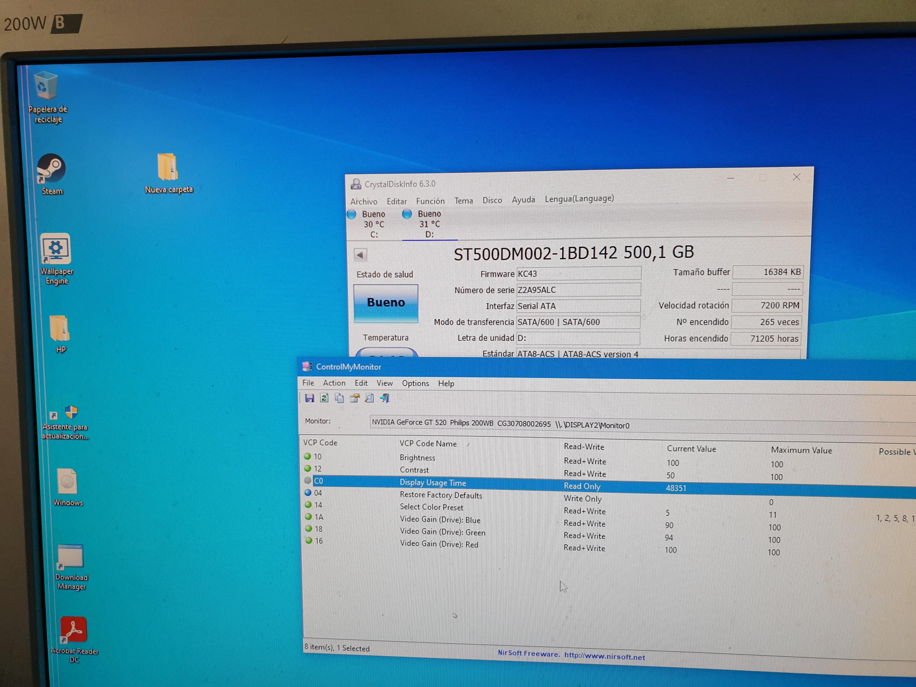

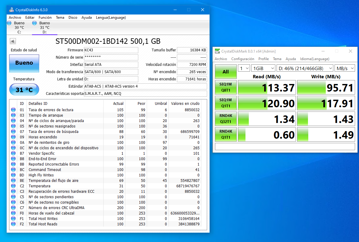

                            I update, this Seagate 1BD142 is proving to be very reliable, the last time I photographed it had 61,000.
                            Also, as an extra piece of information, the monitor that the PC has has almost 50,000h, and I have never changed the CCFL lamps.
