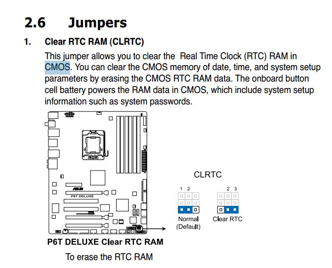

    Re: My Asus P6T CMOS settings now always wiped out when unplugged!
    Only when the battery is no good. Have you tested it's voltage ?
    Jumper knocked off ?
        There's no place for a jumper to even be found, LOL.
          There is, it's bottom right hand corner, labelled CLRTC
            I couldn't find "CLRTC" or "CLRRTC".
                  The manual seems to indicate it should be marked but it's not. It's just above the front panel connector.
                  Pic changed, didn't notice you have the Deluxe.
                  I would have thought if a trace had been damaged then the issue would have show itself then ?
                    OK, maybe I got confused, because there's a jumper there, where it appears to be marked for another function, SMH!

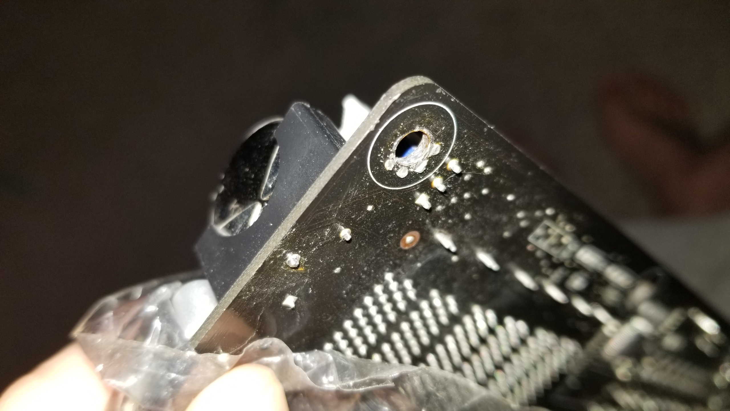

                          This happened to a customer of mine with that exact same motherboard. I fixed it. Want to know the solution? I'll send you my paypal and give me $50!
                          Kidding.the p6t is poorly designed for the battery casing. It's vertical. It's easy to knock the positive pin out the motherboard. I heated it up, put some leaded solder on it and pushed it back down as I heated it up. Worked fine after that
                            Check that pin on the very edge
