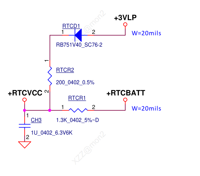

    You can remove the pull-up resistor mated to the power switch and this +RTCVCC rail to investigate if that is a root cause. Each leg of this power rail appears to have a local part that can be temp removed to check if that load is the fault or not.
    Confirm the 2 resistors are ok @ RTCR1 and RTCR2.

      Both resistors have a good value.

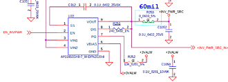

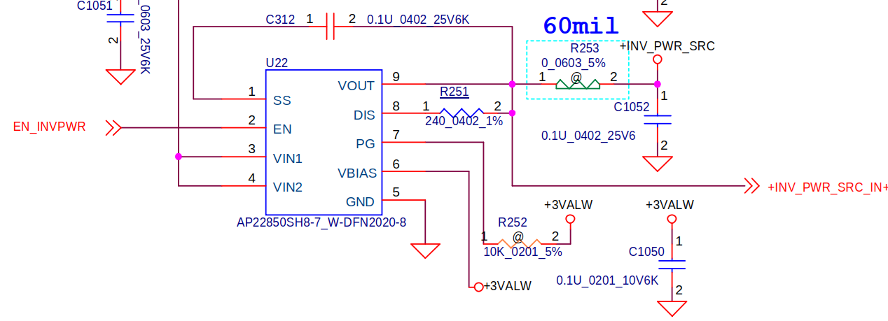

        + What i have managed to figure out. If only AC adapter is plugged in (no main battery or cmos battery) then laptop starts with power button press bios reseted and complains abouth battery voltage low but OK.
        + When only AC adapter plugged in, the board draws 100 milliamps and after about 20 seconds it jumps up to 380 milliamps (in this state, the resistor R251 next to u22 and one spot inside UE3 (MEC5105_WFBGA169) also getting hot (both IC spot are 38 Celsius )
        Click image for larger version  Name:	inverter_en_noreason.png Views:	0 Size:	91.1 KB ID:	3739899
        Its like the inverter is turned on but nothing is connected on that port so why? This happens even when the board is not connected to any of the periferials or screen. The board takes the same amps.
        + R251 value isnormal 240 ohms when measured.
        + When only main battery plugged in then its voltage is dropping to 7.3V (normal standard is 7.6V, battery health is 85% so its good) laptop won't event reacts to power button even when AC adapter is plugged in.
        + When measuring R251 when AC plugged in, it shows 0V on both side so it is pulled to ground .
        Any idea what this means? my suspect is UE3 because it turns on the U22 for no reason but why is u22 pulling inverter line to ground?
