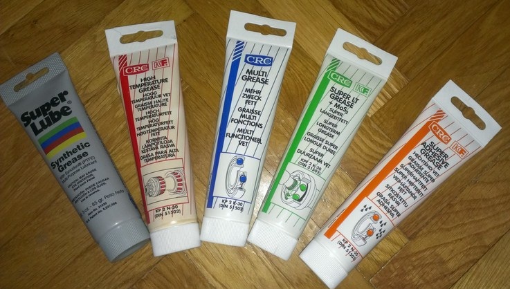

                            I've been doing some research on lubrication and came to the same conclusions as 999999999 posted a while ago. I used all kinds of greases on pc fans just for fun. The longevity seems to be better than with stock lubricant.
                            I'm just not sure how long can a fan run on a thin film of grease that doesn't get replenished.
                            There is also some difference in rpm when using grease instead of oil. It can be as high as 20-30% when the fan starts. But after 15 minutes or so, the speed settles closer to the oil's maximum speed. Usually grease lubricated fans still have 3-7% lower rpm than oil lubricated fans. This is for 8cm case fans and grease that has viscosity 100-150cSt. That's a viscosity grade of a typical multipurpose lithium grease.
                            And the only non automotive oil that I found thick enough for the job is Power Lube. It's an industrial grade oil with addition of PTFE that should help fill microscopic asperities on the bearing surface and hence reduce startup friction and avoid boundary lubrication in general. It is my understanding that PTFE acts as a kind of fine deposit that settles on tiny imperfections on the surface.
                            These are some of greases that I used

                                That Mobil 1 could be similar to my "High temperature grease" on the picture. Both are lithium complex grease types. Except that Mobil 1 has a higher viscosity which you compensate by mixing with oil.
                                I actually do this by disassembling the fans and then cleaning the bearings and the shaft with a degreaser spray. Only then I apply grease along the entire length of the sleeve. I usually use a toothpick for this.
                                For worn out bearings I use higher viscosity grease (800cSt). I still haven't been able to see the final results in terms of longevity. I know that the cheapest fans I have failed within several months of use with stock lubricant. Now they've been spinning on grease for over a year.
