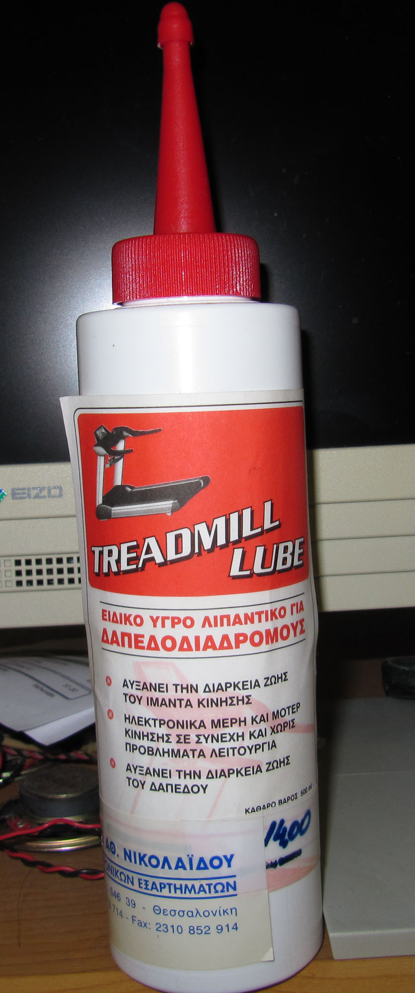

    ^ What a treadmilll uses could depend on the manufacturer and where it is used. If it is in a gear housing then it's probably 85W petroleum gear oil. That would work, but won't as readily soak into the porous bearing.
    Silicone oil is rarely used for lubrication except where petroleum oil would break down components or in an extremely high temperature environment where it better retains its viscosity.

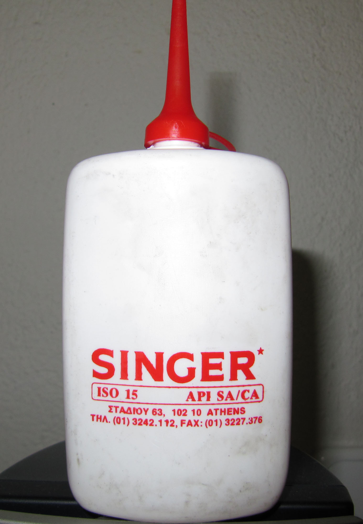

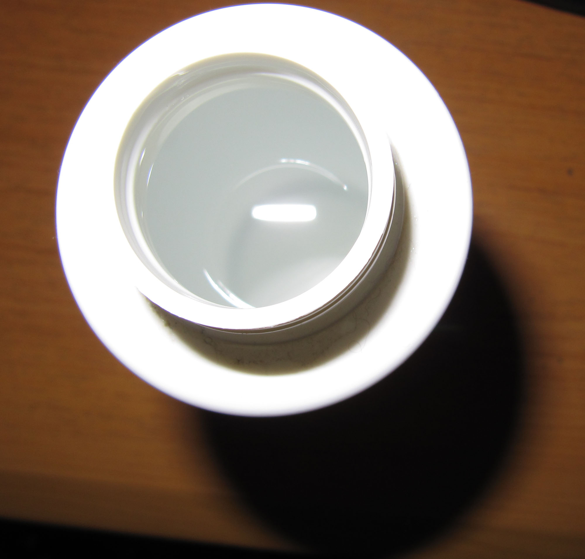

      Re: Computer fan noise and maintenance
      Here it is.
      I think it is silicon based. What is your opinion?
        ^ Based on (lack of) color it does look like it may be silicone based, but I can't read the text on the tube. Where is it used, which specific parts of the treadmill?
        I wouldn't use it on fans, but in an emergency it might keep one running.

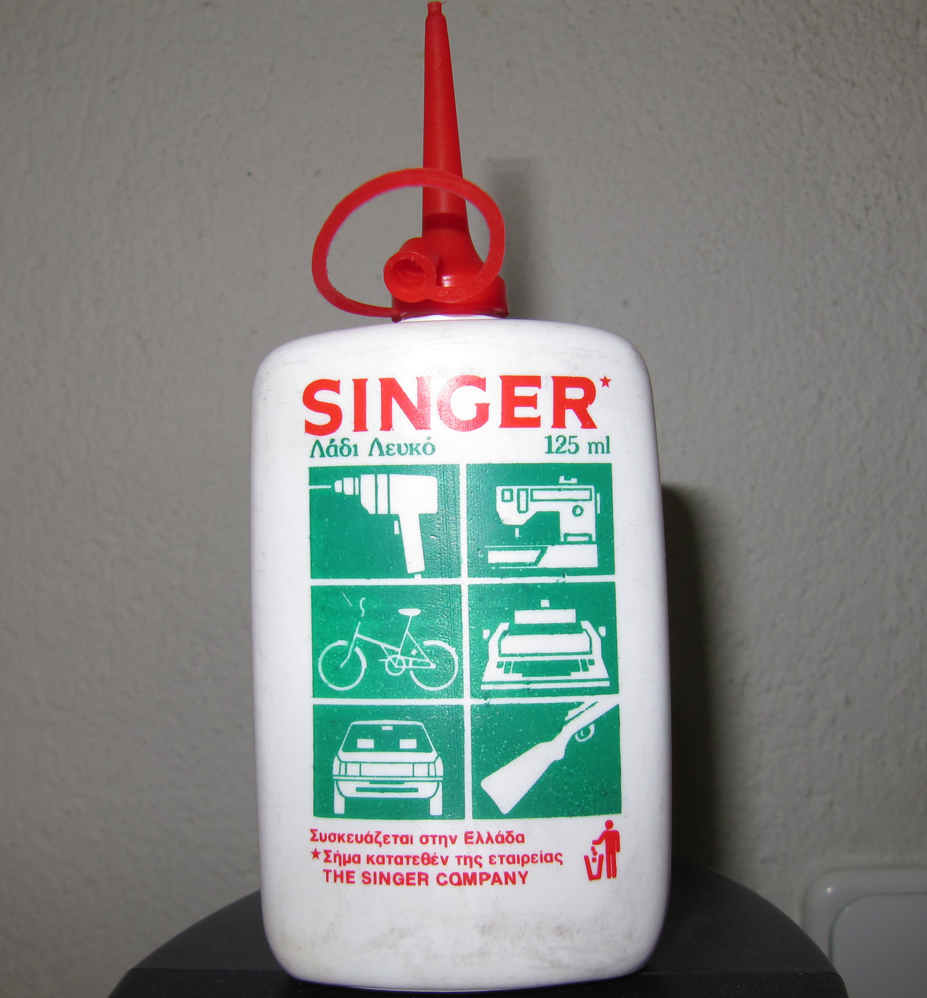

                    What about this oil type? I bought it today for 2.5euros. Is it the suitable for fan bearings?
                      Looks like seweing machine oil type (unlikely that it is genuine "Singer" like the seweing machine brand, but anyways). If so, it will probably do fine. Sewing machine oil tends to be a bit more runny, but it doesn't dry and (at least IMO) it works fine.
                        Yup. I've un-stuck and lubed a few fans with sewing machine oil before. I usually use chainsaw lubricant, which is just a bit thicker, but that works fine too.
