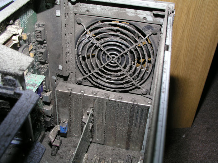

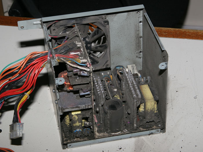

    ugh.......dirty

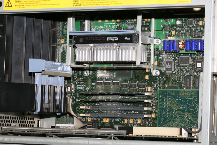

    maximum uptime = look like this after 5 years.

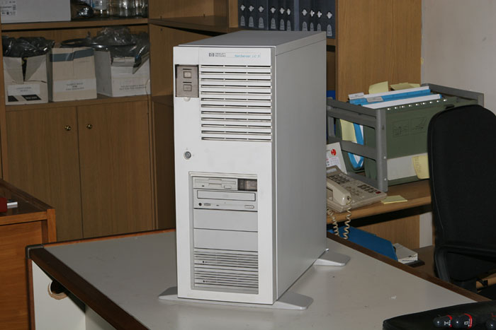

        Yecch. I saw a 1995 Packard Bell that was about as bad as that. What sort of machine is it?

          Man, did that come off an aircraft carrier? Looks like jet exhaust.. or foot fungus.

            nope i think its car exhaust. it was in a room next to the main road on the 3rd floor. kinda makes you think about what you are breathing. i see only machines in the city with this black dust.

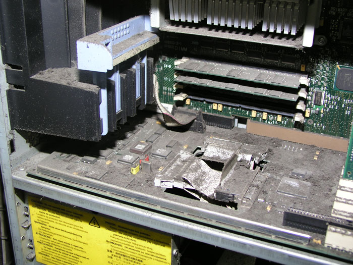

            dunno what to do with it yet though. the scsi disks have been whining for a long time so i wont use them. i was running it out of production until they died but got bored waiting, quantum scsi are definitely better than the ide. it was installed in 1999 so it is older than i thought. i will definitely clean it. It would be nice to serve archive data using pci sata. a gig of ram and some new procs would be nice...........sad to shut it down, i will miss novell.
            HP LC3, PII 350, 128mb, 2x10gb software raid-1 novell 4.11
            replaced by HP DL380 G4, 3.4ghz xeon, 1gb, 3x72gb u160 hardware raid-5 + hot spare, redundant psu, redundant fan kit. RHEL 4

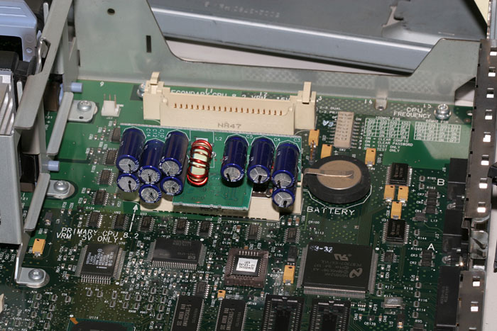

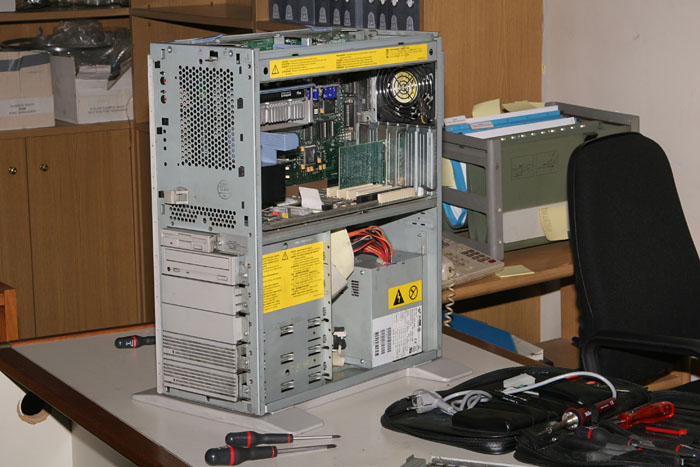

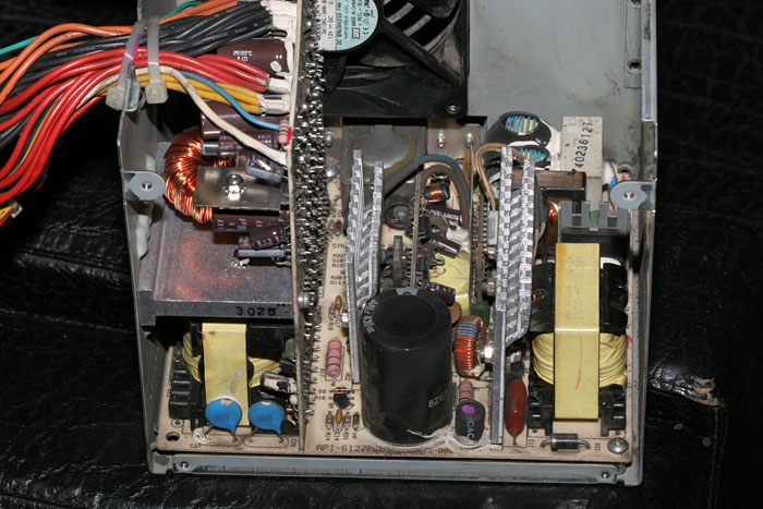

              All parts cleaned and ready for assembly

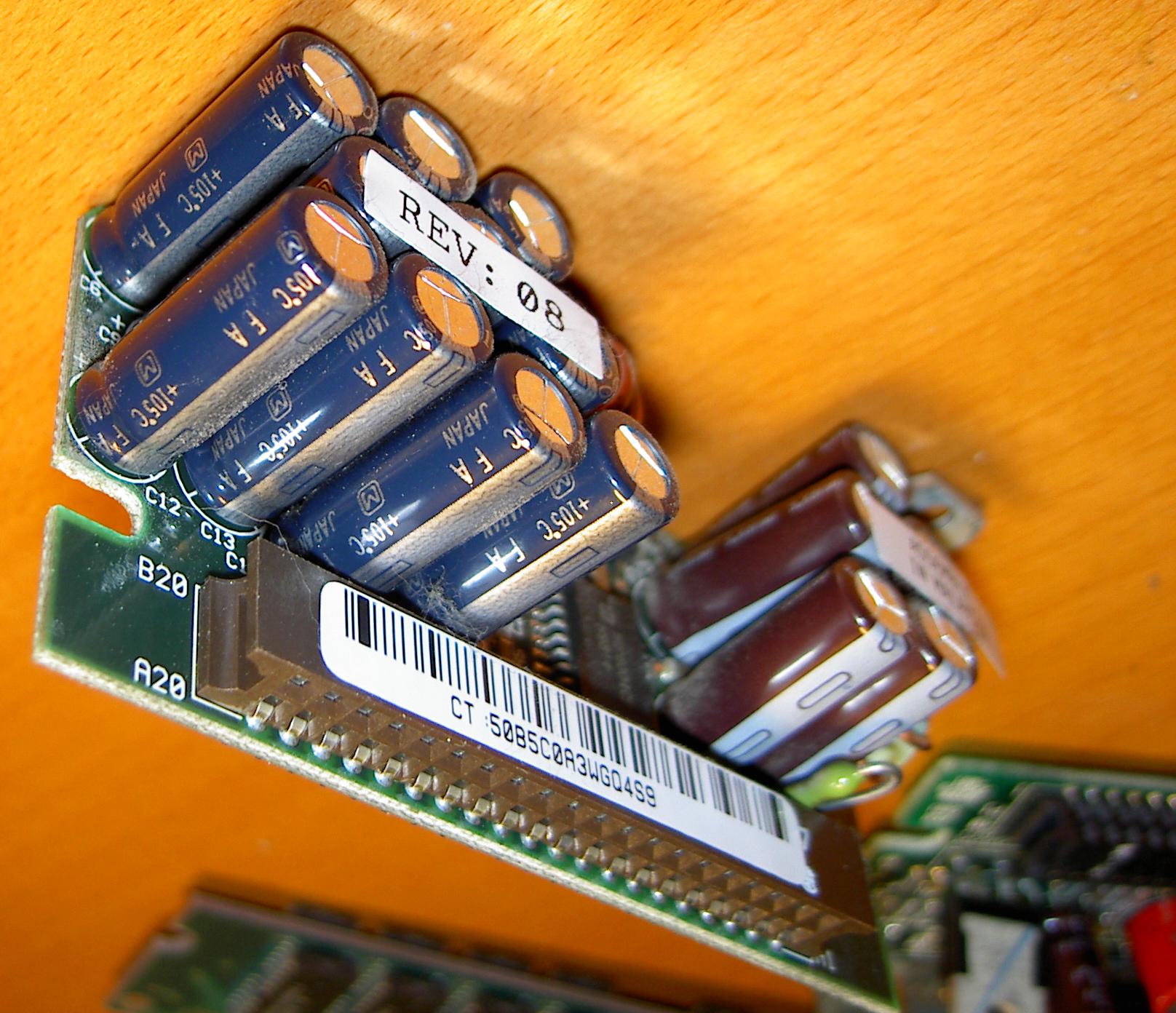

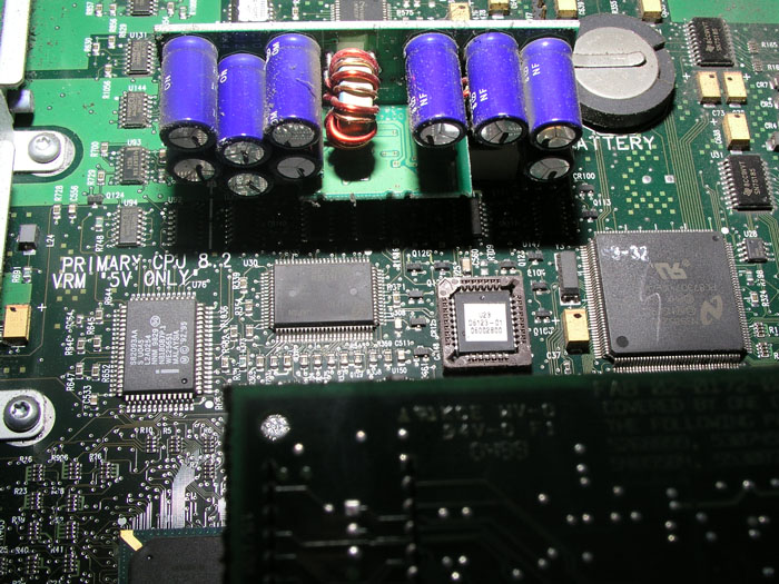

              doh! there is only one 8.2 vrm so no dual possible unless we find one.

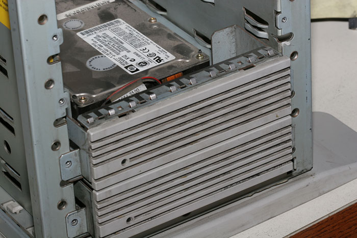

              hdd caddys. if you buy an HP server secondhand, make sure it has enough of these and not just blanking plates.

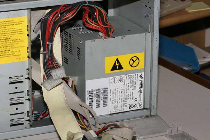

              acbel psu API-6127 350w
              psu interior
              all panels on
                Not one of these by chanche :P :P :P

                  looks interesting, i dont know if it would be compatible though. what do the other stickers say.

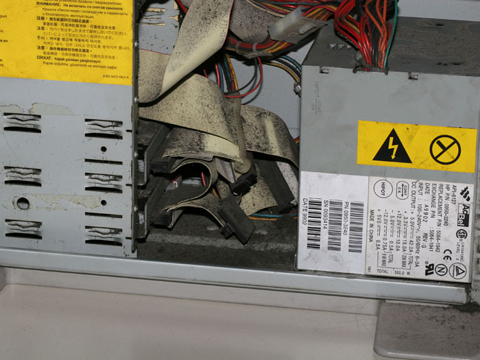

                  situation with the server at the moment is the psu is playing up. i had problems to start before one time when i had to down it a while ago. now it was starting then restarting repeatedly with no cdrom/hdds attached.
                  eventually started properly so i shut it down again and i reattached them and got it up. the hdds sound like shit now. i am not suprised, when you take elderly servers out of service for a while and then start them again big problems start.
                  anyway the hdds are for the trash i know anyway. what about the psu though? the caps are chemicon and look ok. any ideas? i will take it apart and check it with the esr meter to see whats up. but anything else i should check except for the caps? need to refurb psu otherwise it is all no use,

                    Odd, And I looked at that PSU and thought, ahh, old nice servers always use good powersupplies, oh well
                    Regarding the VRM, I was only teasing you, I need it myself

                          Yup - the AcBel PSU is not as good as the earlier (?) Delta OEM units that HP was using. It should be fine after a recap, though. Give a shot of TV tuner cleaner or switch cleaner to all the power connectors, as well.
                          I'm not sure about this particular system, but if it's a i440BX chipset, it may be capable of supporting Cumines in slotkets with a VRM upgrade to 8.4 and a BIOS upgrade (for Cumine microcodes). I was able to do that to a HP Kayak XU that originally had a Deschutes PII/350. Another option (even more iffy) is a Tualatin-conversion Slotket.

                            Re: ugh.......dirty
                            yeah it must be a bx, i see a fw82443bx
                            good call.

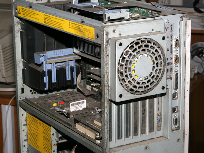

                              I just noticed you replaced the PSU fan backwards. The label side should be facing away form the components.
                              The great capacitor showdown!
                              • tiresias
                                • Feb 2006
                                • 489
                                Re: ugh.......dirty
                                I beg to differ.
                                Notice the location of the PSU - at the very bottom of the case. It is therefore logical, coolingwise, that this should be an air intake, not an exhaust.

                                  Re: ugh.......dirty
                                  both fans are backwards. i fixed them after uploading the pix. original for the psu was for exhaust so i continue original design
