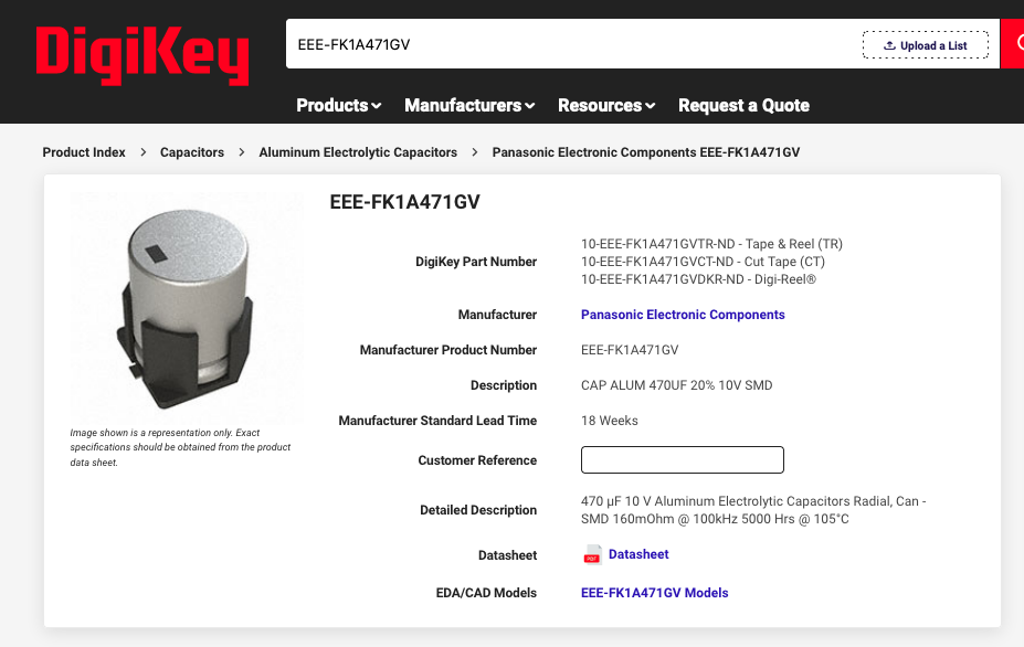

                      #170
                      470uF, 10V
                      go for something 105c rated 470 uF 10V or 16V, at least 5000hrs rated.. Like
                      EEE-FK1A471GV
                      on Digikey.
                      Mine are through hole with two legs. This one you mention at digikey looks like it's not through hole. Is this right?
Name:	Screen Shot 2025-07-01 at 11.58.00 AM.png

                        #171
                        Click image for larger version  Name:	Screen Shot 2025-07-01 at 11.58.00 AM.png Views:	0 Size:	122.0 KB ID:	3672594
                        Then just fit a regular through hole capacitor like
                        EEU-EB1A471
                        just watch the leg spacing, diameter and height.

                          #172
                          The cap that scottl31 posted above is Nichicon HC series, as lti correctly identified.
                          EB series from Panasonic is not quite adequate in that case, if ESR and ripple current capability are to be observed.
                          Relatively close replacements would be United Chemicon KZE and KZH or Rubycon ZLH or ZLQ. All of these are readily available on both Mouser and Dikigey ATM. Just match the capacitance and the voltage (10V, 470 uF), along with the diameter. Height-wise, UCC KZH and Rubycon ZLH and ZLQ will likely both be shorter, since they are newer miniaturized series.
                          *edit*
                          Forgot to add... Nichicon HW and HV series would also be close enough (if not better), along with Panasonic FR and FS. These are also readily available on Digikey and Mouser.
                          Happy hunting!

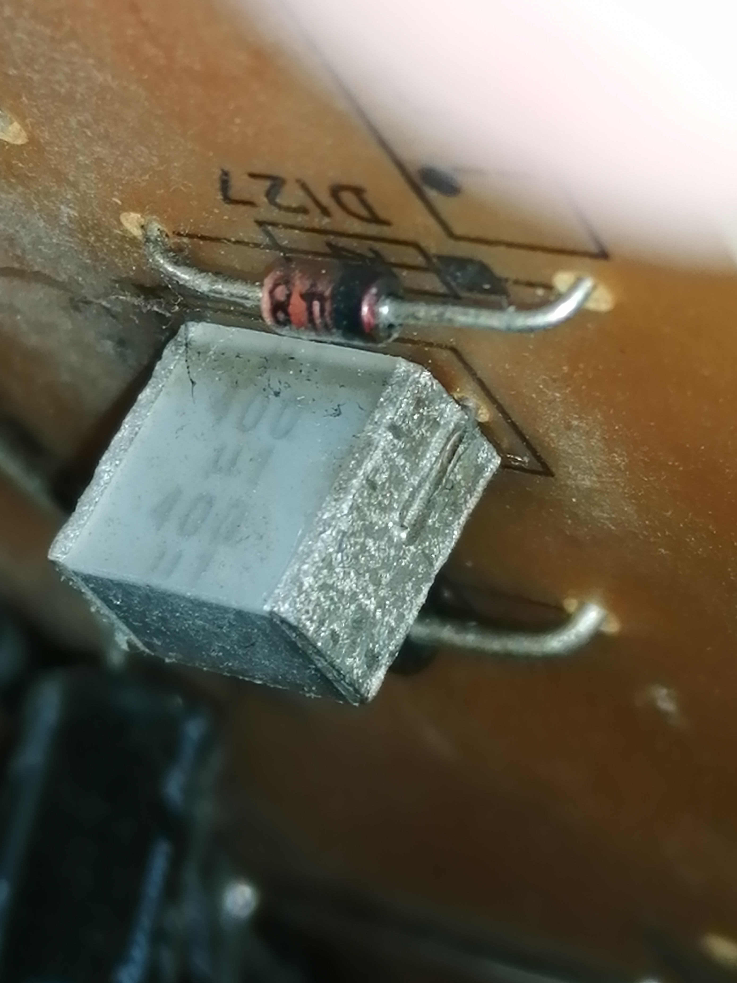

                                        I have a THT MLCC that i am unsure of. could someone help ID this cap please?
                                        thx

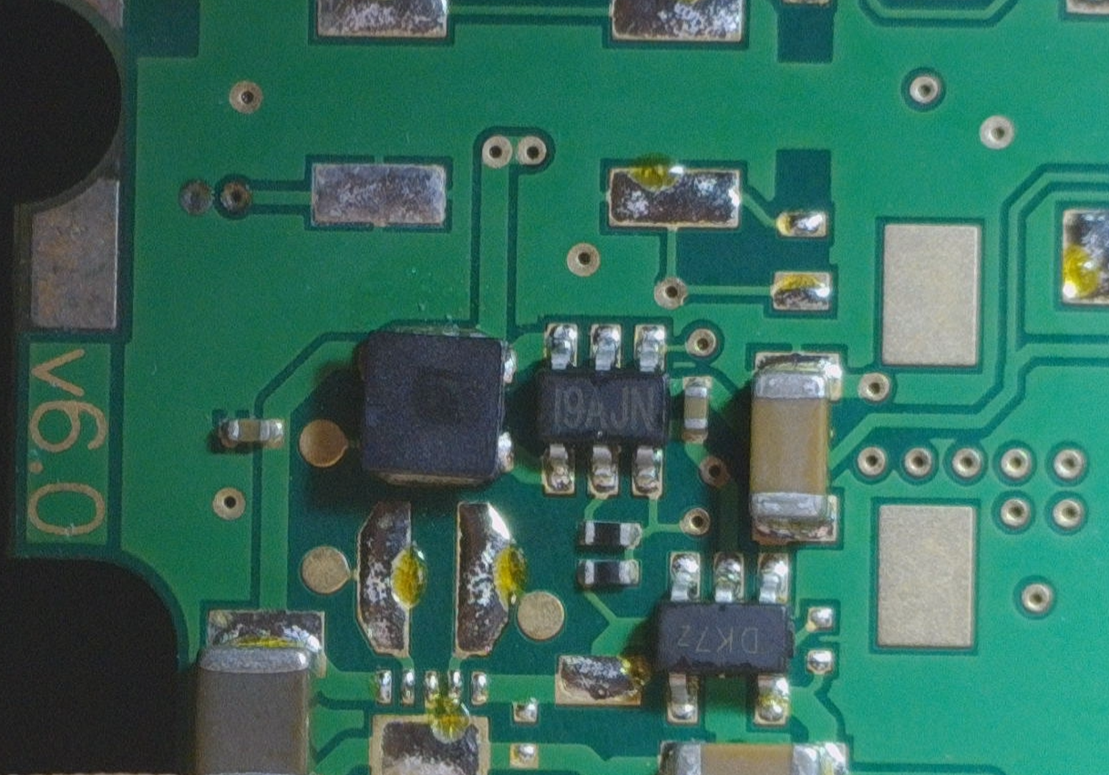

                                          I'm trying to repair a car ECU that shows a fluctuating system voltage (between 6V and 13V in diagnostics) even though the battery voltage is stable. I suspect a faulty capacitor on the main power supply line.
                                          The capacitors in question are a small, yellow, ceramic capacitor located right next to the main power input pin (pin 12) and ignition (pin 13) of the main controller chip. There are no visible markings or codes on it.
                                          I've attached a close-up photo of the capacitors (pin 12 is constant + and pin 13 is ignition + ) and an overview of the board. I've checked the resistance with a multimeter and pin 12 capacitor goes for 0.8MΩ and pin 13 capacitor goes with 2.8kΩ. The ecu was under water so from my little understanding I suspect this could be the problem for the fluctuating system voltage
                                          Could anyone help me identify its likely value? Any help would be greatly appreciated!
