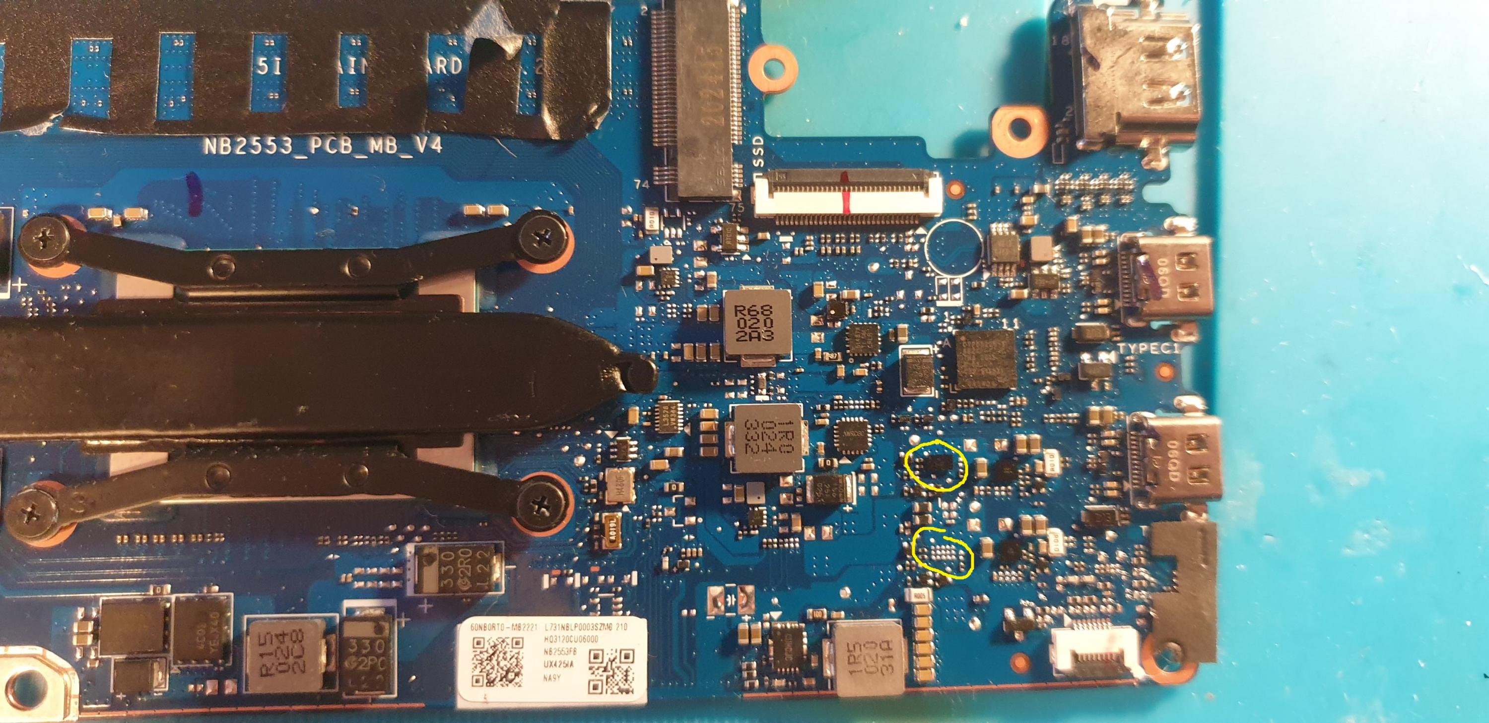

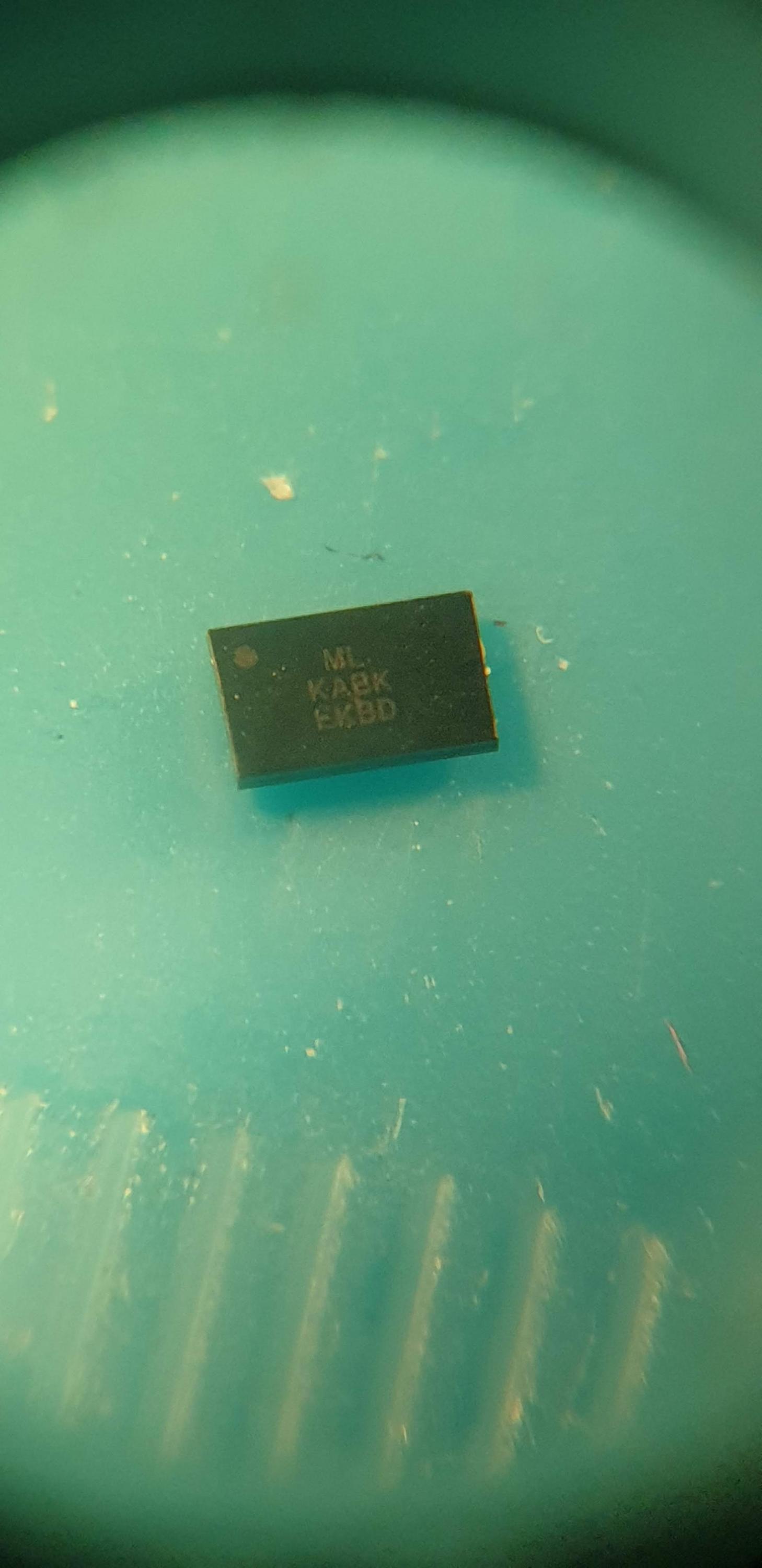

                            Can anyone identify this component for me please? It's from an Asus US425IA motherboard. The writing on the component reads "ML KABK EKBD"
                            https://ibb.co/Smgr01T
                            https://ibb.co/8n3CV3X

                              Attached images of above question

                                Re: Post help identifying capacitors here
                                That looks more like a MOSFET or DC-DC converter IC to me, from the little I can see.
                                  Oops sorry, I just realised this thread is only for caps. I'll move it to a different thread.

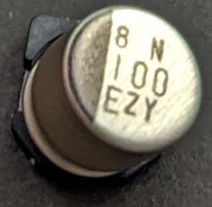

                                    I have an Alienware Area 51m laptop that blew a surface mount aluminum cap.
                                    I've attached an image showing the following lettering:
                                    8 N
                                    100
                                    EZY
                                    I know it's 100uF 25V series ZY but I'm coming up dry on locating the manufacturer.
                                    Any ideas?
                                    Thanks,
                                    -vencain

                                      Looks like Panasonic to me, maybe some vendors special series, but if you'll look close to letter E, it's slightly bigger then other letters, like in Panasonic caps, but this is only thing that reminds me of panasonic caps
